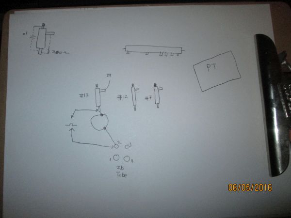

I think what you are measuring is the resistor that is connected to the cap. We're not particularly interested it that . We are interested in the coil winding above it. Note the drawing and find the ohm sign and connect your ohm meter there at the coil and the plate pin of the 26. This will measure the coil's resistance not the 1oo ohm decoupling resistor.
Test voltage for the cap @ 300v.
Ok, I understand now.. The Coil #6 primary( Connected to Plate) = 1.6 ohms sec = 2.0 Ohms..
same for # 11 and 16..
#1 the 10K Pot kind of flackey..Will have to take apart and Clean..
#2 Primary connected to CTR of pot = 2.4 Ohms Sec 2.0 Ohms
