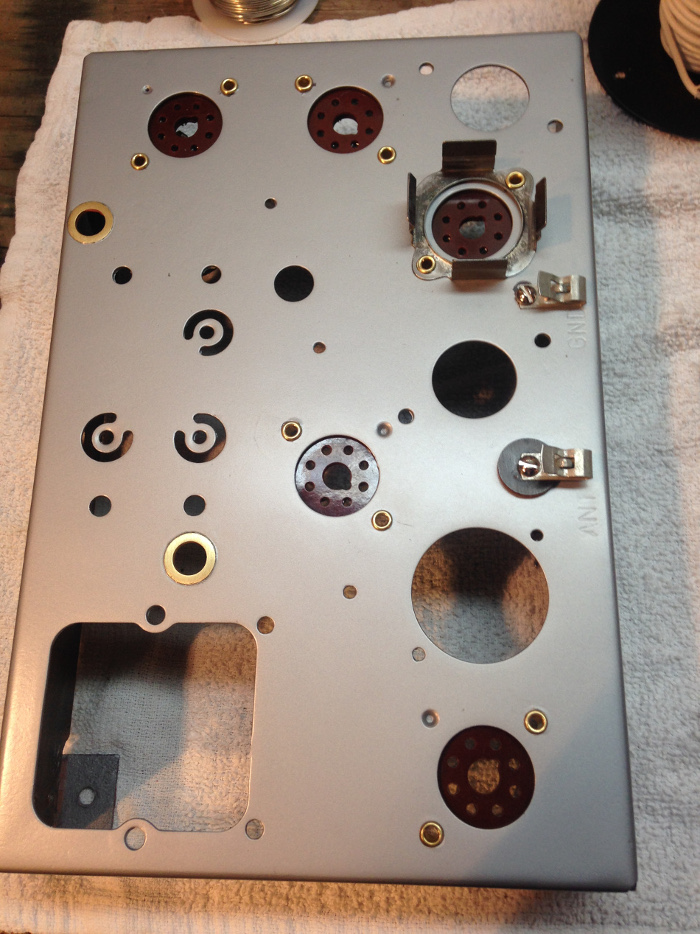

Where to find eyelets and tool(s)?
No. Those are not brass grommets.

I do not have the skillset needed to make my own flaring tools for this project, let alone modifying eyelets with tubing.
I'll just use pop rivets and drill a hole for the wire.
Thanks everyone.
Let's keep looking. The ones we want and the tool are out there - somewhere.

Hello Ron, I used these for attaching tube sockets.
https://www.amazon.com/gp/product/B00BL6...UTF8&psc=1
I used a 3/16 eyelet setter and anvil that I bought off of ebay.
I hope this helps,
Kelly

These are too light-duty for the application on a radio chassis.
I have the tool for these.
So...I told you a week ago that a Phine Phellow Phorum member had given me a call and made what I thought was a very good suggestion, but I did not elaborate.
Having finally found the time to get what I needed from the hardware store, I tried his idea out tonight and it worked!
Here's the details.
Ed suggested that I install the combination of tube socket and tube shield base with two 5/32" or 3/16" aluminum pop rivets, and then take a nail and knock the head out of the rivet through which the wire needed to pass.
It wasn't easy geting the head out of the rivet, but I was able to do so and, as far as I could tell, nothing was damaged in the process.
The new cloth-covered wire easily fits through the hole in the center of the rivet.
Problem solved.
Thanks Ed. Icon_thumbup
One of these days, I may still try my hand at setting brass eyelets. That is, once I get my mitts on the proper setting tools.
Note - I just googled, and copper "pop" rivets are available, if that is a more appropriate material than aluminium.

The ones we really need are brass and nickel plated brass. They end up looking the same on both ends when installed properly.
