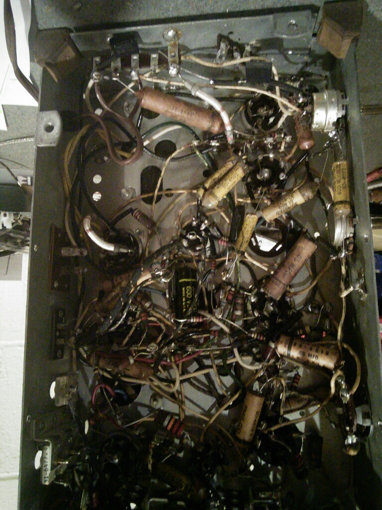

With regard to that phono jack I don't know what they were up to there, the usual method is to feed the signal into the grid of the 1st audio tube, or the top of the volume control. I don't know what they were up to in connecting the center of that jack to the plate of one of the power output tubes, and I've never seen a choke involved with a phono jack instal before, maybe they had some other intended purpose, five will get you ten it was a Ham operator that did it.
On those molded paper caps I think that Dennis Carter did drill the actual capacitors out of the plastic shells with a twist bit in a battery powered drill, they looked like those Sangamo "Little Chief" caps to me with the bright coloured shells. I don't know if the Bumble Bees are molded any differently, but one thing I do know is that they were no better then the run of the mill Aerovox waxies, unlike the Solar "Sealdtite" brand ones which are one of the few that are usually still functional.

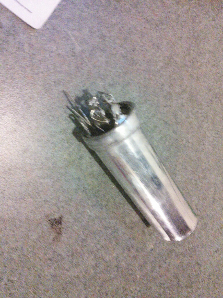

I soaked it 24 hrs. Tonight I pulled the pickle out of the brine, grabbed one of the twist tabs with pliers, and the shell with my hand, pulled and the cap came out with the juicy "chwuak!"sound.
Black tar.
Removed most of it but decided to soak more to remove the rest.
I like this method more as gripping hot capacitor while trying to work fast as it is cooling fast is even less enjoyable.
...that's what heavy gloves and pliers are for.
P.S. Congratulations. I would not have thought soaking would be successful, given that the shell is foil over a very thick paper material.
It's permeable, plys open unfoiled end at the lower flange. It came out without much effort at all, plus the thinner did not make the paper warp.

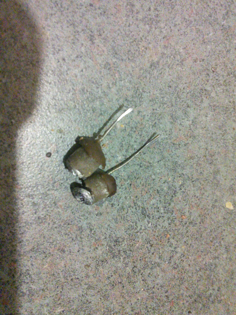

Received 0.0056uF caps to restuff 0.006uF Philco tubulars. These proved to be the most stubborn caps yet: I do not know what kind of compound this is they used for the plgs, but it doesn't melt. I broke the leads on one, and ended up crushing the p!ugs with a hammer, damaging one end so I had to trim the tube.
The second cap I approached differently: I held one lead in a vice and pulled the other lightly with pliers: after 5 minutes of heating the plug came out. The other end didn't fare as good: I ended up crushing this end too, though it worked better this time. Spent an hour for two caps, and I have another two of the same.

I've run into tubular paper caps like those before, they were made by a company called "Good All" and had some sort of putty in them that does not melt with heat. "Good All" in spite of the name, does not have a good reputation, a guy who fixes TVs on You Tube calls them "Bad All" and he lives in an area where even paper Aerovox caps seem to be good after 60 years.
I never did try soaking them in lacquer thinner, but I don't really have any equipment that used "Good All" caps as OEM components, plus they are from the 1950s and therefore too new to bother with.
I take it, Philco might use re-labeled caps then? These are the only ones in the whole radio that behave like this.
There are different waxes, those brown that melt more readily and those greyish-brown or grey that melt not as good, but all do melt and come out without major problems. These are 6nF 450V caps and the only type I ever encountered using this type of putty or whatever that is.

This is how the plugs from the caps look after extraction. They havent lost the shape in the least bit.

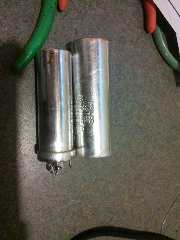

The twistlock cap. Being glued together. Will dry up tomorrow.

One more twistlock and hopefully this will be it. This one also isn't in a cadboard shell so maybe it'll be easier. But I hate that phenolic panel they are mounted on.
