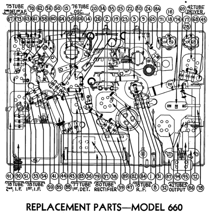

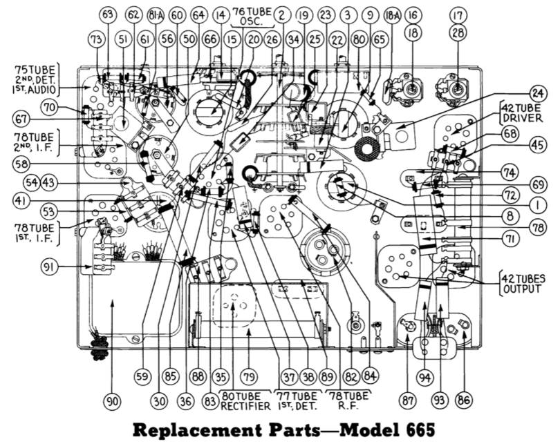

Comparing the 660 to 665 under-chassis pictures to your photo:
You've got a 660.
-> Part #32 is present on your chassis, not on 665
-> Part #39 is present on your chassis, not on 665
-> Part #71 is present on your chassis, not on 665
P.S. it turns out that the 660 and 665 use the same transformer and dial scale parts.
