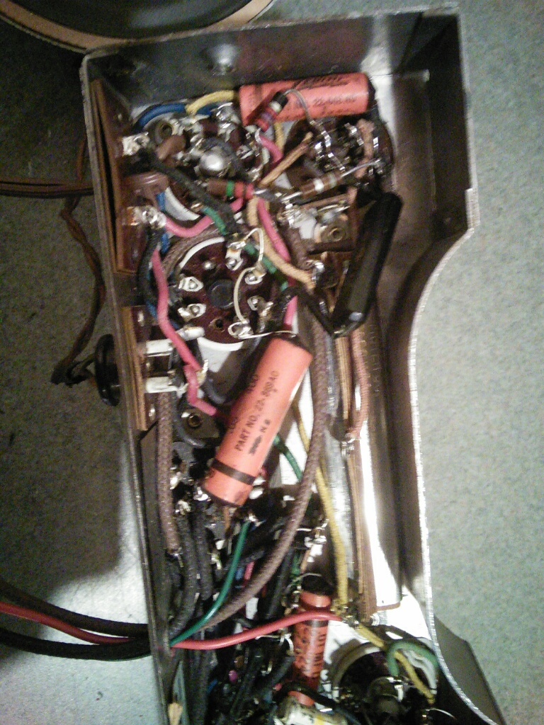

Meantime finished restuffing the tubulars.
Speaking of the tubulars: half of them on the right side are the type with thin paper shell in place of thick cardboard shell.
The wax seems stamped (flat with a ridge) rather than just poured over.
Gutting these is a hassle: wax melts easily but doesn't just pull as a plug but rather creates a jam-like remnant which can't be just nocked off lest the thin paper be damaged.
Luckily most of them, 0.05uF, are of the diameter of my exacto knife handle, which coukd be pushed through when the wax is hot.
Still uncomfortable and the paper is easily charred.
This time around I used Exacto blade to cut the electrolytic open: came out much cleaner than with the bandsaw. Not that it matters much.

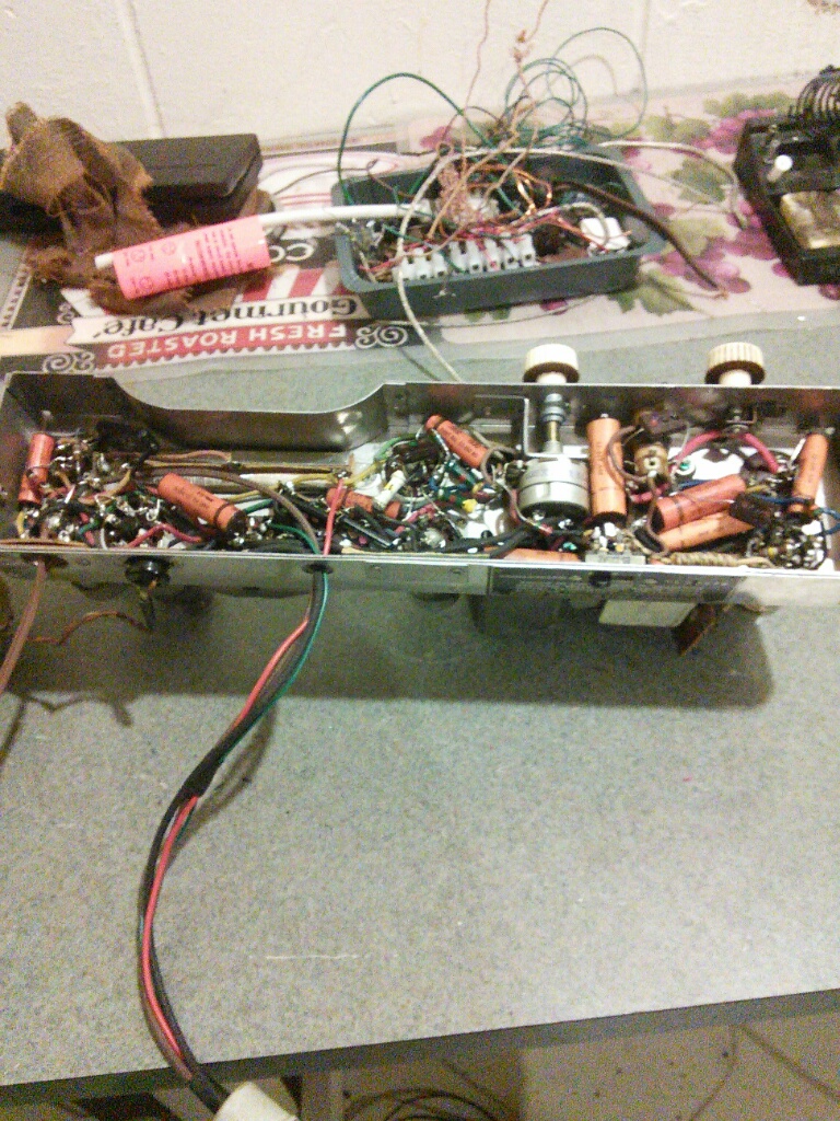

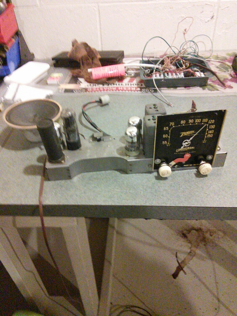

So, Thursday the electrolytic caps came, and today I restuffed the last one, glued it together and soldered it in.
Had to replace a few wires that really started to crumble on me, plus rebuilt the battery cable.
Here it is again:
I plugged it then directly into isolation transformer, without the variac, and turned it on.
Nice radio noise started coming out after about 4 seconds (fast if you ask me, often takes 10+) snd I quickly tuned in my local station which happened to be exactly where it should be.

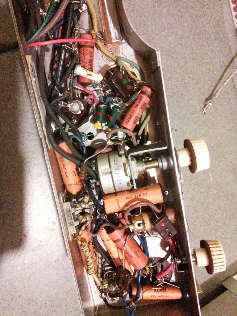

The volume pot is noisy, I think I'll try first to find a way to get some Deoxit inside without having to open it up.
Mike I have had good luck using WD-40 on volume controls.
David,
You mean, intraven...I mean, inside? Icon_smile
It might work, sure.
I just happened to have Deoxit Fader Lube specifically formulated for the job. If the pot were ooen, I mix just a smidge ot lithium grease with it.
I use Deoxit D series on switches.
Nice Job Mike!
There was noise while handling the volume control on my Zenith in the other thread. I determined that this was intermittent contact  between the control shaft and the body (grounded to the chassis), not the control track or wiper itself. A tiny spot of lock lube (which contains graphite) was applied to the shaft where it enters the bushing of the pot. No more crackling  Icon_biggrin
Ed,
Thanks. I wish it was that easy, but mine seems to be just a scratchy pot....the sound of a scratchy pot is very characteristic, plus I think if there is a problem with the shaft contact with the chassis I would hear hum when touching the shaft which I don't. I'd try your suggestion anyway if I had the graphite lube handy, else I have to go and buy it.
At any rate, I will have to find out how to get that Deoxit inside. I am really reluctant to take the pot off. Drilling holes in it also does not seem like such a hot idea to me.....
Icon_smile
Yes inside without taking it apart!!! Spray WD-40 around the shaft and around the connecters might have to do this once a day for several days keep working the control back and forth. Learned that trick from the guy who had the old army generator I talked about in the what you fixed today thread. Jack was old school EE and signal corp from WW2. Him and his friend J.M. could just about make anything work.
