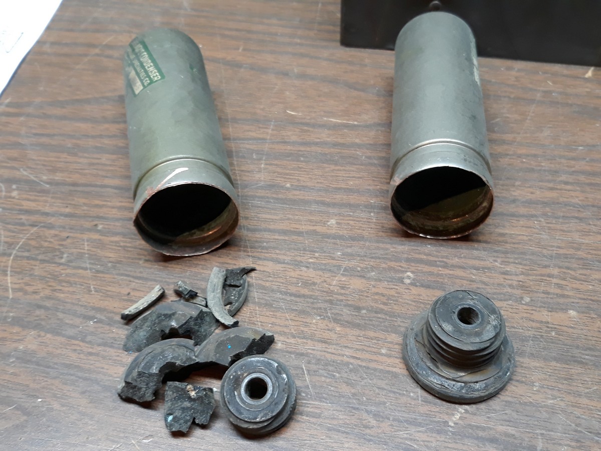

So I tried again just a few minutes ago.
I could not get the bakelite piece out of the first can without breaking it.
Then I ground the lip from the end of a second Sprague cap.
After doing so, I made a discovery that you guys who have done this before had not mentioned.
There is a rubber ring at the bottom of the bakelite piece. This is what keeps the bakelite in and may prevent its removal.
I found that if I carefully went around the bottom with a knife, cutting away the rubber ring between bakelite and metal, that the bakelite piece could then be removed fairly easily.
I had ground enough material away from the first can. It was the old, hardened rubber holding the bakelite in place.
Results of the first (left) and second (right) cans, below:
Now, if I could only get good enough with my Ryobi "Dremel" tool that I don't let it slip and mar the outer edge of the bottom of the cans...

I suspect that when I use a belt sander to remove the lip, I am sanding a little of the rubber ring away making it easier to remove the Bakelite assembly. I did remove the rubber ring, at least on the Mershon's which gave me the room necessary to roll the edge of the can over again on reassembly. It looks like, though, that I did not remove the rubber ring when I did the Sprague's.

That looks like quite a puzzle, but I'm sure you can glue all those pieces back together!
Ed
I will try, Ed...

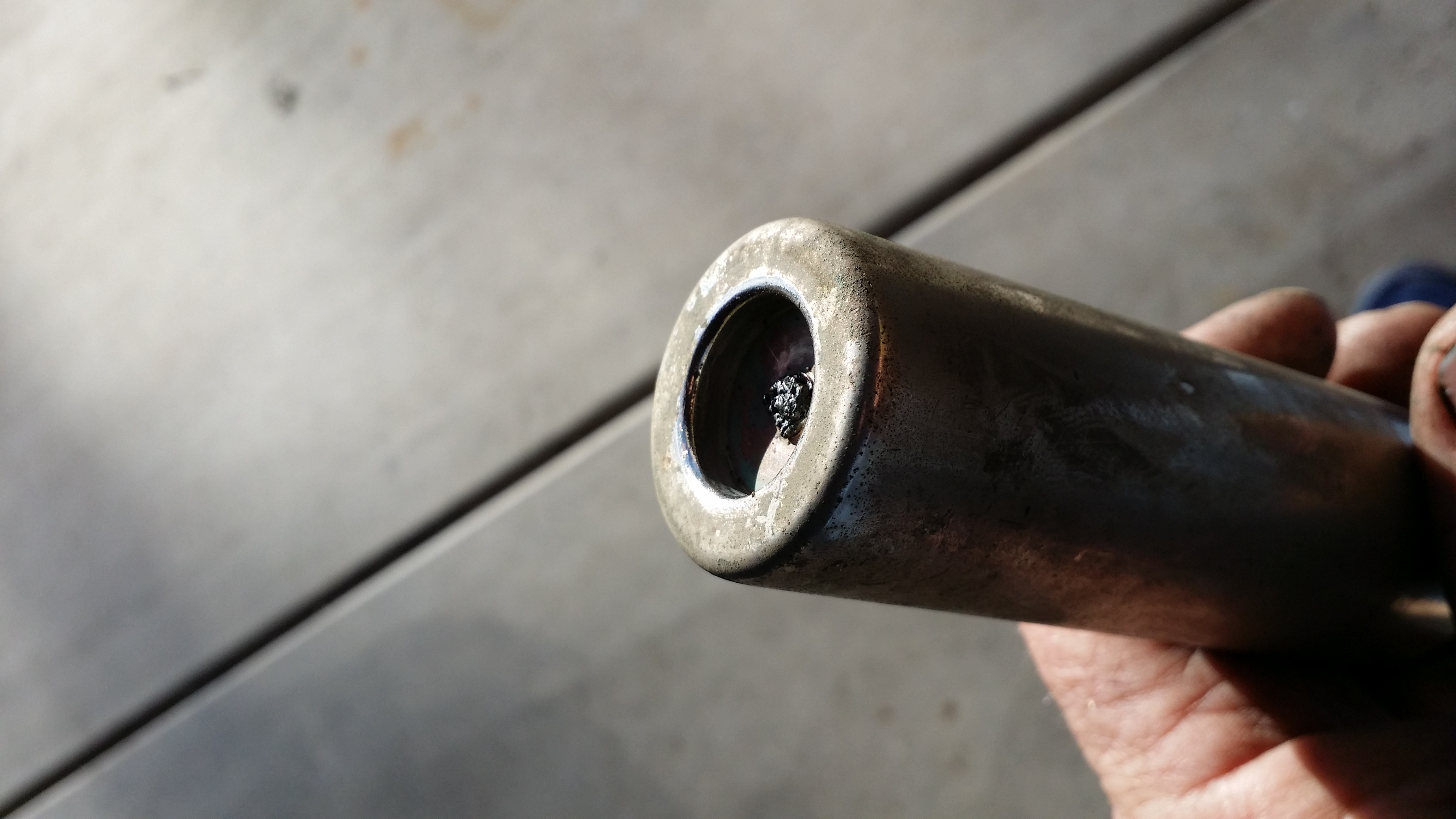

You guys are all starting from the wrong end. Open the top by removing the vent plug, & remove the old guts from the top.
A new stud & cap can be inserted from the top, & the cap re-installed.
I've done many of these this way over the years, & they look untouched.
John
Details. How do you remove the vent plug/cap?
Posts: 11
Threads: 4
Joined: Feb 2014
City: Ontario Canada
I use a dental pick to pry the vent cap off. Then use a dremmel burr to enlarge the hole. Needle-nose pliers used to twist & remove the guts in pieces. I solder a new electrolyic to a brass bolt, & drill a small hole in the side of the can near the bottom for the neg. lead.
The whole works fits into the hole in the top, & then put the vent cap back on.
It takes a bit of time, but the results are worth it.
