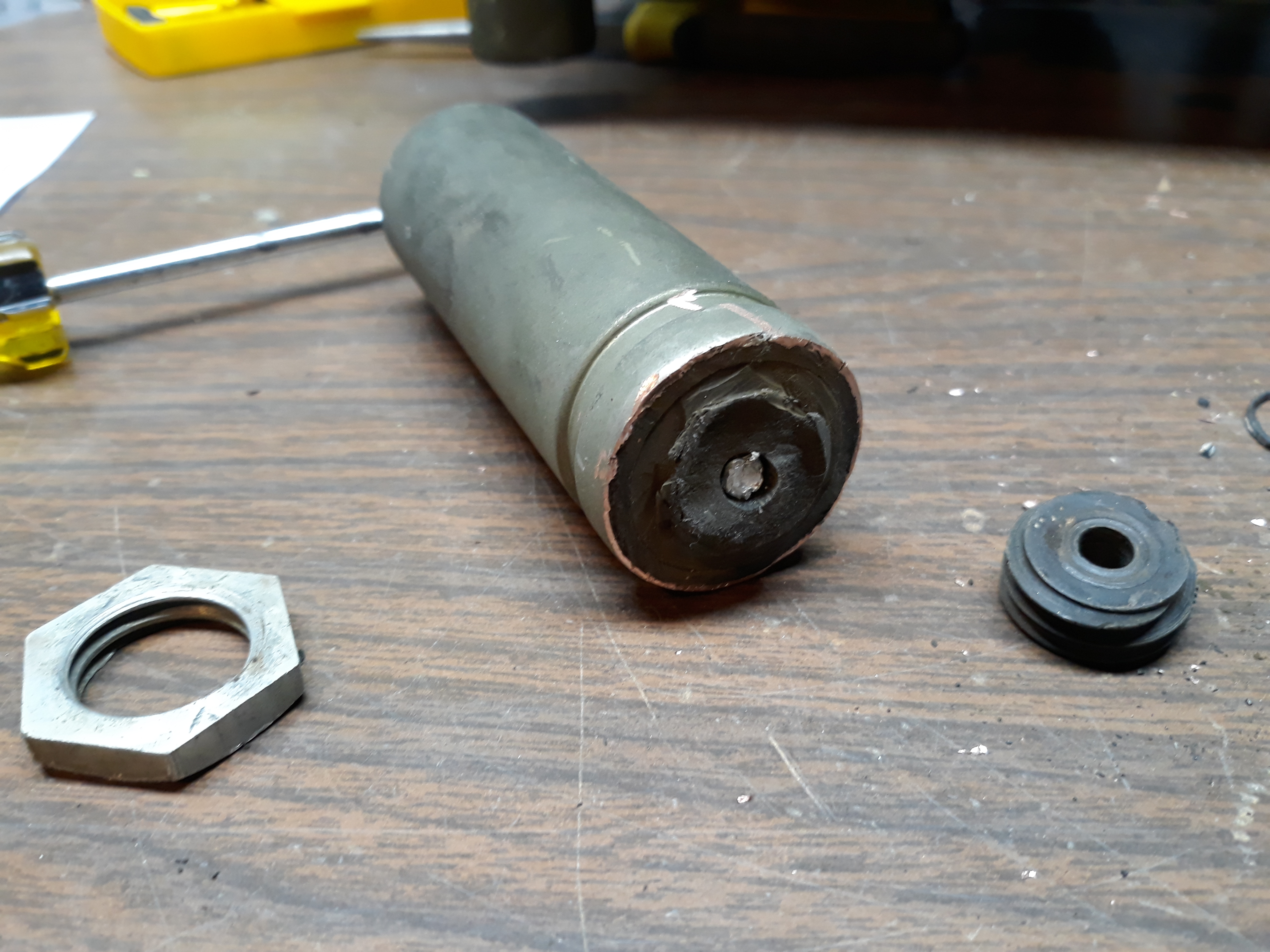

After reading this thread as well as this thread, I thought I would try my luck at opening up one of those nickel-plated copper Sprague electrolytics by grinding the lip off the end and wiggling the Bakelite base out.
Only, just my luck, it did not go so well.
As you can see, the Bakelite base broke at the threads.
Suggestions welcome. I'm tempted to just cut the D**n things at the top of the narrow part, restuff, then slip the top over the narrow part. It won't look original but it should work. Thoughts?

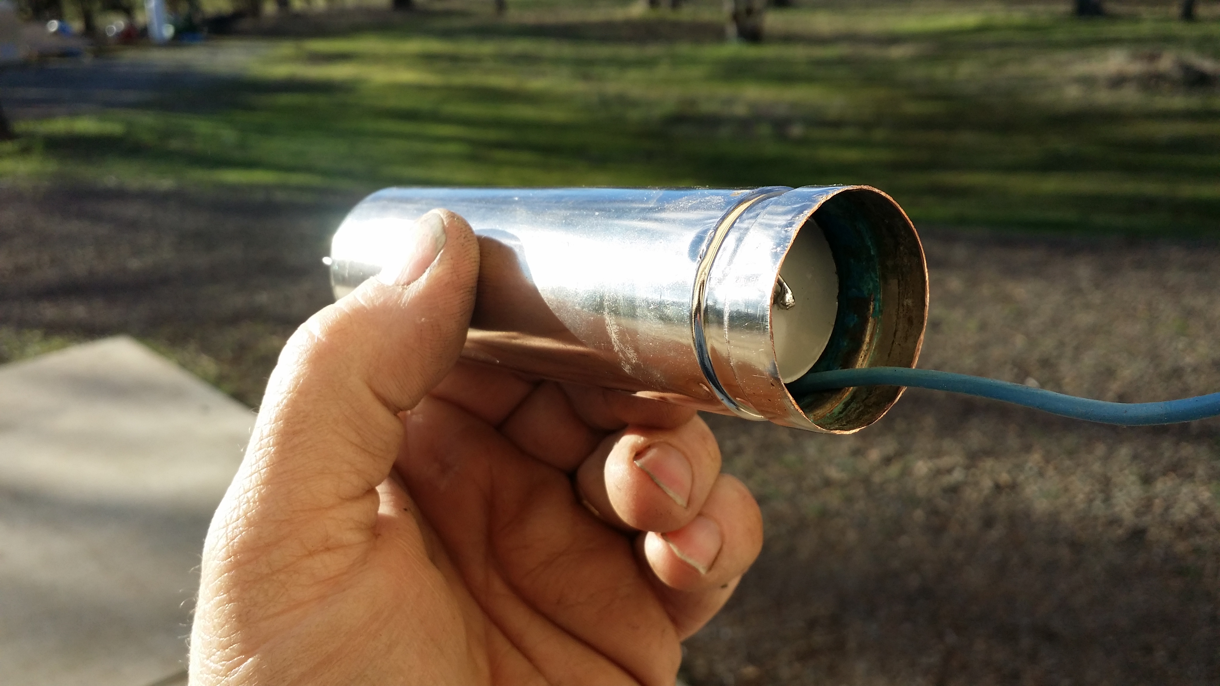

that Bakelite can be in there a bit tight. I've done a couple of these and 4 Mershons that are assembled the same way. I use a belt sander to take the lip off. I've found that you need to go a bit farther than what it appears that you did. I think I can see a tiny bit of crimp left holding the Bakelite in tight. Then, I put the nut on the threads and gently tighten it and even have put another nut on to give as much support to the Bakelite threads as possible. I'm trying to distribute the forces of rocking and twisting the Bakelite plug away from the thread part and onto the plug itself. A couple of them that I did took a lot of gentle working to break the corrosion before the plug came loose. Once the plug is out, I drill a small hole through the Bakelite right next to the stud for the positive lead and another farther out for the negative. I sand the edge of the plug so that the plug will seat farther into the can up to the narrow crimp section. This allows me to roll the sanded edge of the can to re-crimp the plug. Where the negative wire comes out, I indent the can slightly to accommodate the negative wire which is then soldered to the negative terminal ring. I'll also solder the wire to the can with a tiny solder connection.
A couple of pics here: https://philcoradio.com/phorum/showthread.php?tid=19313 You can see the edge of the plug I sanded to allow the plug to seat deeper in the can. You can also see the edge of the can rolled in slightly to hold the plug.

Possibly, you can glue the broken bakelite back together with JB weld or I've found "super glue" works great on bakelite. Clean up the lip some (emery cloth)....it looks like there is some material left, preventing the base from coming out. Might try some WD-40 around the junction of bakelite and copper.
I'm just guessing......good luck.

The way I did them can be seen here: https://philcoradio.com/phorum/showthrea...#pid111855
Similar to rfeenstra's description. The first one I did, the bakelite came right out of the cylinder. The second was more stubborn and took some rocking back and forth. I think it would be very easy to have the bakelite fail as it did in your case. Yes I agree, it looks like the lip still needs some grinding..its a PITA but a dremel tool helps. I'm not sure what to do at this point to get a grip on the bakelite. You might try drilling two holes on either side of the center hole and thread in a machine screw in each to give yourself something to grab??

I read over everyone's efforts (other than Mike's) prior to attempting this myself. I even linked to two, including Bob's, in my original post.
I was grinding into the Bakelite when I stopped grinding. So you say I need to go further? Wow...
I may just try Mike's method instead - it looks a lot easier.

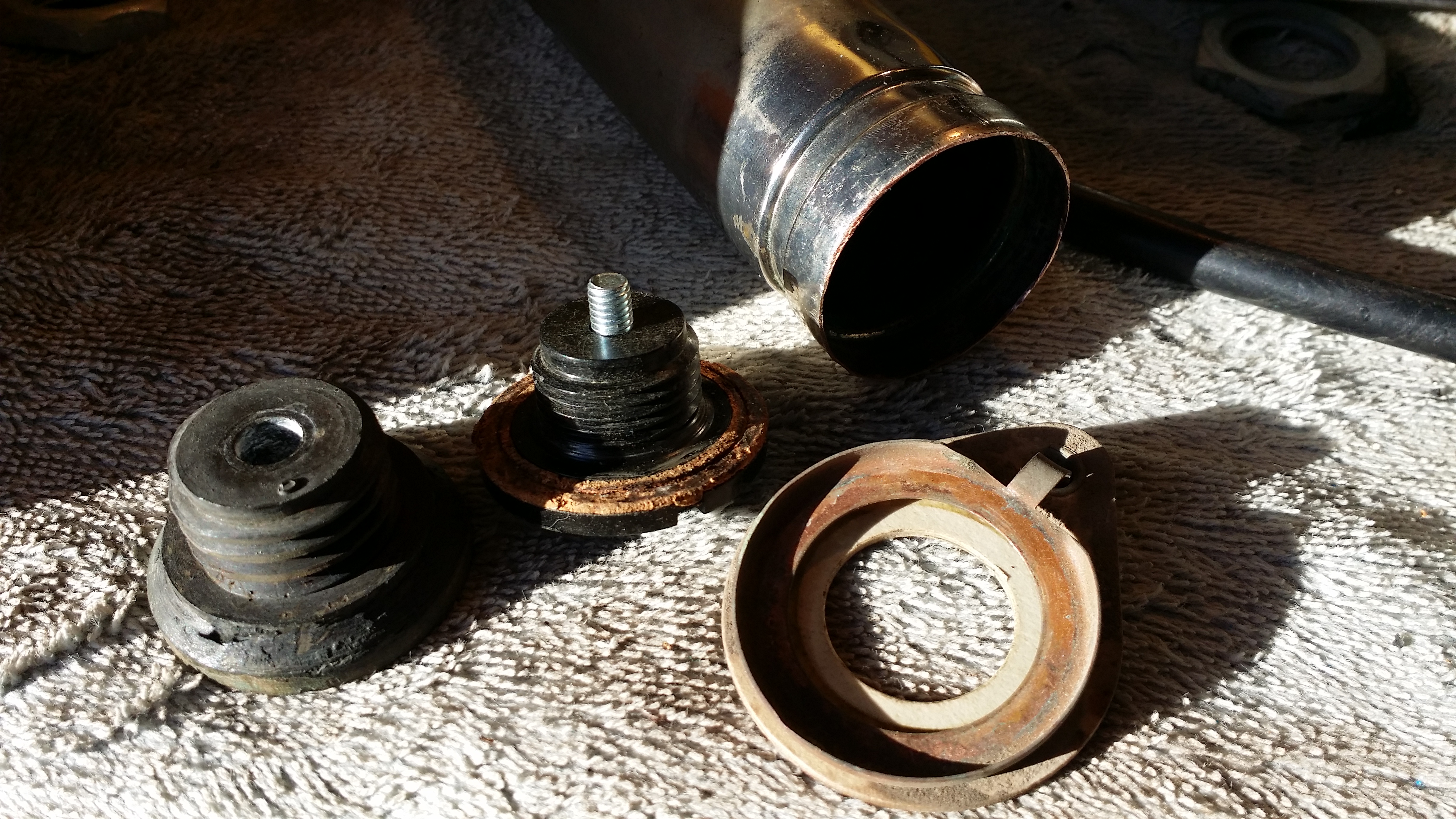

Ron, I have done many of the Spragues the way you are doing them. It is not my preferred method, but in the case pictured below, I also wanted to change the coarse thread base to a finer thread. So removal of the plastic base was necessary .
My preferred method is to cut the body of the cap at the pinch and then resolder the parts together, followed by replating. I know that I am the only one that would do this, but it also resolves the issue with strength. See, I like to use those caps as grab points or I just set the chassis down on them. This will often pull the can off of the base. For me, even with replating, this is easier.
I think that I already posted some pictures of the second method - - somewhere.

With nothing to lose, I'll try grinding the end of this can a little more and then see if I can remove the remnant of the base.
