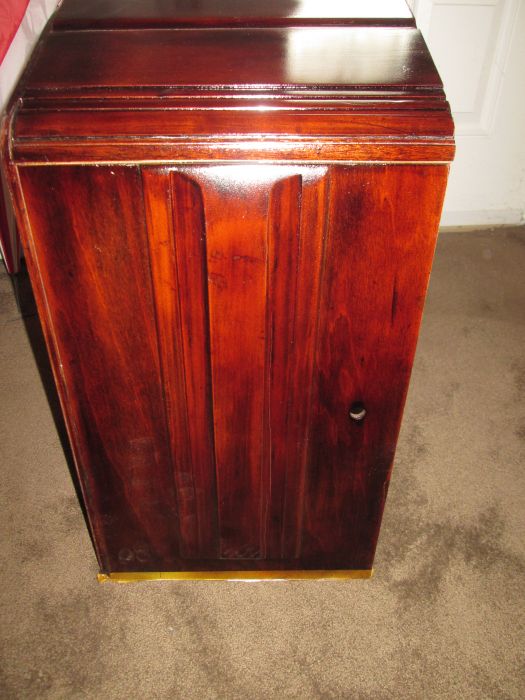

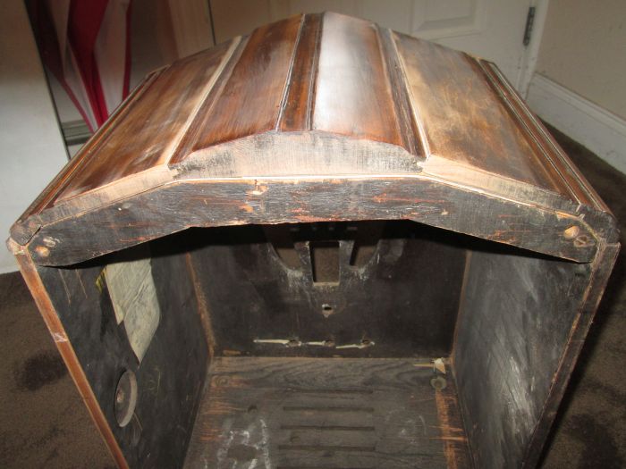

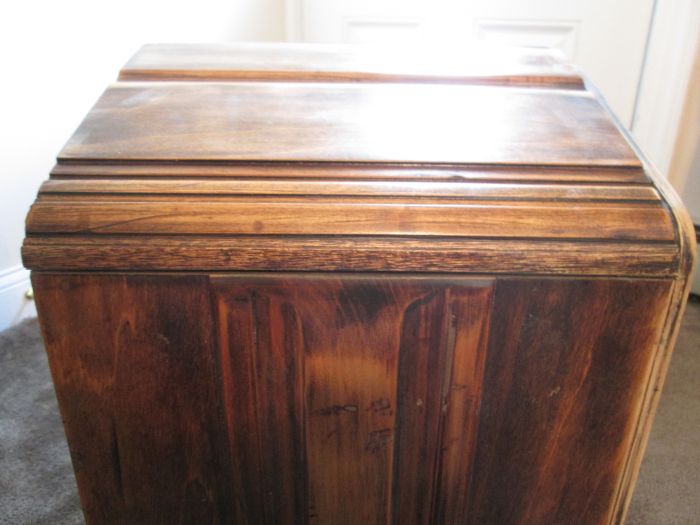

So Have been busy sanding and stripping the cabinet. I think the cabinet had been stained whatever was on the didn't really come off much but was able to give it a rub down in mek and then sand. The edge of the repair piece need a little adjustment, the edge had a bit of an overhang but some 60G paper and a sanding block made quick work of that and it's difficult to tell from the other side. Resanded w/320G to sand out fine scratches. Will spray the lt side and top tonight and glue sometime later this week.

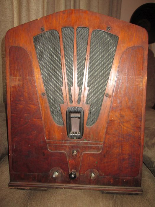

Was wondering what grille cloth to use? It has chevron patterned cloth in it now but not sure if it's correct.
The 16B cabinet's top is back together.

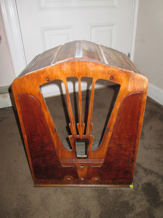

The Philco 16B2 has a hole thru the front panel (for a tuning shaft) but it has a nice worn patina. It has a decal from Sherman Clay & Co. It was a west coast based (SF) piano company starting out in the 1870. During the '30s they supplemented there sales by offering radios. Have seen a picture of their showroom w/ a display of late '20s /early '30s RCA sets.  As time marched on they branch to a number of stores throughout the US. By 2013 the company is owned by Sherman Clay Group a diverse company involved in real estate management and consumer finance. Anyway I digress...
I'm thinking I might try adding some lacquer over the panel to see if I can save the patina. I'll start another thread on this set after I get number one done.

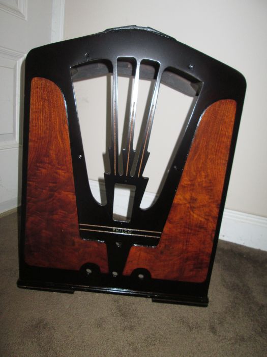

It's getting DDDDAAAAARRRRRKKKKKKEEEEEERRRRRRR!
BUT I'm not sure that I'm crazy about it... There are many imperfections in the wood some from the original manufacture and others from 86yrs of being uses and abuse. I thinking a sanding and a coat (or two) of grain filler are in order(bah humbug!!) for the front and sides. The top is passable.
I have been using Mohawk extra dark walnut toner but it very red where the original is more yellow/brown. Going to give the van dyke brown a try on paper it seems to be a little more yellow.
Still a vast improvement over what I started with

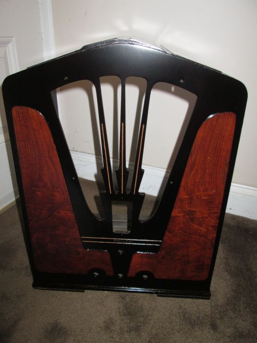

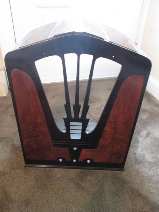

Front panel is done. Still have double check the top and sides before spraying the clear coat. The dark almost looks black but after removing the dial escutcheon from the 2nd cabinet it's really dark under there. I started with extra dark walnut but it looked (to me ) too red. I switch over the van dyke and that's what's you are seeing. Woodworking for me is an exersize in patience. Gluing, grain filling, and lacquering don't necessarily abide to a speed limit other than SLOW. Here's a B4 & After:

Looking very nice Terry!
Icon_clap Icon_clap
Tnx!

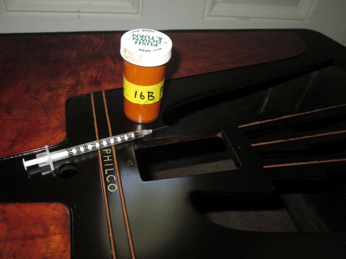

I was reading over on ARF abt a fella that bought a 16B and had refinished it neglecting to paint the pinstripes. I mention it and LarryAD had a clever way the color them. I would have used a teeny art brush and made a mess of it. Using syringe works great!
https://antiqueradios.com/forums/viewtop...1&t=376926
Sam the original poster lives near the Mohawk factory and offers to make available their products at cost + actual shipping. This is noted in a post in this thread.
After matching the color to the other cabinet it ended up being a brownish color.

The chevron cloth is correct...and it appears yours uses the green chevron, which unfortunately isn't reproduced anymore. I have a couple 16 sets that use the green; the rest have the "gold" chevron.
Tnx for your input Brad,
I saw online a bunch of different cloths being used most of which I knew were not anything close to the original. I think this one maybe original but it's not being reproduced. http://www.tuberadioland.com/images/philco16b_i_7.jpg  The dark one in my set is a replacement but I'm going to tighten it up a little and use it. Have some of the later chevron style use in the '36 and '37 or so models. Neither the dark or the newer style are a dead on match.
