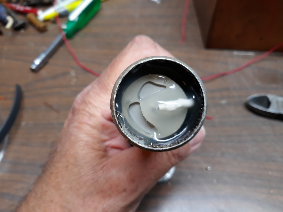

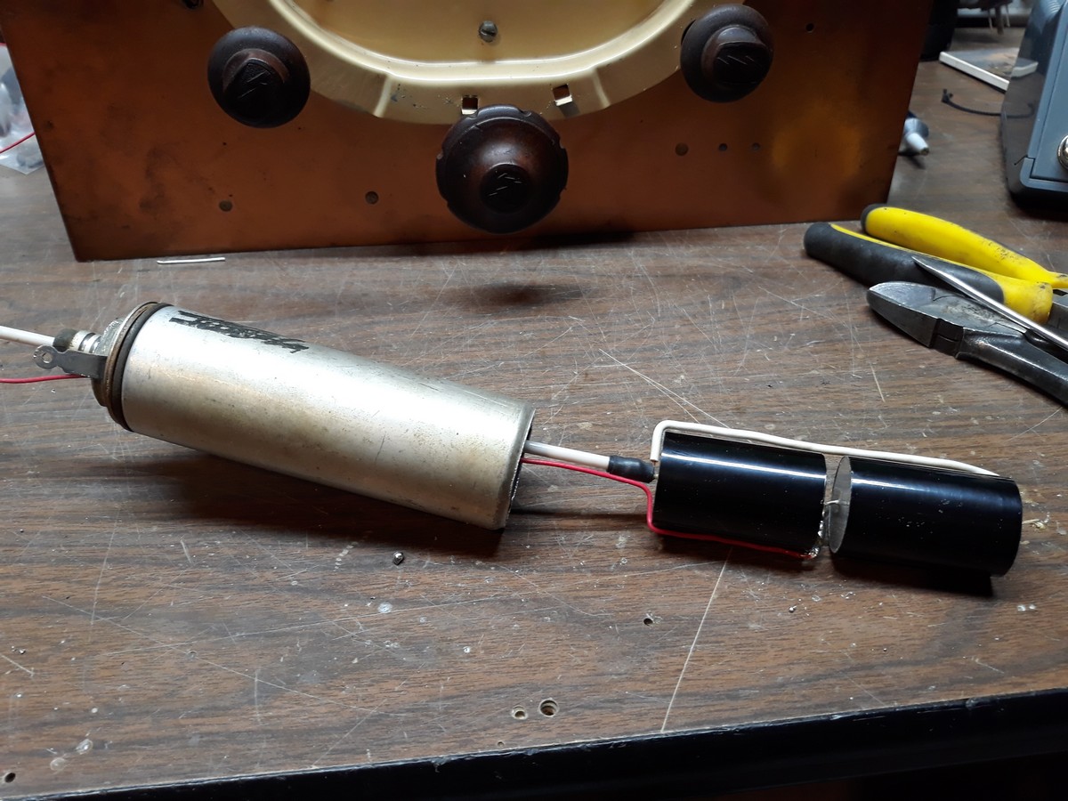

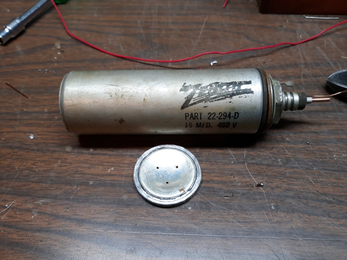

I opened up the 16 uF wet electrolytic can, cleaned it out, and installed two Solen 8.2 uF caps in parallel which will equal 16.4 uF:
Next, I stuffed everything into the can:

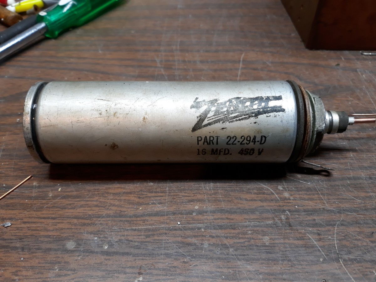

Finally, I glued the top back onto the can with J-B Weld.
Now this restuffed electrolytic is ready for reinstallation into the chassis.

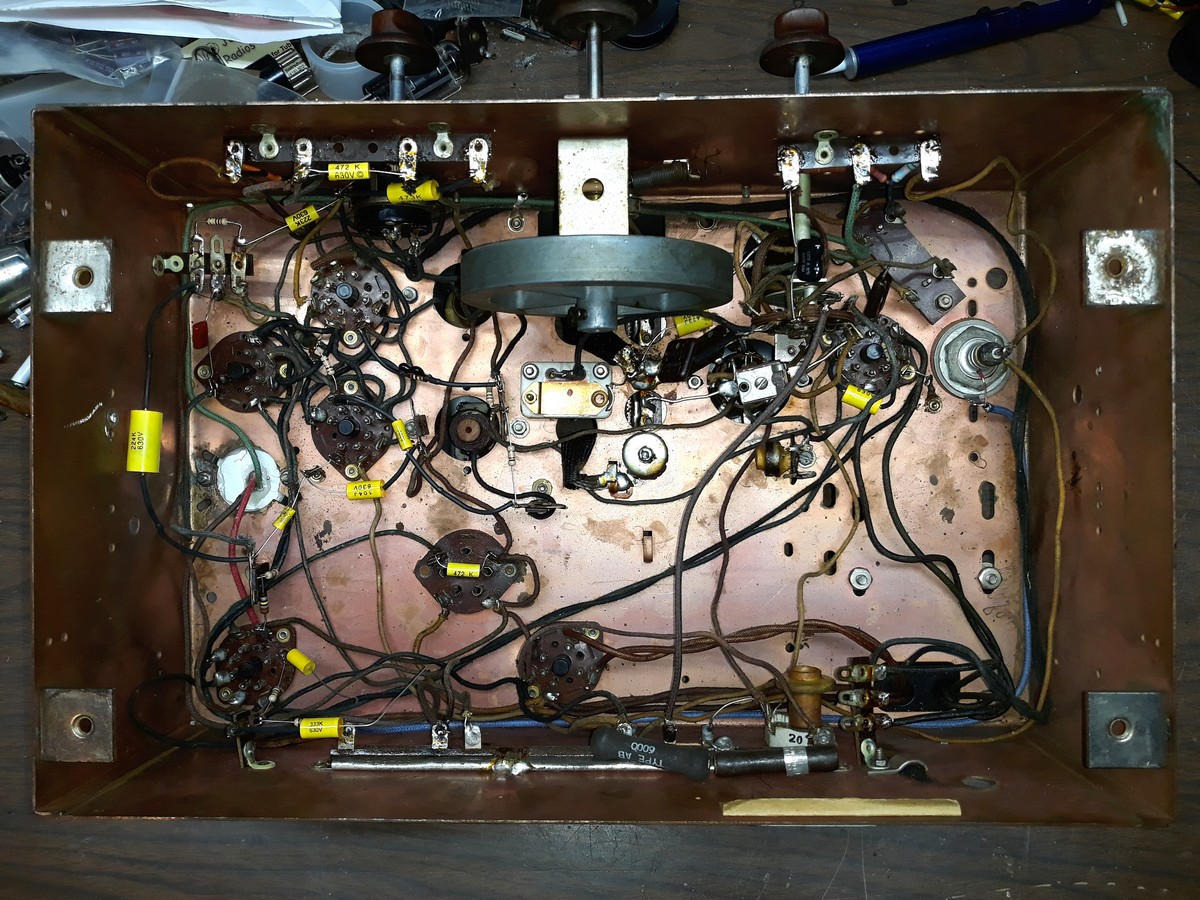

And here is how the underside of the chassis looks at present:
The resuffed electrolytics are installed and (mostly) hooked up. I say "mostly" because one wire from the combination 10 uF / 2 uF can connects to the Candohm, and I have yet to replace the Candohm with new resistors, solder terminals and a strip of aluminum. That is a job I hope to accomplish this weekend, along with replacing a wire coming out of the top of one of the IF transformers and connecting to the grid cap of the 6K7G IF tube. That, along with a replacement power cord, some misc. odds and ends, and reassembly of the dial with new dial lamps, and this Zenith should soon be ready to try out!

is this hotglue I see you put on top the Solen cap?
If yes, when I pot film caps (they are plastic film and I do not know how they react to hot glue if applied straight on) I put a cut to size fitting piece of thin cardboard on top. This will stabilize things without directly heating the cap.
It's the same as when restuffing tubulars with film caps, when we put some wad material before potting the leads (depending on the space left I either roll a strip into a spiral and then put in if there is space, or cut a circle, poke a hole and slide it down the wire if there is little space left). This way even i some hot glue makes it down to teh cap, it is little and will cool fast without potentially harming the cap inside.

The top of this assembly is a positive lead, as is the bottom - the middle is negative as the caps are connected in parallel to add up to 16.4 uF. A Solen 18 uF 630V cap is too large to fit in these aluminum can electrolytics. So I wanted to make sure the top lead did not make contact with the top of the aluminum can. The hot glue serves as an insulator (along with heat shrink tubing) to accomplish that.
A noble cause indeed Icon_lol

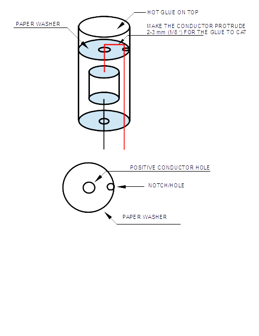

Here's how I see it:
1. Cut  a circular piece of dense paper (backing from a sticky notepad etc) diameter of the can. Should fit in the can snug and definitely be larger than the cap itself.
2. Make a hole in it for the top cap's conductor to go through before you bend it and route it down the can to the positive pin. You could cut a little notch in the cardboard circle for that wire to easily go where it should without having to bend the cardboard. Make the conductor protrude a bit through the center hole in the washer so the hot glue catches on it and thus stabilizes the cap a bit. It is not the kind of assembly that is subject to vibration so you do not have to be overzealous with the stabilizing. Just so it doesn't bend due to gravity back and forth.
3. After assembling everything put hot glue on top.

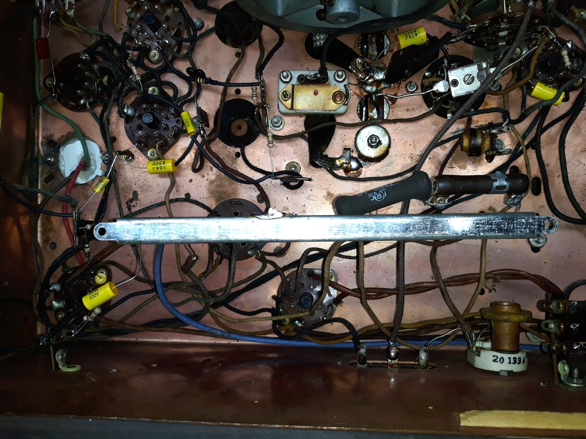

I also took the time to remove the two rivets holding the Candohm in place. Most of the wires are still attached to it. It has so many terminals that I intentionally left it this way to (hopefully) make it easier to know which wire goes where on the new assembly and to reduce the possibility of errors in wiring up the new assembly.
Tomorrow afternoon...hopefully...the installation of new resistors to replace the Candohm begins.

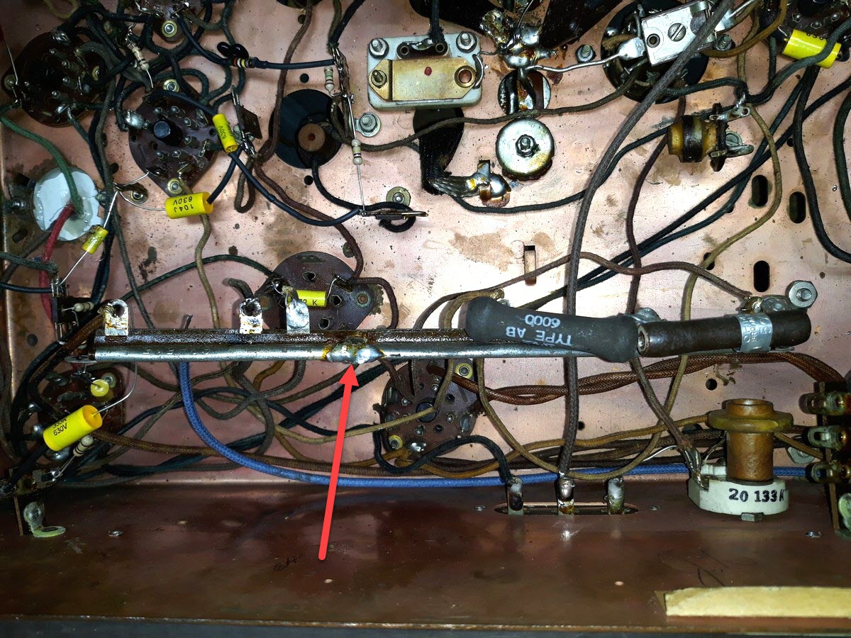

Here's what I started with - remember, in a previous post I said that I had removed the rivets holding this in place on the back of the chassis:
There was one terminal which was grounded to the chassis, as you can see where the arrow is pointing to the solder blob above. The trouble is, the solder did not stick to the chassis as the Candohm came off when I removed the rivets, and the solder blob did not hold the Candohm in place.

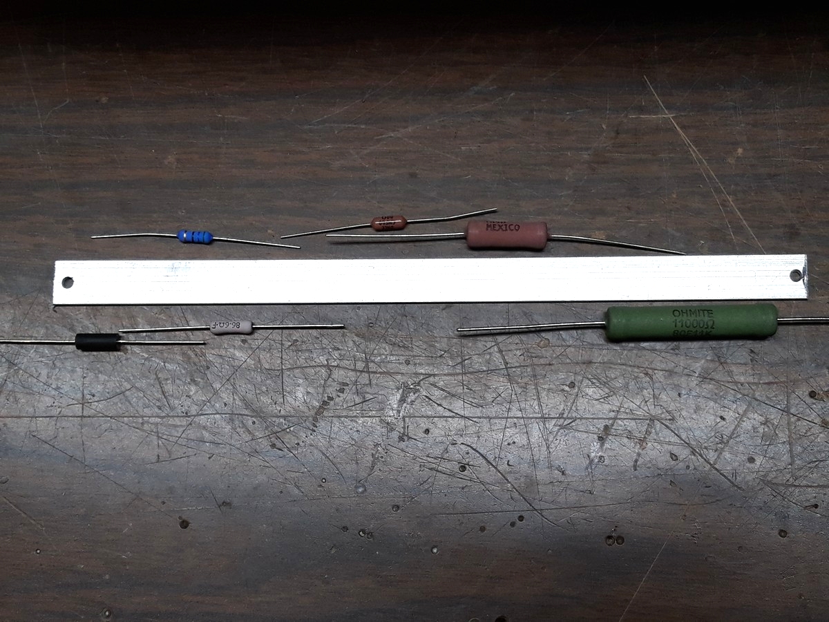

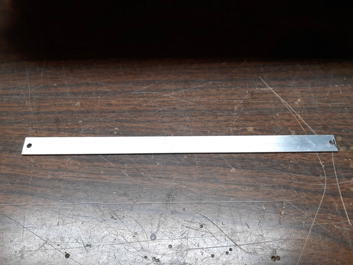

I carefully measured the total length of the Candohm - 8-1/4 inches. I then cut a piece of flat aluminum to this length.

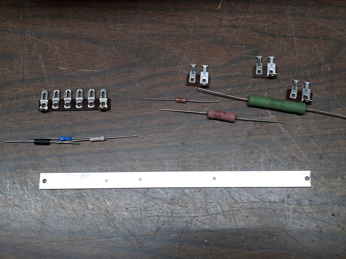

Next, I laid out the resistors which would be used to replace Candohm sections, in order to roughly determine where to place terminal strips.
Having determined that, I then marked spots where I would need to drill holes.
more...
