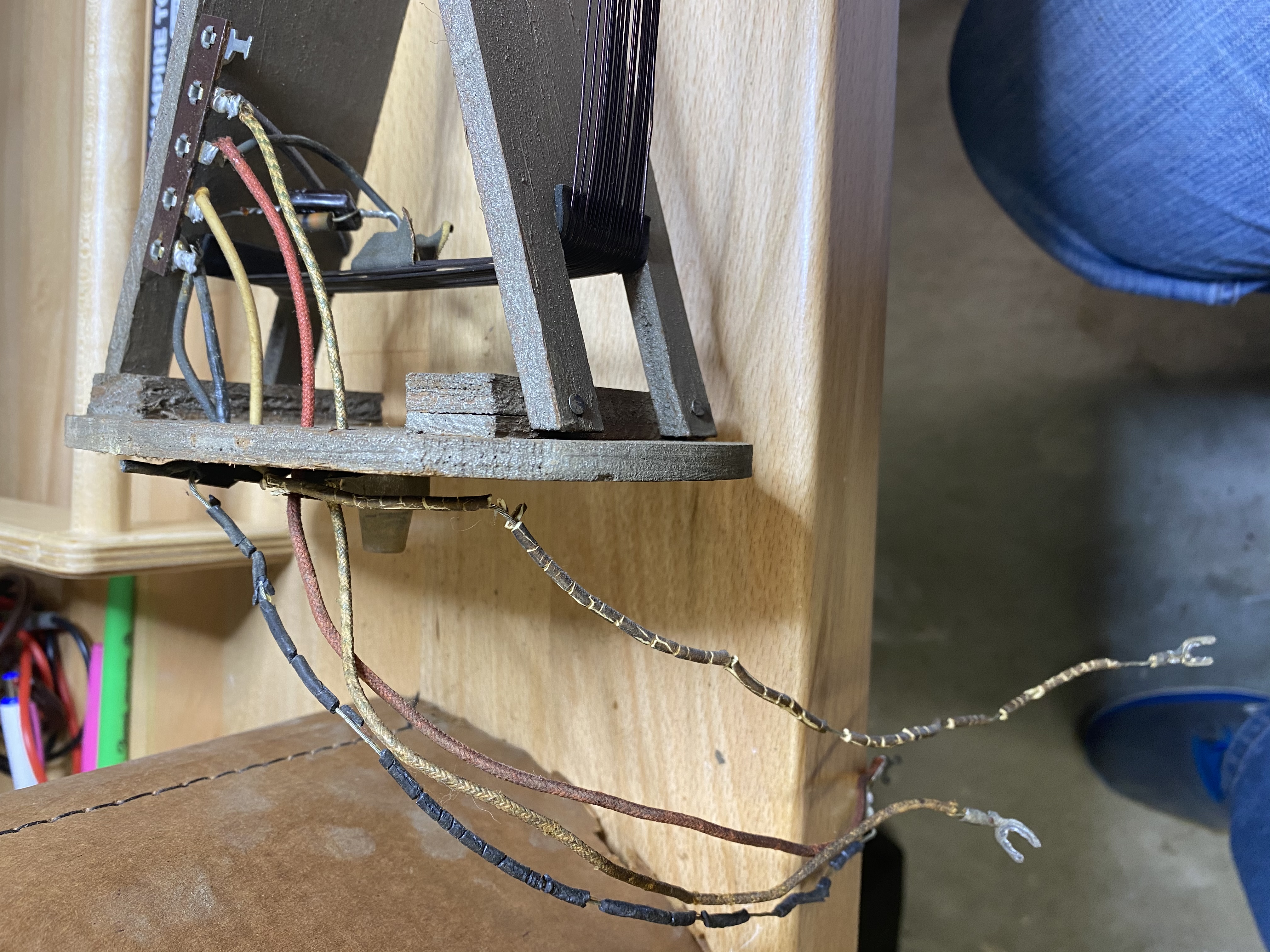

Thanks all for the feedback and info go far! All good stuff! I did get a sheet of mica fairly cheap on EBay, so going to see if I can make two new wafers from that. If not will go the plastic route if needed. I put original wafers back in for now and will cross that bridge when I get to the alignment which is still a ways out. Still waiting on my cap and wire order to arrive.

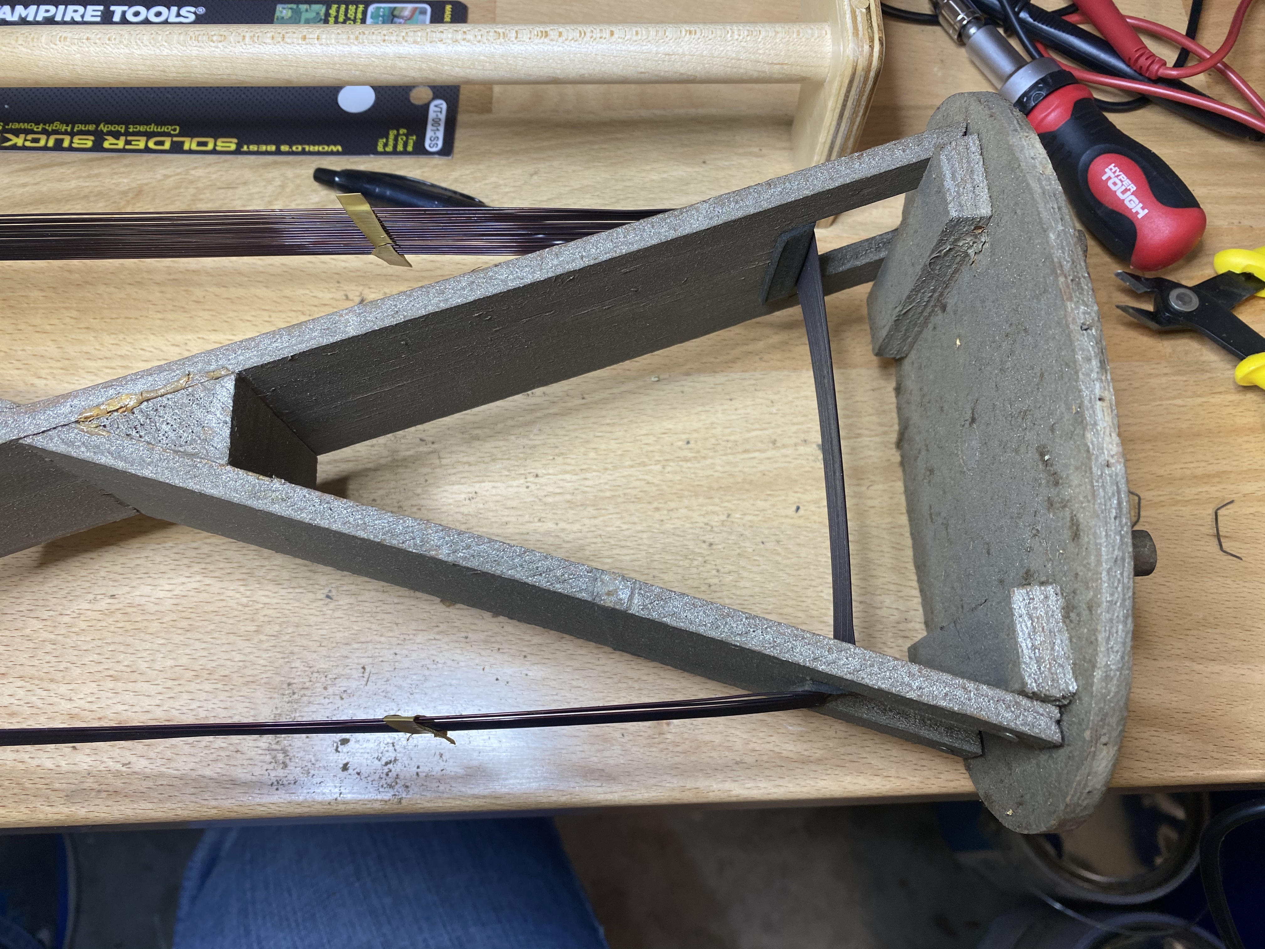

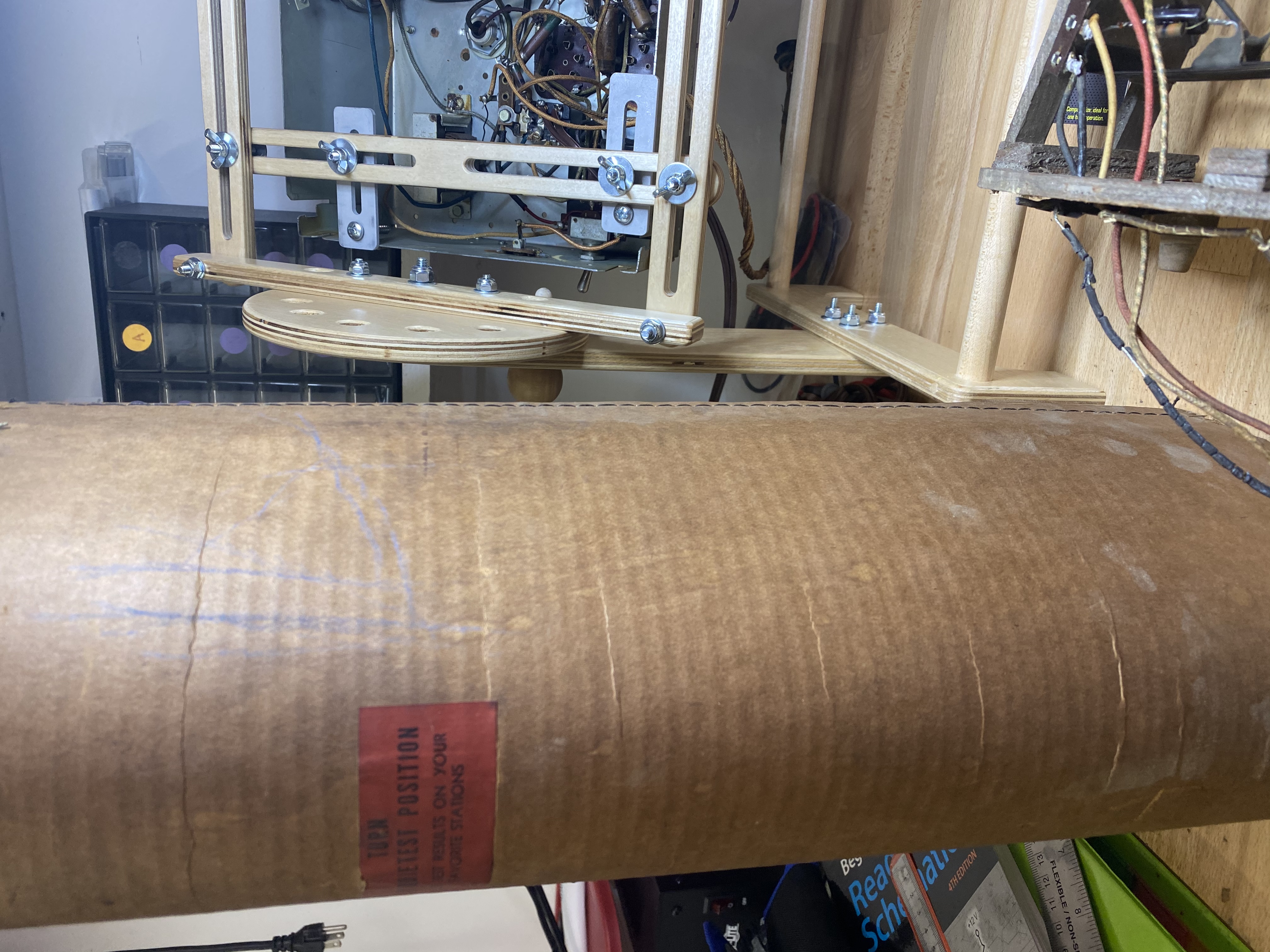

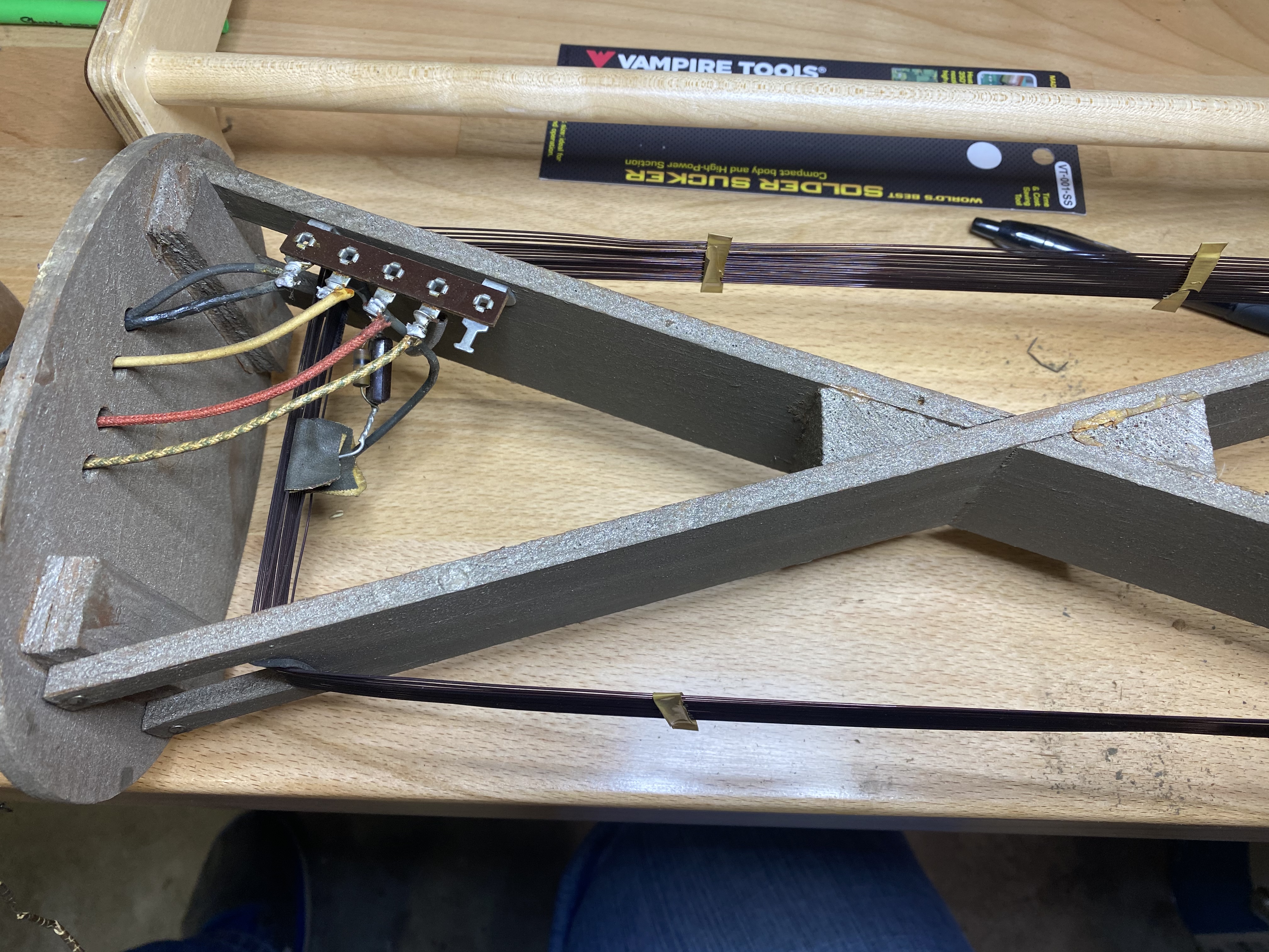

Enough with my questions, time for a progress report. I’ve checked most all resistors so far as well as coil continuity. Coils are all good so far and just a few resistors to replace. I’ve also tested all tubes and all are weak except for one which is a 7B6 which someone used at some point in place of the 7C6. Next steps are cleaning up some rust, clean the tube pins and replacing the electrolytics, wax caps, rubber wires and bad resistors. Not in any big hurry...just taking my time and enjoying the ride! Another positive note, managed to get the super aerial loop apart without destroying the cardboard cylinder. Pretty neat little apparatus if you’ve never seen the inside of a nice one. Pictures attached for your enjoyment! Cheers! Vinny Vinny Greensburg, IN "We don't care what you do...just don't electrocute yourself or burn the house down." -My Parents

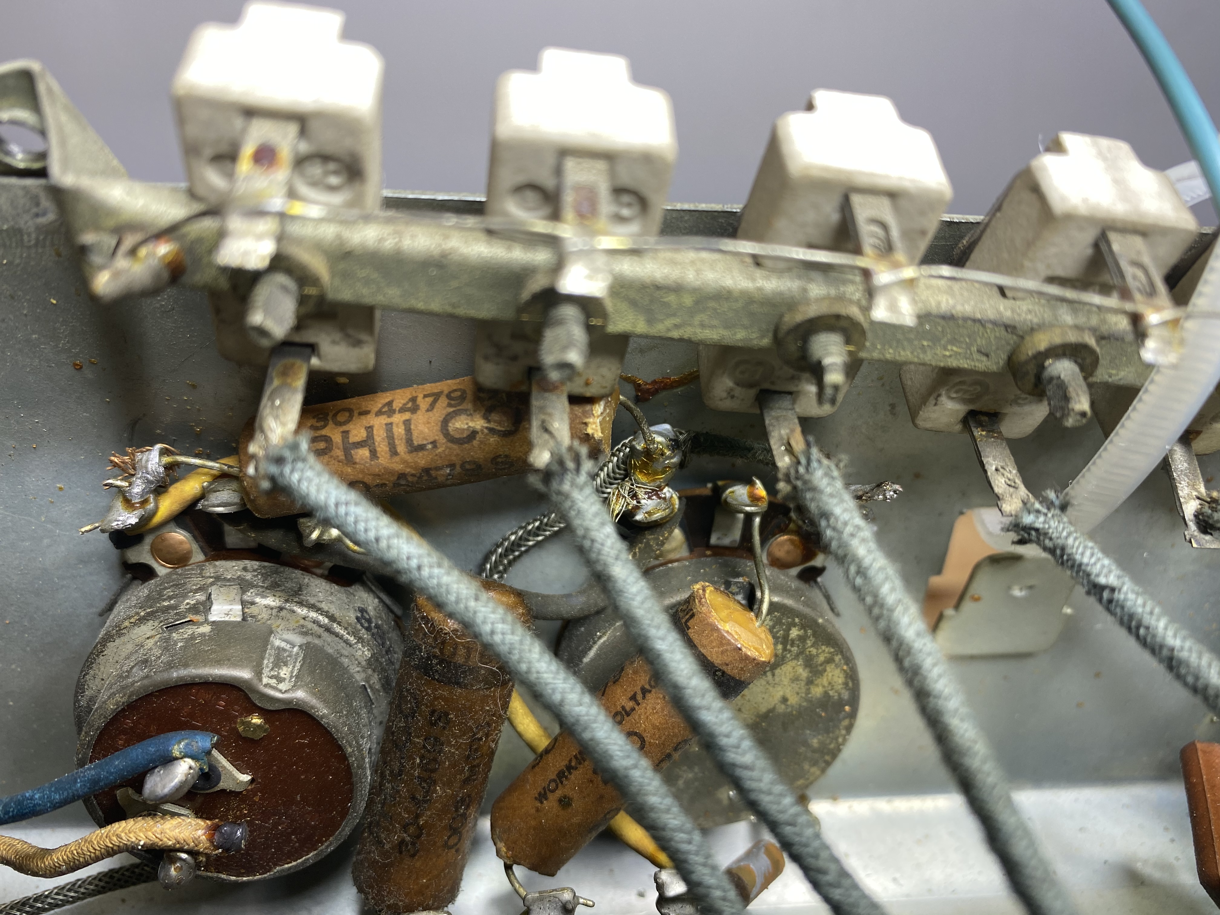

Hey All,

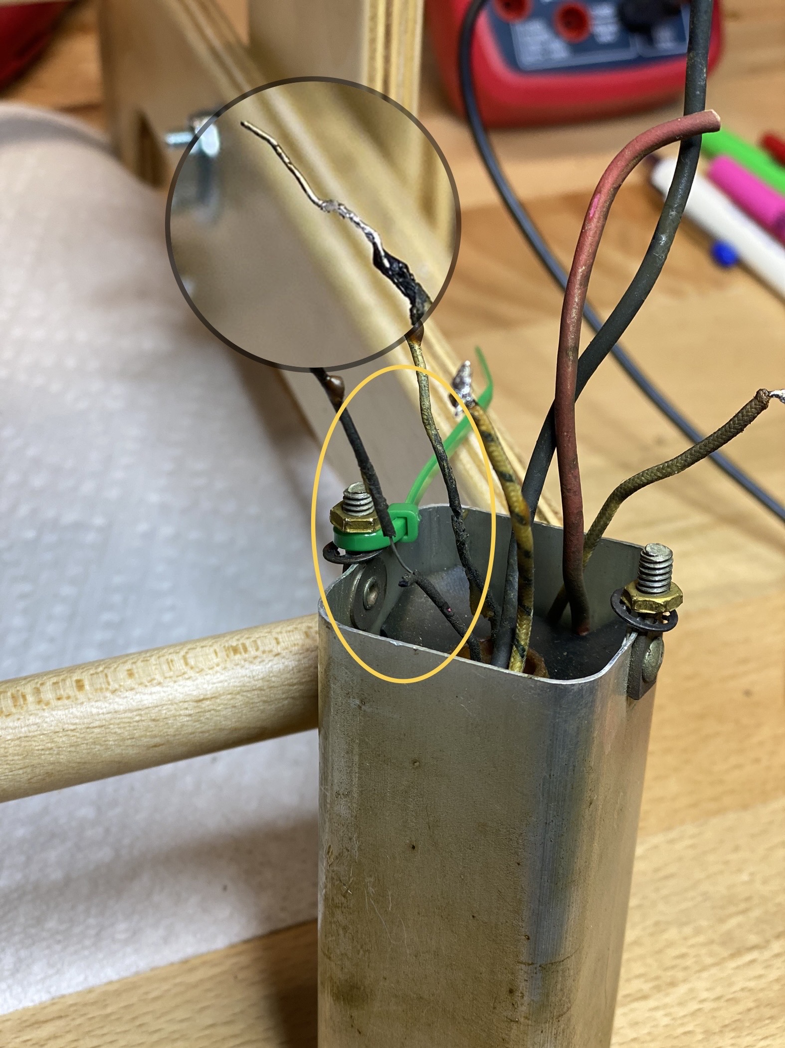

Removed the IF cans from the chassis last night and taped over tube sockets in preparation for some spot rust removal and cleaning. How have you all handled the tiny wires from the first IF can (see attached). Wire appears smaller than 22 ga, looks more like wire you’d wind a coil with but silver in color and covered in rubber insulation. I’m leaning toward just removing old insulation just to below the base of the coil and covering these with heat shrink. I’ll be replacing the red and black rubber wires with 20 ga stranded core. Also for you seasoned restorers, what have you found to be the best method for desoldering without getting the tube pins too hot? Add solder and use a solder wick and flux? Use a solder sucker? How hot do you typically keep your iron, and what is your preferred tip...pointed or small chisel? Going to snip leads and join with new leads where I can for the new caps and resistors, but have a few places where I’m definitely going to have to work on the tube pins to replace wires. Thanks in advance! Vinny Greensburg, IN "We don't care what you do...just don't electrocute yourself or burn the house down." -My Parents
02-27-2021, 02:46 PM
I mark the wires.
In this case clipping and adding new wiring, plus heatshinkables would do it. Or just use heatshinkables over the old wire. People who do not drink, do not smoke, do not eat red meat will one day feel really stupid lying there and dying from nothing.

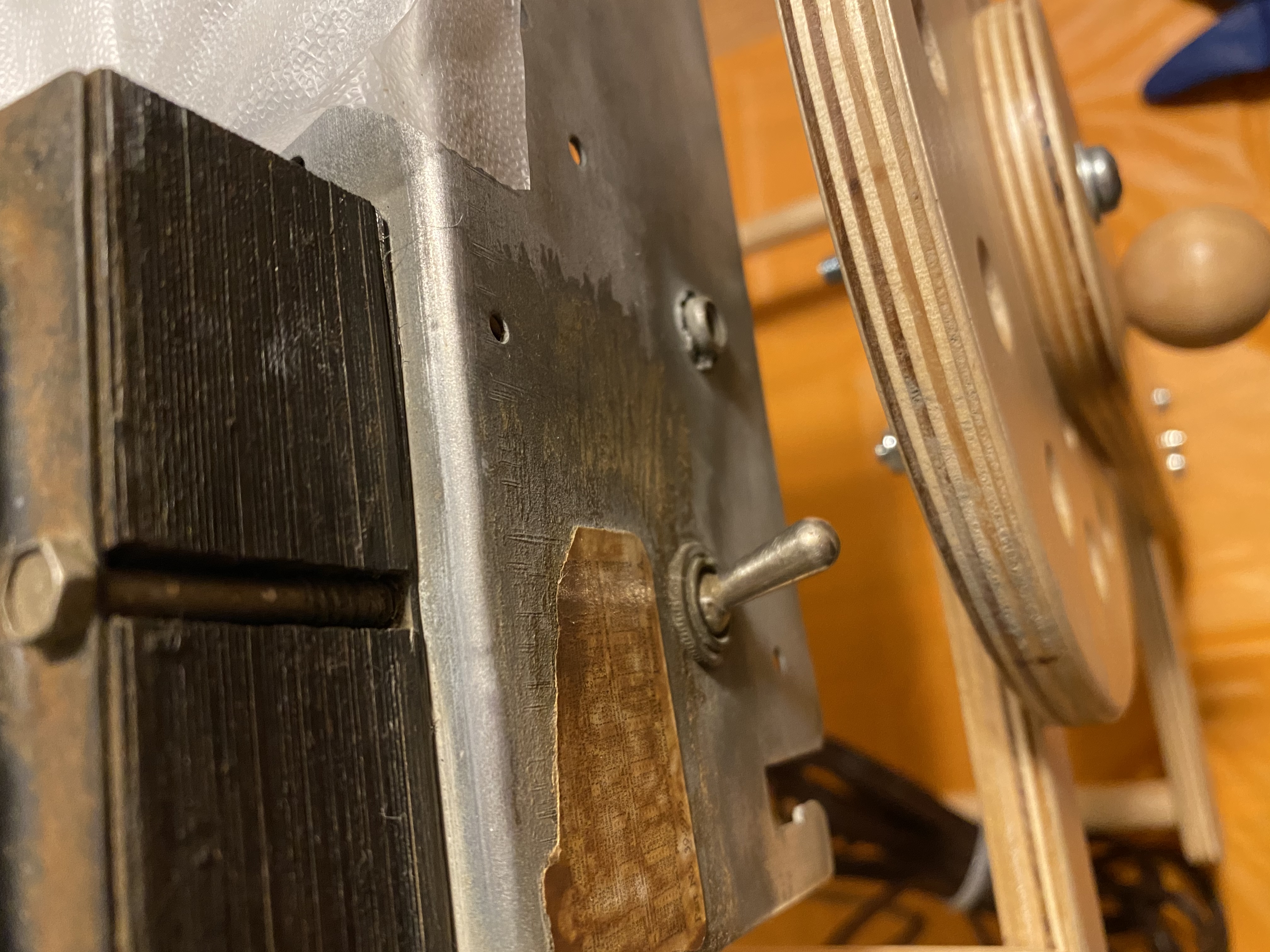

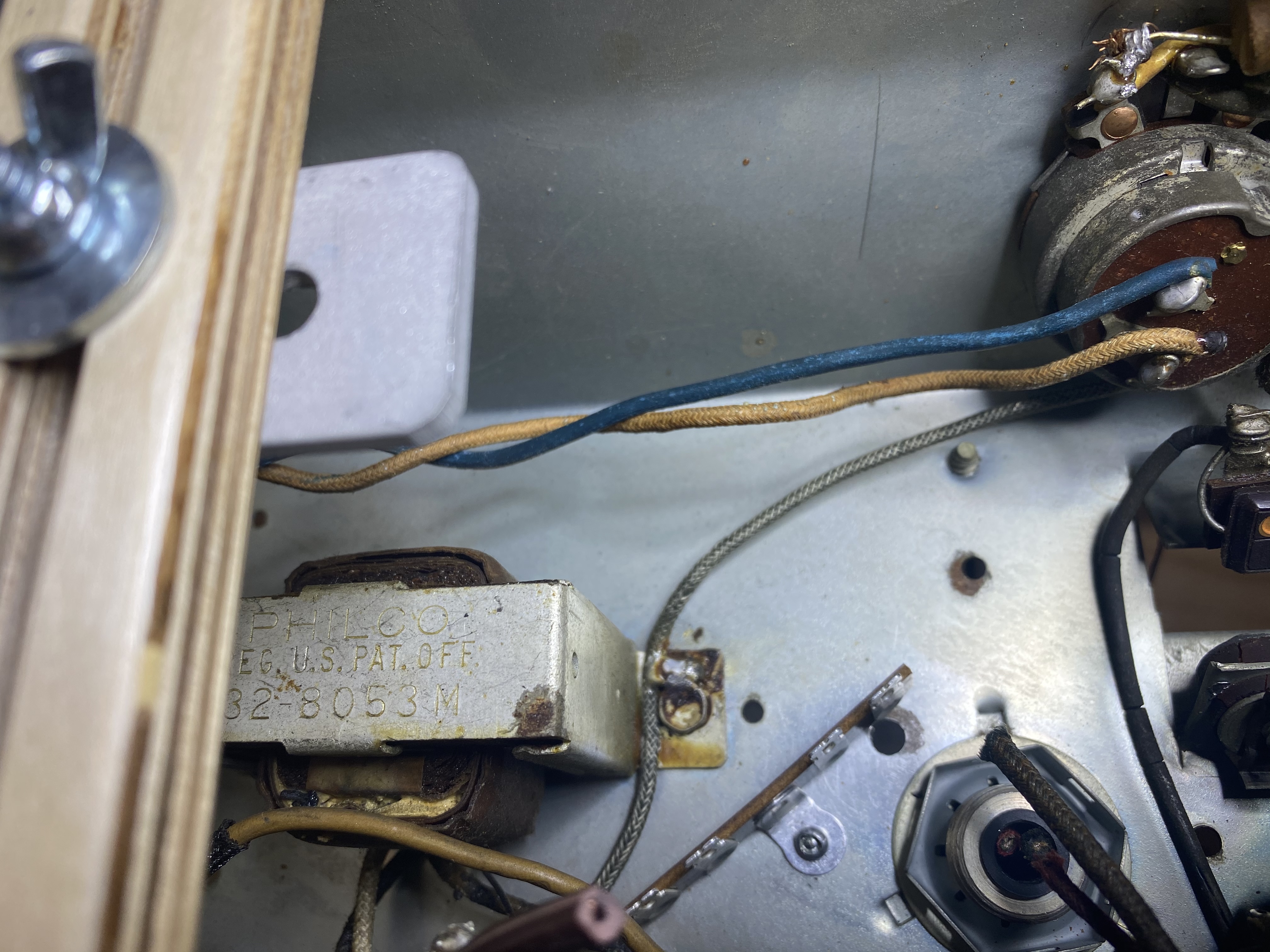

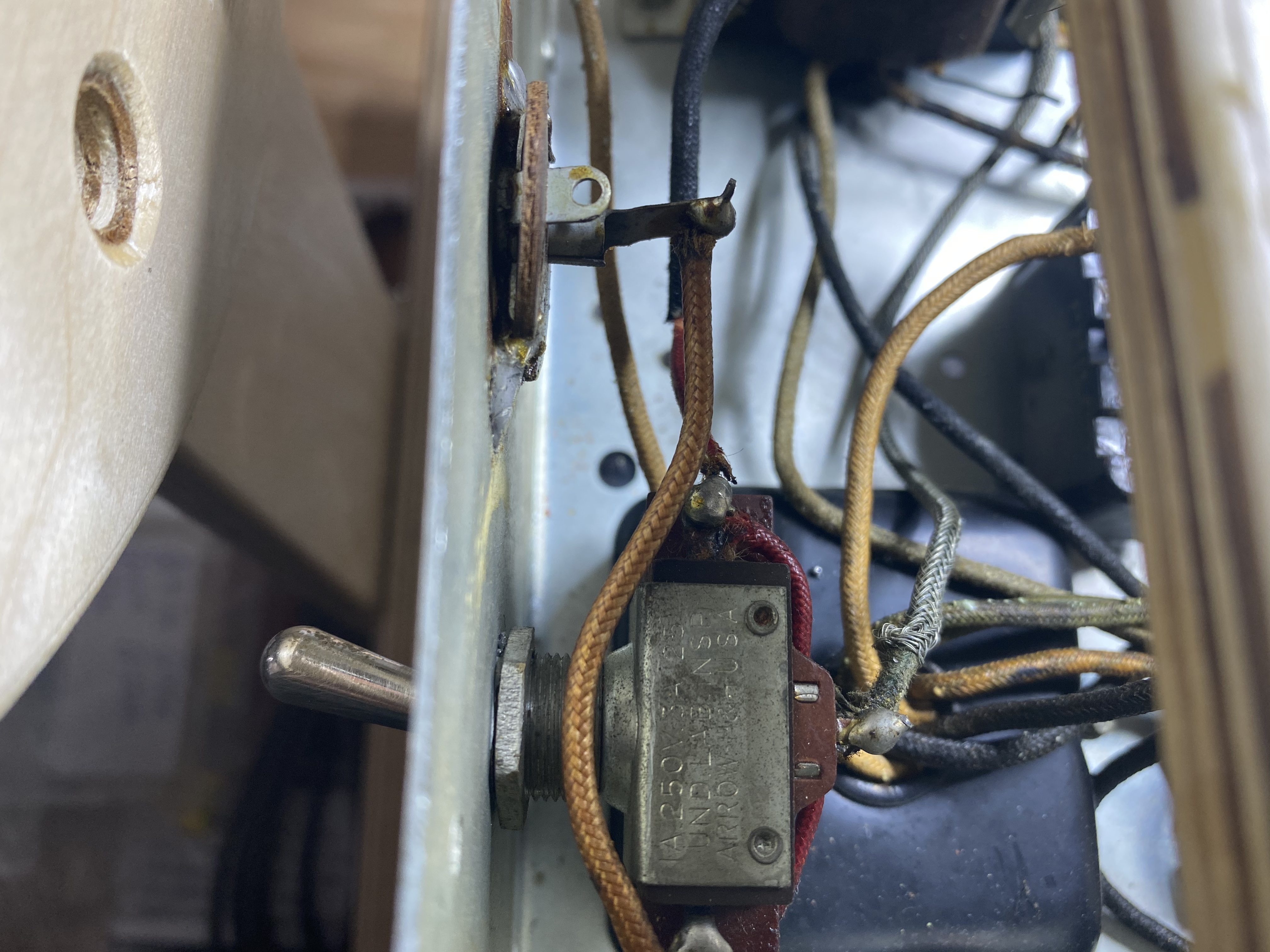

03-01-2021, 09:23 PM
Anyone ever seen this toggle switch/phono plug combo on a 40-180 chassis before? Not on the schematic, but if it was added later, whoever added it did a pretty fine job making it look like it came from factory this way. I saw something similar on another thread which makes me question if this was an option. If so I would have thought the schematic would have noted such.
03-02-2021, 05:20 AM
Nah Philco was busy selling the RP series of wireless phonos. You won't find any prewar sets with a factory phono input. https://www.google.com/search?q=Philco+r...6y1sIIGkkM
When my pals were reading comic books I was down in the basement in my dad's workshop. Perusing his Sam's Photofoacts Vol 1-50 admiring the old set and trying to figure out what all those squiggly meant. Circa 1966 Now I think I've got it! Terry
03-03-2021, 02:45 PM

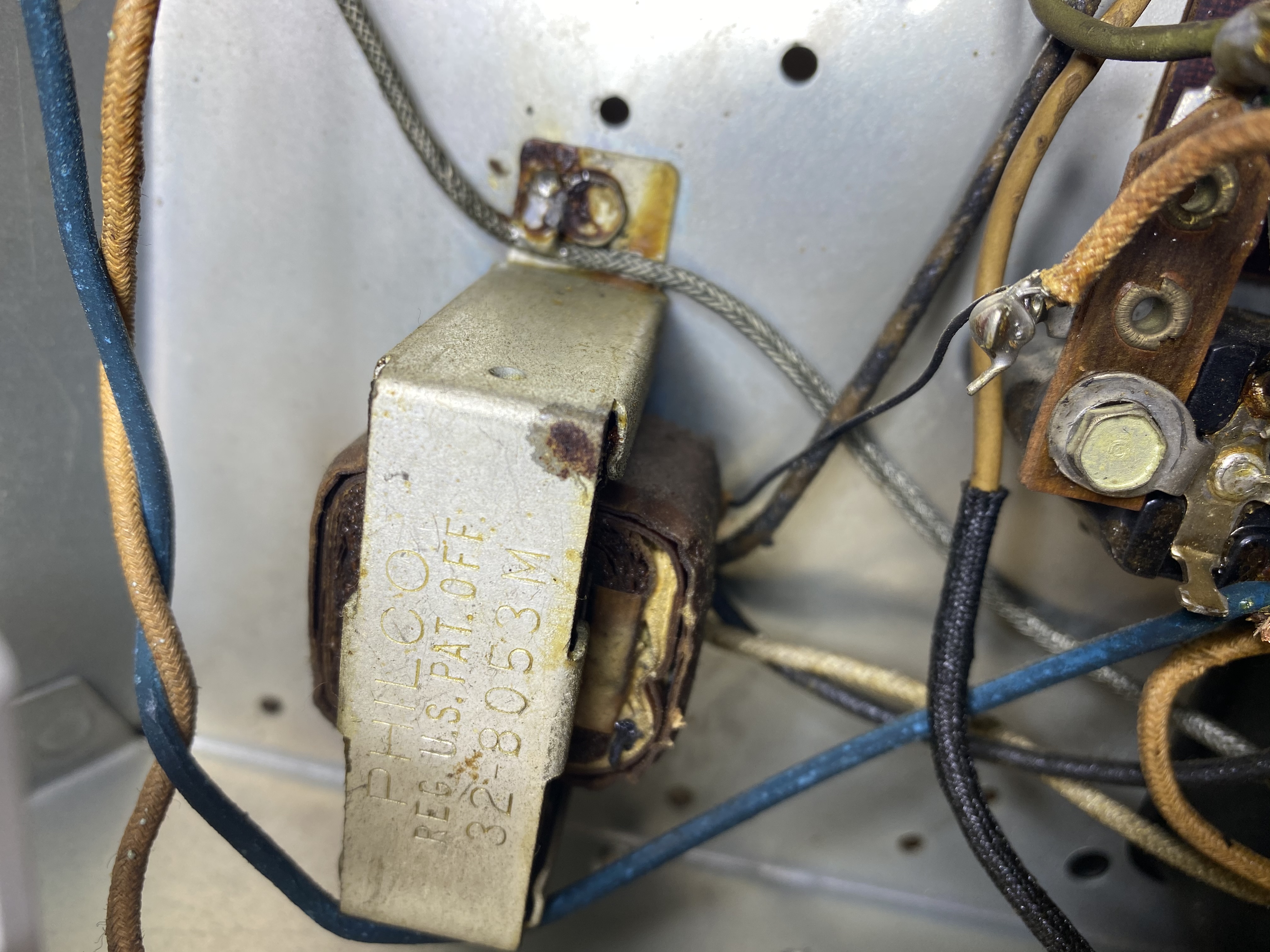

Terry,
Thanks for the note! I assumed this was an “after market” add. As I do the rewire, I plan to remove this and take it back to how it would have been originally. With that being said, do you happen to know where the volume control connects to chassis ground? Currently, the shield of the wire from the toggle switch is being used to connect the control to ground (see attached pictures); however, when I remove this wire, will need to connect to ground somewhere. I assume there would have been a jumper wire from the volume control pin to one of the chassis ground terminals, just not sure which route this originally followed. Not a big deal if no one knows, I’ll find a connection point that’s close...just was going to go back to original connection point if I can. Thanks in advance...you all are great! Vinny Greensburg, IN "We don't care what you do...just don't electrocute yourself or burn the house down." -My Parents
03-03-2021, 03:28 PM
It may have a ground lug attached to the front to the pot where it bolts in. If it doesn't and you need one just clean off a spot on the metal cover of the pot and solder to it.
