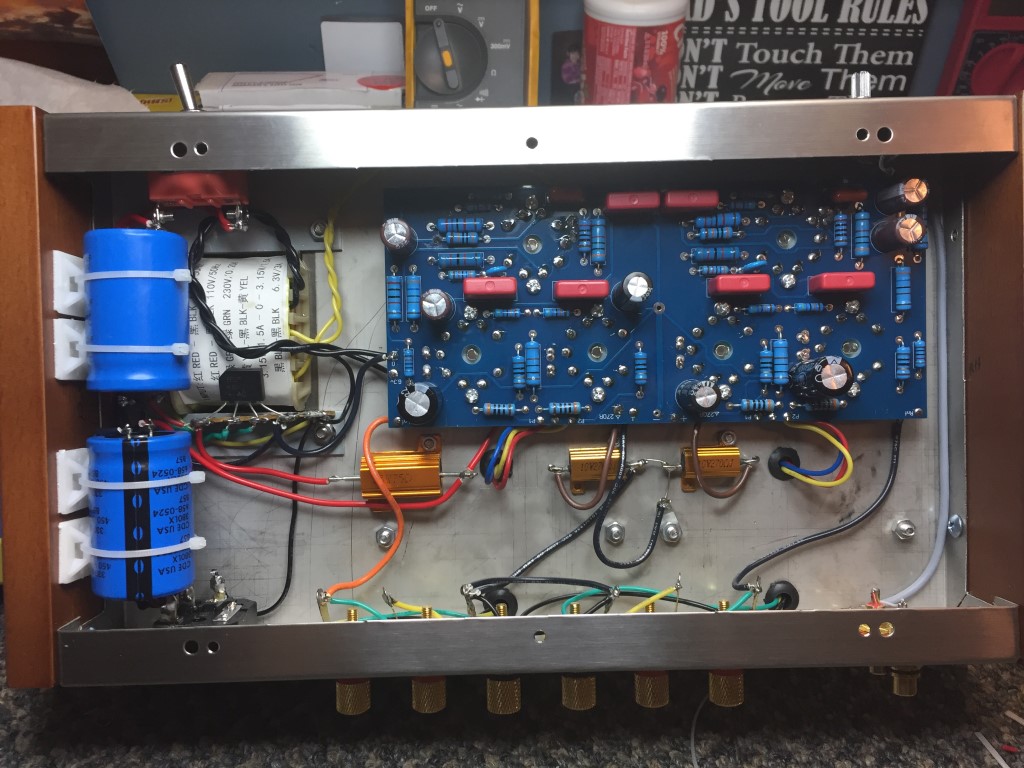

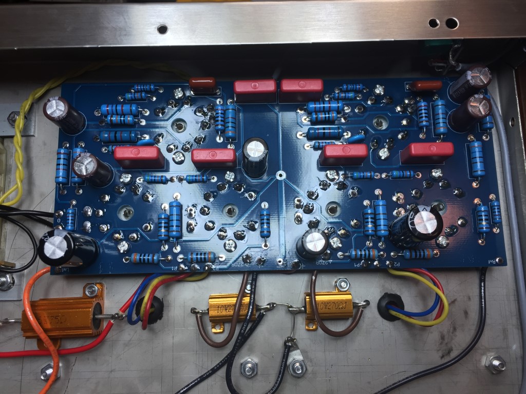

After attaching the PCB (hopefully for the last time), I pushed the tube sockets tight against the chassis, double checked to make sure all pins were in their place, then soldered. I soldered 2x just to make sure it was a good connection. I got the output transformer wires soldered on. I found lightly & carefully tinning the stranded wire helped it go in.

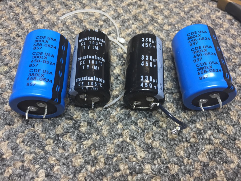

A comparison of the supplied electrolytics vs. the CDE.
They were a lot bigger and fit was tight, but they are in.

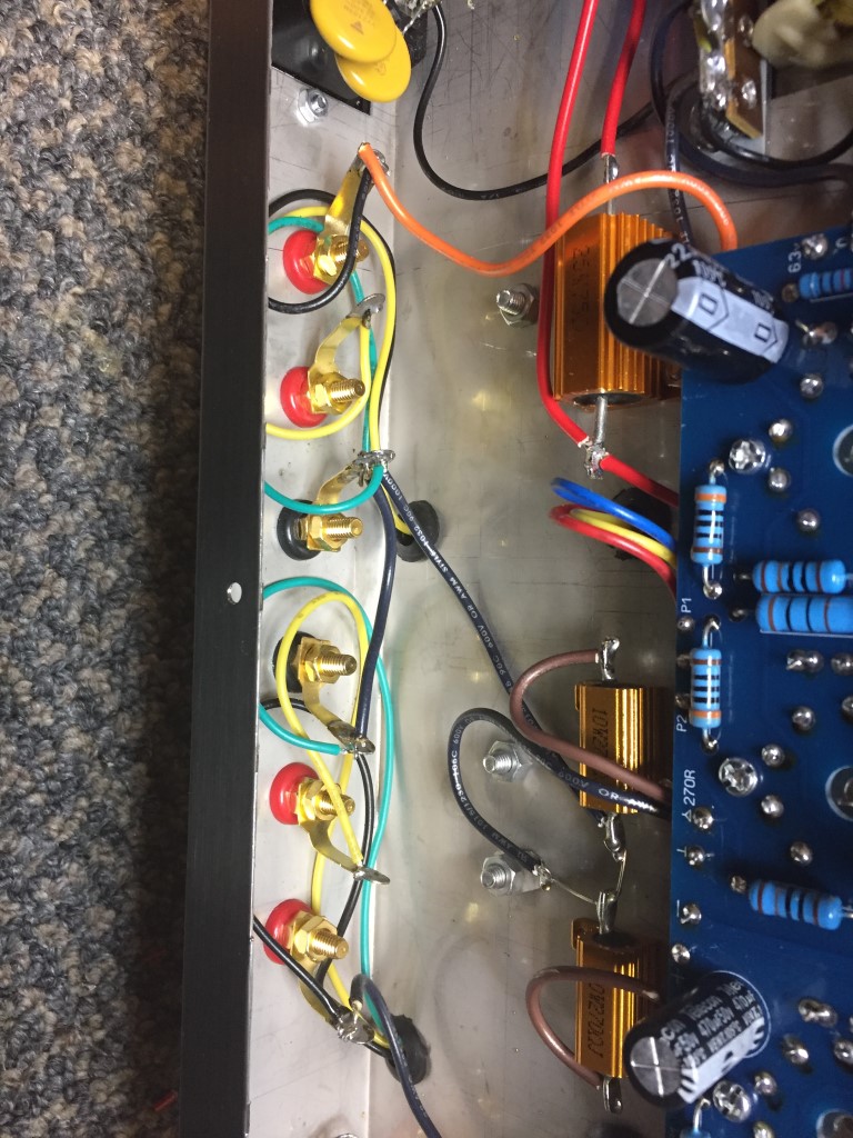

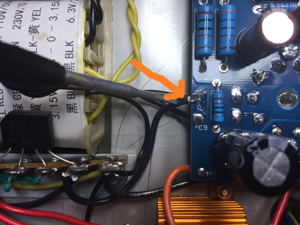

One mistake I made with my last build was not grounding one side of the filament winding. It produced an annoying hum among other things. It's NOT on the schematic, but this shows where I connected the ground for the output tubes. The voltage amp tubes have the filament center tap grounded. The current rating is the same for both filament windings, so I connected it like what appeared in the picture of the completed amp build shown on the auction site. One additional thing I did was to add a ground from the - on the PCB to connect to the ground on the terminal strip, just to insure if there's any resistance on the chassis it has a direct path to the B-
I did a no tube/no load partial power up and things look good so far. I did a few resistance checks 1st from the B+ to ground and didn't see anything unusual. I only powered up to about 60v and voltages looked about right.

Tim, did you try removing the connection on the rectifier terminal strip between the bridge rectifier negative and the adjacent chassis ground lug?
My suggestion would be to have the bridge negative be isolated from chassis at that point and connect bridge negative directly to the big filter caps negative. Then connect the big cap negative with another separate wire to chassis and circuit ground. Wired this way, all the ripple current flows directly to the filter caps without any alternate path through the chassis or PCB grounds.
