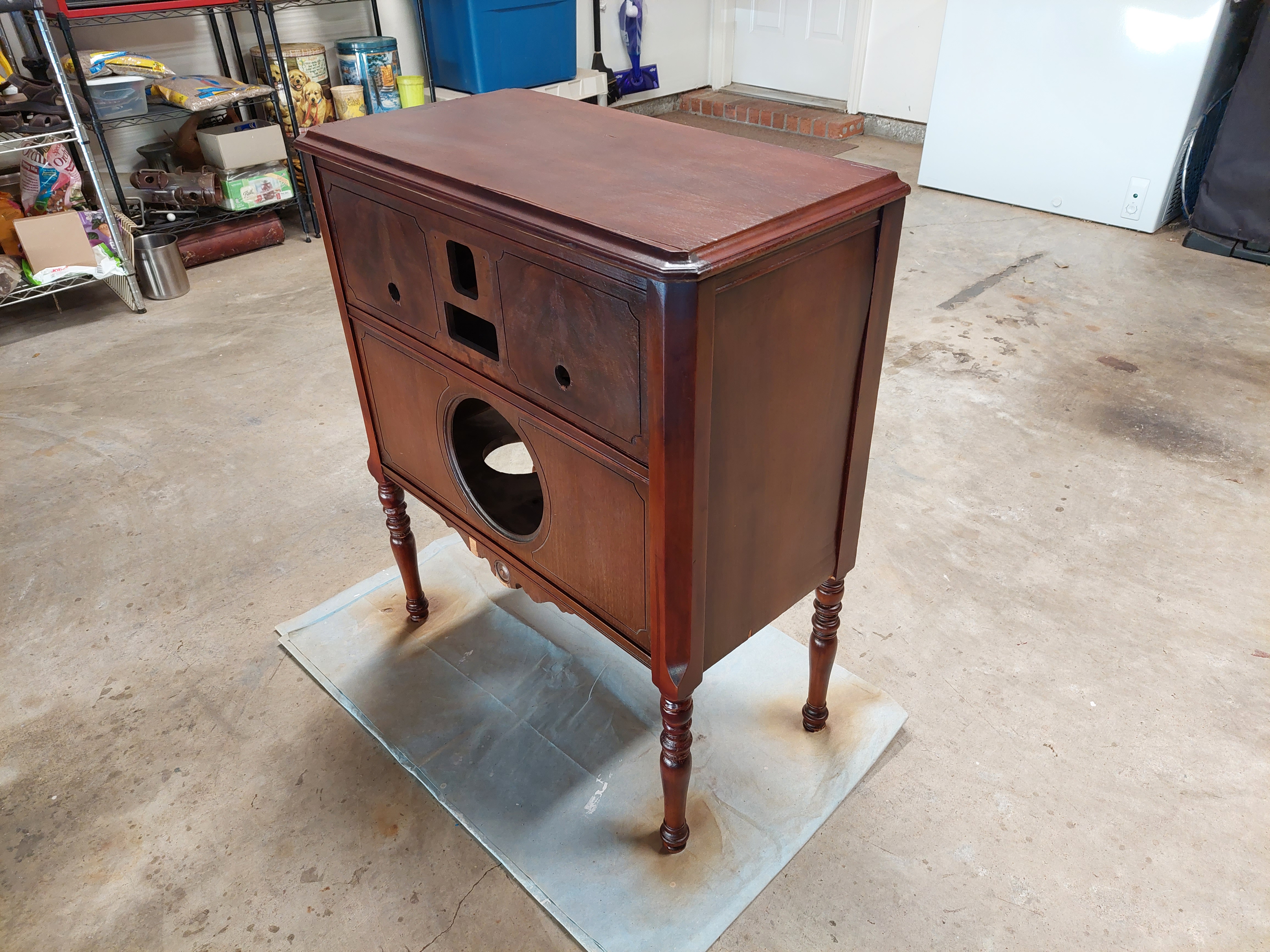

I think I will use clear Gloss instead of semi-gloss as the top coat. It doesn't look like I can get the shine lighter, maybe the gloss will help it blend in better. The legs still aren't exactly like the back ones but will do. Now I need to learn how to replace some of the broken veneer and new grill cloth. Pic to be posted later today I hope. You guys are sure a wealth of info for newbies like me.
George
I applied some clear gloss on the legs and think I will leave them as is. Next to the rest of the cabinet.
A little more progress, bear in mind I am not trying to make it look new, just decent. Ordered some veneer hopefully I can do it ok, especially on the speaker grill.
George
I'd say it's shaping up nicely- BTW your pics loaded VERY slowly on this end. Maybe a problem or not?
Simon
That's a nice looking repair, George. I also do not need to get a radio to look pristine or like it just came out of the box. My feeling is that a radio that has a 70-90 year history will usually look it. I like clean and complete, but not necessarily perfection. I certainly don't look like I did when I was new, so why should my radios?!?! I believe a radio that's used looks it! Take care and BE HEALTHY! Gary
