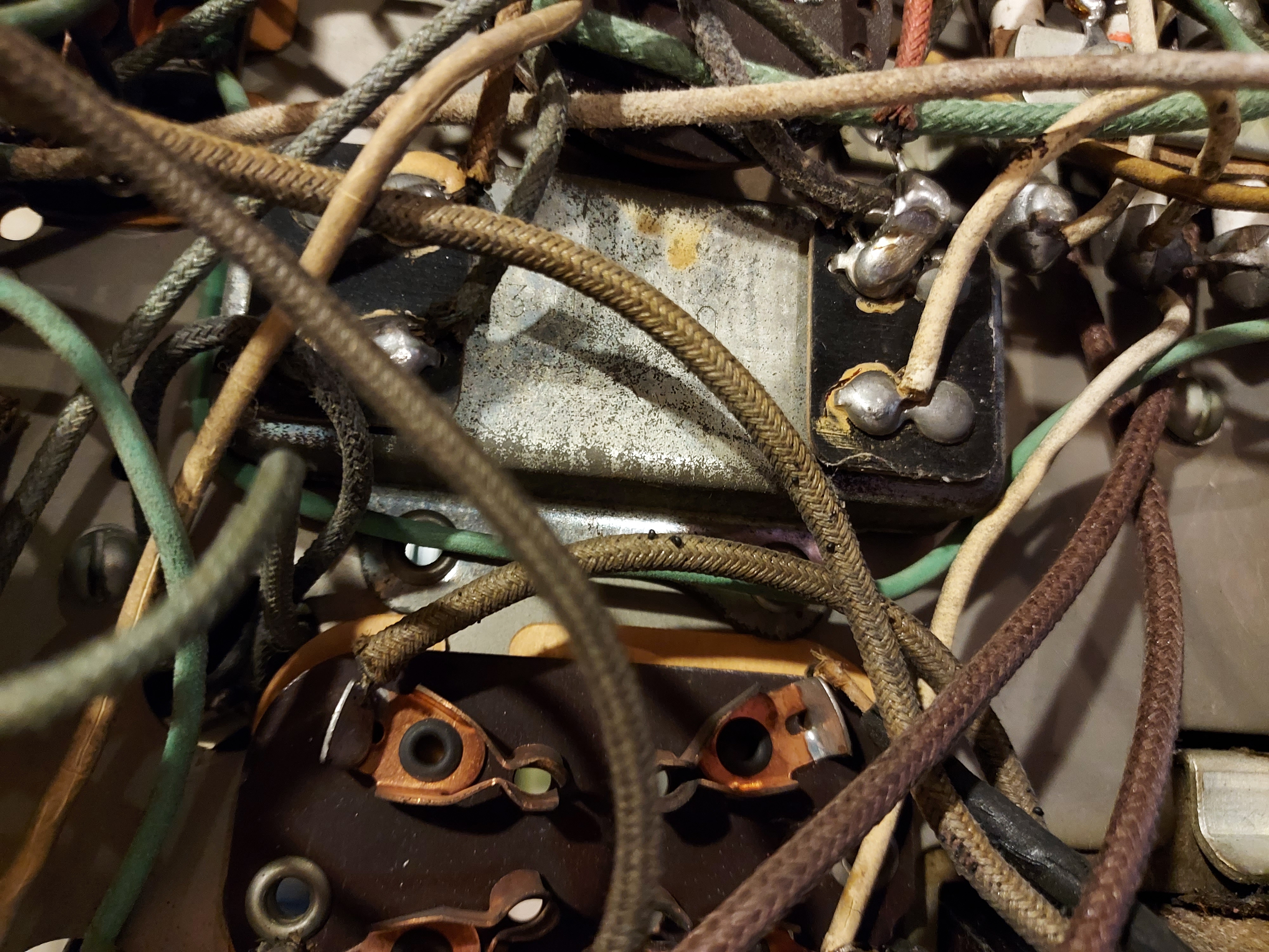

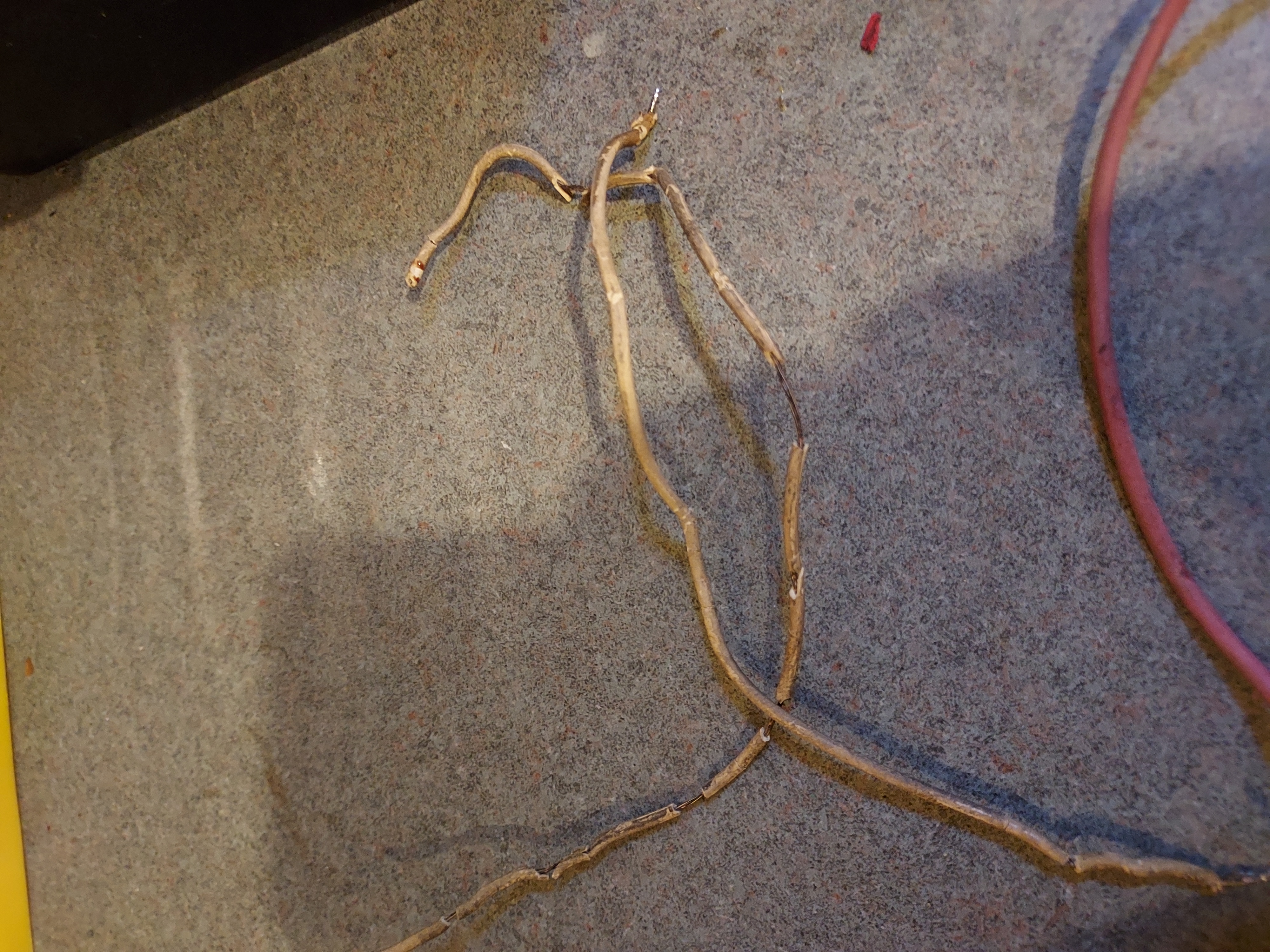

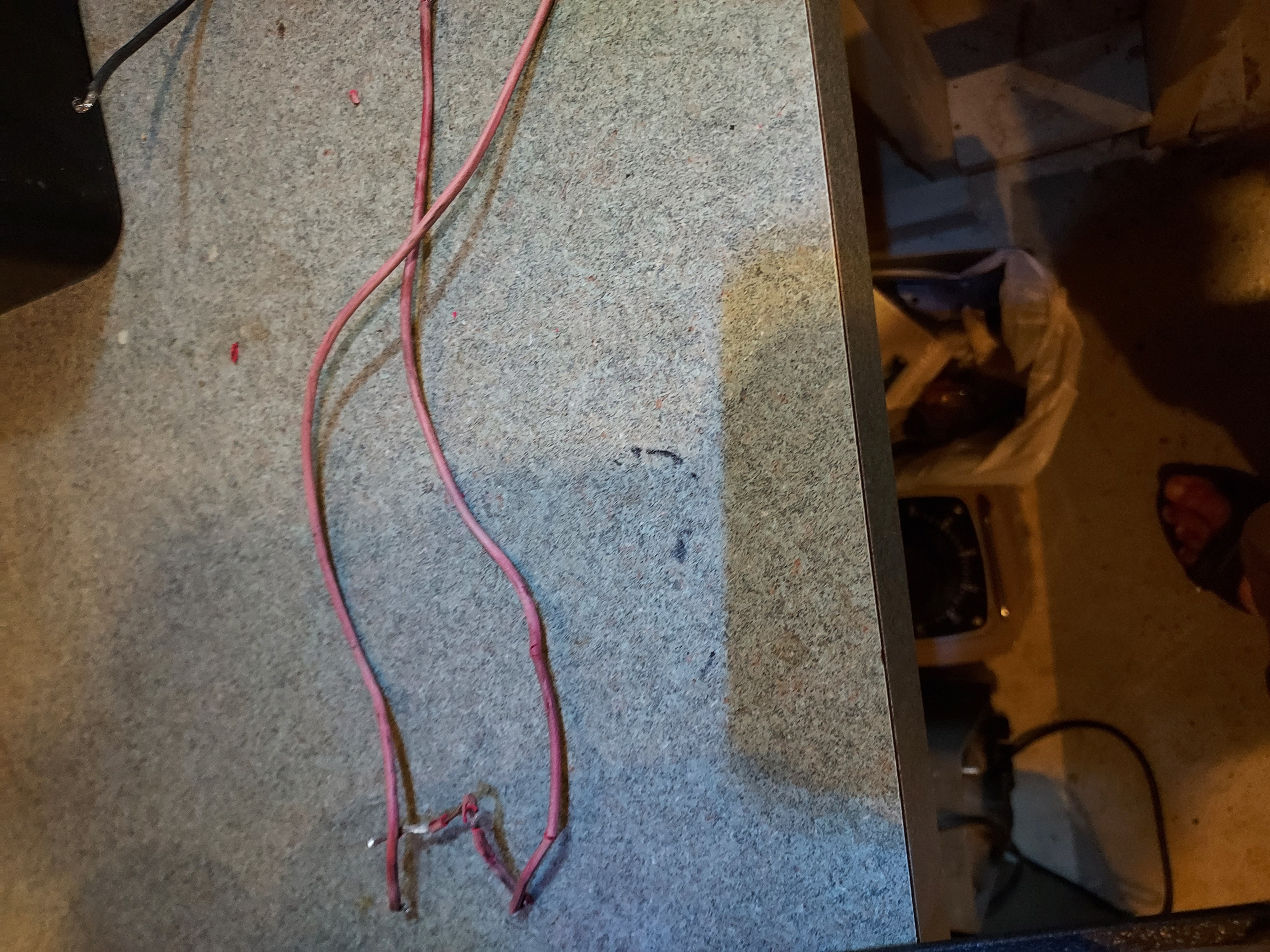

These are the wires I replaced. The pink are the filament wires, and the white are signal wires. Started to crack, so I decided to replace them.

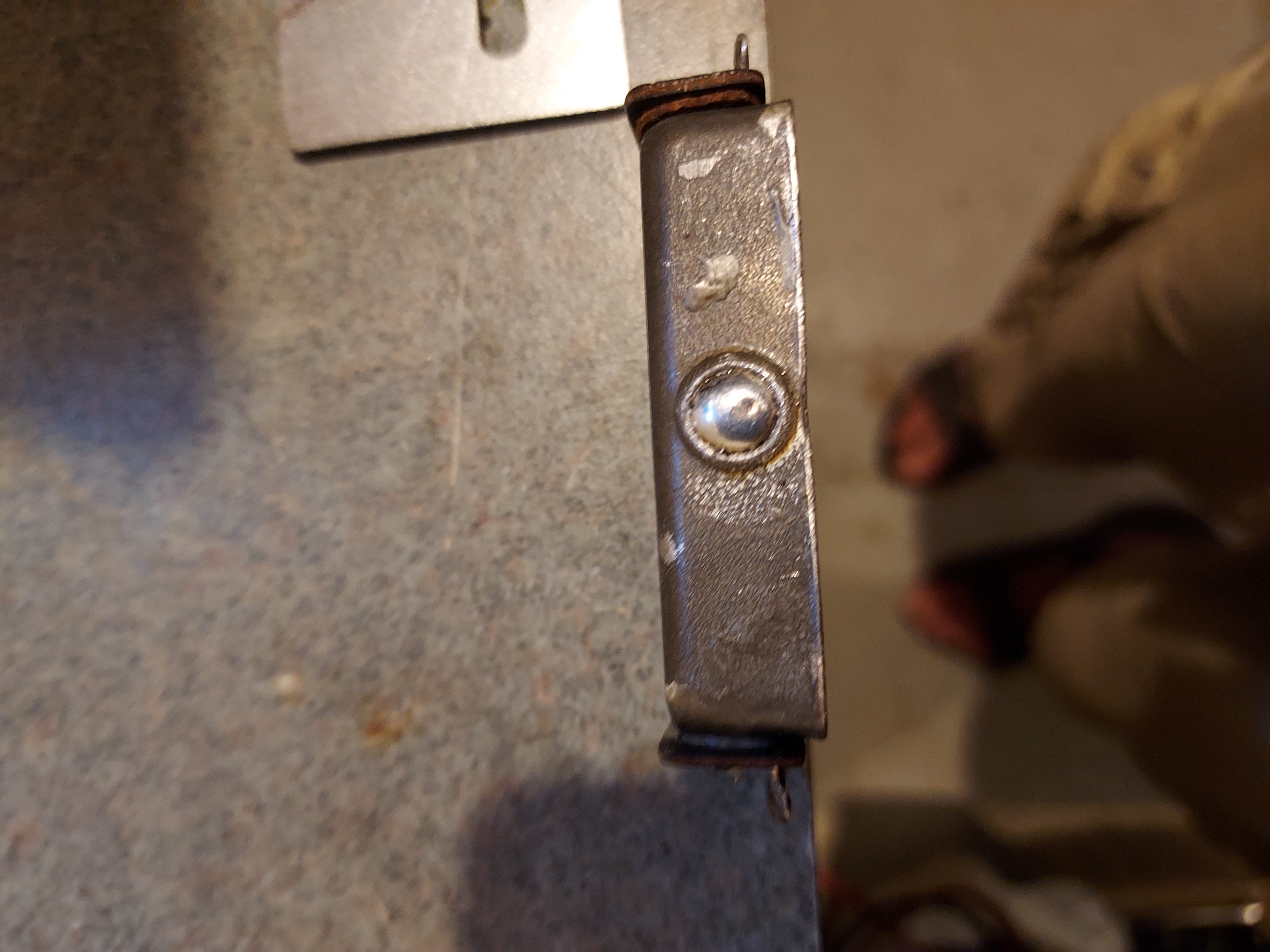

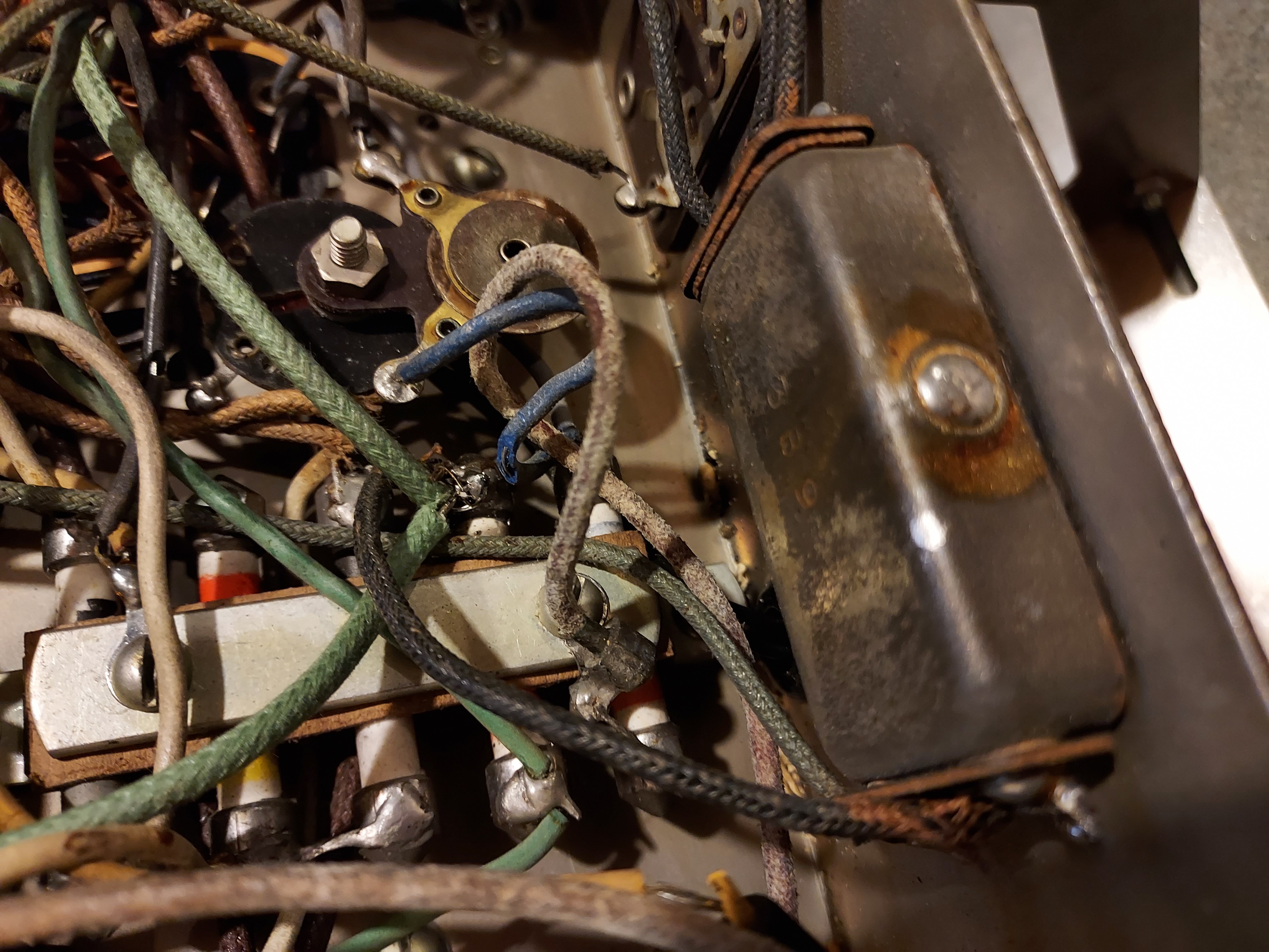

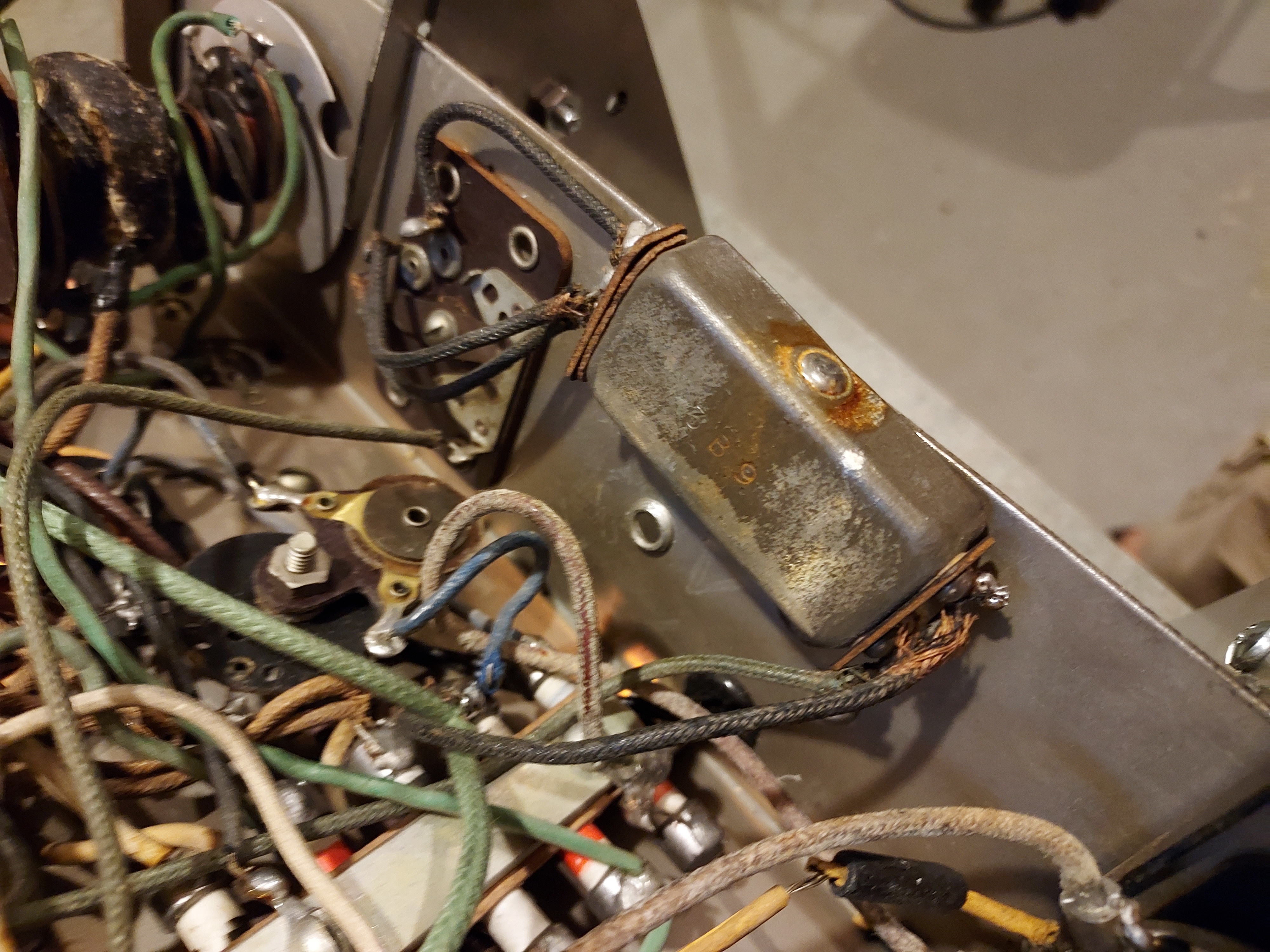

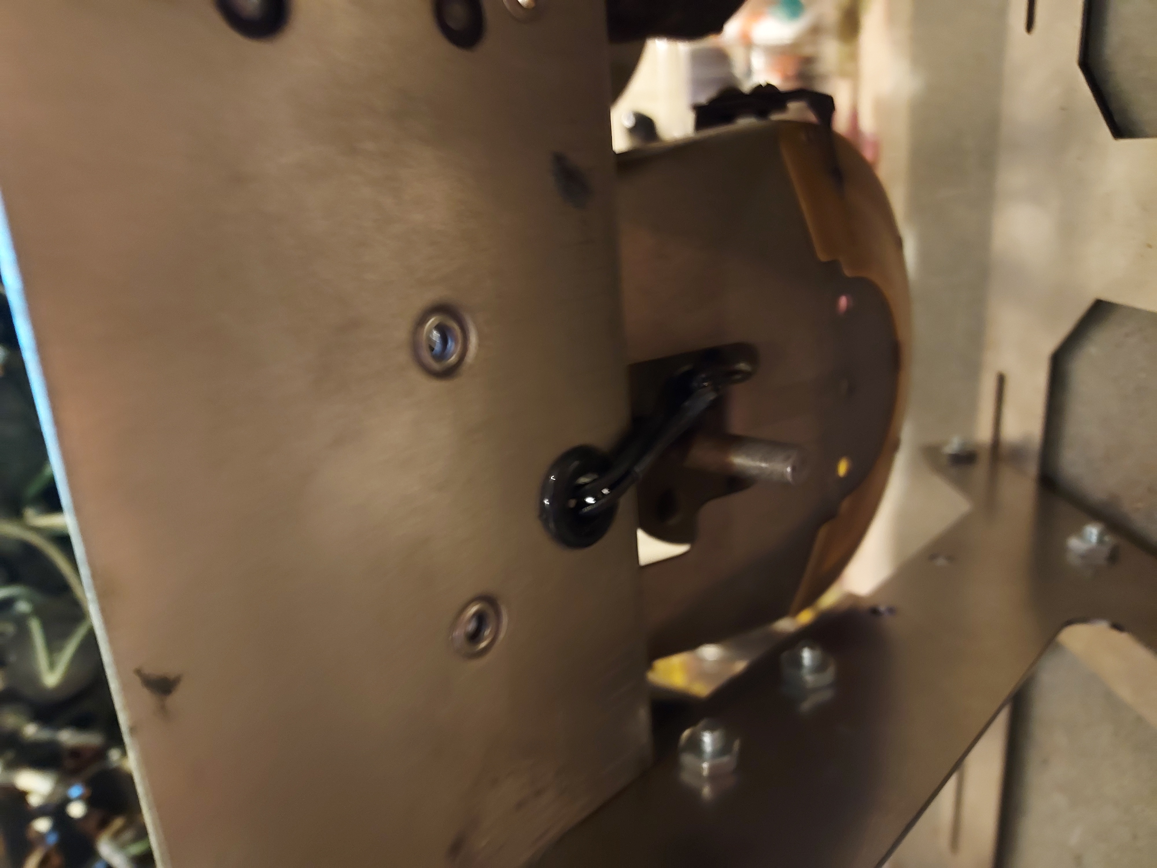

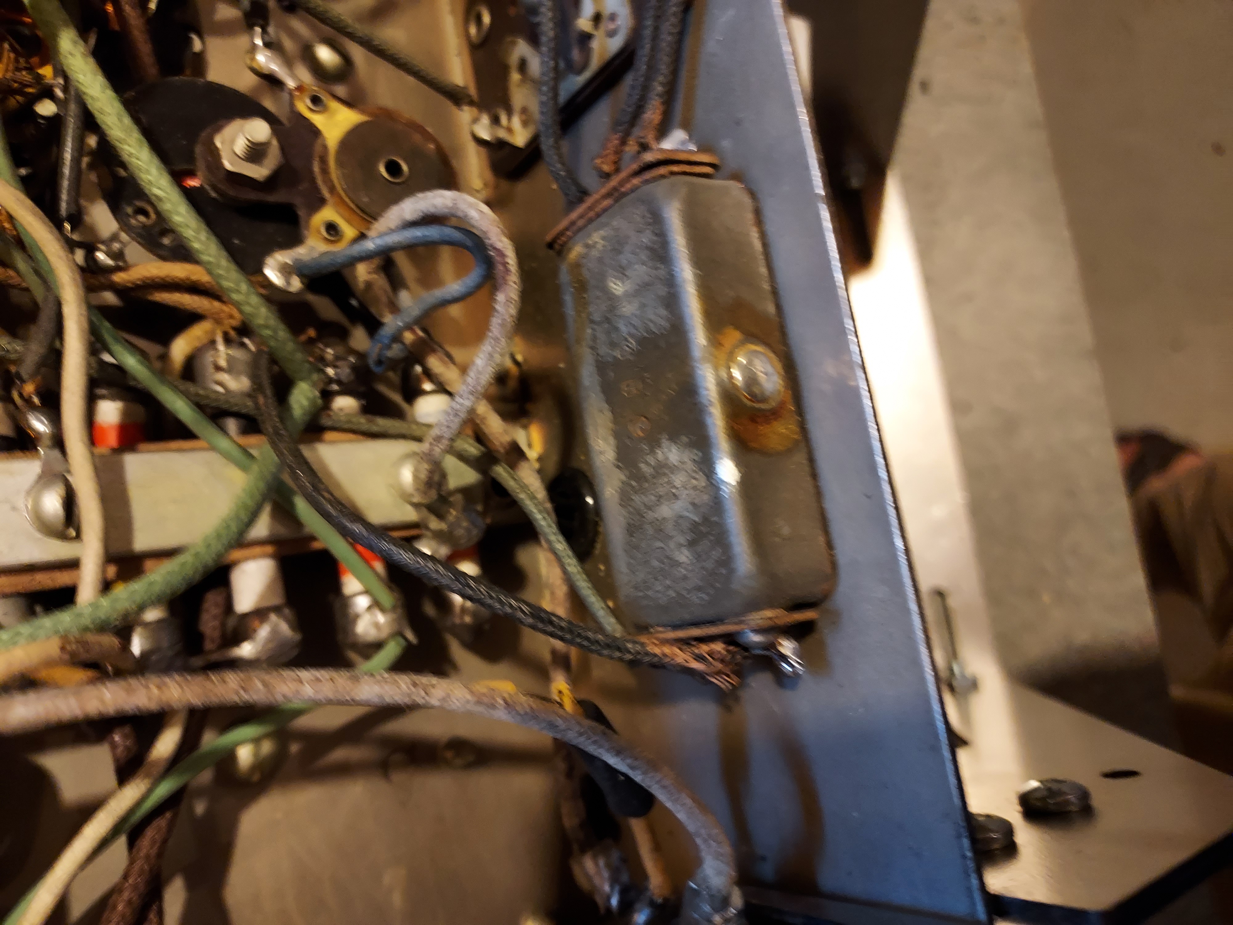

Now there is that question of the capacitors' cans. They are riveted to the chassis..
And these are the cans themselves (you could see the rivets).
The rivets are on the side, so could be easily drilled out, and then, I guess, replaced with screws, even if this will alter the apearance a little.
What did those of you who deat with these do?

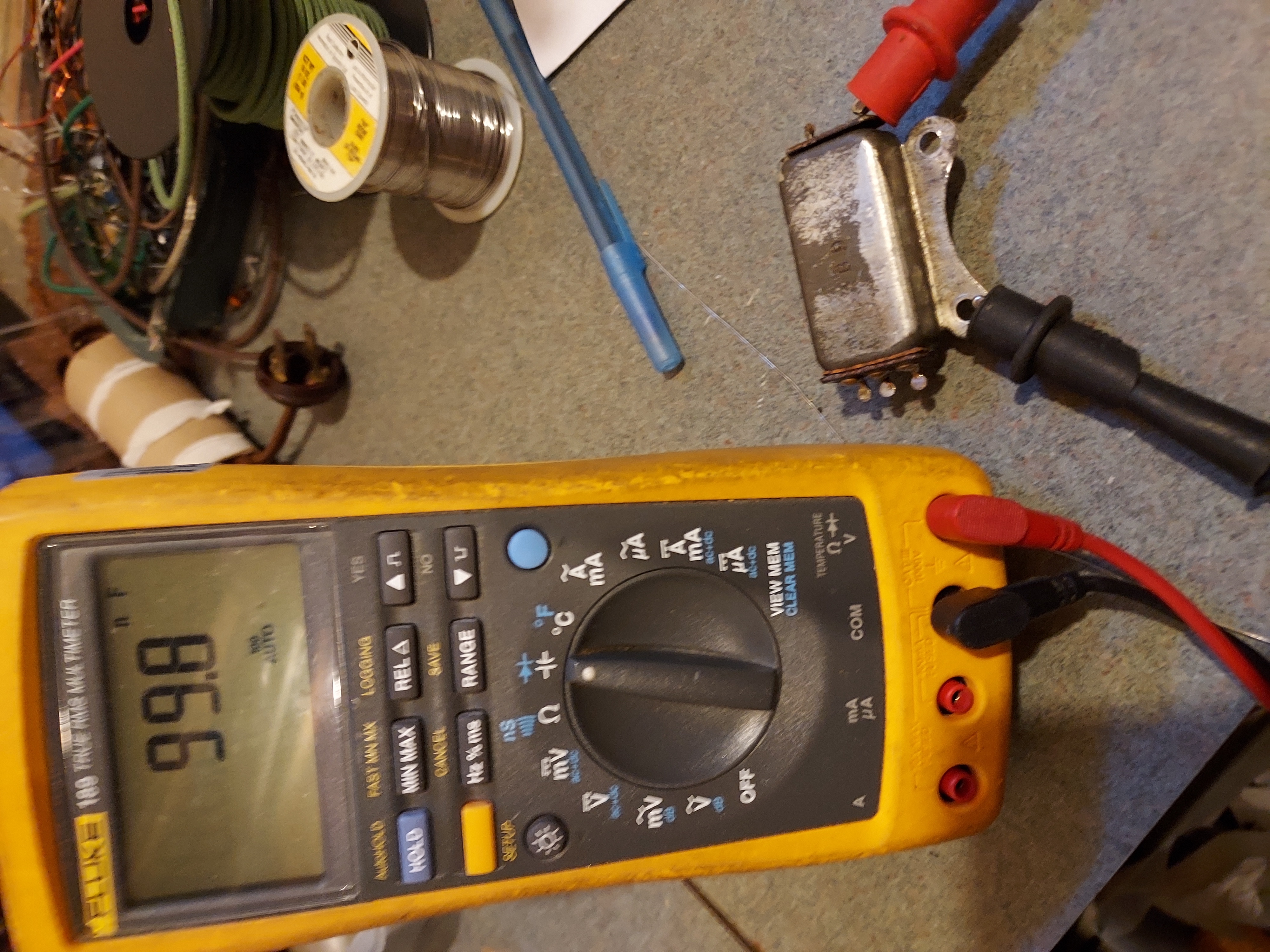

Another option is just to install solder strips and bypass them. The caps' values, unlike the resistors, are all over the place (I checked out of circuit, of course).
Also the tone ctl can is a bit diffrerent (5-cap) from that in the sch (4-cap one).

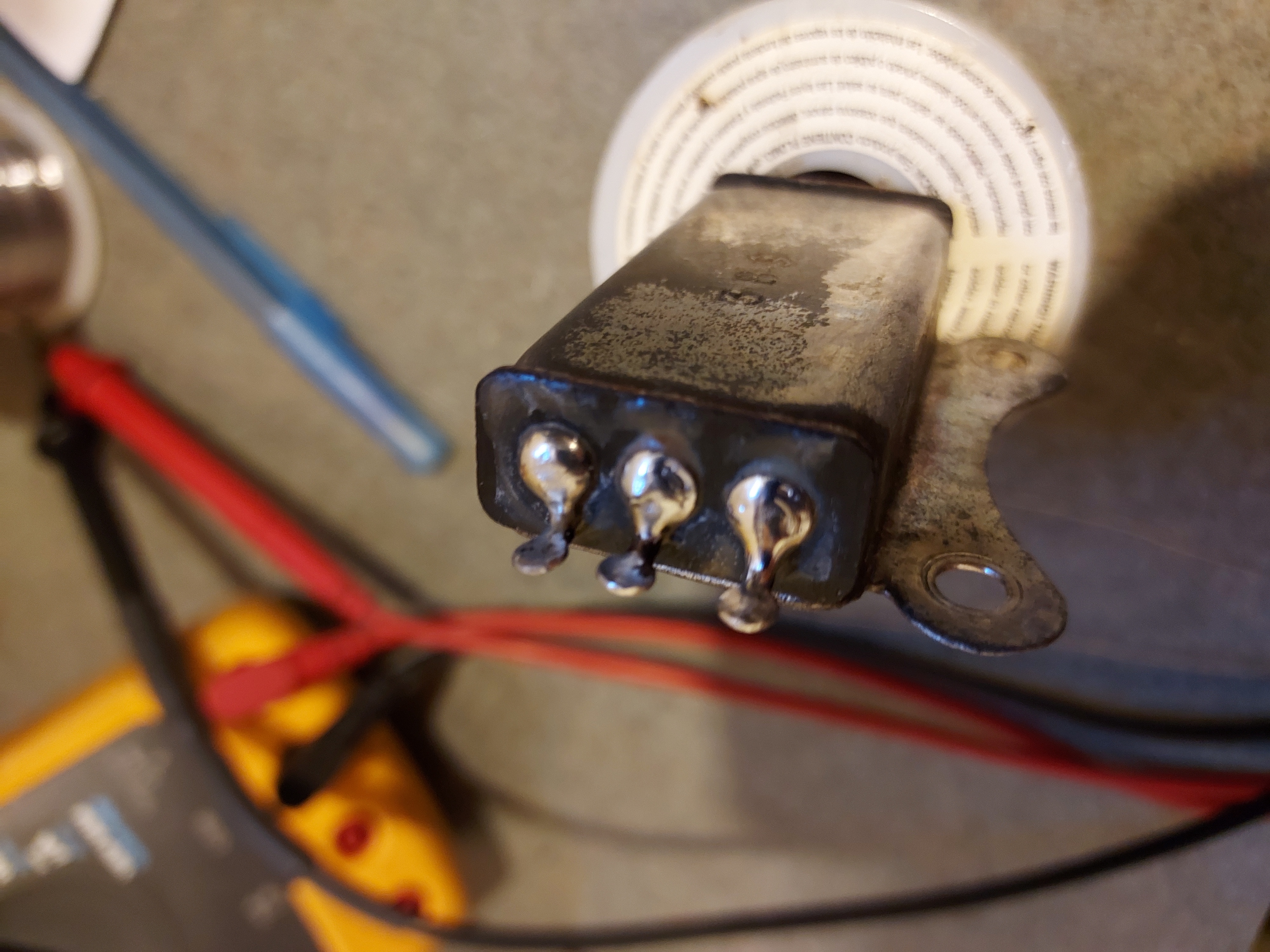

I also decided to keep the electrolytic caps rework the way it is, (with the Philco-Ford caps replaced). I will use solder lugs and use the existing electrolytics as the support.

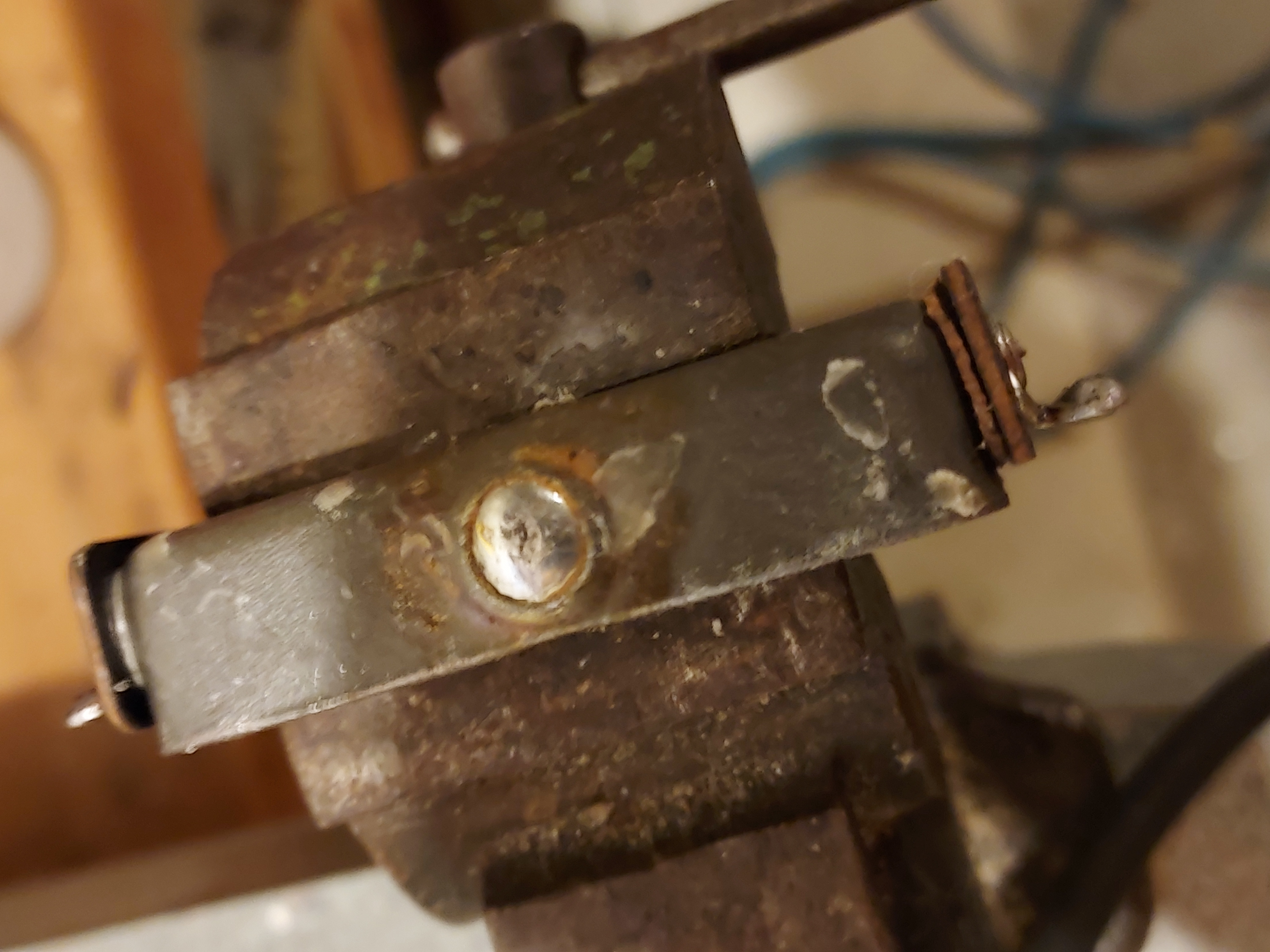

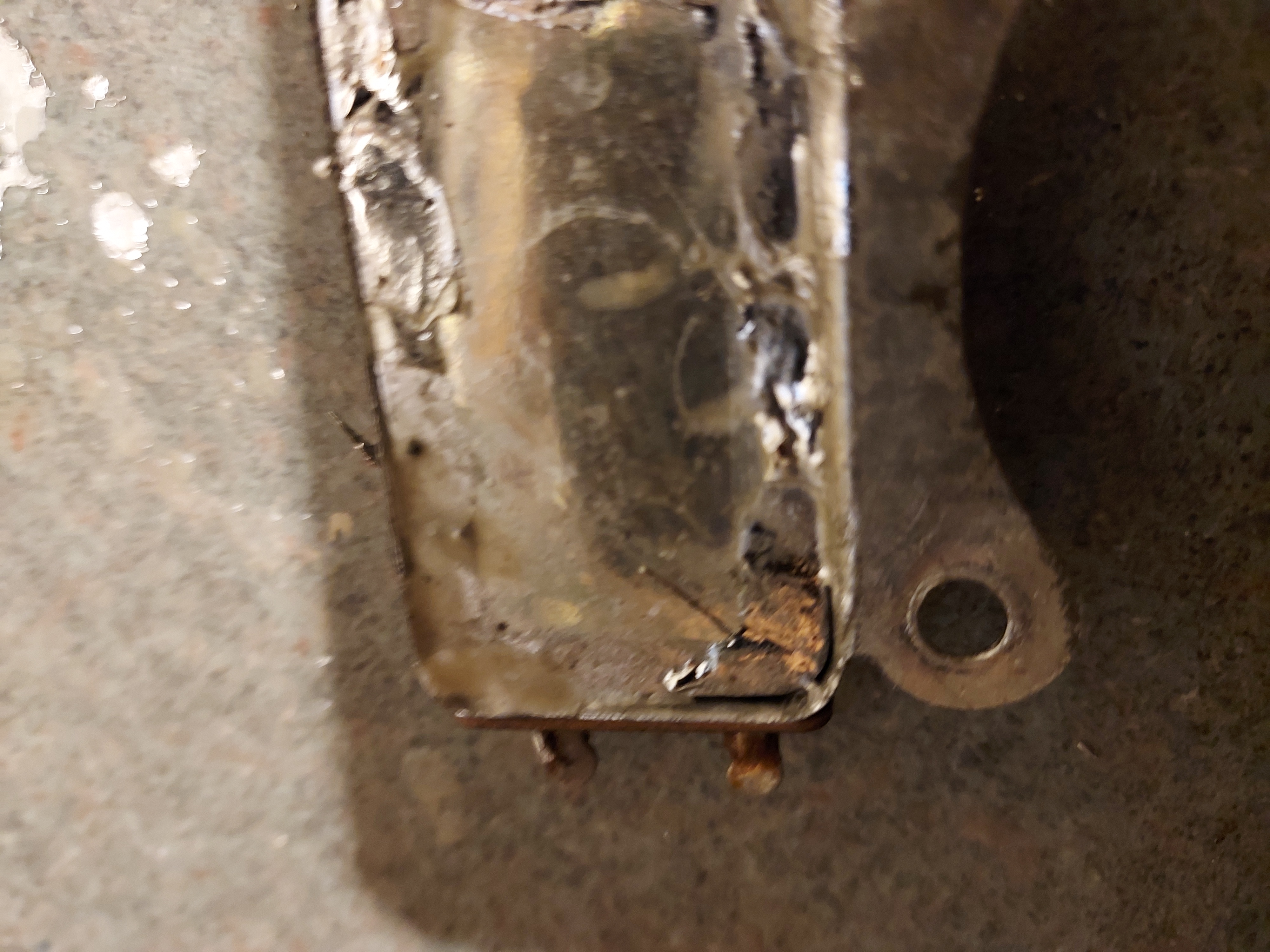

I took the drill and drilled out the rivets.
The desoldered it.

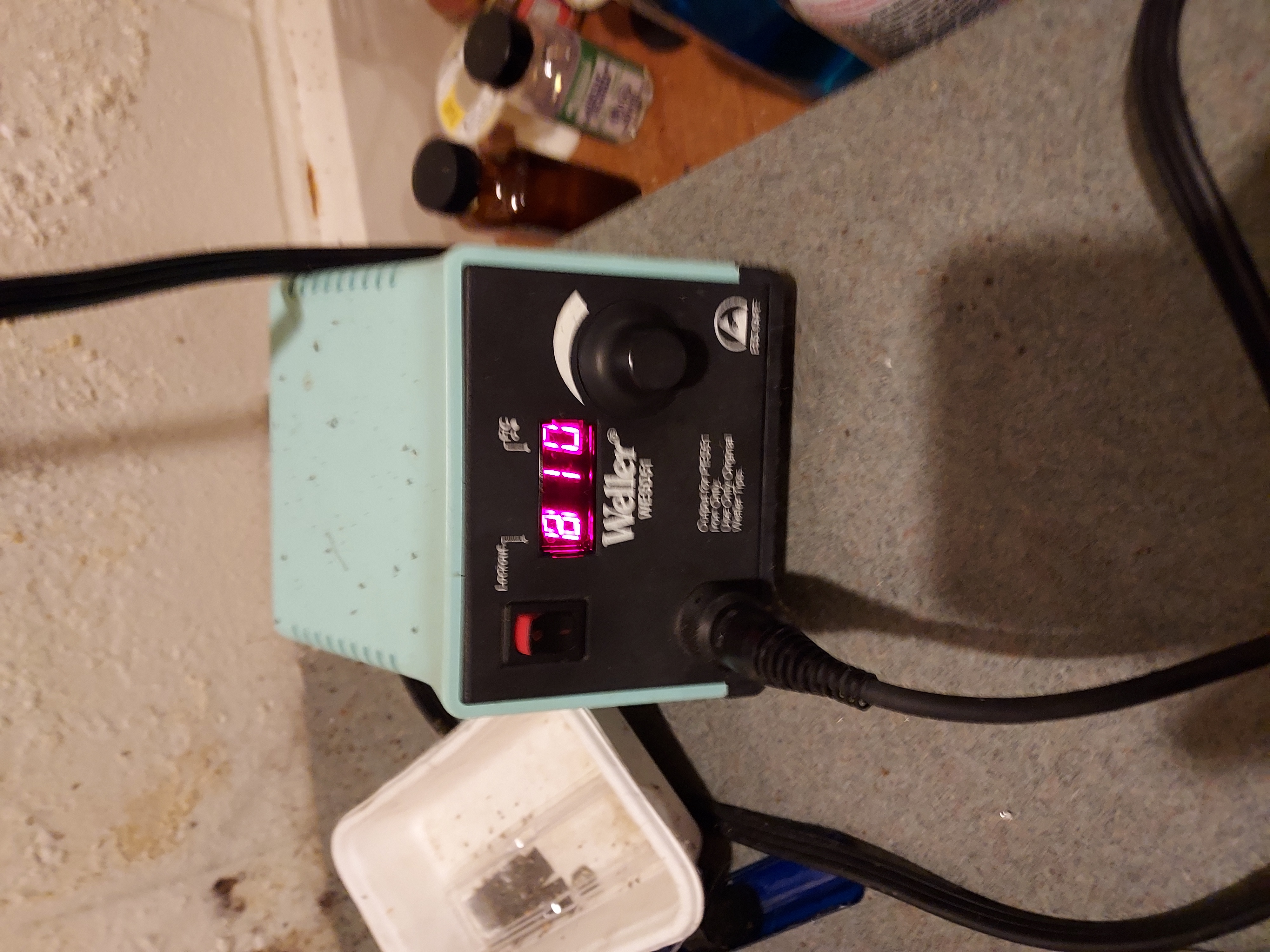

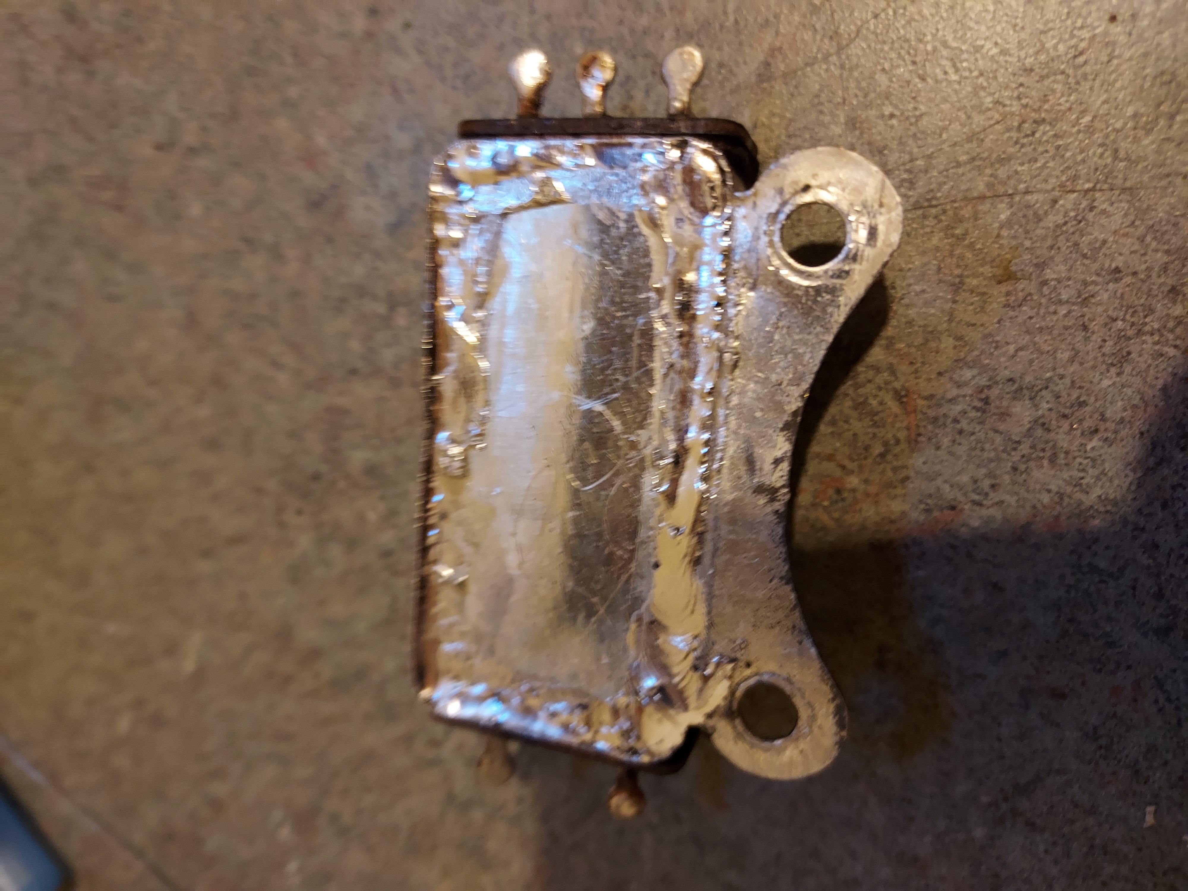

Then I set my sodering iron tip temerature to just ove 800F.
The tin is rather thin, and so I kept heating the bead and shaking the solder off.

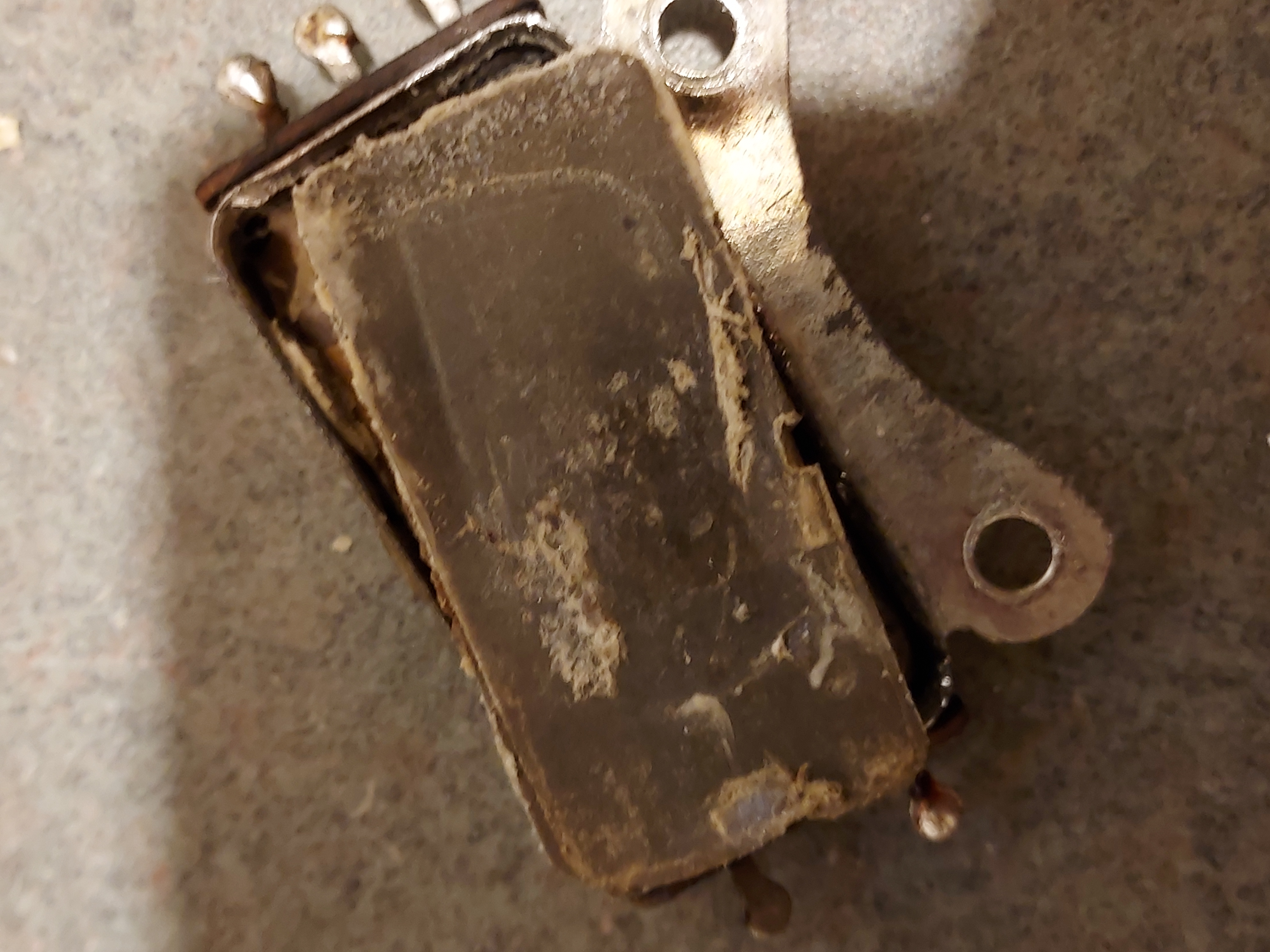

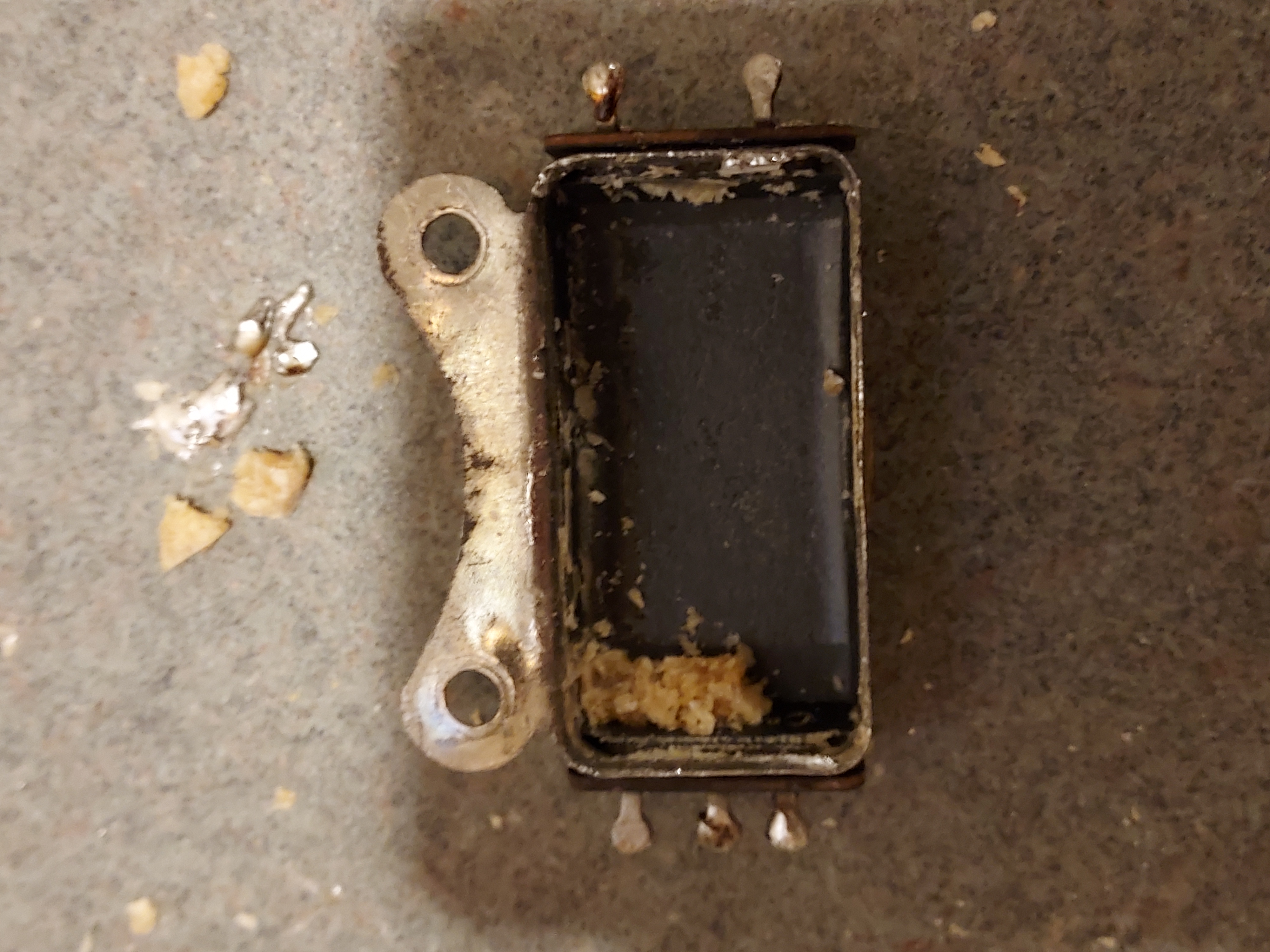

Then I pryed the lid and with a little help of soldering iron it came off fairly easily.

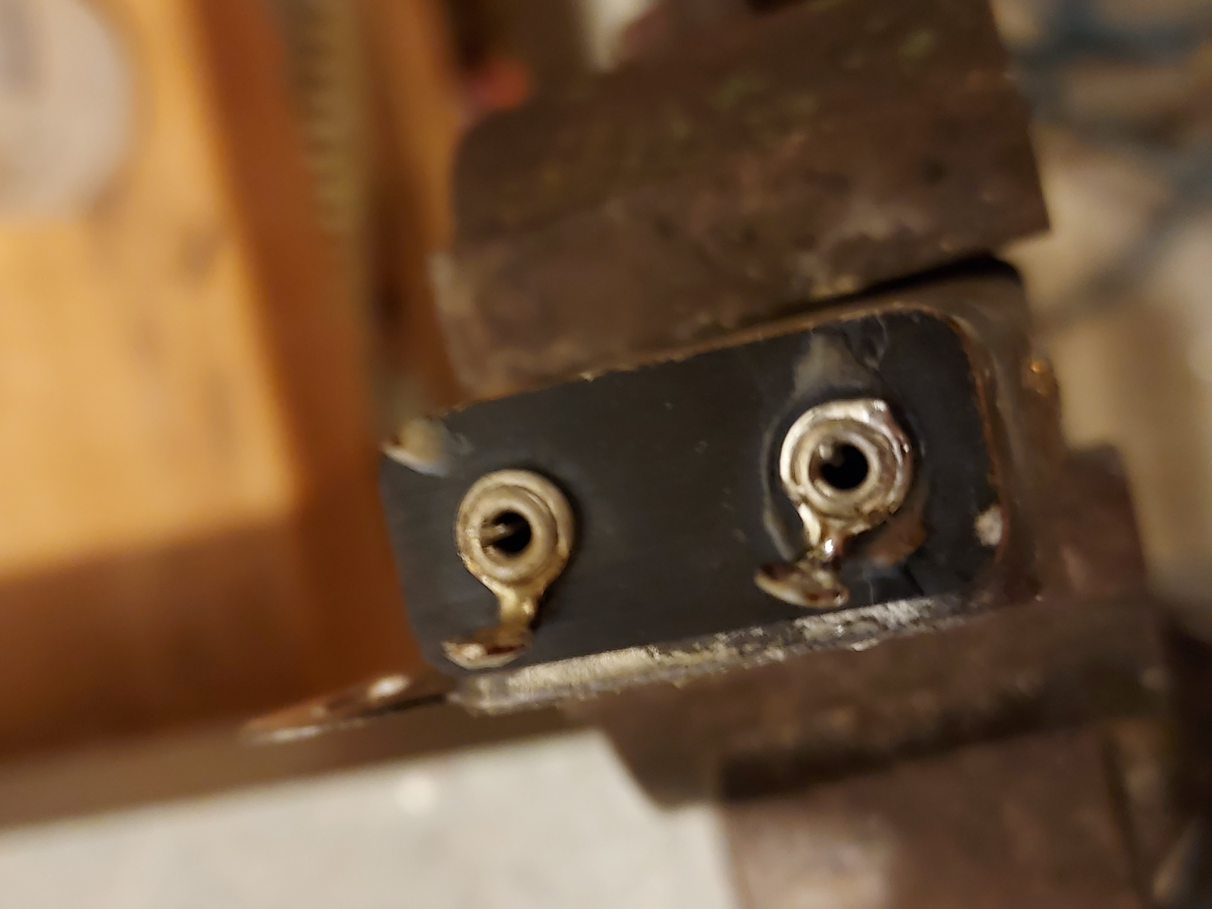

Then I heated the eyelets and shook out the solder to free the wires.

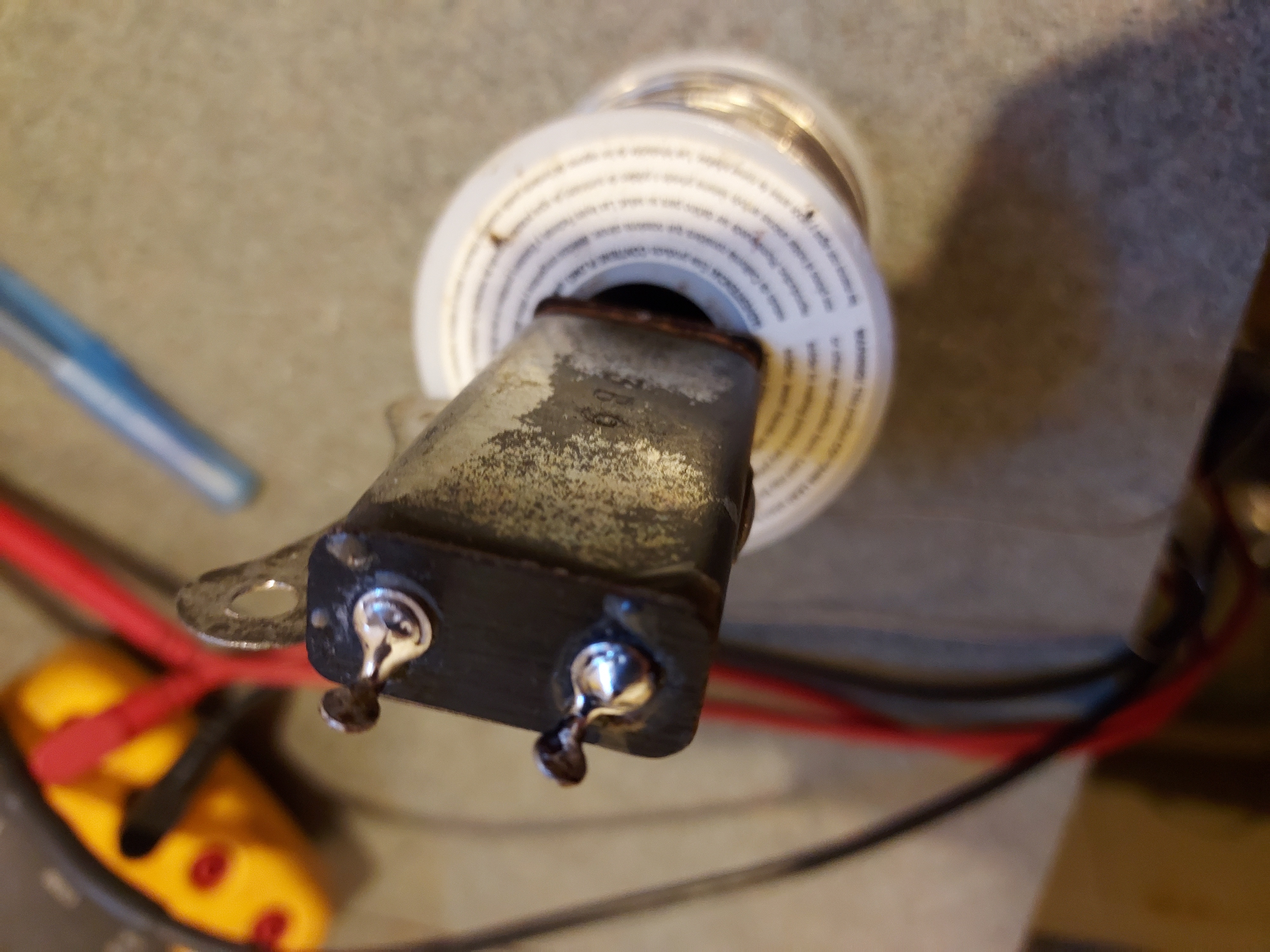

Also the solder bead on the side. I did not know whether it held the ground wire. So I desoldered it just in case.

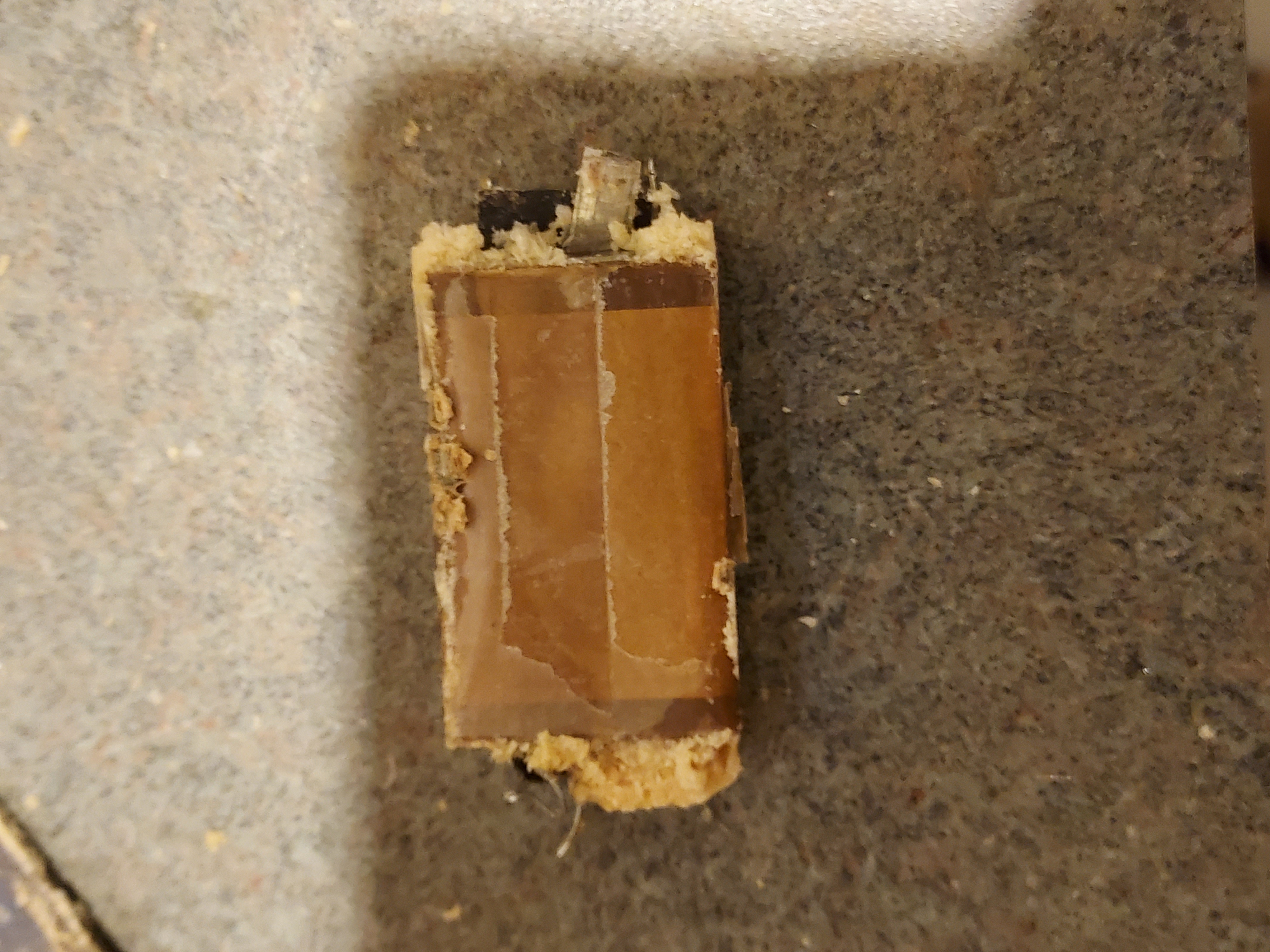

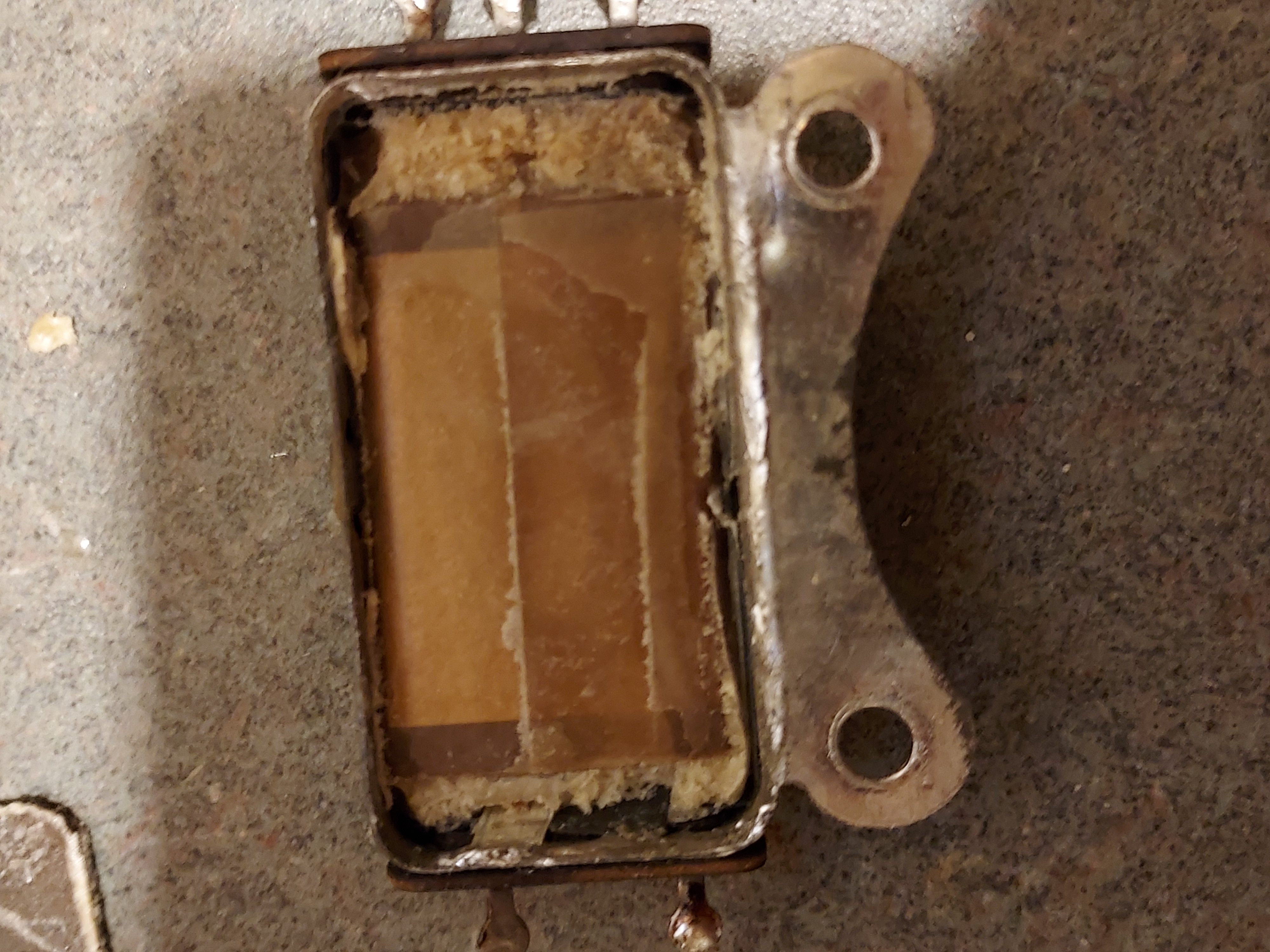

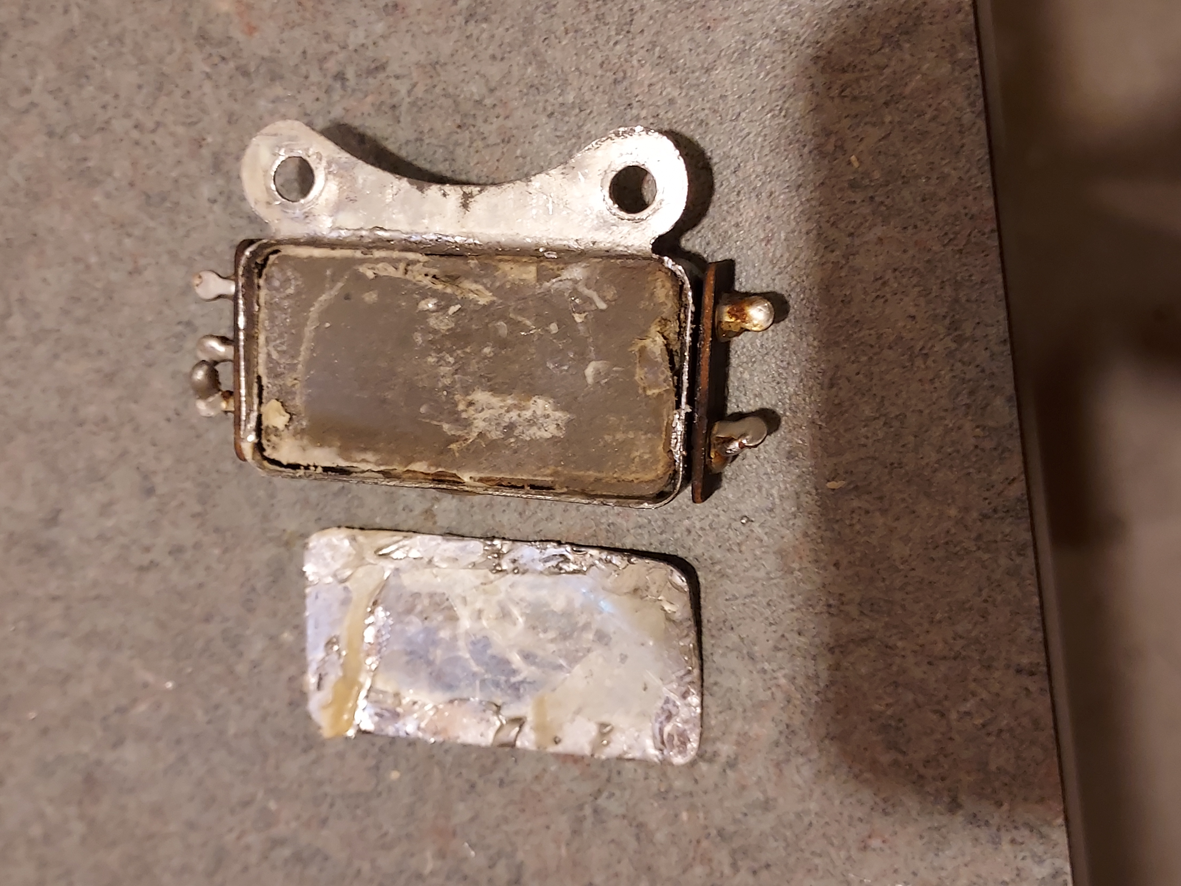

With a bit of prying, some sort of cover came off, and then the innards.

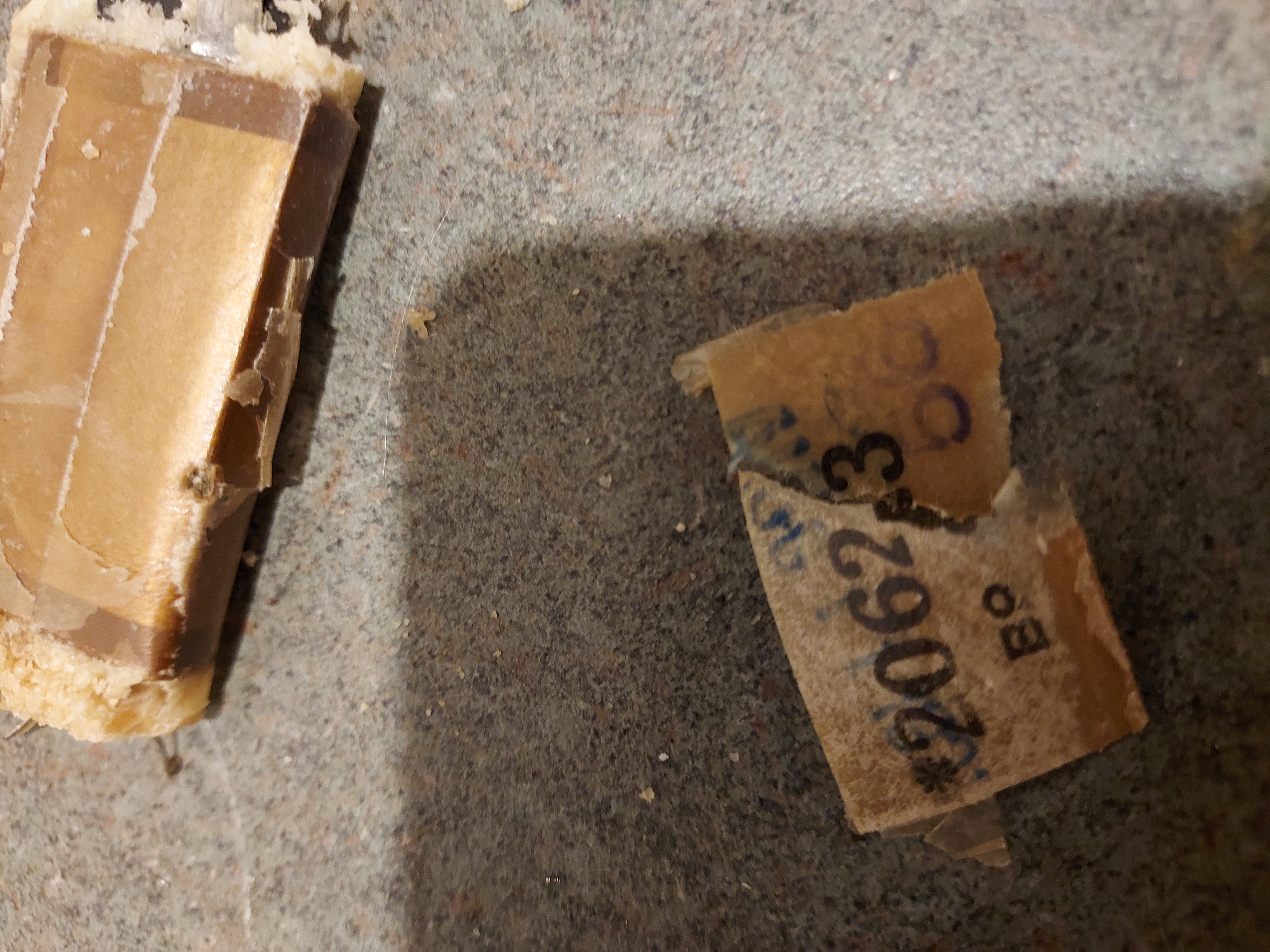

The other side of the cover had some numbers on it; I wonder if it is the can P/N.
Would like to finsd out to figure the 3rd Tone ctl cap's value. Though I am sure it is small, 300-500pF, and not too important.

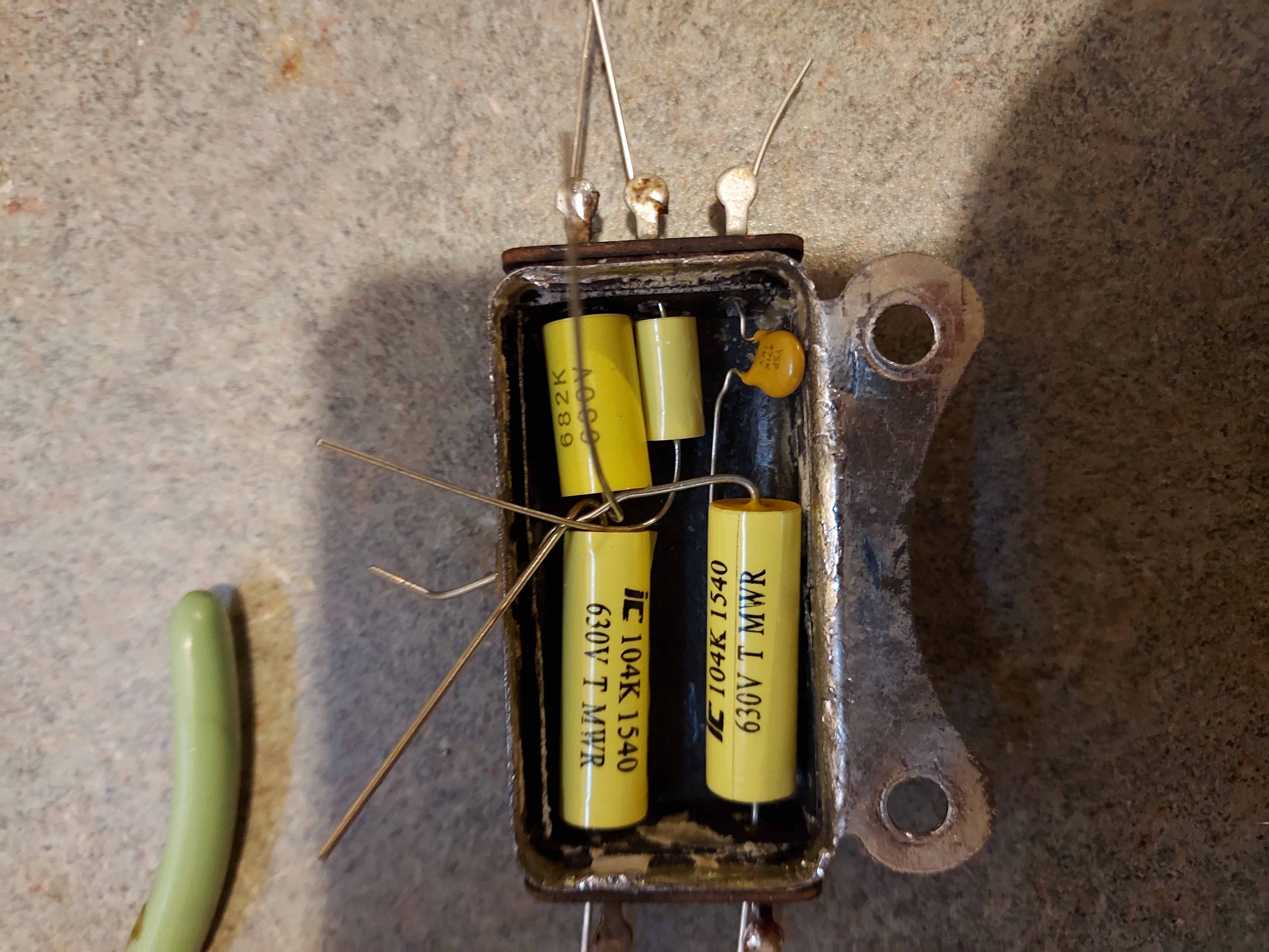

Yeah, I think there's enough room for yellow caps. I might use brown flat caps for 0.1uF, as yellow cylindrucla might be a tad too fat for it.
OK, I know exactly what I have.
There is "3 B 9" impressed upon the can. I checked, it seems that the first number 3 means something else, and the letter and numbers after that is the alternate name for the can. Thus, in the book B-9 is indeed 21250.
I checked on the rest of the cans and the same system works when checking the imprinted numbers against the 5-digit number in the book.
So now I know for sure my radio used 21250 can and not 20010 can (in the book listed next to mine, with all correct caps' values).
So, it is 0.0005uF, 0.003uF and 0.007uF (500pF, 3nF and 7nF) caps that I should be using.

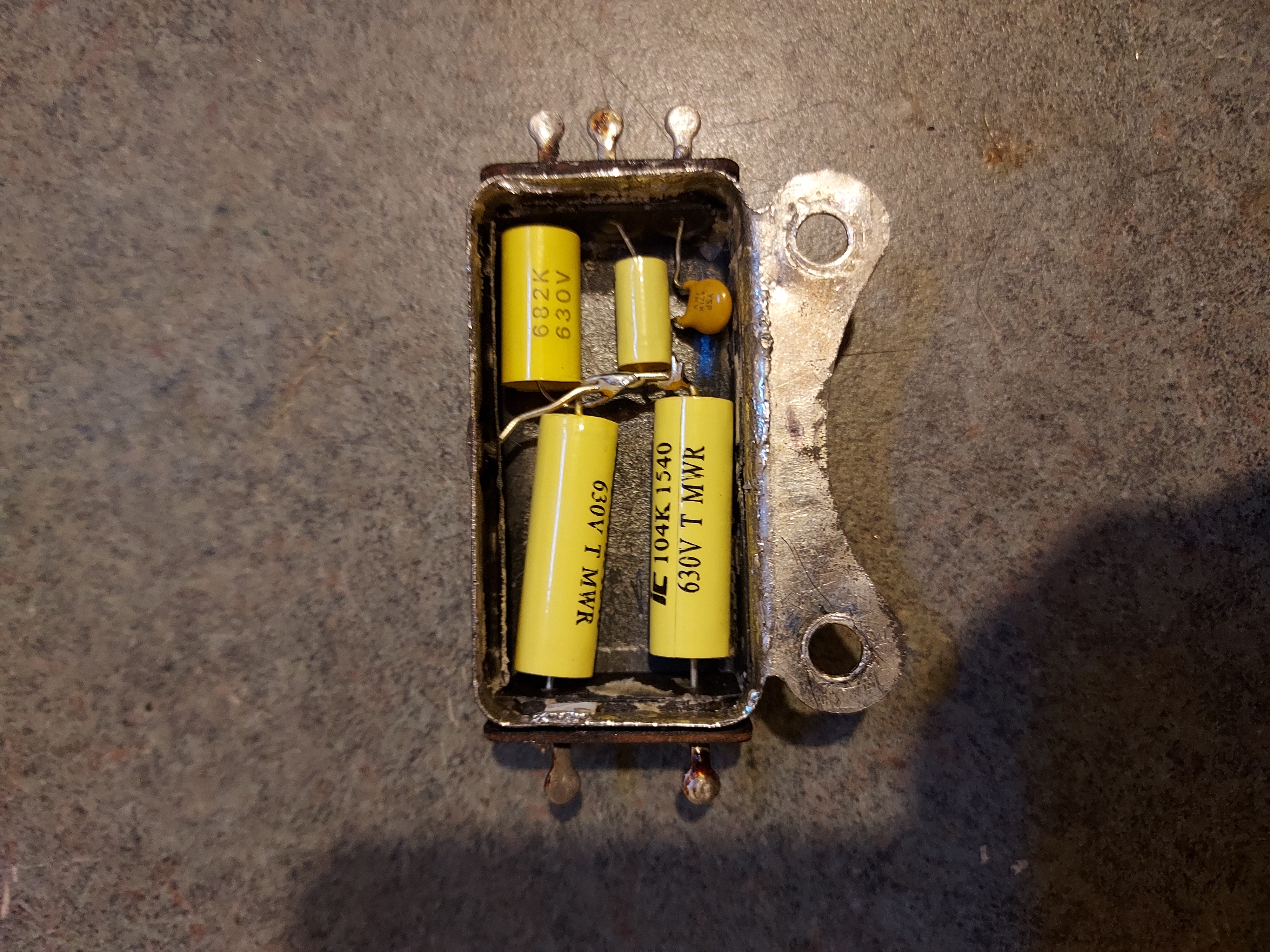

OK, now here's how I have just rebuilt the can.
Placed the caps inside.
Solder and trim.
Close the can after having put one of the dielectric covers inside.

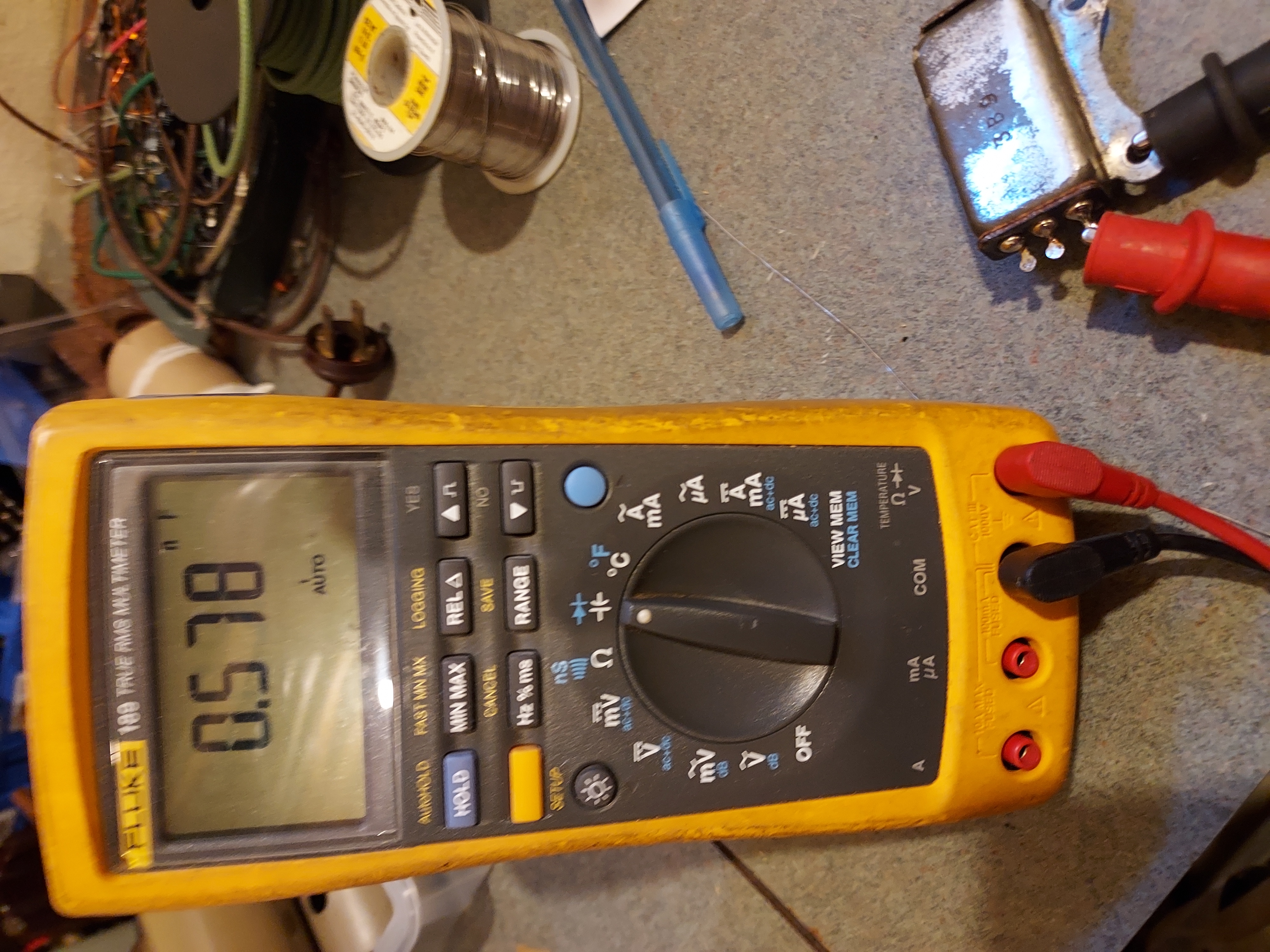

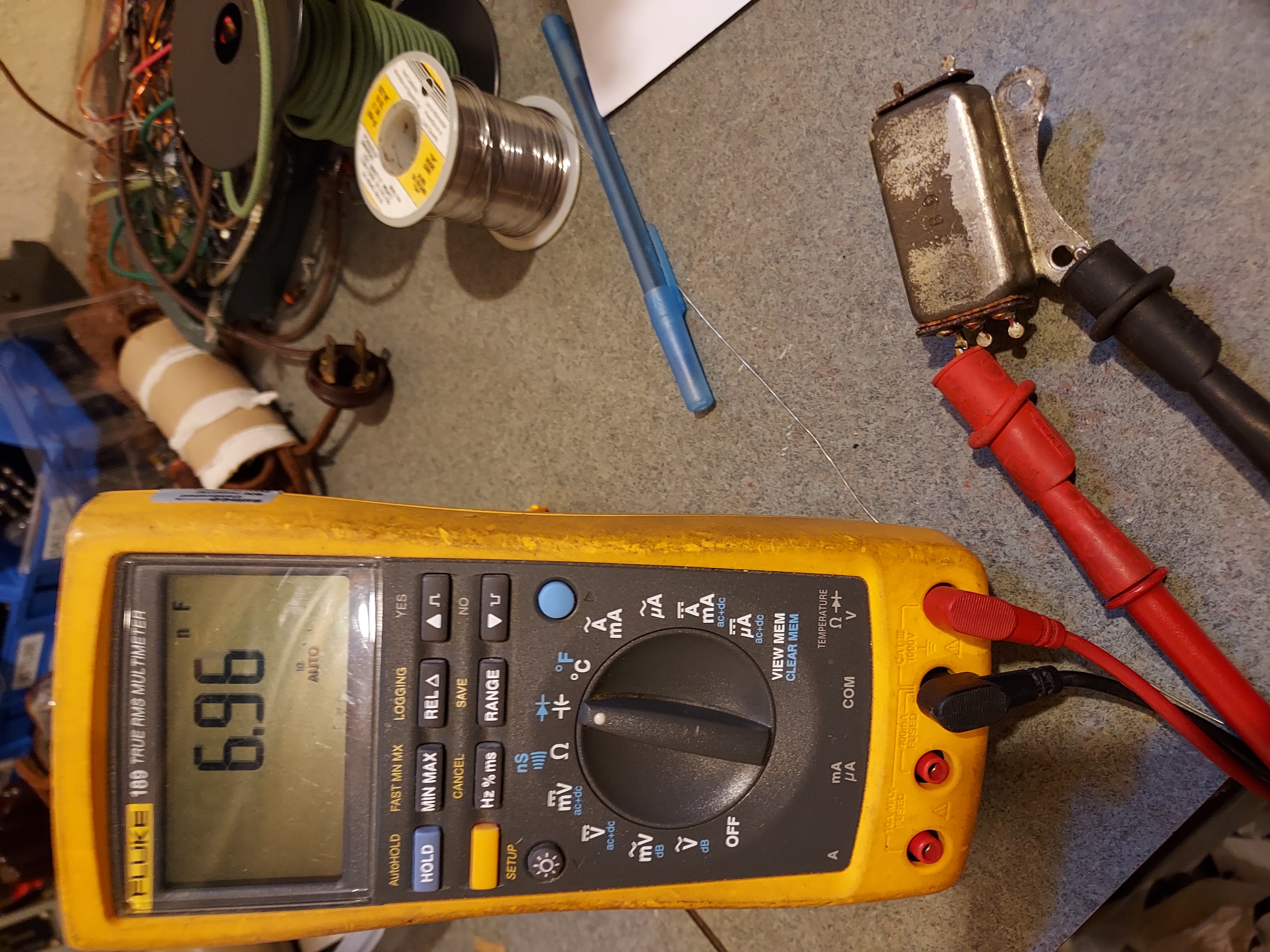

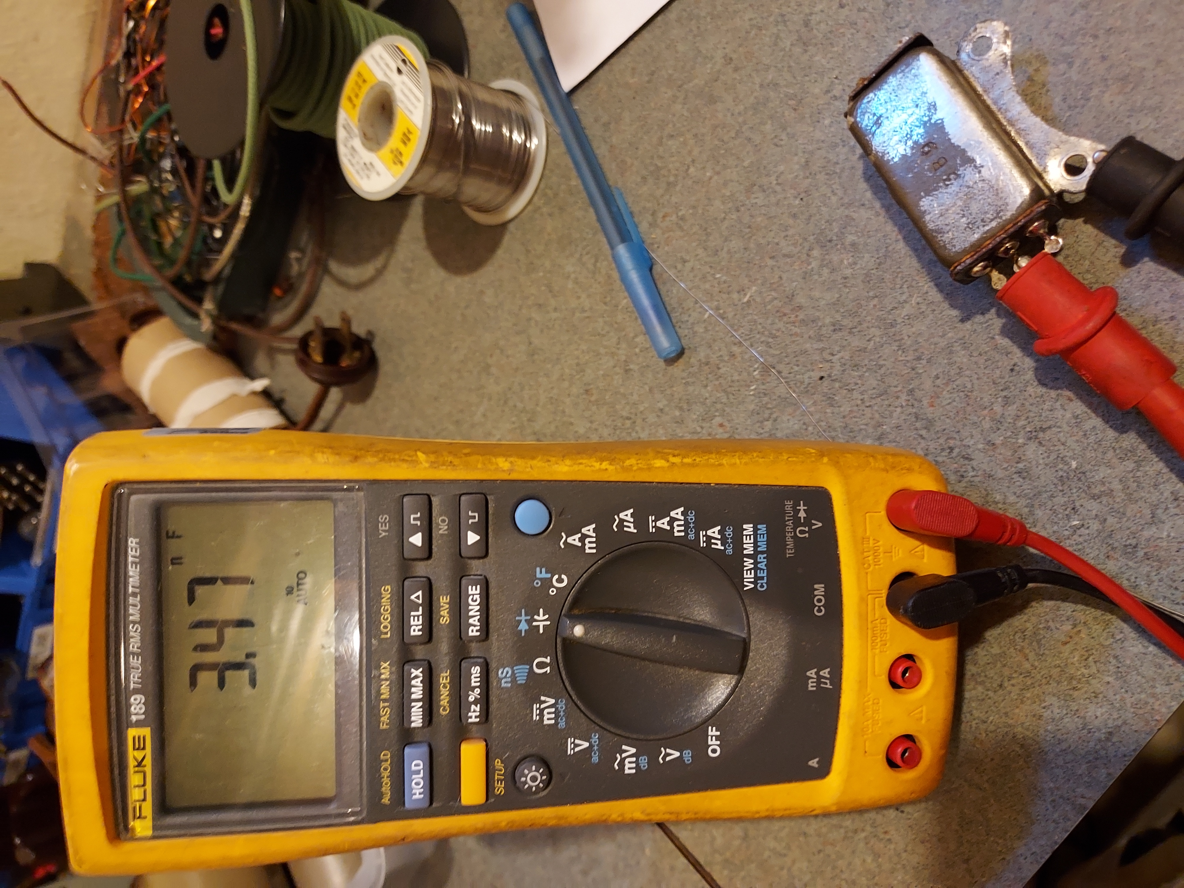

Re-measure the caps. Should be 2x 0.1uf, 3nF, 7nF and 500pF.

Also need to decide if I am rebuilding the elecytrolytics. There is a chance I will simply relace the Philco Ford caps mount on soldering lugs, using the lytics as mounting posts.
