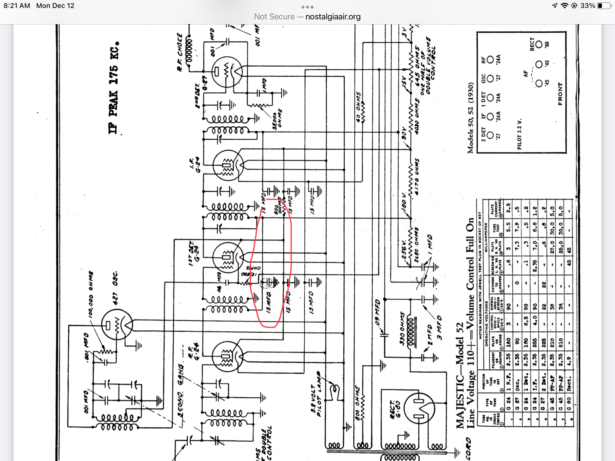

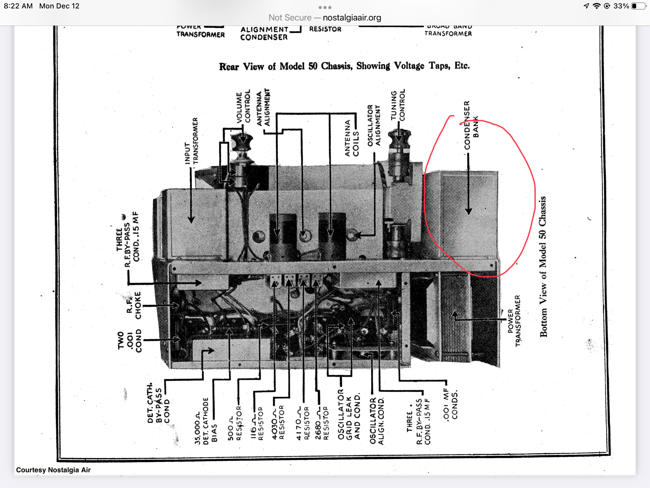

Progress moving along! I have recapped this beast except for 4 electrolytics that are entombed in tar inside a huge armored box that I have circled in the attached photos. Also found what appears to be a mistake at the factory. On the schematic, the plate circuits for the RF amp and 1st detector are tied together as can be seen in red are on the schematic. Upon doing continuity checking and tracing wires, I can’t find continuity between the plate circuits. I fired it up to take voltage readings and both plates should be at 180v per schematic. The RF amp reads correct but the 1st detector is around 255v, clearly too high and proving both circuits aren’t being sourced from the same B+ as they should be. Drove me nuts tracking it down and I’ve come to the conclusion that it was wired wrong at the factory. It all looks original, not altered so I rewired the 1st detector so that it ties in with the same 180v source as the RF amp and it works. Need to gut that big box for the electrolytics yet and do an alignment. I will see how that goes!

Ron, the voltage chart confirms your actions, 180 on both plates. It's a real mystery as to how it got that way.

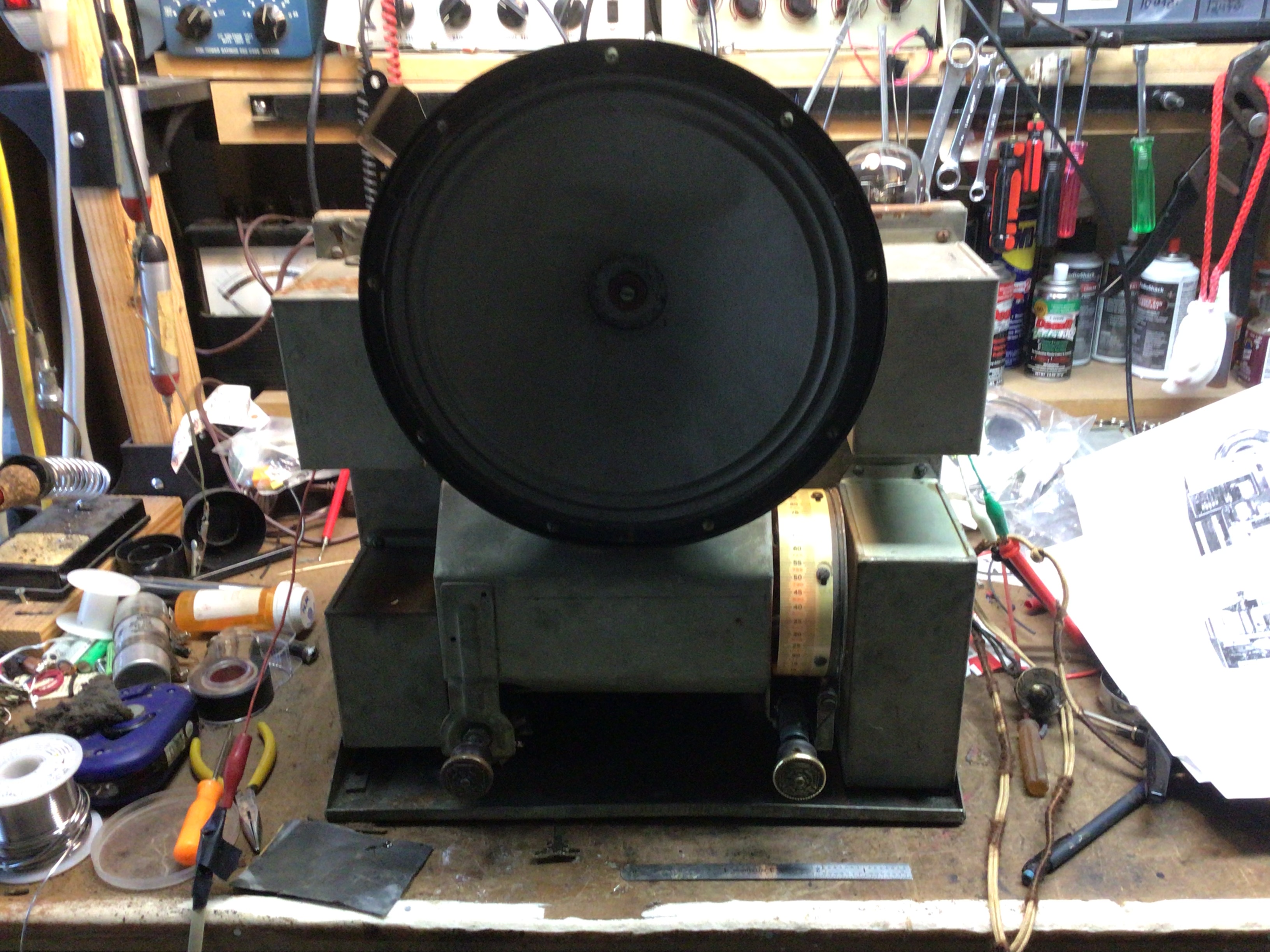

I’m pretty much done with all the electronic work except I still need to replace the cloth covered line cord. In doing the alignment, the set started motor boating which would change with the slightest tap on the chassis. Tracked it down to a bad ground rivet on the IF amp socket. It affected how well the tube shield would stay grounded. With the bad ground the shield wasn’t working properly thus allowing for strange oscillations and motor boating. I will order some new cloth covered line cord and antique plug. All that’s really left now is to refinish the cabinet which is partially stripped but that needs to wait til spring to do outside. Then a new grille cloth!

Grigsby Grunow seems to have been like Rogers, they were not into sparing the steel, most of their chassis are made out of heavier gauge sheet metal, and lots of it. Also, given the design of some of their chassis it's a wonder how they were assembled on a production line basis. Judging by the values of the filter caps,1,  2, and 3 uf, respectively, the filter caps were probably paper rather then electrolytics, so motor run caps, or Solen fast caps, will work as substitutes, and likely outlive you. It's not really recommended to replace such caps with electrolytics anyhow as the modern types in that size will not like the ripple current, I think Terry tried some in a Radiola set, and one of them short circuited within a year.
Yes Aaran I replaced that 2mfd cap coming off the 80 with a Solen cap. It amazes me how there is no hum in this set with such low value caps as that 2 mfd and the 3 mfd that comes after the choke and the big speaker! As for all the steel they used on this chassis, it not only made it crazy heavy but also very difficult to trace things and work on. It’s the worst chassis I’ve ever worked on but it is a decent performer considering the age of the design!

Unfortunately, the spider (or lack thereof), reminiscent of the Philco 20 speaker probably detracts from the sound.
I remember finding one of these speakers (without the radio) at the local landfill as a kid in the 1960s. I didn't keep it due to the condition, but I did realize that it was from the very early 1930s. It was not common to find real early radios in our landfill, as the large majority of the houses in Huntington Township were built in the mid 1950s (Although I did find a 1929 Radiola 62 chassis once). My friend did find a Scott Philharmonic that I fixed for him. He moved away, and I lost contact. I don't know if he still has it.
MrFixr the sound is pretty decent as this is a 10” speaker but admittedly not as good as some radios from the 40s or even late 30s. I attribute that to possibly the type of 2nd detector, almost like my Philco 70. This set doesn’t appear to have a separate spider but instead, it’s all part of the speaker cone like it was all formed at the same time. The cone is in great shape luckily.
RodB you are correct about the choke doing a good job. This set has not only a separate choke but also use the field coil too!
