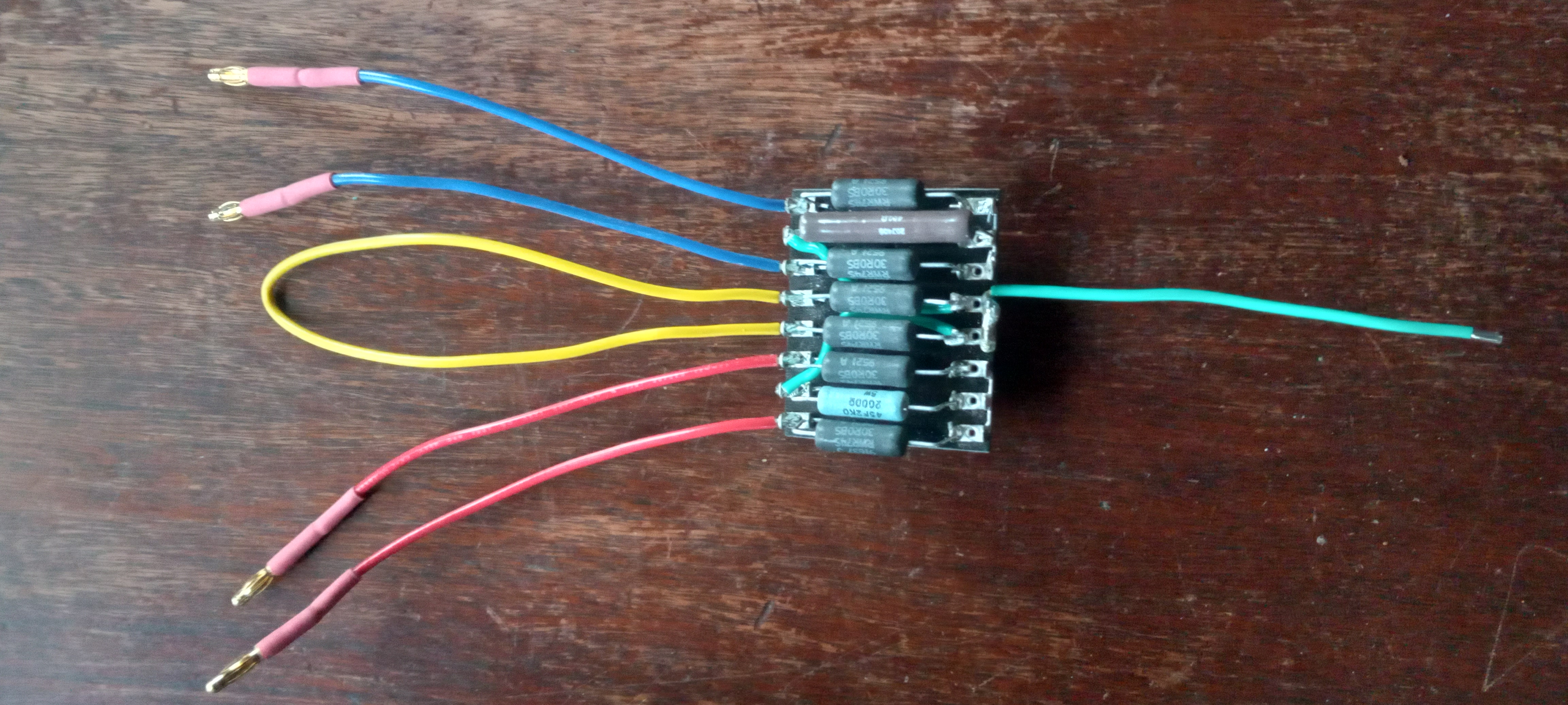

Small progress, I've soldered 3 pairs of 30 Ohm resistors in series for the cathode bias with a 400 Ohm center tap between one pair, a 2000 Ohm between a second pair, and no resistor between the 3rd pair. I had bought 30 Ohm wire wound as these were specified on the Radiola Guy schematic. Hopefully these will work temporarily, I can order 20 Ohm later. All of the above are 5 Watt. I've attached a photo. I can plug this assembly into the 0-30 V power supplies using stacked banana plugs to connect to the audio section terminal strip. I'll also figure out a connection to the far right
"Output" shown on the right side of the schematic, which connects to the 1875 Ohm center tap resistor shown on the Radiola Guy schematic that connects to the 5V PS.
I used a 2000 Ohm resistor rather than 1875 Ohm as this is what I could find to purchase.

I assume that the yellow wire will be cut and will be the center tap for the 2.5V line. This all looks good electrically, and extremely good mechanically.
Yes, the yellow wire is to be cut and connected to a 3rd DC PS to power the R-18 radio section. I don't need that voltage though for the audio section #26 and #71-A tube filaments so I'll leave it out of the circuit. I'll cut the yellow wire before connecting the new audio section and insulate the ends.
I'll also connect a wire between one output/speaker banana jack/post on the PS to the junction of the blue/gray 2000 Ohm resistor and the black 30 Ohm resistors either side of it. This appears to be the correct location for that connection, looking at the schematic.

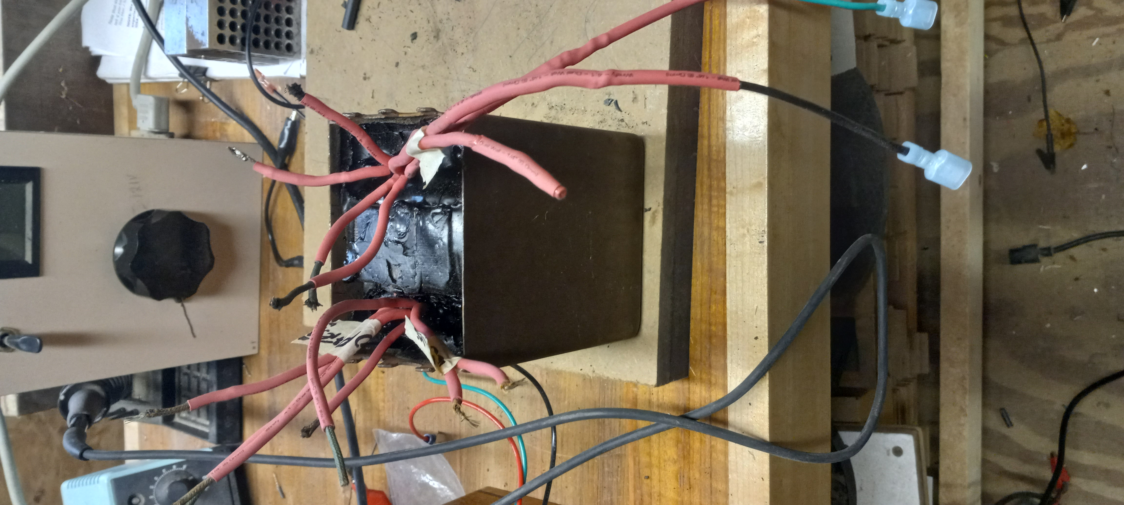

I've looked at the two extra Radiola 18 power supplies I have. Much of the point-to-point insulation on one is crumbling but the transformer wires seem safe. Perhaps I can carefully cut these leaving as much length as practical extending from the transformer then shrink tubing over the wires carefully. Perhaps the transformer is still OK, and re-starting this project with it may produce better results.
The transformer leads are deteriorated, but seem sufficiently intact and are easily reinforced with the shrink tubing, which has a heat setting adhesive that may make the old leads sufficiently robust. This would not however be safe enough for use on campus.
I fpund the 2 leads that have highest resistance for the 110/120V AC input, ~3.4 Ohms vs. 4.1 Ohms. I'm using the 4.1 Ohm pair for input. I also tested the high voltage output at 699 VAC, and the #80 tube filament voltage at 6VAC. I need to try the centertap lead, and I have yet to test the remaining leads, but they are now as safely covered as I can make them.
The insulation on the old leads had broken down where the wire was bent around parts of the chassis and/or near connections. I suspect it was potentially deadly left as it was. It had crumbled and fallen iff in several places.
Applying heat near the "tar-like" substance in th     e transformer is interesting, it seems to vaporize at a fairly low temperature, I suspect its flash point isn't much above the heat gun temperature. All very interesting!
