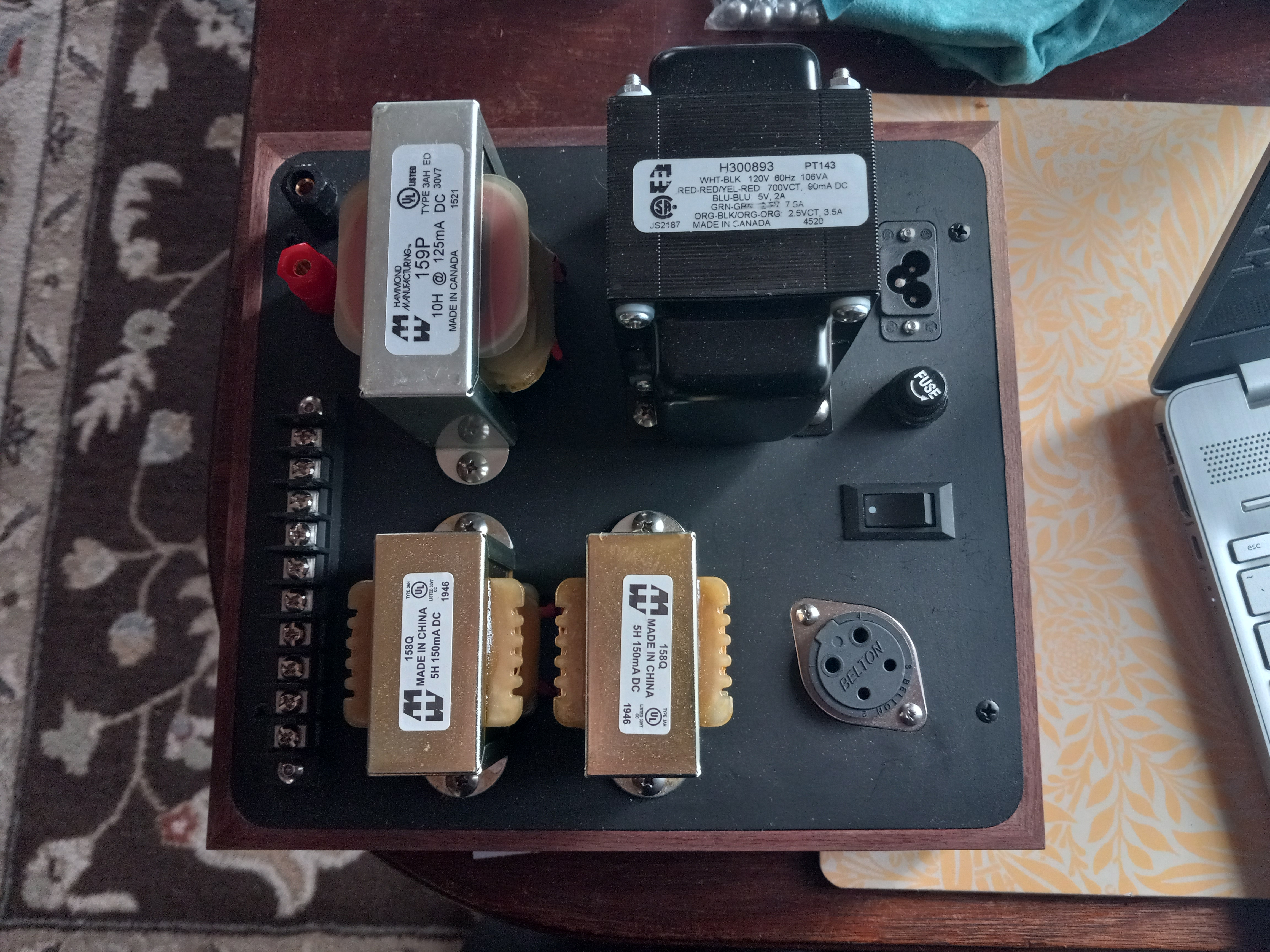

I have a Hammond PT143 transformer with the required voltages except the 1.5V, I thought perhaps the 1.25V from the 2.5V CT might suffice for the #26 tube, or a resistor to drop the 2.5V to 1.5V. Unfortunately I am somewhat new to electronics.
I'm using Radiola Guy's schematic and booklet for component specifications.
I have included a photo of the PS. I think I have all the necessary components, but have yet to solder it all together.
I have this PS transformer:
https://www.tubesandmore.com/products/tr...v-70-90-ma
Hi TN,
a wonderful layout on that power supply, beautiful looking.
IMHO, yes, using 1.25 from the 2.5V winding would work, assuming y\that you are installing the "hum balance" rheostats used in the original PS. An alternative, if you have them is to replace the '26s with '01As, get an old computer power supply and use the 5V DC to power all the tubes except the '27. There will be much less hum.

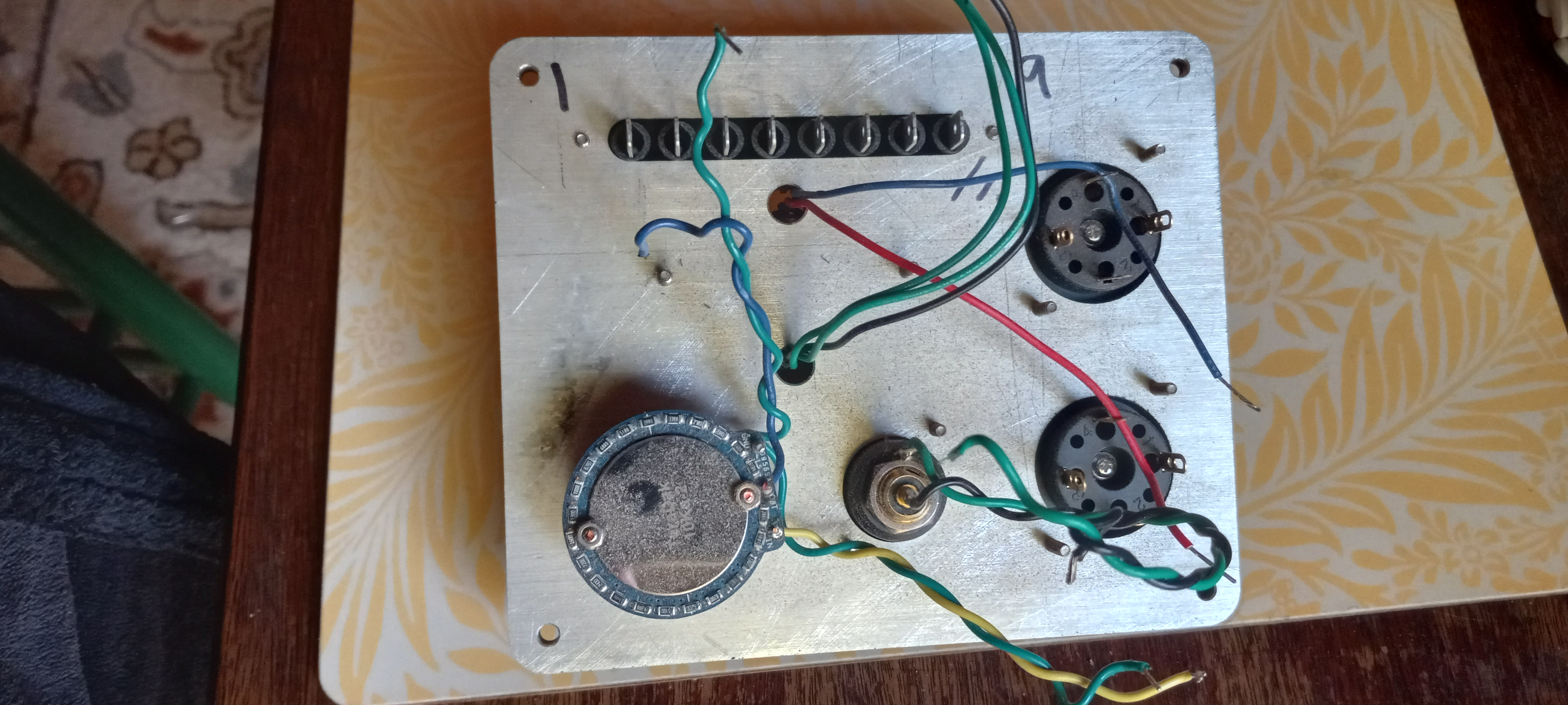

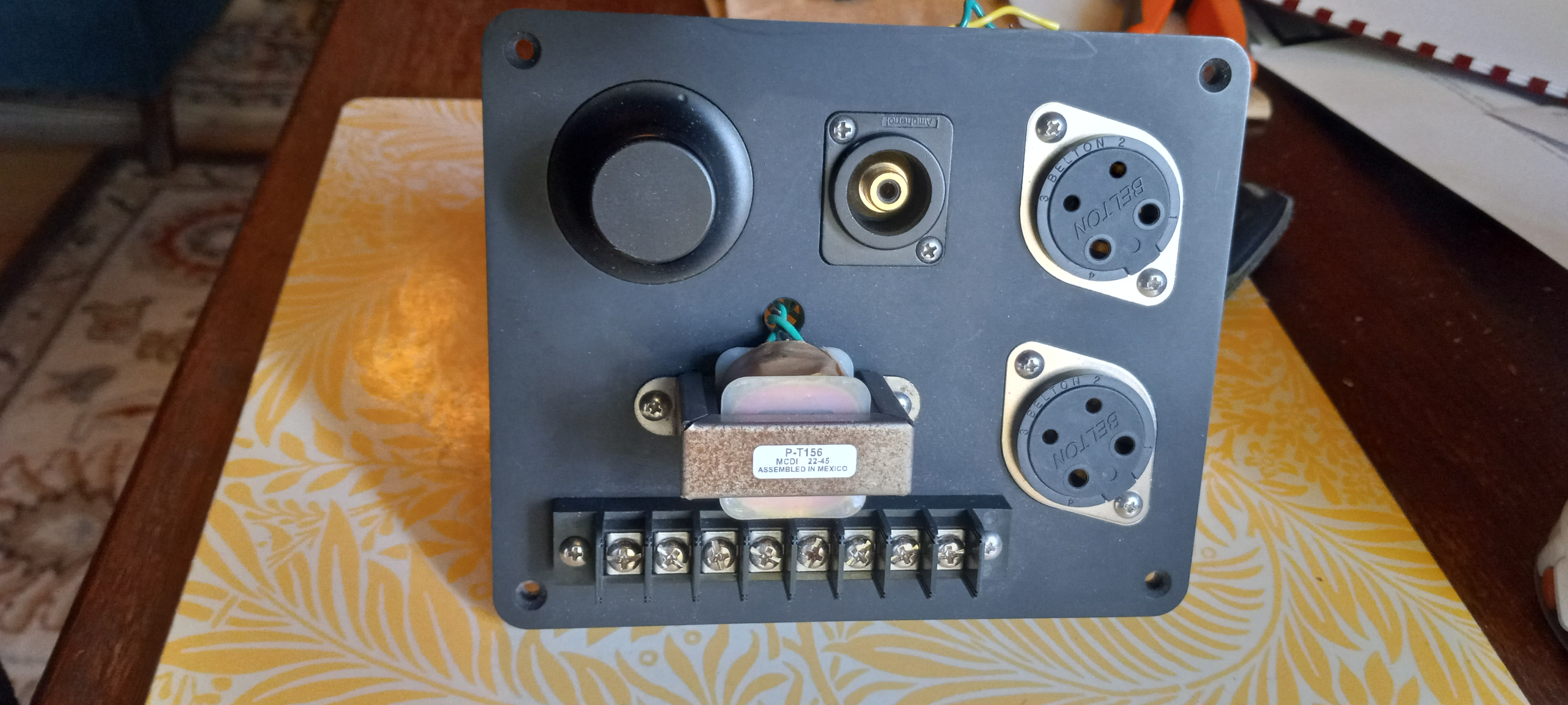

I have returned to this project after a few medical distractions, and have started soldering the connections. I teach at a small engineering college, Maine Maritime Academy, and after describing this project we concluded students in the campus Radio Club may find it interesting. Consequently I'm back at it. I will greatly appreciate any additional assistance regarding the following.
I suspect using the single 5V filament supply on the new power transformer on both the UX-171-A and UX-80 may not work well as it is also part of the output circuit. This is an uneducated guess on my part as I don't understand tge circuit well, but suspect 2 5V power transformer outputs were used on the original transformer to separate the UX-171-A filament circuit from the UX-280 filament circuit. I have a 5V 10A DC power supply that I think might be a good substitute.
I am also not certain about the audio section interstage transformer connections. The P-T156 transformer has blue and red wires on one side which I assume are the input. These should connect to the UX-226 plate and the #7 connector on the terminal strip. The 2 green and single black wires from the other side have me puzzled. I know black is the center tap, but where are the 2 green wires to be connected?
I've attached photos of the top and bottom chasis plate.
Thank you, tna
Separate filament windings are required for the 71a and the 80.
The PT-156 look carefully at the two green wires the one closest to the core is the start and will be the A- or bias connection the green closest to the outside of the core is the grid connection.
Or. measure the two windings green to black and black to green the winding that has the least resistance will be the A- side therefor that associated green would go to bias. The winding black to green that has more resistance because it has greater length, that associated green goes to the grid. Use a D'Arsonval meter to measure the transformer.
The P-T156 may not have sufficient plate impedance for the 26 tube so there may be distortion. Try adjusting the bias. If that does not work then another choice for the inter-stage transformer. This replacement transformer is bobbin wound, there are no layers of glassine between the windings...
 The 71a has a relatively high plate impedance look for a 5k impedance transformer.
