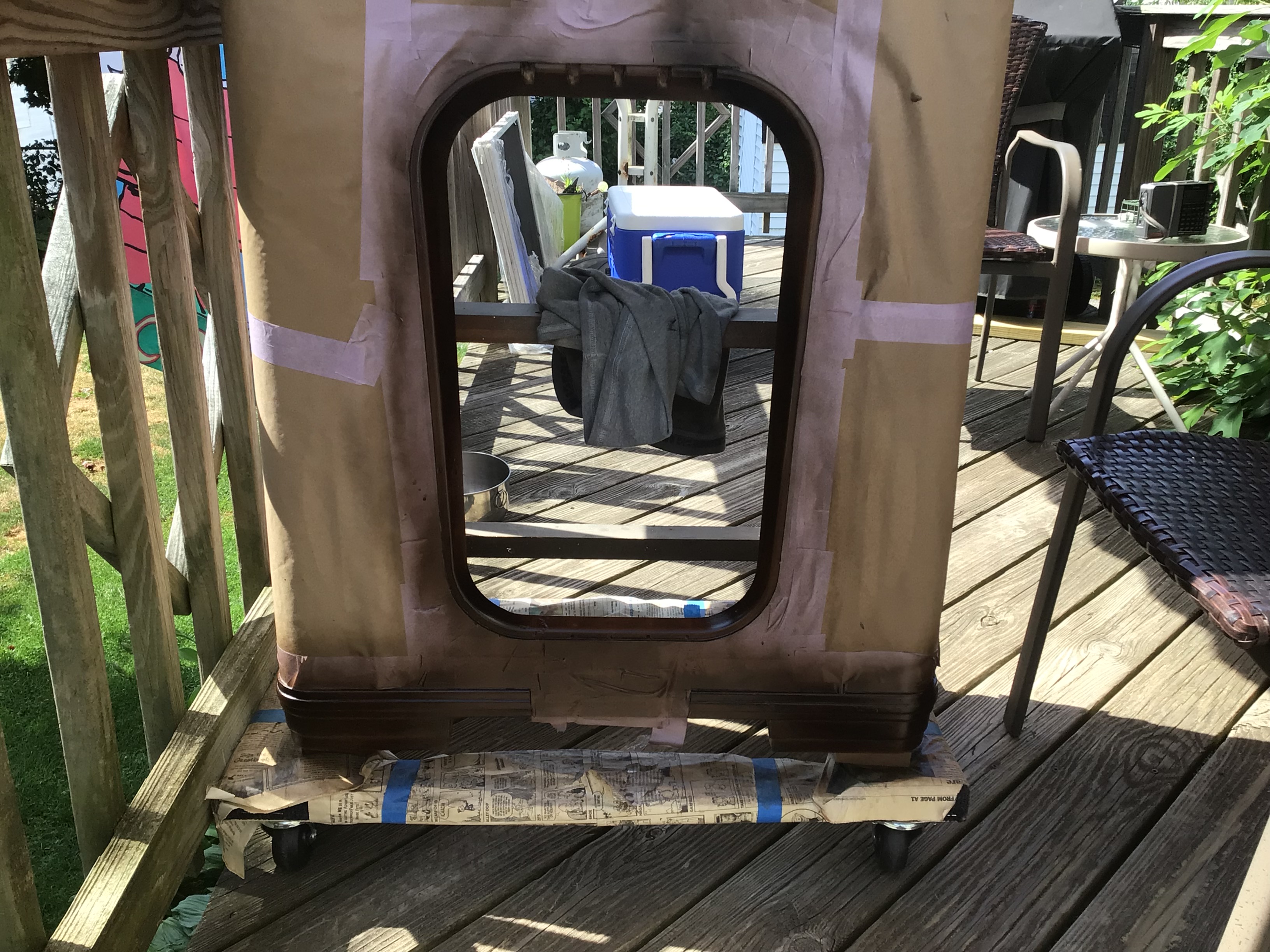

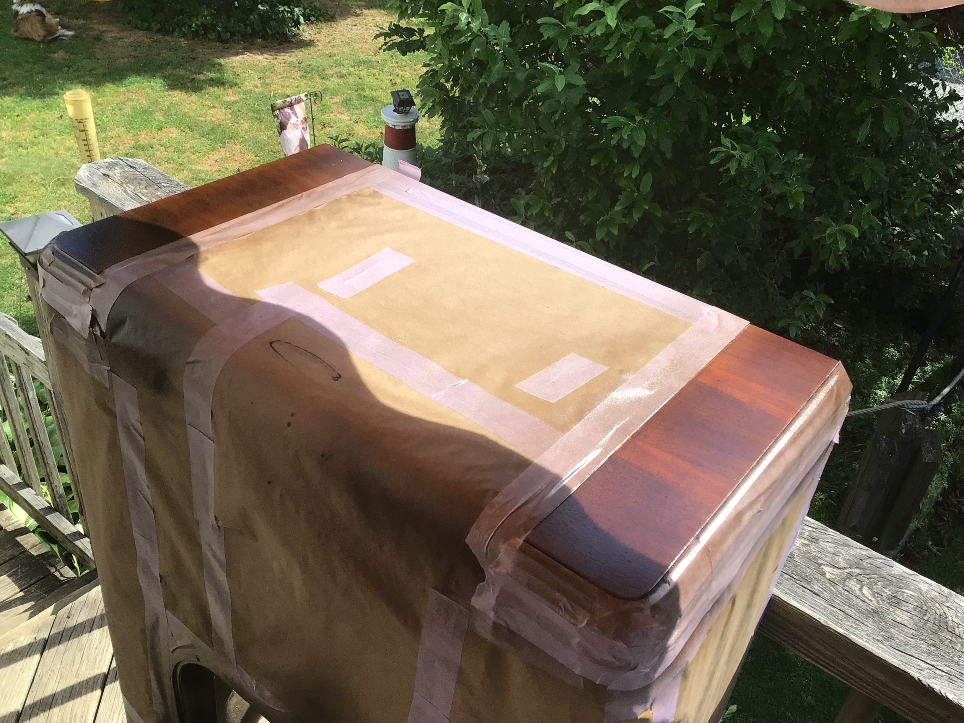

OK, winter doldrums are over so it’s back to spraying toner on my 37-116. Now I need to time my spraying days between days that are too windy or too humid. So was able to spray the trim with Mohawk Ultra Dark Walnut. Soon I will be able to do the cabinet body!

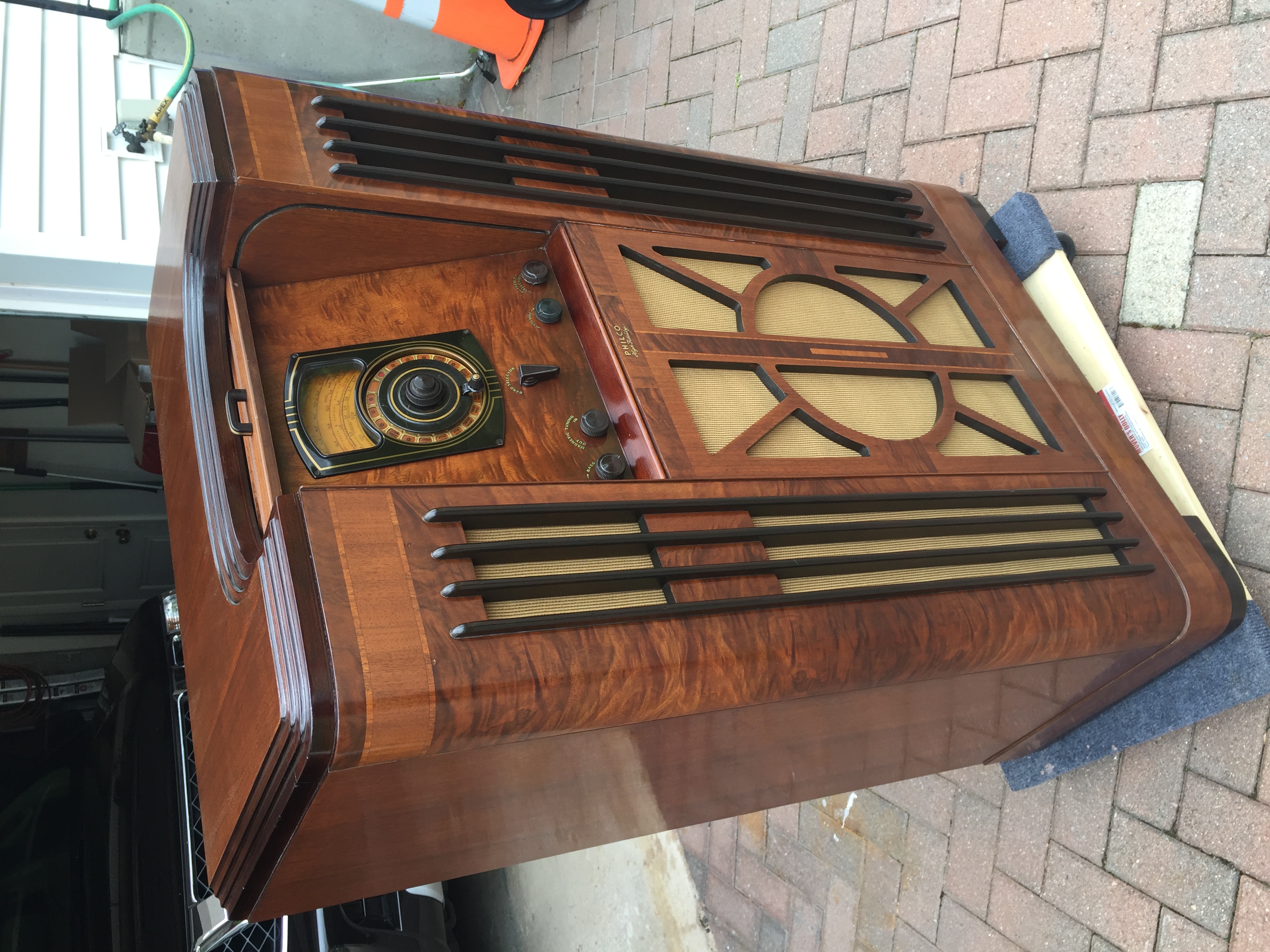

Hi all, making slow progress on refinishing my cabinet. Had to stop last fall as I ran out of good weather. Started back up this year but getting a day with low enough humidity, not raining or not too windy has been a challenge. Anyway, I am almost to the point of applying the last coat of clear lacquer and want to know if I can use automotive rubbing compound on the cabinet once it cures? Thanks for any advice!

Hi Joseph, I completely stripped the old finish from the cabinet and then washed it down with lacquer thinner, then OMS. Then sprayed on clear sealer then applied grain filler and rubbed it off. Then a few coats of colored lacquer and lastly several coats of clear gloss lacquer. After a few weeks to give it time to cure you can then use a rubbing compound to sort of even out the finish and smooth it then rub down with a paste wood wax. I have automotive rubbing compound just not sure if I can use that.
10 years ago I did a 6 hour round trip to buy this radio. I have gone through the
chassis long ago and kept procrastinating on refinishing the cabinet ever since. I don’t like doing cabinet work at all Icon_mad I figured it was time already to get this thing done!
