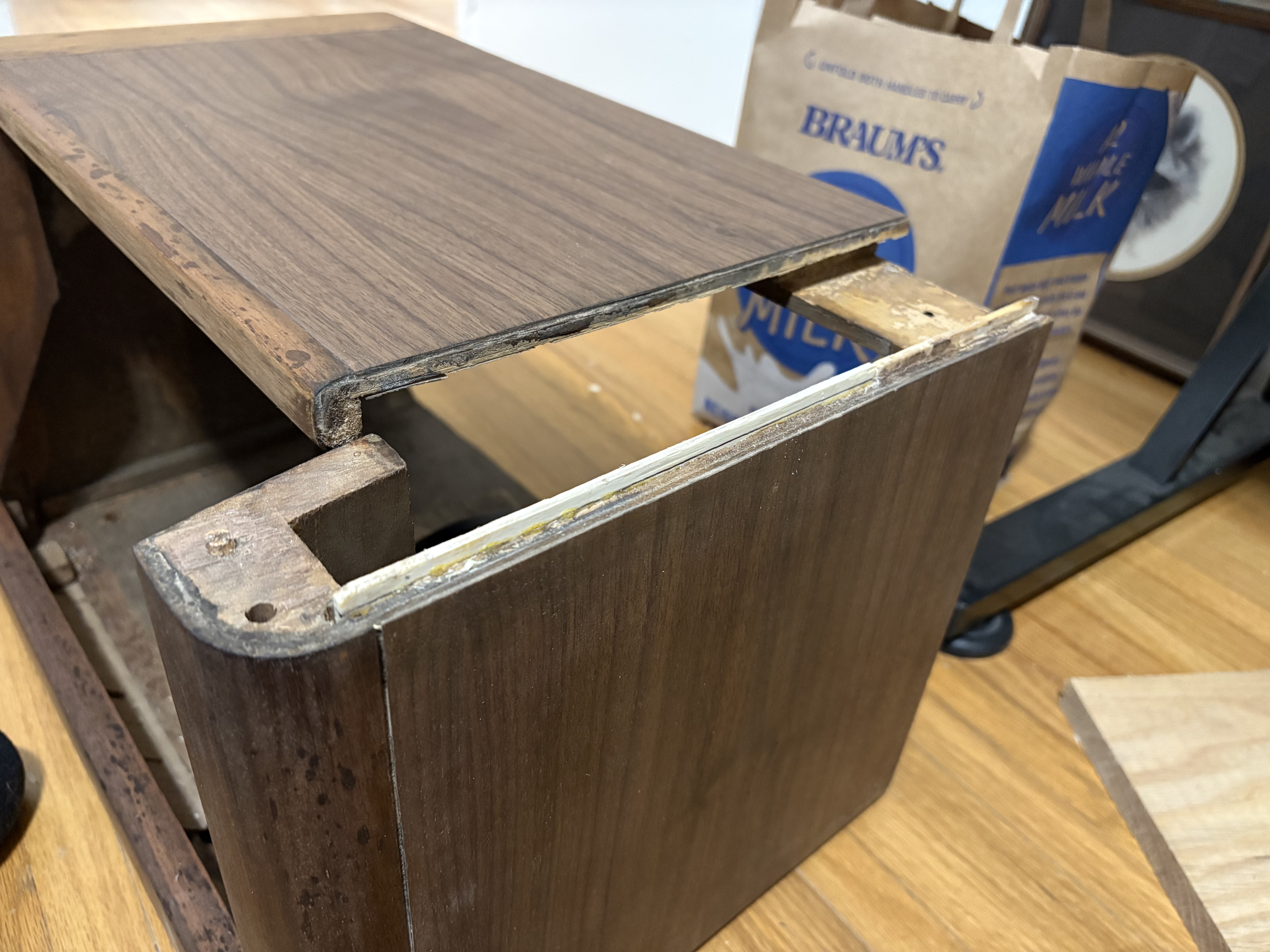

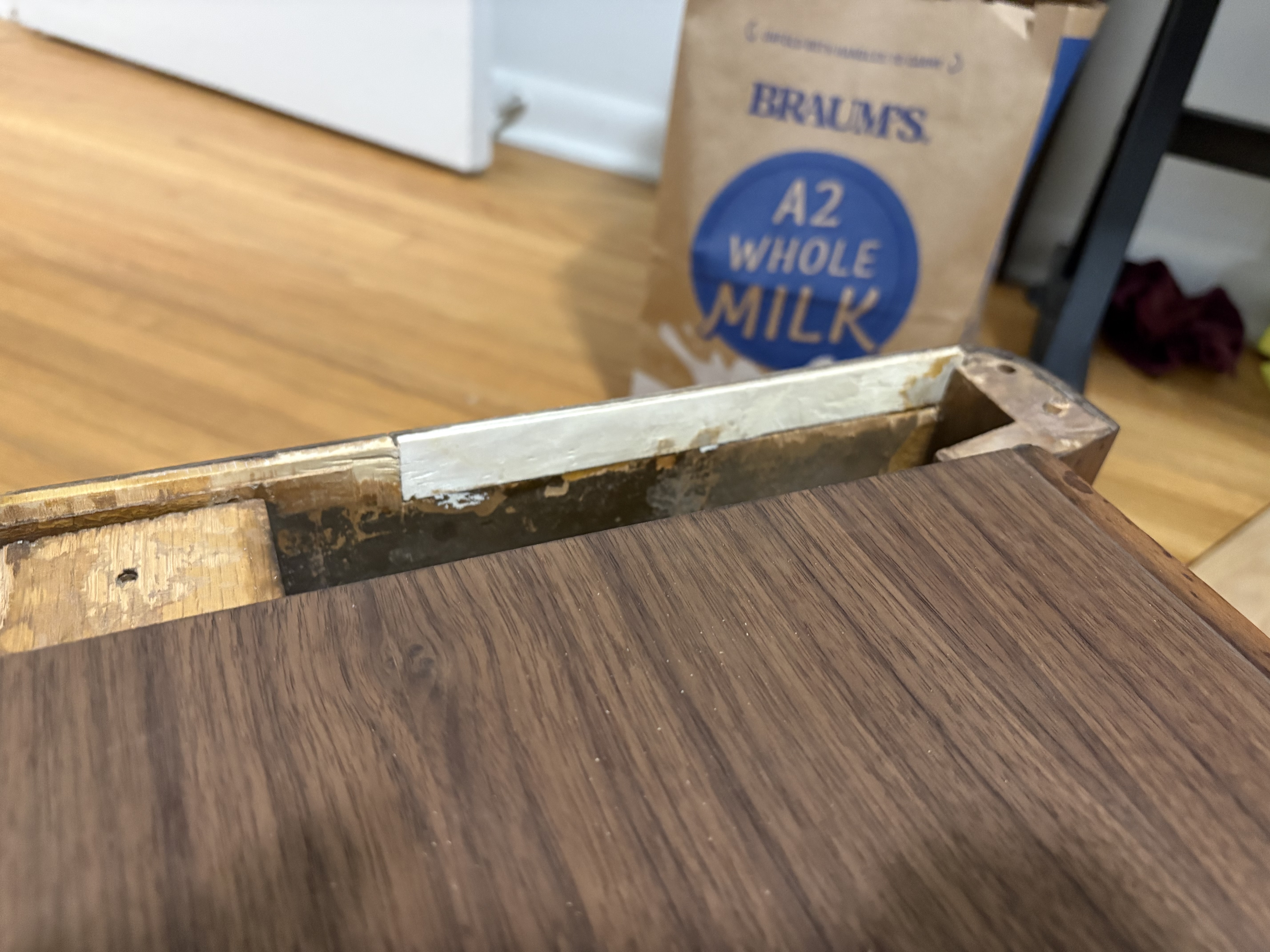

That said, I had been working on furnishing a replacement groove for the broken portion under the right-hand shoulder just as my dog got injured.
I glued it into place one night when I had just a few minutes, and clamped it tightly. Here it is, repaired.

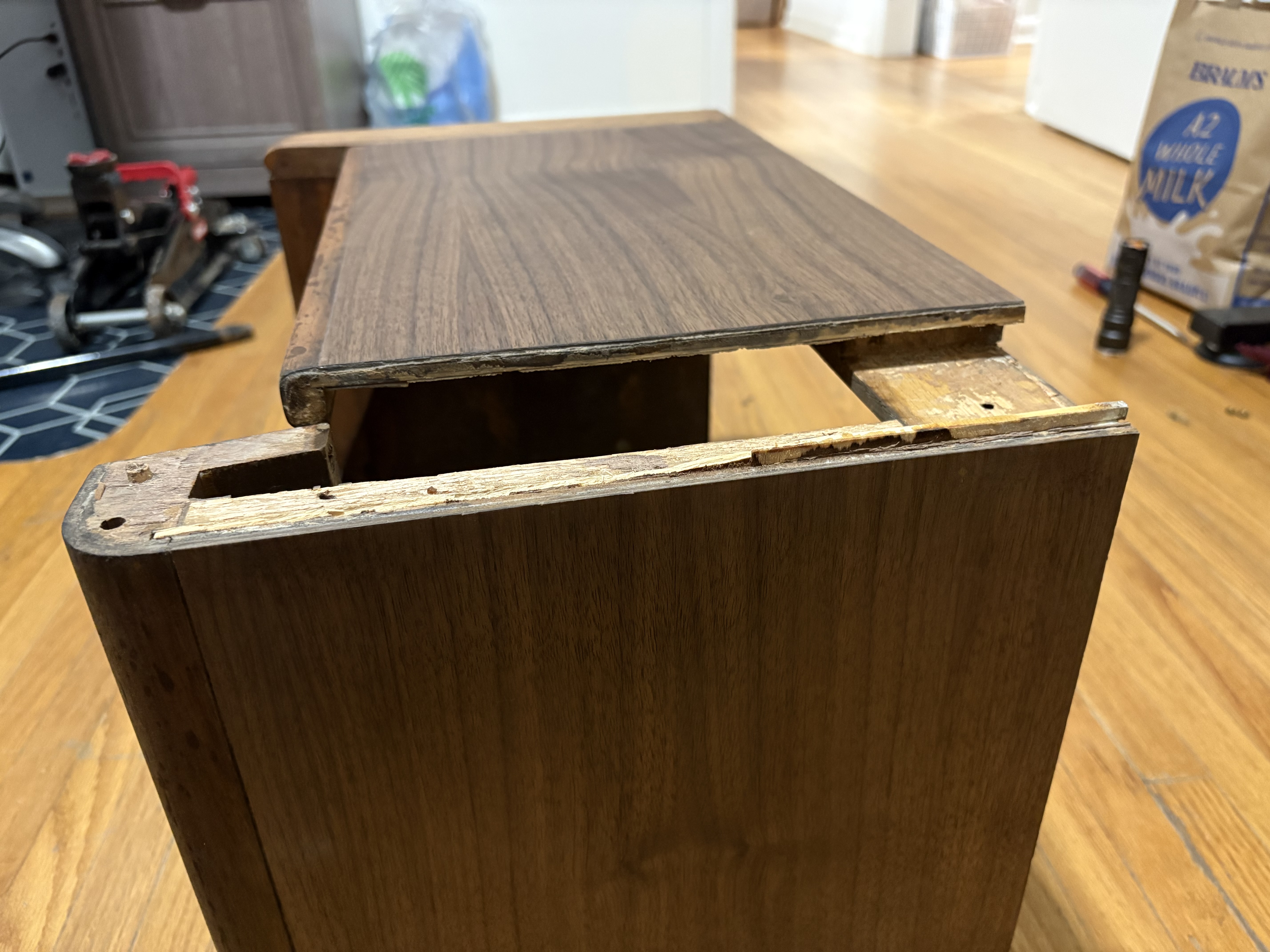

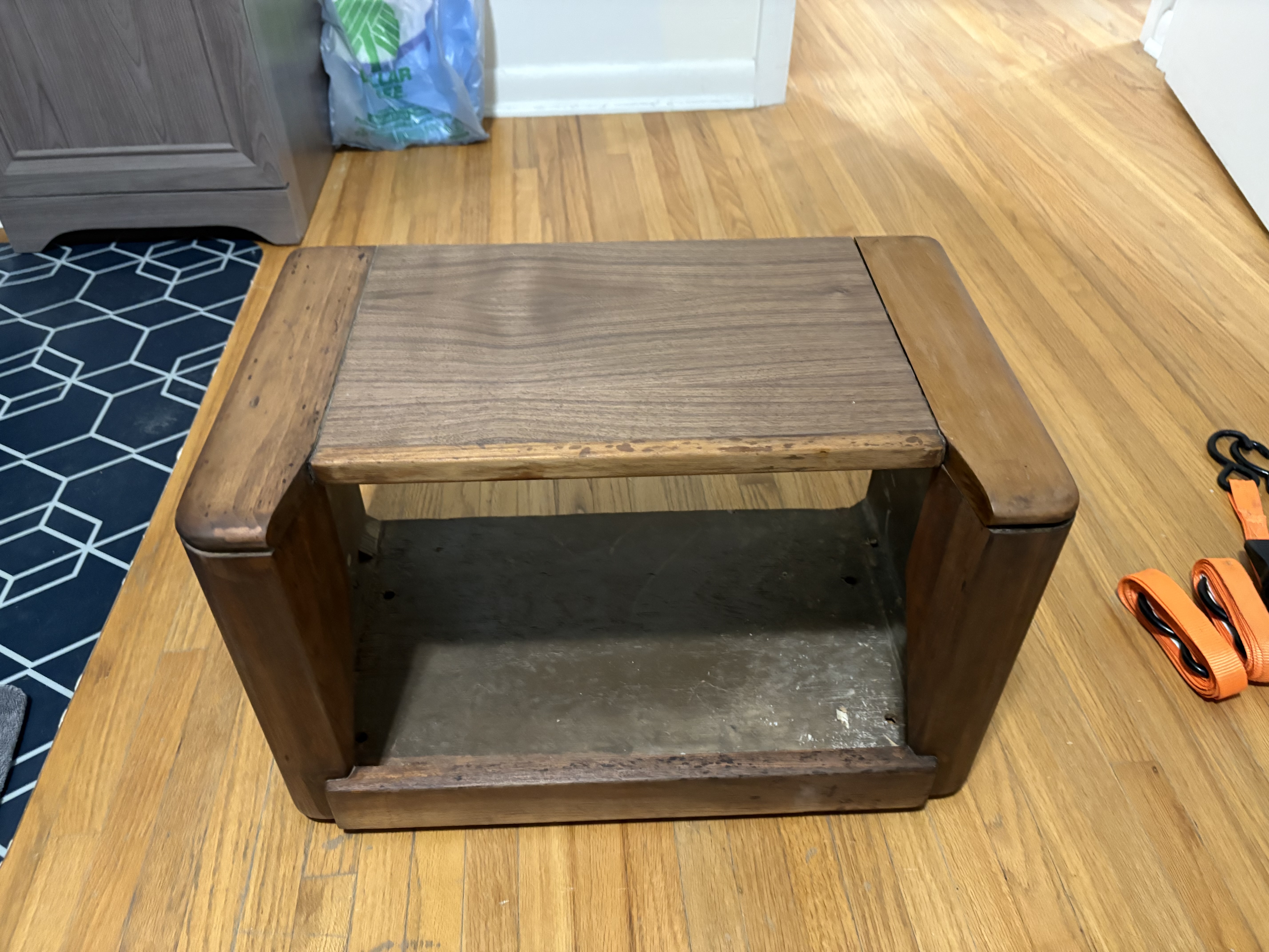

It took a lot of test fitting without any glue to get the new shoulder to line up properly with the rest of the radio, but at last I got it. I fiddled with it for about an hour this evening, and then finally added the glue to all of the joints and screwed it down. I’ve got some clamps and ratcheting straps holding the cabinet tightly together while the glue sets. I’ll be able to show the end result tomorrow once it’s set and I can unclamp it all.

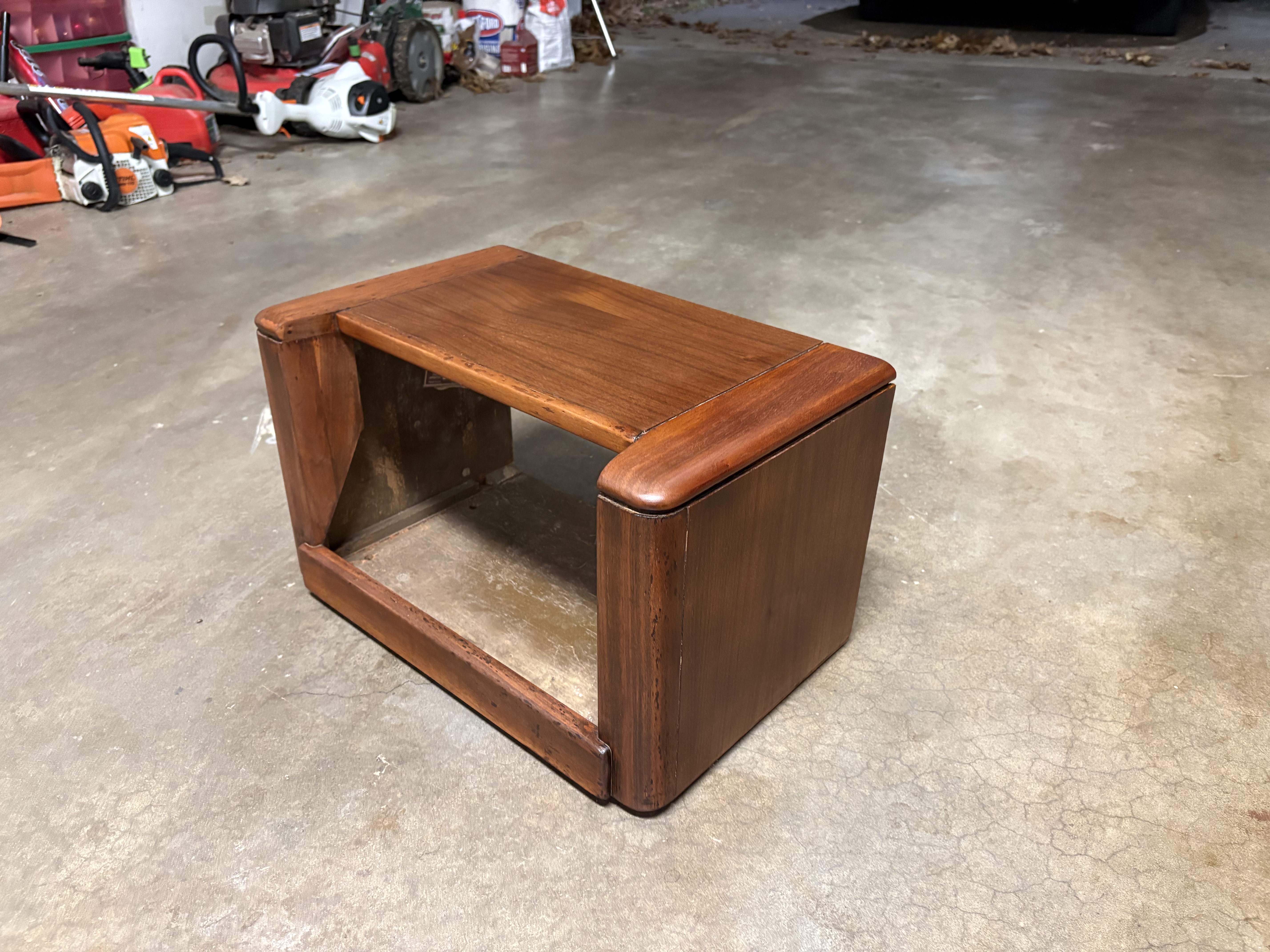

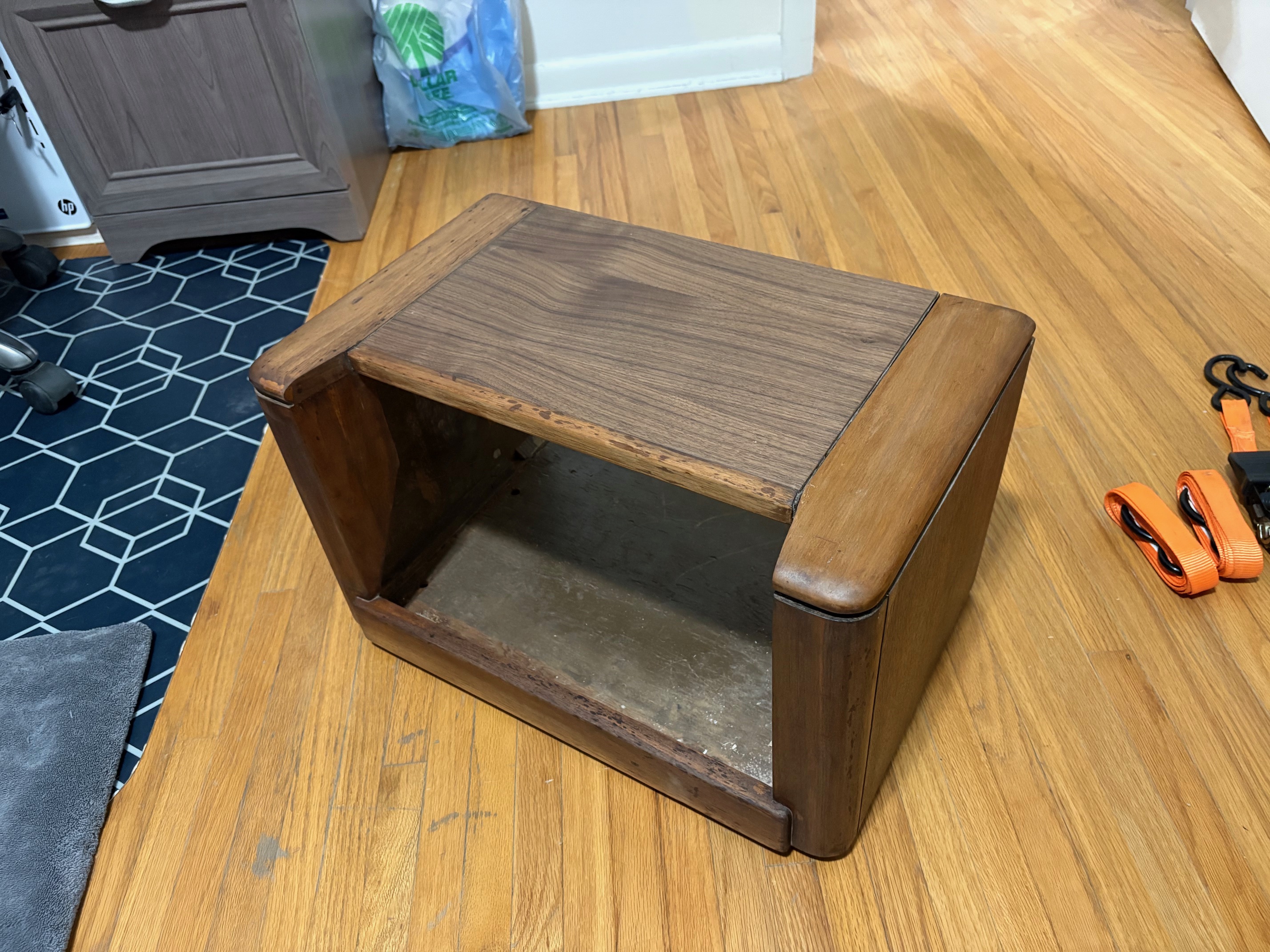

And here we are, with the new shoulder installed. It’s looking better already! Now I’ve just got to get down to work on blending the color of the new veneer to the old wood.

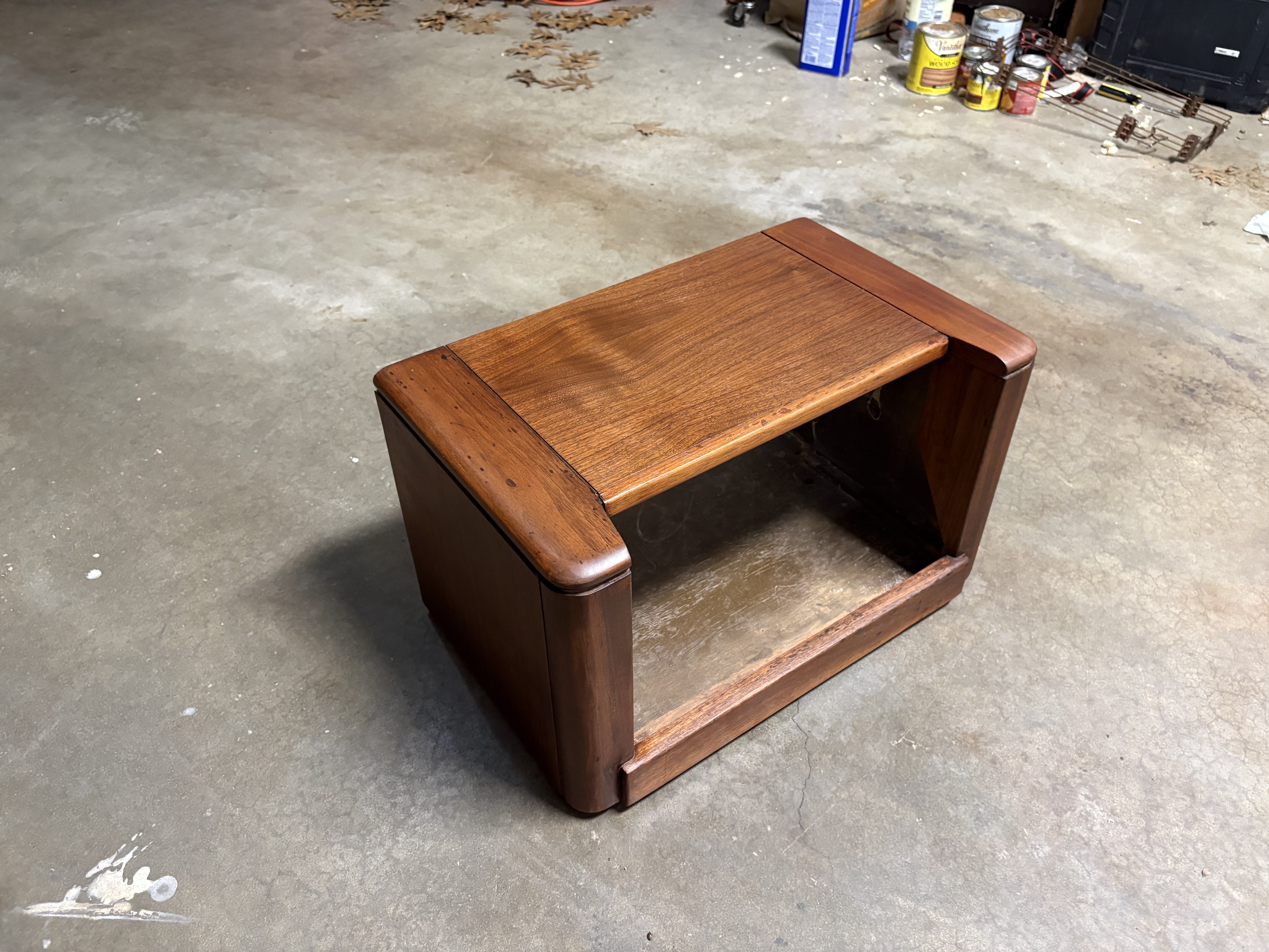

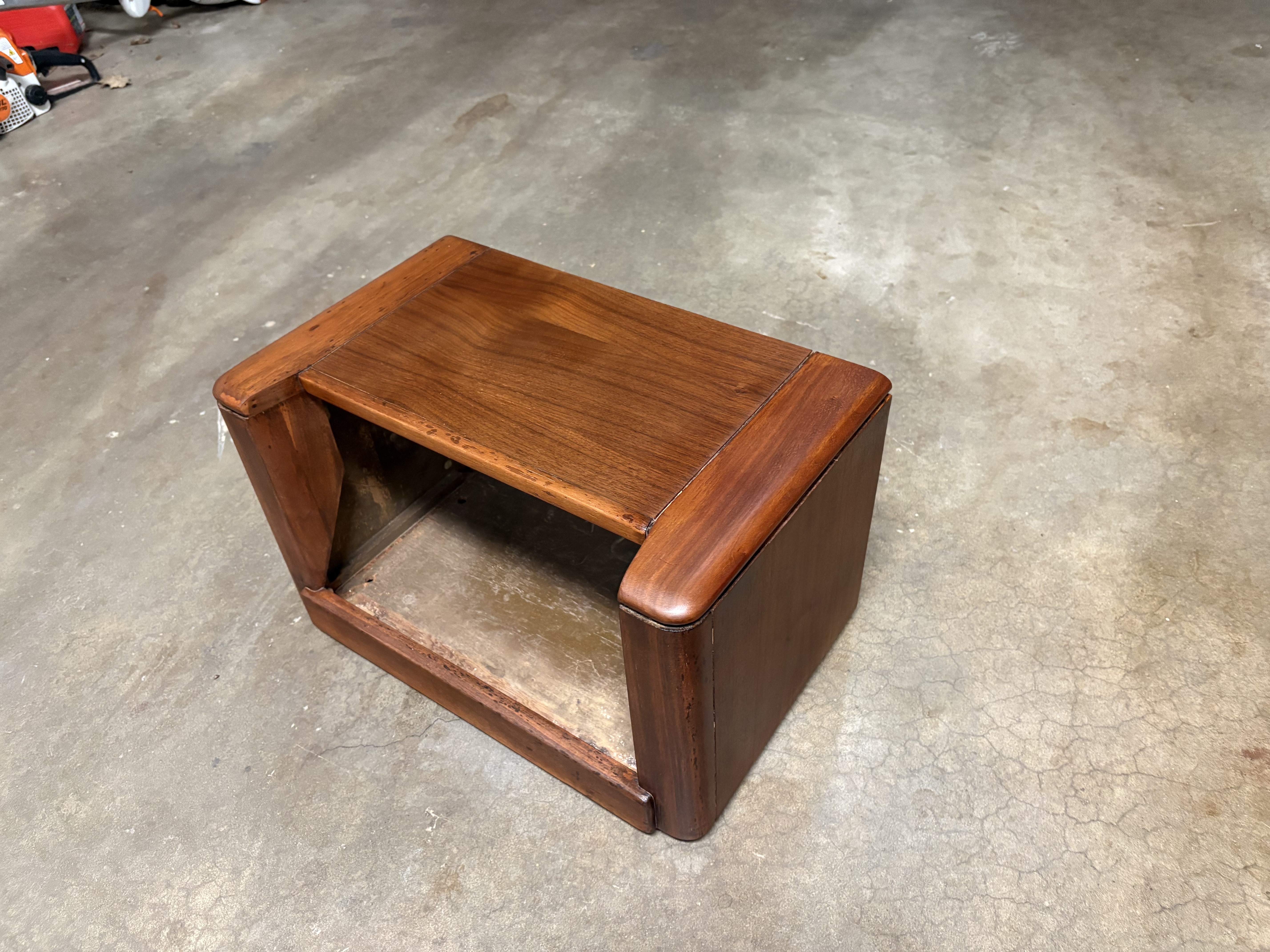

I had a whale of a time blending the color of the new veneer with the older wood, but I think I am finally satisfied. I started doing my research after Arran mentioned the wood dye. We have a store here in Tulsa called Wood Craft, and I discovered that they sell dyes. I got two colors, an auburn (for some orange) and a deep maple (to add some yellow). I bought the kind of dye in a concentrated dropper bottle much like a food coloring squeeze bottle, to be diluted with water or denatured alcohol. I mixed a bit of each into water and treated the new veneer. At this point the wood was much too yellow orange, but it all started coming together when I then used the regular wood stain on top. I used a bit of cherry stain, cut with mineral spirits and then a bit of walnut gel stain. The new and old wood was getting very close, but still the new lacked a bit of red. I was able to blend it all together with some cherry toner. Here’s the final result.

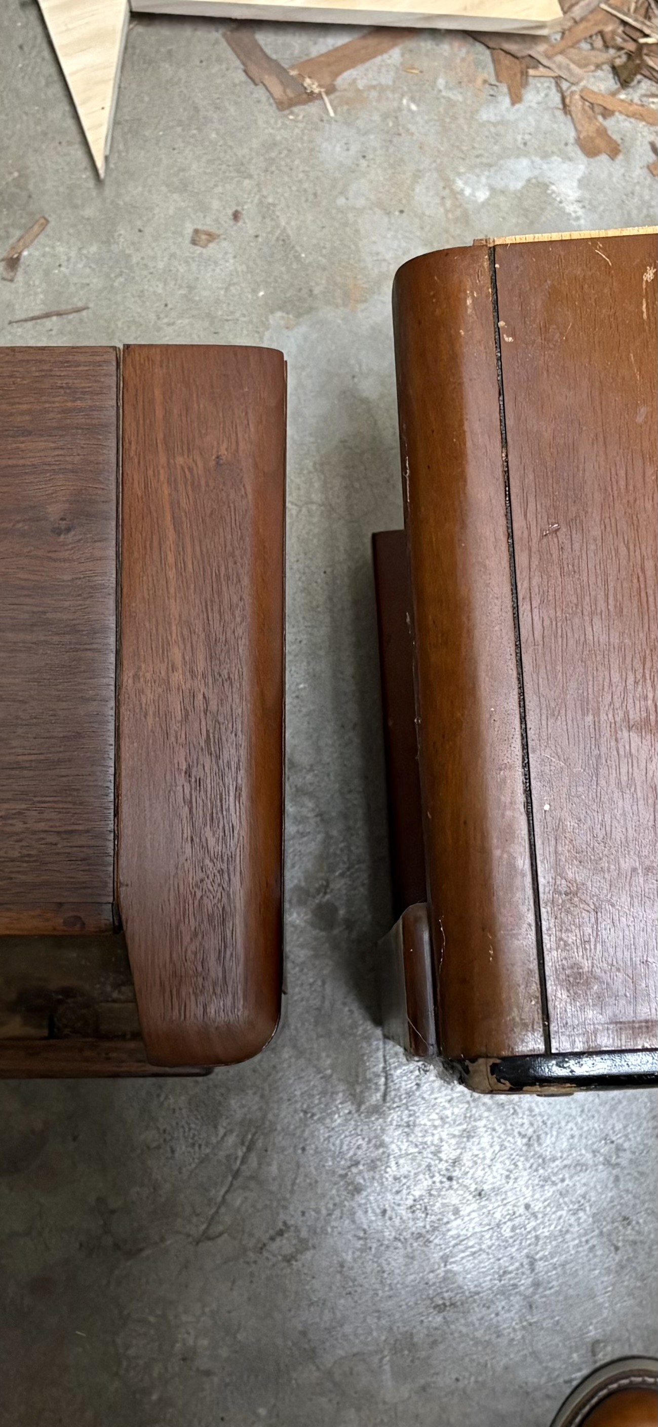

It’s definitely a darker tone than this radio came to me, but I’m thinking it was faded. The junker radio I got over west of Tulsa in Sand Springs had a much richer tone. I sought to match that, and I think I did okay! Here’s a photo comparing against one of the undamaged side panels on the junker.

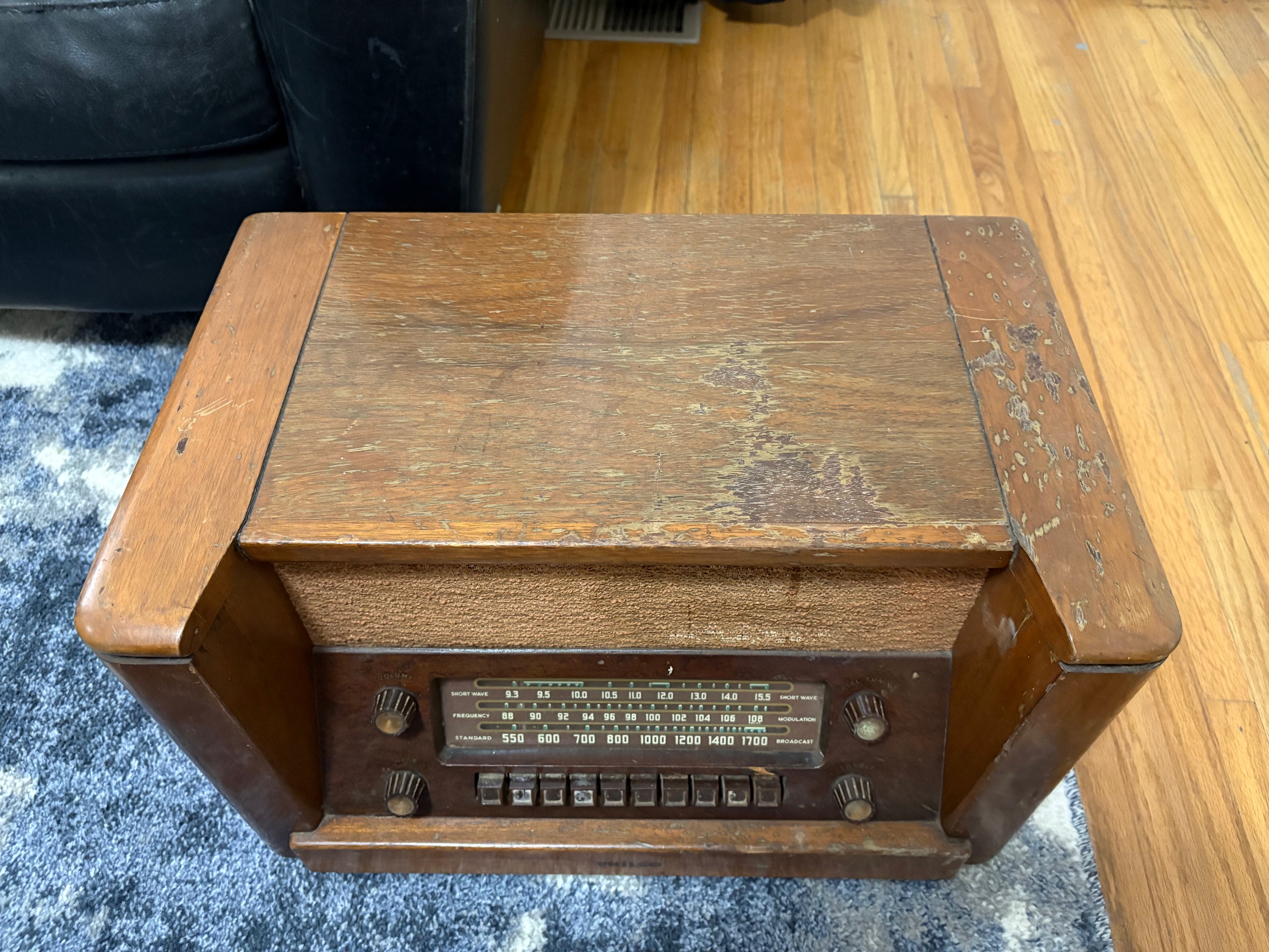

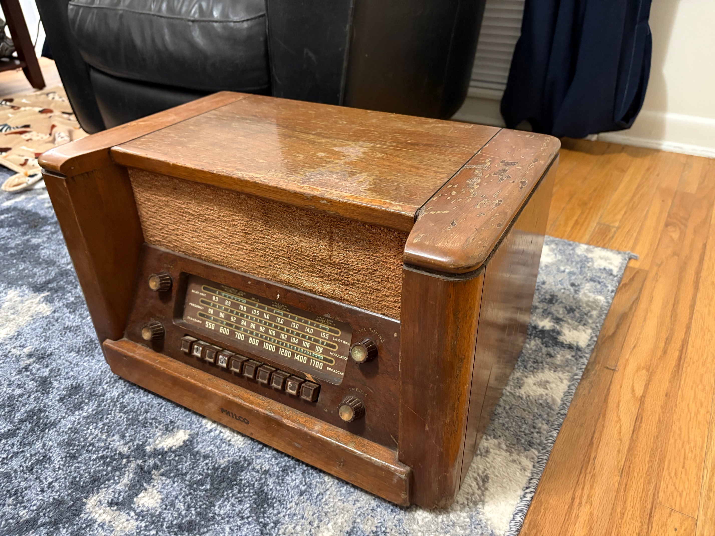

Color and finishing are definitely not my forte, and I feel like the crazy artist who is never satisfied with his work. But I do feel pretty good about the end result. It’s got a bit of remaining damage from whatever splattered on it in the past and damaged the wood, but the worst of it is gone. If anything it adds character to tell a story, but it still looks nice and I wouldn’t mind showing it in my living room. I don’t believe I ever attached a photo of the radio as I received it, so here we are.

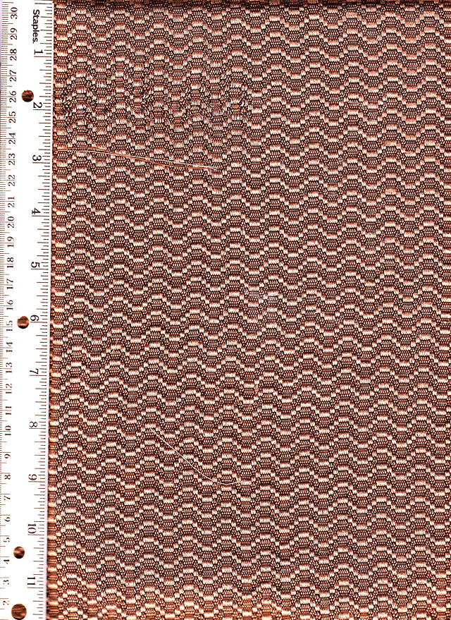

Thank you very much! Next will be the control panel, and finally the speaker fabric. I had looked through Michael Katz’s selection of fabrics, but didn’t see a close substitute. I emailed him to ask which style(s) he may personally recommend, and his suggestion was the #31.
However, he did comment that he expects to have more styles in stock early next year, and thought that perhaps some would be a better option. He advised I check back with him in February.

have you looked at Radio Daz's grille cloth !!
http://=https://www.radiodaze.com/grille...lle-cloth/
I had not! I’m familiar with Radio Daze, but I suppose I glossed over the fact that they carry speaker grille cloth. Their style #14 may also be a viable option.
