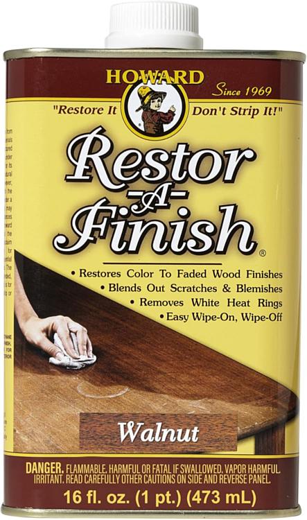

I am asking myself this question: should I refinish the board. On one hand, there was that beautiful walnut finish that survived under the output amp.
On the other hand, it is not bad as it is, and it shows that patina that should be there after 102 years. And some furniture cleaners-restorers could probably revitalize it a bit.
What do you guys think?

I would not refinish the AK and try restoring the finish first !

Try the revitalizing, it shouldn't take a big effort, if that doesn't come out right do the refinish. You'll have time.

I agree with others. Do not refinish. Clean/treat/polish
What are the good clean/treat/polish snake oils' names?
And in what sequence do I apply them?

Start with using the hand cleaner, as you probably would, then see what's under the dirt, after that you can decide what the next step is. It may look perfectly acceptable without doing anything else.

In a similar case, I use the "Restore-A-Finish" after cleaning .
Restor-A-Finish on Amazon

Yeah, I thought of first using GoJo or Goop.
Then see what's there.

Gojo or goop will do wonders for you !
