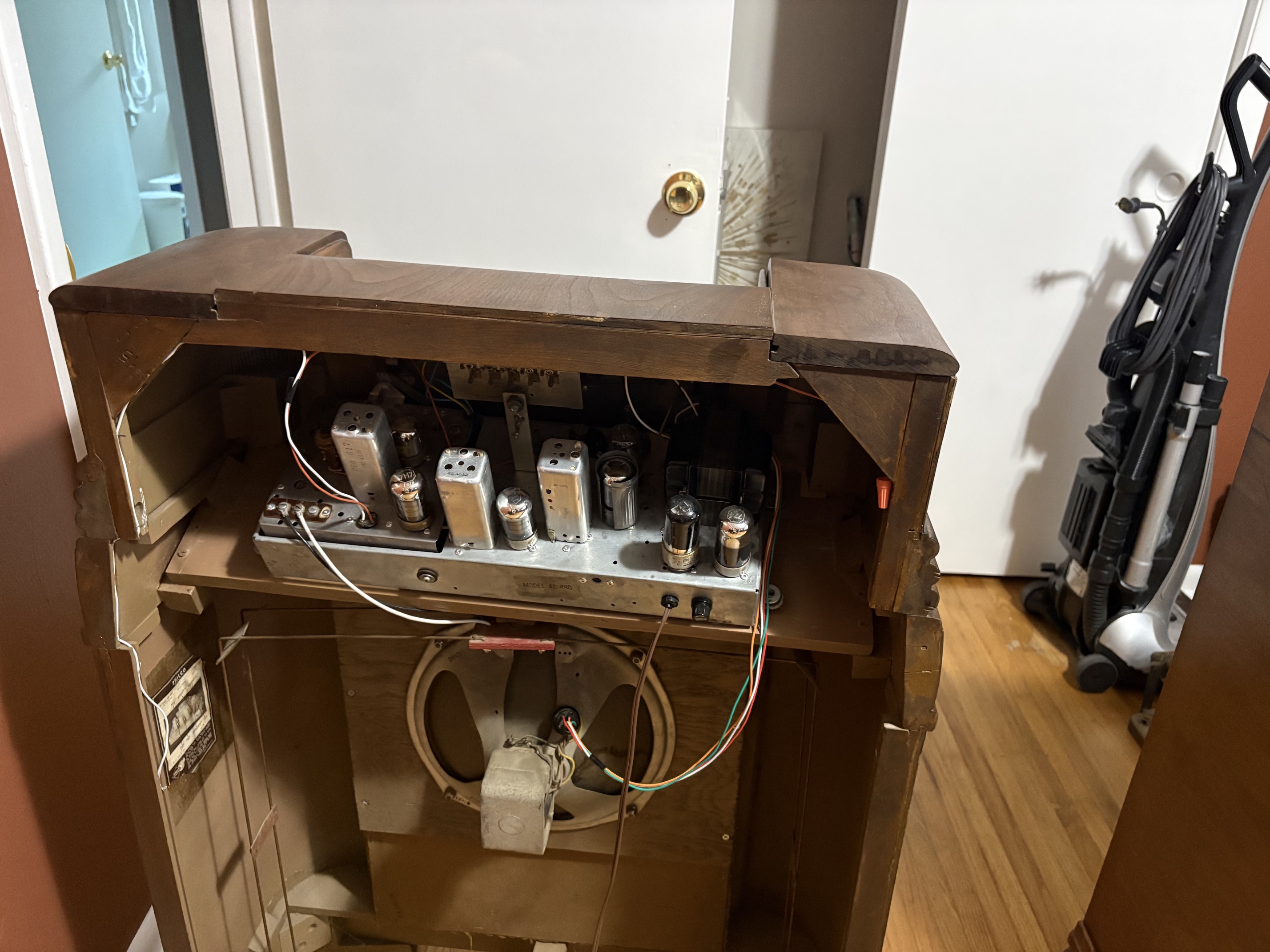

My FM Cabinet Dipole for the 46-480 was removed. (I'm new to this group and this may be the wrong place to ask this question  I also saw a thread about the cabinet dipole for the FM. It had a link ( https://www.rfcafe.com/references/radio-...l-1947.htm) for a folded dipole. The thread was closed and I have a couple questions for anyone with 46-480 experience. Can I run a single loop ( 300 ohm cable) around the perimeter of the console frame shooting for a wavelength of about 116"? If I use the flat 300 ohm pair cable, will it mess up the reception if the shape is not exactly a "T" (by following the inner shape of the cabinet)? I'm asking this because the cabinet dipole has been stripped out.

Hi Harry,
Those of us who are HAMs (I am not, yet) may be better versed in answering this question, but my $0.02 would be that a single length of twin lead would not work. Since the input is balanced, what is picked up by the 2 conductors would be in phase, in other words, common mode and would be cancelled out. It would be best to make the T antenna, similar to the original.
The quickest (and dirtiest) method is to get some lamp cord (Zio Cord) that is long enough to go from the antenna terminals of the receiver to the middle top of the cabinet plus 2 1/2 feet. Separate the first 2.5 Ft of the zip cord and staple from the center of the cabinet down the sides. this gives you a 5 ft center fed dipole that is approximately half wave.
You can make a more proper "folded dipole" out of 300 Ohm twin lead, but by the time you buy the twin lead and spend the time, you can order one from eBay or Amazon for $6-$8 plus shipping.

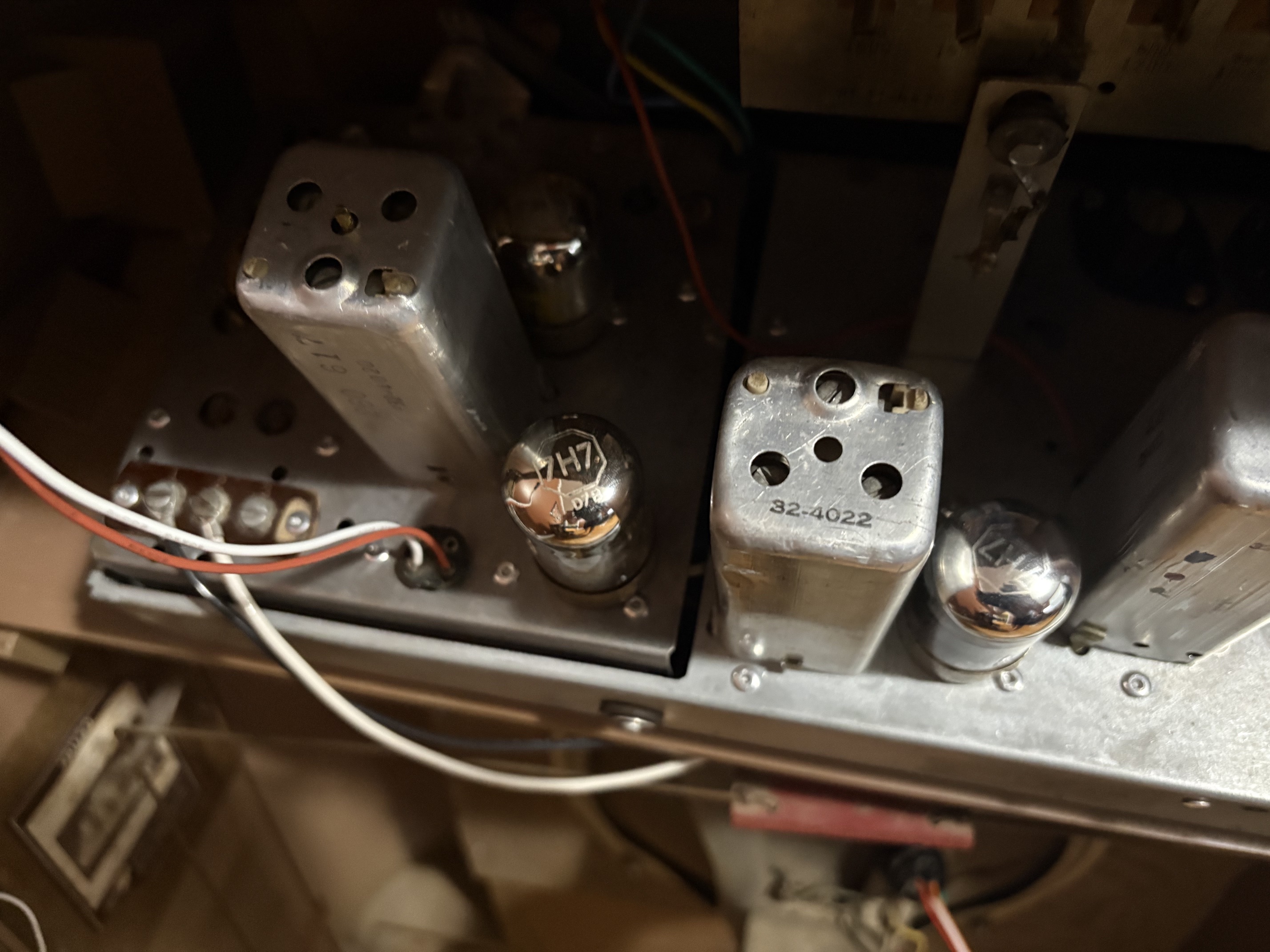

Good morning! I can't say that I've tried using 300-ohm conductor, but I suspect it would work fine!
I was lucky to have the original dipole in the cabinet. I'll tell you, it's just a couple of pieces of 20 AWG stranded wire. The brown wire is about 28" long, and the white one is about 6" longer. You can see that they connect to the two backmost connections on that J400 socket.

Great! Philco took the quick and dirty route!

I don't have photos but you can duplicate the late 50s early 60s German FM radios by using two pieces of heavy aluminum foil about 6 x 20 inches fastened to the interior top of the cabinet so the ends are about a half inch apart. Fasten each wire of a 300 ohm twin lead to each aluminum panel using brass wood screws. The other end of the wire goes to the FM input. I've seen some with a small coil of wire between the panels. I don't design antennae but it's probably to modify the electrical length of the dipole.

WOW! That is really great information! The picture of the actual Cabinet Dipole is really helpful ( I think 28" is half wavelength for the nominal freq). I have just spent the past day tracing connections and components. I have designated Terminal Lug numbers and on the prints - I'm having to label every connection, just so I don't miss anything. The guy that worked on this unit before really did some changes. He added two terminal lug strips and rerouted and added a number of components. One strip went to an RC circuit hooked in where the ground should be on Z301 - so it did not have a true chassis ground on the secondary winding. I have no idea what he was doing. Another 0.01 uF cap, 1000V was added but he ran both ends of the cap to chassis ground (???). I think there was noise and he tried to design a filter on the 2nd IF Amp. It has been a painful task of redrawing component layouts and then tracing them point by point on the actual schematics. It is fun but very challenging. On a separate note - I just finished working on a 46-1226 ( my hobby). I had poor reception on SW (bad tuning cap - replaced) and there was a lot of noise on AM. I made my own tube extender (breakout box) for the 7AF7 to access tube waveforms. I took many scope pictures and used ChatGPT to create me a troubleshooting document. It clearly shows noise, that ended up being poor connections on the IF Amps. That AI really helped a lot to build the document (30 pages) Should I create another chat to post that? It may be helpful for someone else.
