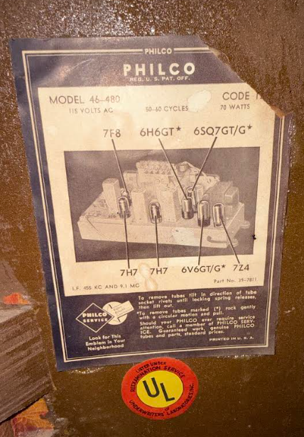

Arran: I think the code for this 46-480 is 121 but from the picture, the corner of the tag is missing.  Is there anyway to determine the 'run' number or to get any information from the pictures I've attached?  That may help clarify the plate load resistor that I need.

You can use the information in the service manual to determine your production run: Service Manual
Check the second-to-last page; it lists the changes made with each production run. Mine was determined to be the final production run.

Thank you - I will have to try that software. I did see on the back few pages of the service manual they list the differences in each "run". I know with the 46-1226 they list "code" improvements like 121, 122 and 125, each having some modification and circuit design changes. They actually tell you what 'code' the system has on the model sticker in the left rear of the cabinet. What I was asking is: is there any number printed or stamped to identify which 'run' has been modified in the 46-480 - if they do happen as runs being made for subsequent improvements as time passes. I may be wrong but I imagine each 'run' to be some change order for improvement. Or, do I need to check for each improvement/modification to determine which 'run' I have?
Aside from that decal inside of your cabinet (which has the code portion torn off, conveniently Icon_thumbdown), just about the only way to tell is to start looking at the circuitry to see if yours has any of those production changes. Some Philco chassis will have a code 121, 122, etc.) stamped on them, but I don’t see it often. My 46-480 did not.

Most often, I believe the code will be on the model label or ink stamped on the rear of the chassis. Which means you could find contradicting codes if both are used.

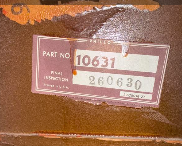

I can't see any reason why C-206 would need to be 1000 VDC rated, it's an audio coupling cap with only 118 volts on the other side. That paper label with the part number 10631, is the part number for the cabinet, believe it or not they used to supply replacement cabinets for many model, though I haven't seen the console ones in a parts catalog yet.
