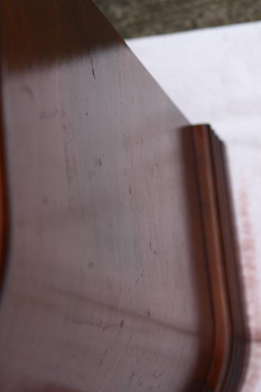

In the two images below, you can still see where the marks were on the cabinet.

So there are two issues: The water damage on the sides of the cabinet and the cracking finish on the top (and a few other places). I would like to see if I can minimize the appearance of the damage marks. Are the marks on the side of the cabinet and on the speaker grille bars a good candidate for some Howards treatment? If so, what color should I choose?

Lot's of thoughts about the finish but that radio cleaned up very well. If it were me, I would wipe it down with a little Howards that was close to the color and see how it looks. If good a few sprays out of a spray gun of shellac and some rub down with 000 steal wool, just to flatten out the finish. Then a couple coats of lacquer from a spray gun. That finish is really nice. You just need to get a little color into the scratch areas. Then a little finish over it.
Nice radio. Jerry
Thanks for sharing your thoughts, Jerry! I am really thrilled with how nice it looks, someone took very nice care of it over the years. I've got a new set of buttons on order for it. Looks like I need to track down some Howard's.

I found a local retailer that carries Howard's. I'll grab some tomorrow and see what happens with the little surface defects. There is really only one or two very minor scratches in the surface, the rest just seems to be places where splashes of one sort or another chewed into the finish. I'm optimistic that those little defects will disappear. I feel like a kid on the night before Christmas...

I just finished with some Howard's and it did a VERY nice job! I used the Cherry colored one that I thought might be too light and it seems to be just a tad dark. Perhaps it is just the difference in the surface reflectivity that makes it look darker. I can still see where the surface of the lacquer was disturbed by whatever caused the spots, but the color match is excellent. That stuff is great!
I used an old washcloth and gently wiped it on and rubbed it in. When I was finished with the entire cabinet, I wiped it down with a dry cloth. I'll let it dry overnight to see how it looks tomorrow. I didn't have the nerve to use steel wool on the more rough spots just yet.
Now I'm torn between leaving it as it is and putting a top coat of shellac and lacquer on as you suggested. If I do spray it, does this require a spray guy for my compressor, or can you use spray cans?
The top image is from before I did anything at all (on the left) and after cleanup with Goop and some Howard's (on the right). Both are from roughly the same vantage point and both were lit by a flash.
The bottom image is looking down at the same side panel. You can still see the unevenness in the finish - not really a surprise, but I'm thinking I'd like to smooth this out a bit.
Overall, I'm REALLY impressed and happy with the results so far! Icon_biggrin Icon_eek
Nice job Eric, it certainly made a big difference. Personally on the checkered areas I would just leave them, nothing wrong with the lady showing some of her age. What ever you do, don't try going over that area with any abrasive without building up some of the surface with either shellac or lacquer. You don't want to cut into the high areas and remove the toner. Problem is that if you do those areas you may have to do the whole cabinet in an overcoat to get the "gloss" to look the same.
It certainly looks nice to me and you have the original finish. You only get that once!

Great job! That is really beautiful. I agree with Jerry - leave it be. It's original.
