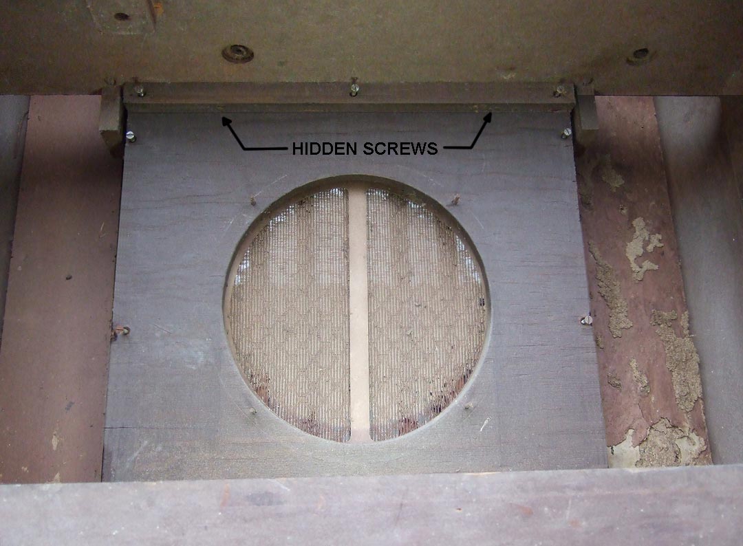

I started removing the speaker baffle board and had all the screws removed, but it was still hanging to the bottom of the chassis shelf. I finally pulled out my auto trouble light and a mirror and discovered there were two screws holding the baffle board cleat to the bottom of the chassis shelf. I removed those and the speaker baffle board came out easily, followed by the thick cardboard backing for the center grill cloth. I discovered that the grill cloth that had been hidden and held against the cabinet wood was significantly darker than the grill cloth which was visible with the unit assembled. The cloth had faded a lot over the years. There is also grill cloth on either side of center behind some wooden scroll work. That grill cloth is also glued to some pieces of thick cardboard. The cardboard pieces had a printed woodgrain pattern on their backside. A casual glance from the back would not spot the fact that it was only paper and not wood. The cardboard is about 3/16 of an inch thick.

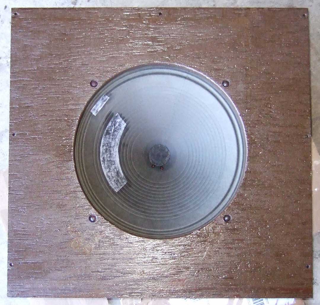

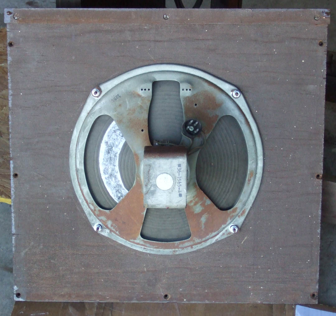

Here is the nice 36-1565-4 speaker that I received from Ron. I mounted it to the baffle board and made some minor patches to the cone using some coffee filter paper.
The speaker frame has considerable rust, and I will be sanding, priming and repainting the frame to get it looking nice too.
Joe

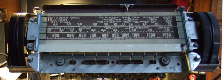

Here is a picture of the dial glass after I cleaned the backside. I just used a piece of toilet paper and breathed some water vapor onto the surface, then rubbed it with the toilet paper (about the same softness as a Kleenex). This did a good job of removing surface grime etc. without removing the paint.
I used some new rubber bands around the ends of the glass to act as a cushion between the glass and the mounting brackets and the back-up plate they attach to. I cleaned the old pads and glue off first before reassembly.
