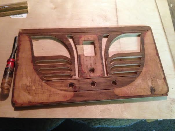

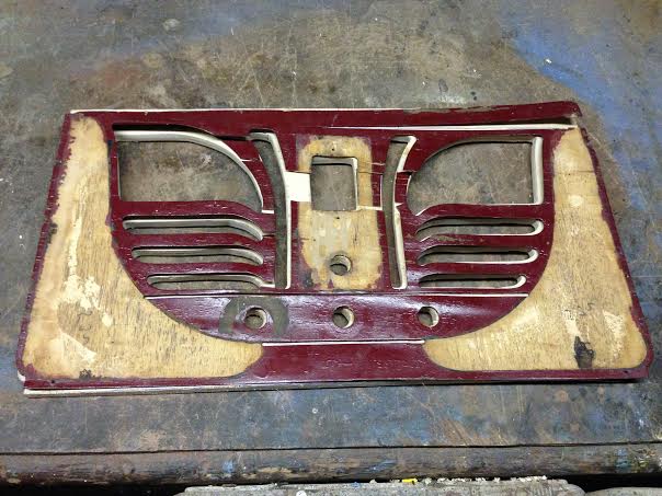

I just finished collecting and placing every piece of old veneer and will glue today after some appts. Only missing a few pieces though. I think I may need to go very dark on the finish, like black toner due to water stains and very dark spots.

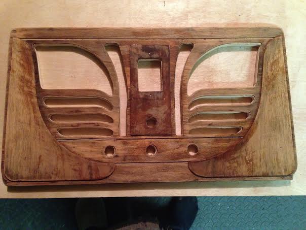

I want it as original as possible and will strip the veneer once secured to the new top and front.
I got the new veneer but I dont know.
Hmmmmmmmmm

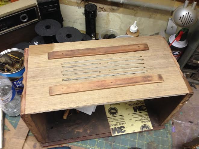

Well the glue finally dried and I removed the planer and the table. It came out nice and flat, thank gosh!
Sanded it down, replaced the missing veneer I didn't have, then added the decorative raised veneer. Then I cut out the vent holes in the new top veneer and done for the day

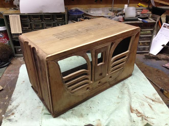

Ok so cabinet now has a bottom, 2 sides, and a top!!
Have to sand the vents but new veneer is looking good.

Clamps are off!
Next is filling all the defects, then grain filling and finally toning.
