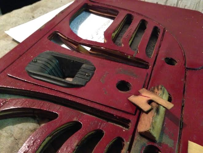

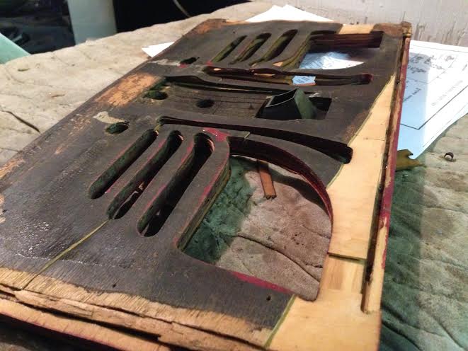

So I got this in the mail today and oh boy it is a mess of messes.
I was told it was poor condition but complete. I should have asked for more than the one picture I guess.
I must now figure out what is savable and what will have to be manufactured.
Maybe they "caught" that in a lake when fishing. Icon_eek
Oh, so you are the one who got "the radio that used to be beautiful".
Well, it'd be interesting to watch!
I saw wood fences in Russia in better shape than that.
And the paint used to be very popular for wood floors (we had full length timber planks, not parquet type).

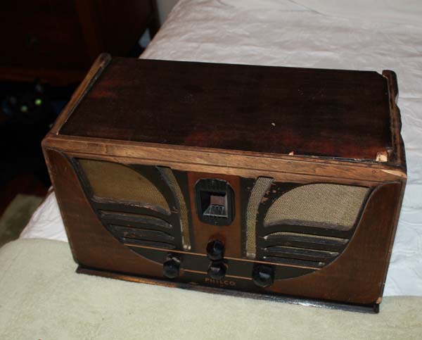

Dont think I have ever won anything that looks better than it was in the pictures. The seller always seems to use bad lighting to there advantage

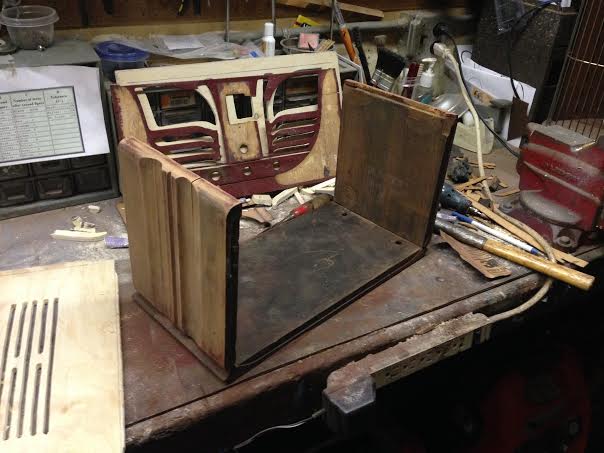

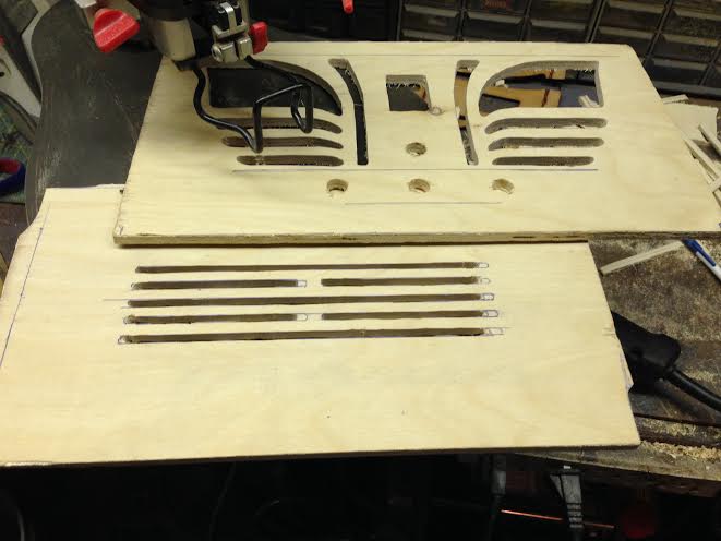

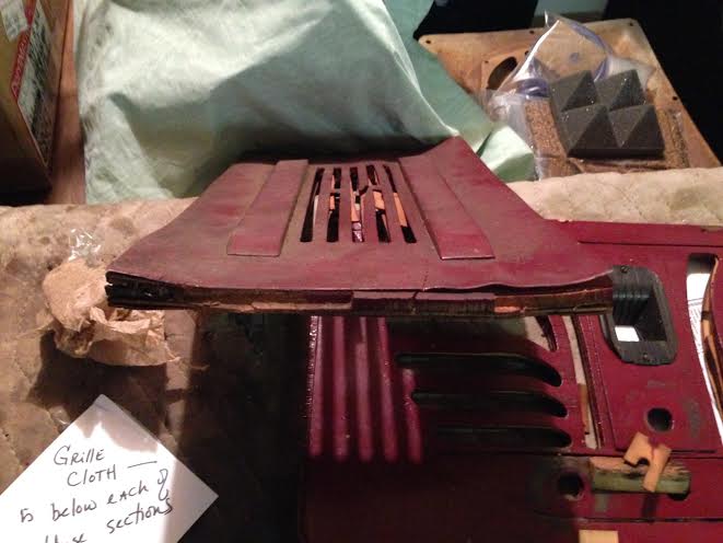

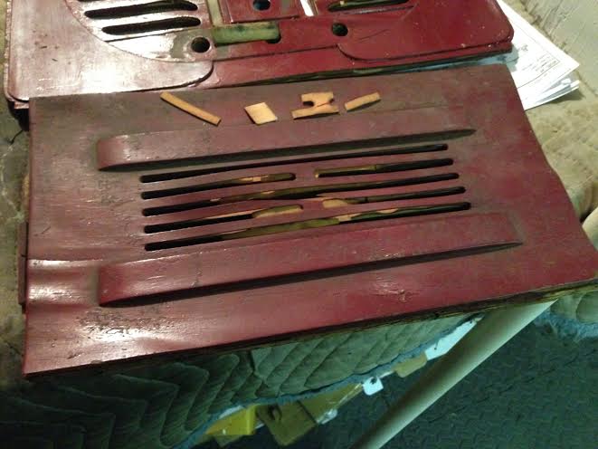

Well that was a bust, the top and front are gone. I salvaged the veneer but had to make a new top and front. Well, I am making the top and front.
Wow, this is serious stuff.
I hope you are not using a coping saw and have a router for that.
I do not even have a place to put a router.

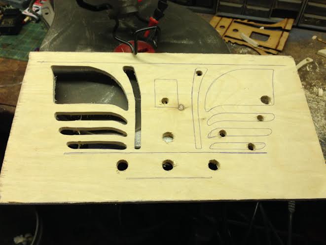

Unfortunately it is all being done by hand on my scroll saw but I will have to router the keys on the sides and top.

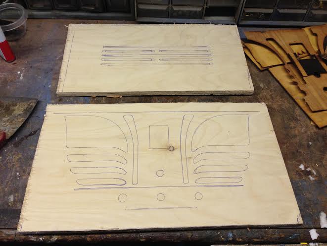

Rough templates done
Keep your chin up... It can be done!! . I had to make a new top too. It was worth the effort.

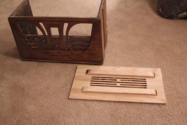

Mine wasn't quite as far gone as yours, but you'll have to refinish yours at some point. Perhaps my thread will help..
Awesome,
It was a very big help. I have the same problem with the top tongue and groove.. It is almost all missing so I will have to fabricate new ones with some 1/4 square cuts.

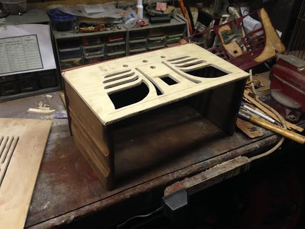

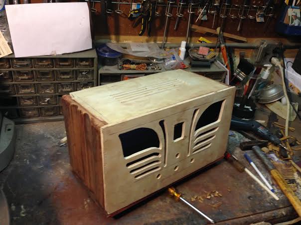

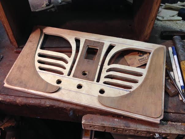

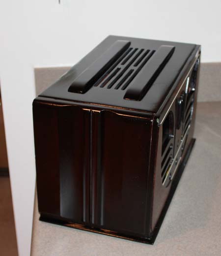

Today I got right into it.
Sanded roughly to level out the lines, stripped all that hideous red paint off of the rest of the salvageable pieces and began building and tweeking the cabinet.
Didnt realize that one side was a bit warped but It will have to do. If I replace any more pieces I may as well just build a new radio.
So, new top, old veneer, new front, old veneer, and original sides and bottom.
Looks like you've got it going your way, Old Res.

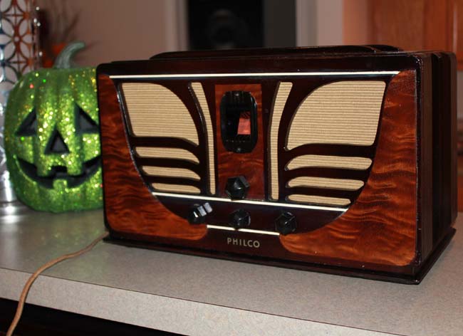

You are well on your way, Old Res,.. looks like you are going to come through this Butterfly project with Flying colors Icon_eh Icon_lolno
