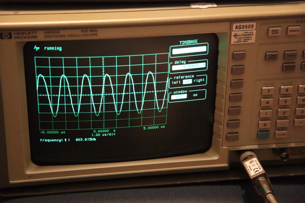

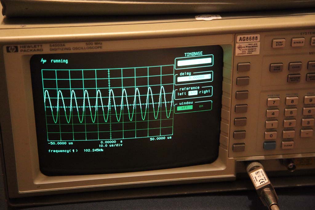

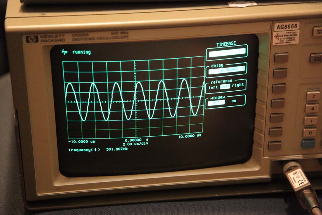

Starting on the HP200CD oscilaltor
S'more:
100kHz
300kHz
600kHz. This is where distortion starts creeping in (who cares, It is RF)
And the frequency is pretty much accurate, what you set is more or less is what you get.
