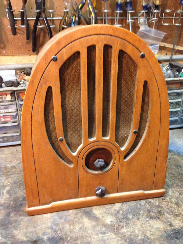

Not very happy with the photofinish

Definitely an possibility Eric.
  I need one for my 84 but won't get that till I get moved in to the new house. I will be following the direction better.
I am hoping I will not have the issue again.
Like I said, He is definitely an asset and I sure need that new photofinish for this poor baby.
That is one very naked 84!
Kirk,
That one didn't have the photo finish, it was toned light around the edge and middle and dark around the grill.
www.liveauctioneers.com/item/2500230
Hmmmmmm,
  Thats good to know!
Thanks Todd, I thought I was getting away from major taping  Icon_lol
Kirk
hmm kirk you putting a beer tap on that Icon_thumbup
