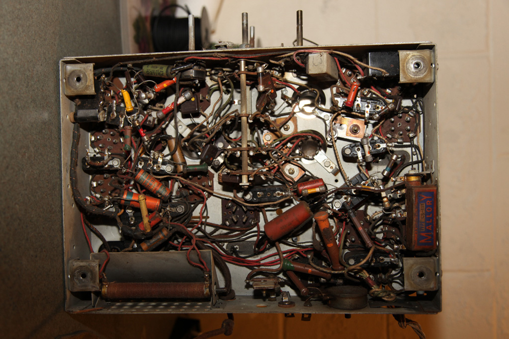

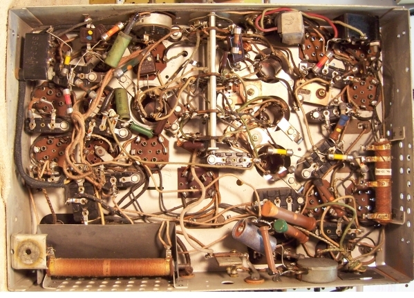

Hopefully Ron, Chuck or someone who recently restored a 16B could answer this:
As I stated before, there are some discrepancies between what I have in my chassis and the 16B sch in the Rider.
Mine might be a 16B code 121 as it uses an 80 rect tube.
http://www.nostalgiaair.org/pagesbymodel...013139.pdf
These are the pictures of my radio and someone else's (Mcclellan's website, a restoration of a 16B)
Mine
The other
Now the volume pot arrangement is different. It does look like someone touched it, but:
1) The cap (in the picture the green tubular one going to the vol pot) is a Philco cap, plus present in both radios.
2) The red (or is it orange) resistor with a yellow dot is also present in both but is absent on the sch.
3) The arrangement is different: in the chassis' the cap is connected to the top point of the resistor separating it from #53 resistor and others. In the sch the cap is connected to the output.
4. My resistor is not tapped. Dunno about the other guy's one.
There are some other things rearranged or different.
Was there a change and is there a document to reflect this? Is there a schematic that reflect the changes if those were official?
Mike.
PS. Found another image on the ARF, same deal.
http://www.antiqueradios.com/forums/view...5&t=206781
If it is a 5-band set and uses an 80 rectifier, then it is a Code 121.
Model 16 underwent a number of changes, they are documented in the Philco Changes in Models package available for download here:
http://www.philcoradio.com/phorum/showth...hp?tid=215
One change not documented in there is the volume control being changed from a 350K tapped control to a 2 meg tapped control. The Nostalgia Air data for Model 16 includes a page outlining this change in the volume control circuit.

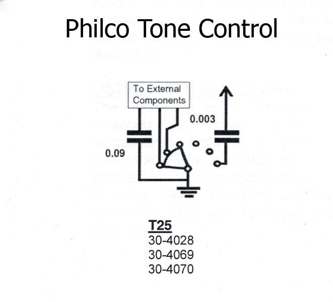

I am trying to implement the change for the tone control.
Since I do not know what the new one #30-4069 looks like I need to mod mine which is a 6-tap, not sure if it is the 30-4033 shown in the sch..
I am not sure it has same number of taps as the new one (it mentions 4) or is it the same?
They have 7653-C backelite cap for 0.025uF externals but seems like both caps are connected to GND, so not sure I can use it the way it is as only one 0.025uF cap is grounded.
If someone has a good account on moddind the whole thing I'd be grateful.
Found this in Google archives.
http://philcoradio.com/phorum/attachment.php?aid=3308
This however does not show what the description in Production run #4 says it should be.
Aha. Found this
https://www.google.com/url?sa=t&source=w...737D5LFb_Q
Seems to be it.
So the link before shows diagram wrong, and then the backelite cap should have the two caps in series conbecting together at centerlug.
Posts: 16,562
Threads: 573
Well....the description in the Philco document (or rather Rider's document) has an error:
In item #4 "Tone Conttol" it says:" ....while the third is permanently connected to ground through the other 0.025 mfd".
"The other 0.025uF" is connected to the common wire of the 0.09uF, 0.025uF going to the secobd tap and the 32kOhm resistor. That is the caps are connected the same way as in the old sch except the values had changed.
The last link I gave with youtuve shows that exactly that.
