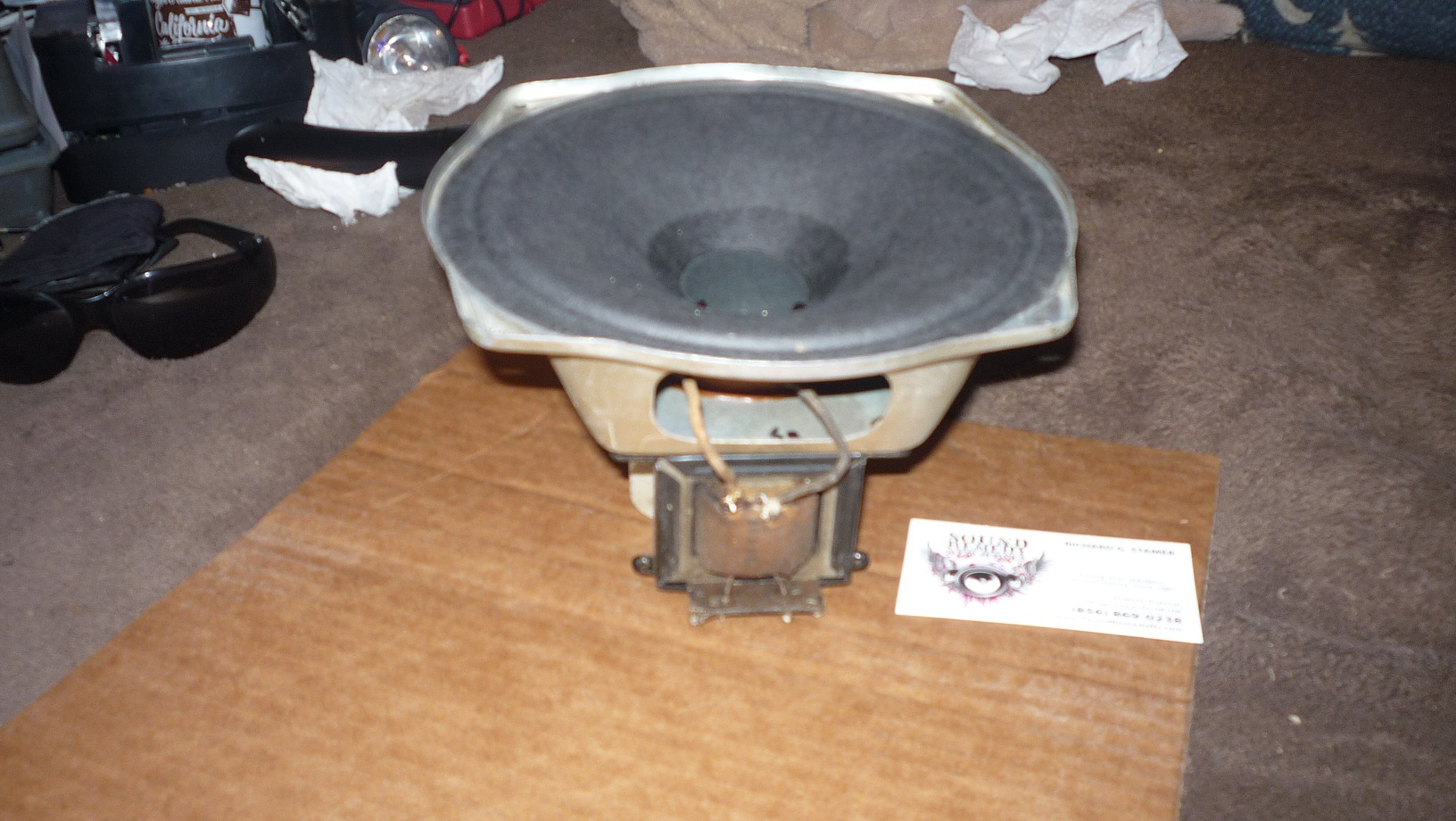

If you see a USPS jet fly over, be sure to wave, my speaker is on its way to NJ...Icon_biggrin

Oh, if it is on its way to Rich, then both of y'all are gonna be happy with the results.
#37
just seen it fly into Phila,,,,,right over my house,,,is the flight patten
#38
In the evening I heard someone blowing a raspberry over our in the sky; I think it was the bad cone saying 'hi' to Jersey pholks.
#39
LOL!!  That naughty 1/3rd of a cone.... Bitter to the end it is.. Icon_twisted
Box marked "Attn Rich Stamer"......He'll teach it some manners!!! Icon_thumbup
