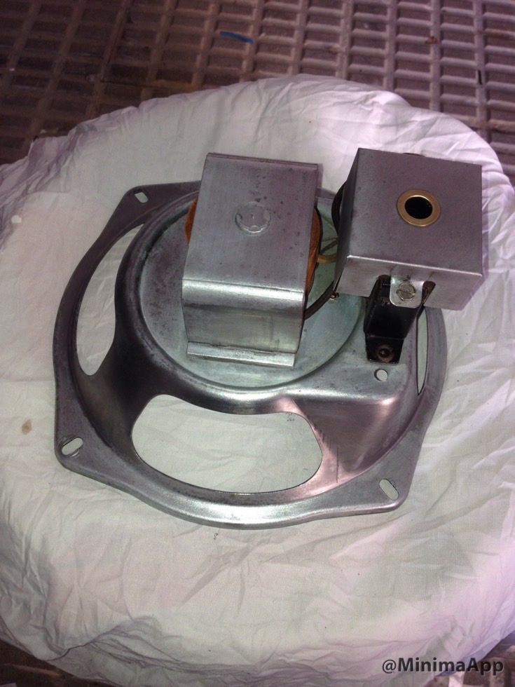

Order side

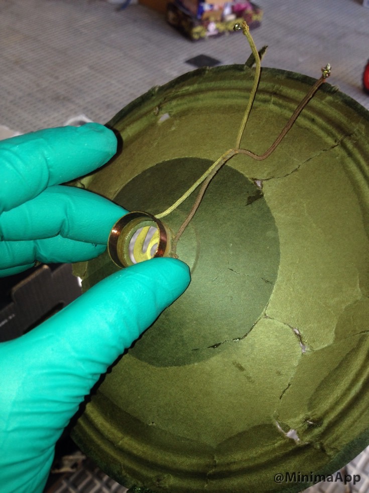

The cone to be replaced, I will try to save the coil

Hi Jeepeto,
Please see my 16X Story thread - it may give you some ideas on speaker cone making. I did exactly what you plan - save the coil - and made a new cone and surround. It works really well.

Thanks Ed, I will take a look this is my first speaker re-cone, I am getting out of things to do waiting for parts, including new cones Icon_smile

Really good Job Ed! Maybe I will do a try to do a cone from some of my kid's thin cardboard for homeworks in the waiting for the replacements, they look very similar to the old paper and have same thickness, by the way beautiful restoration of your 16x, those big forniture radio are very rare in my country from that age...

Thank you Sir Icon_smile I would recommend experimenting first, to get the geometry right. Then you can make an accurate template. It is also a good idea to set up a jig to position and hold the voicecoil accurately whilst gluing it to the new cone.

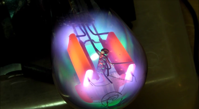

So here the deal. W/o the speaker connected the power supply no load (all this HV w/nowhere to go) #56 keeps charging up and charging and charging till it get to it maximum voltage rating @ 450v. It's still charging up and up. After that happens it shorts from being exposed to too much voltage. This in turn put a terrific load on the rectifier tube (80 tube) and it shorts. With the 80 shorted it takes out the HV winding on the power transformer.
To find out what is going on w/your set unplug from the ac line, remove all tubes, and lamps. Used the schematic to make sure that the resistances on the transformer windings match the schematic and what there are supposed to be connected to. You may have something miss wired from rewiring the transformer.
If all that checks OK then replace all of the tubes and lamps EXCEPT for the 80 leave it out. Power it up and measure the ac voltage across the two small pins (2 and 3) of the 80 socket. If all is well should see about 600-700vac.
If that checks OK then replace #56 put the 80 tube into it's socket and connect your dc voltmeter + to the + side of #56 and the - to the chassis. Should see about 250vdc.
GL
One angry 80 tube !!!!!! Pic stolen from the net.

Thanks for your explanation Terry, still learning and maybe this time in the bad way for not connecting the speaker Icon_sad hope I have not burned anything, the 80 tube did not shine like the photo O_o just got hot...and never applied more than 60vac 1amp, for next times always is needed to have all tubes and speaker just for Test shorts or other things? Any recommended book for learning testing tube equipment?
