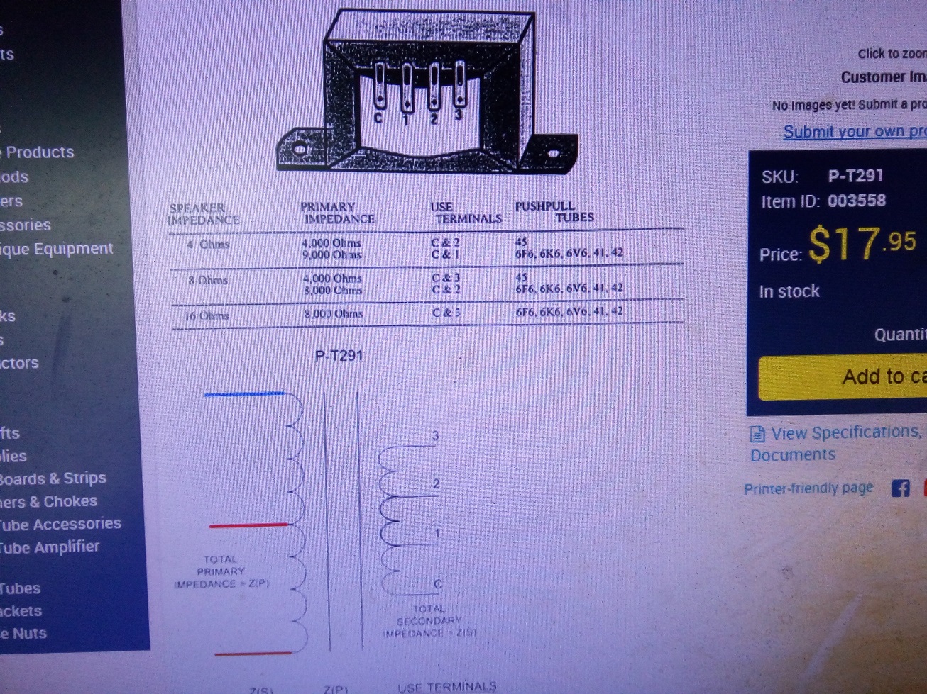

the audio output transformer can be had in a few varieties,, there will be an 1, 2, 3, C and a metallic ground tab mounting terminal.
one of the letter terminals will "sound" the best on the speaker you have or the speaker you have chosen ,, but its all about impedance matching.
they are not overly expensive.
i got mine from antique electronics supply pn P-T291 for 17$, its 8watts.
this may not be what you pick, but just saying there are options

Actually I have one already (Bought in case I needed it for my Philco) - and was just looking it over on the bench. I need to configure it for 8k impedance (or the nearest tapping) plate-to-plate for the 6V6 output valves, and find a safe way to wire up the HT.
