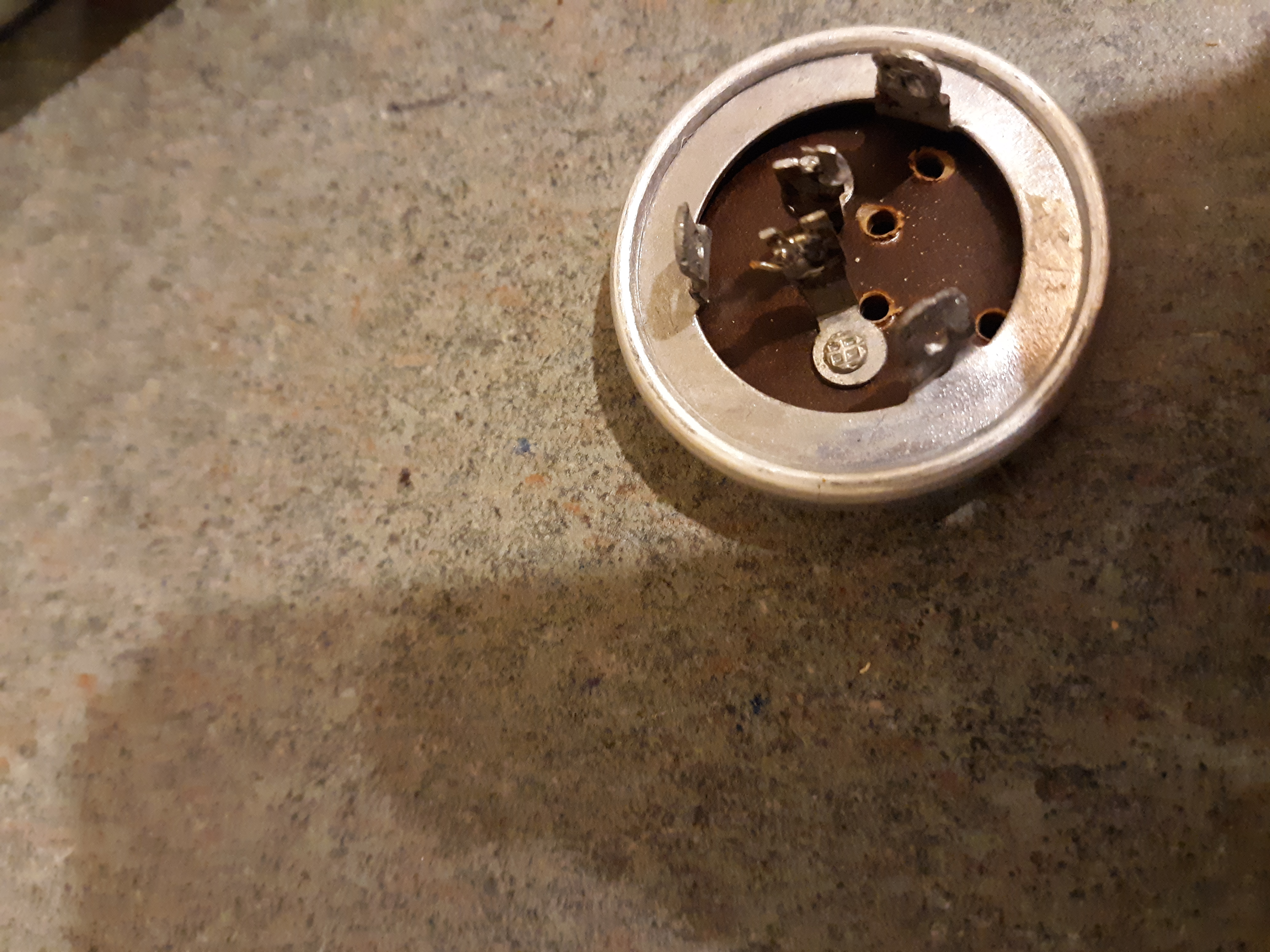

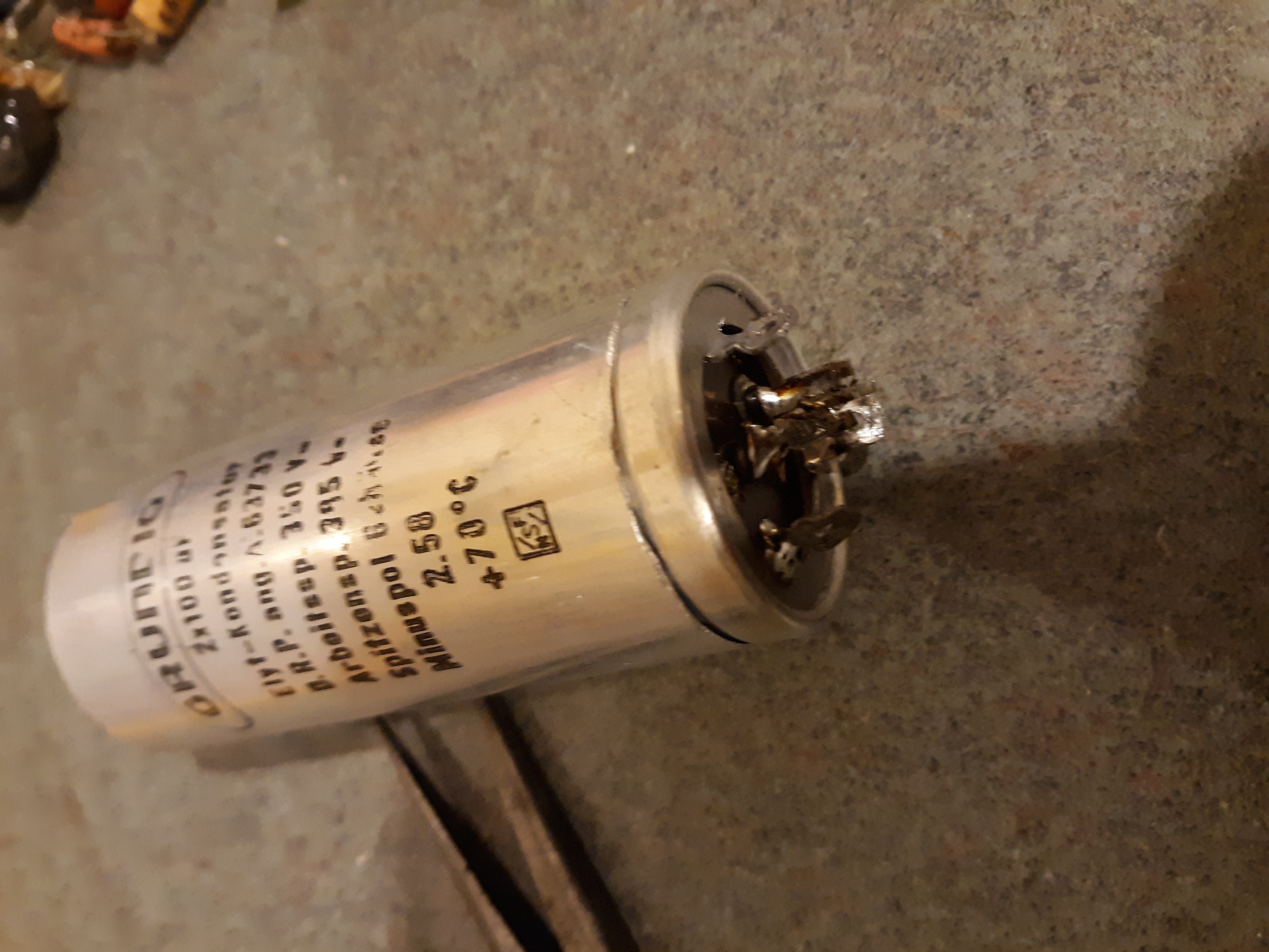

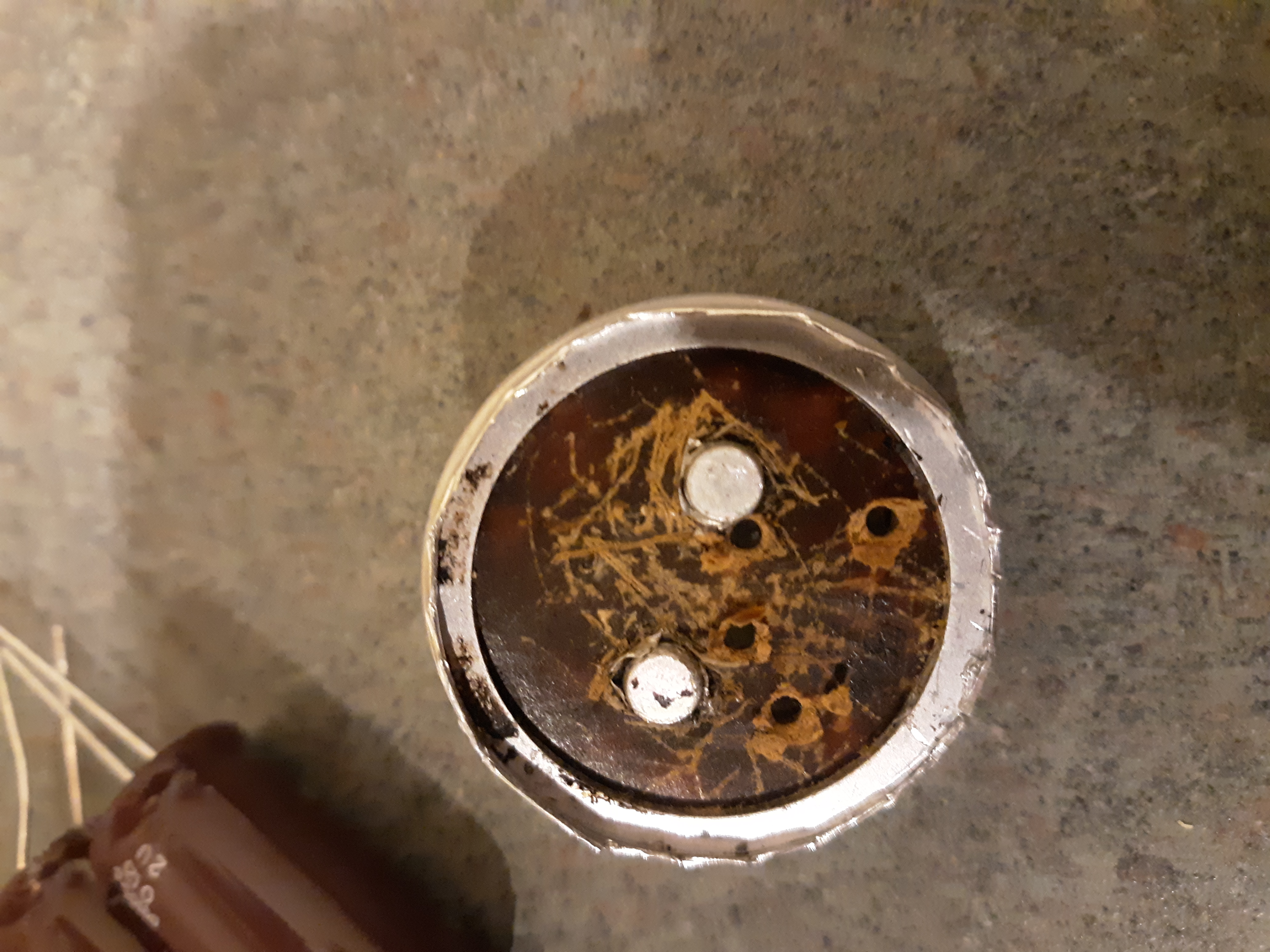

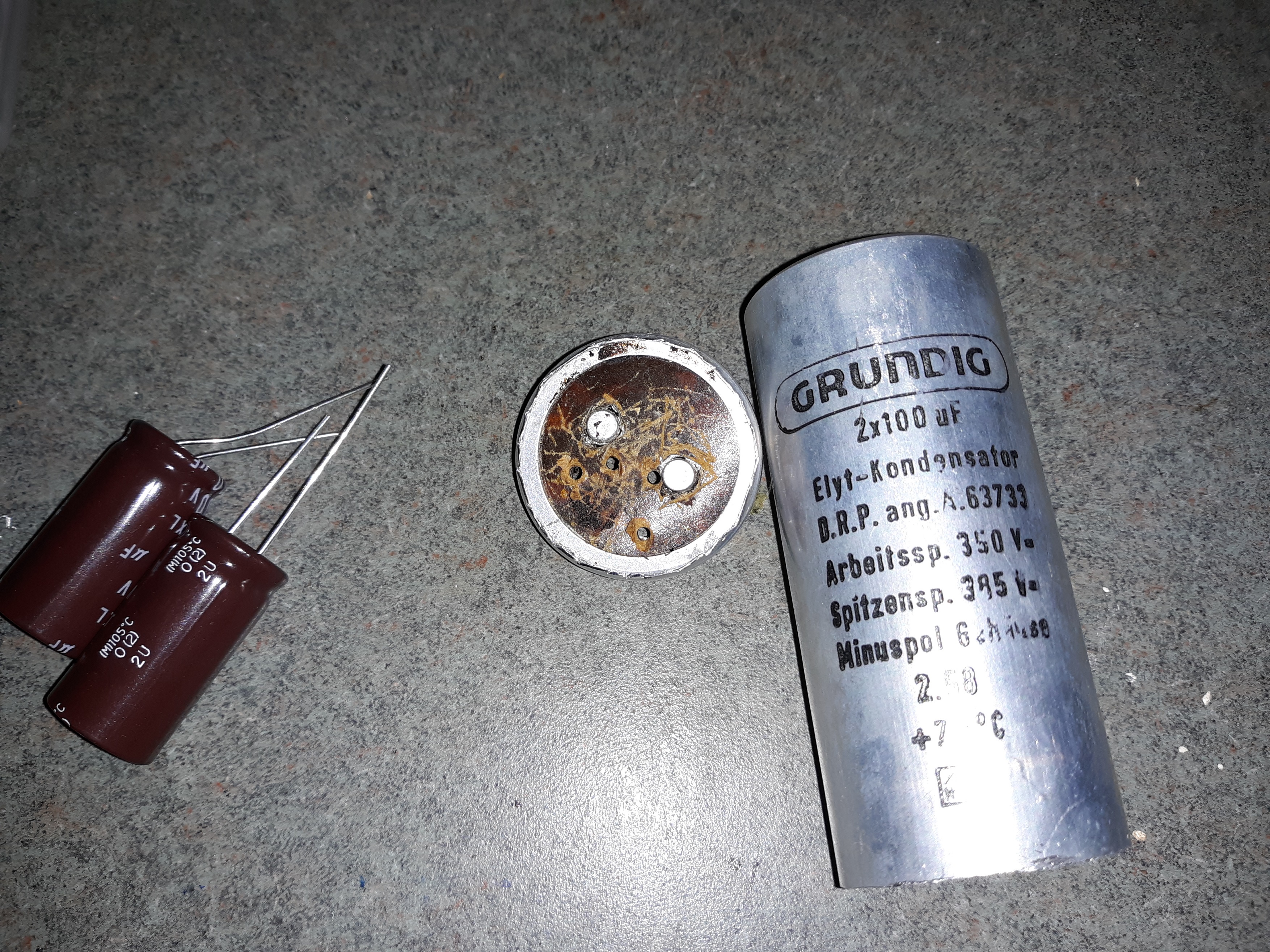

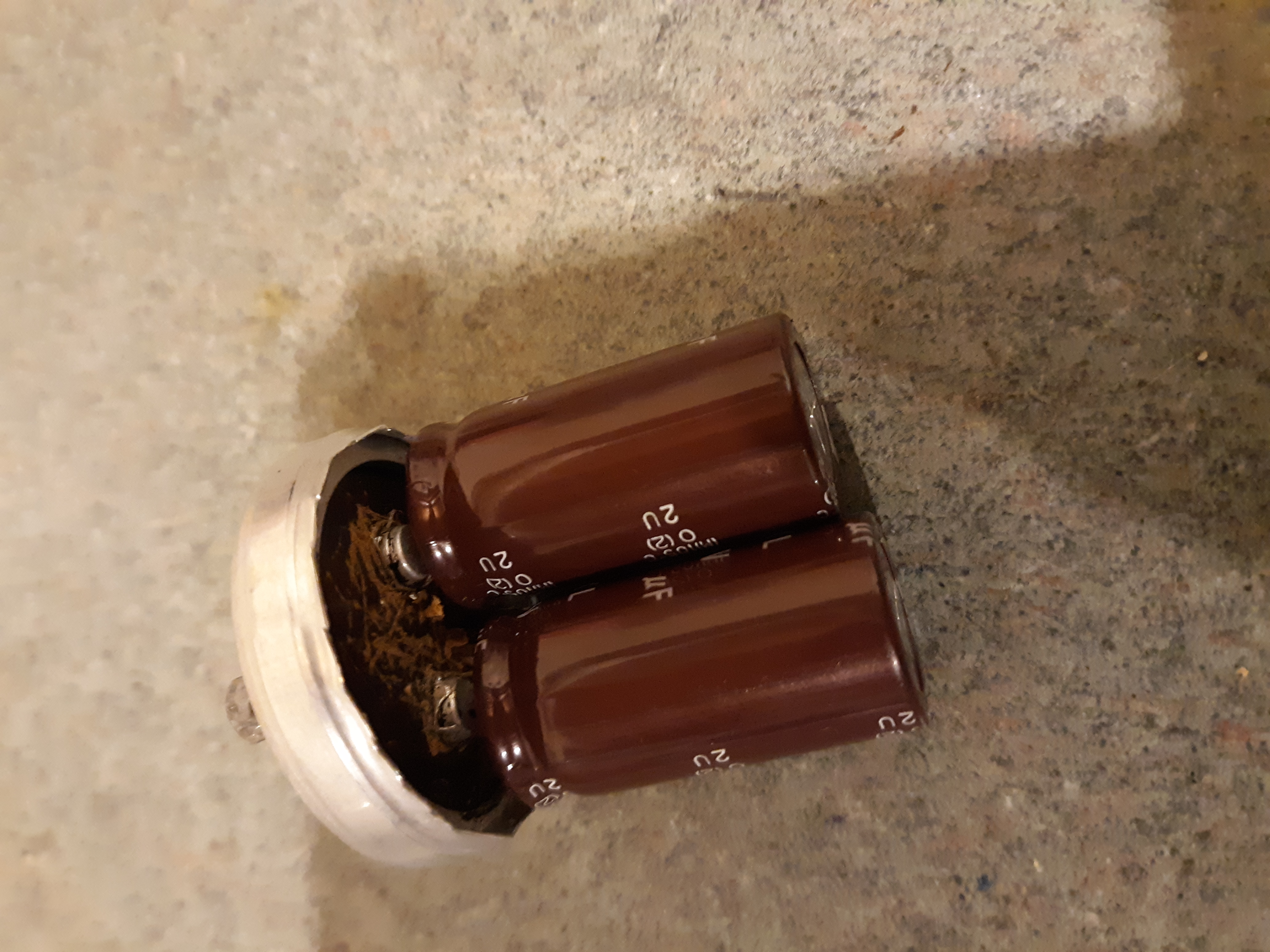

The caps were maybe $1.50p each and the cap came apart real easy, almost no effort at all.
Vinegar bath dissolved everything unneeded, and then drying and baking, and strategic drilling, soldering and gluing.
These are the ingredients.
Drilling holes so the caps fit without wiring.
Soldered
Glued together.
