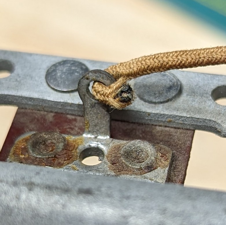

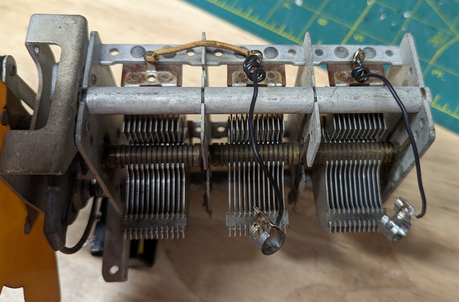

Today's puzzler: What the Heck?!
Here's my cleaned up tuner assembly. Two gangs have leads to the caps of the 78 and 6A7 tubes.
But then there's that little tan (was white?) wire between the mid and front gangs. Hmmm...
And at the front gang- the wire is merely looped through the lug- no solder, and that lug has NEVER had solder. It's clean.
Those two gangs are not supposed to be connected at all. The first gang should be connected to Grid 0 (pin 5) on the 6A7, and to some lug on the band switch that I haven't traced yet.
Any ideas?
It's a gimmick capacitor that couples some of the osc signal into the input of the mixer.
+1 what Terry (RadioRoslyn) said.
Leave it alone. Do not bother it, modify it, remove it or attempt to solder it.
RodB has given an excellent description of the reason manufacturers used flexible braided wire to ground tuning condensers and I agree with his analysis. Just keep the darn things; don't replace them with solid wires.

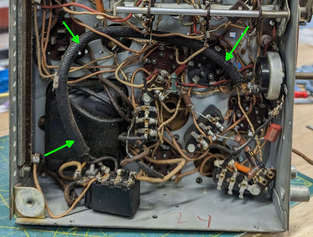

Shielded Power Cable:
I asked about this before, and the consensus is that the shielded power cable that crosses under my chassis is shielded for a reason.
OK, but it's nasty. All crackly and cracked rubber insulation. At least there's enough length where I can trim the ends a bit if that helps.
But if I want to replace it- with what? All the old power cables in my Old Cable Box that have shielding are foil-shielded. How to terminate THAT?
Proper braided shield 1-pair 18g cable is available... but I can't find it in less than 25 foot length at $5 a foot. Nope.
A cut length of shielded twin pair cable from eBay would probably be your most economical choice. It needs to be 18 gauge and rated at least 300V. Here's the cheapest one I found in a brief search:
https://www.ebay.com/itm/255115465280 - 25 feet, 18 AWG, 300V - $6.95 plus shipping and tax
And that's $6.95 for the entire 25-foot length, not $6.95 a foot.
That's a great deal. This cable if purchased new is very expensive. I also looked at Mouser Electronics, and they only sell it in large rolls which run from the hundreds to the thousands of dollars.
