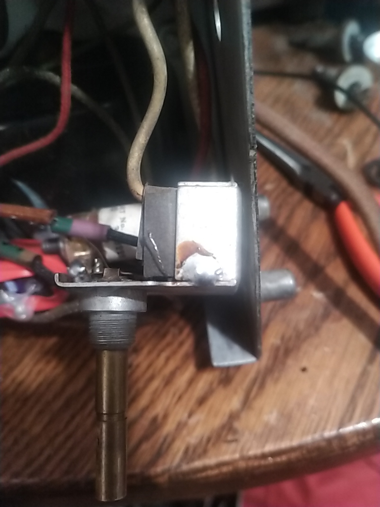

It will pop it out until fully assembled and the Jesus clip is in place. Fully assembled means, the inner shaft is inside, and then the whole thing is inside the bushing that holds the large balls inside.

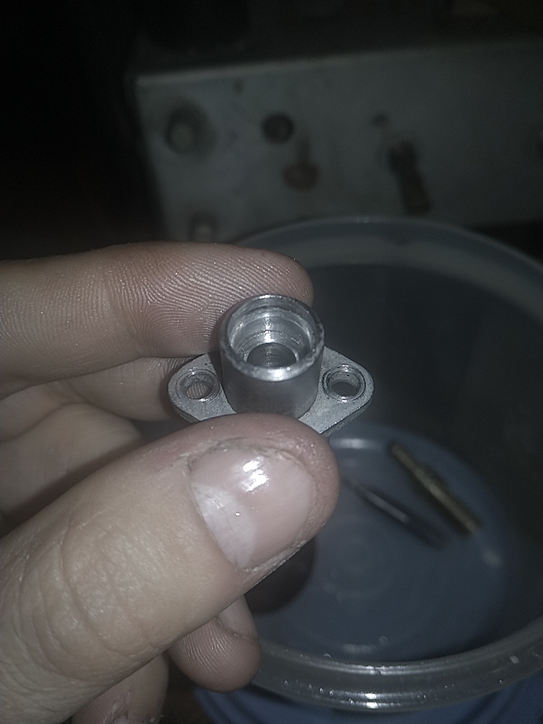

It's pretty clear to me and it works perfectly after I assembled it but a few turns of the knob it makes a click noise and the dod jumps out a few millimeters.
Now the only thing I didn't do was use grease, I used a drop of oil after the black crud was cleaned out and scraped away.
I'm at a loss what I'm doing wrong.

The "Jesus" clip is the circlip that holds the outer shaft in. People call them Jesus clips because when they shoot off into a parallel dimension one says "Oh Jesus". I don't like to take God's name in vain, but I am not above using "salty" language, so I call them oh$#!^ clips, because that is what I say when they spring off. Whatever nomenclature that you use, this is the "C" shaped clip that snaps behind the gear on the outer shaft.
The mechanism that Klondike indicates may be different externally from yours, but the innards should be similar. I believe that the inner shaft is held in by the 3 balls. The outer shaft acts as a "race". The balls are sandwiched between the "cup" of the mounting body and the tapered area of the inner "vernier" shaft. If the end of the shaft or the cup of the mounting body is too worn, this may be why the shaft is popping out. Try slightly larger ball bearings. You may have to slightly enlarge the 3 holes in the "coarse tuning " shaft.

Circlip, c-clip, e-clip, snap ring - all types of the retaining ring. Also called "Jesus clip". The reason being, it often flies out during attempts to install it, never to be found, and this is often folowed by "Oh Jesus!" exclamation. Or so the legend goes.

The inner shaft should snap in place.

Ok I took a tea candle and used it's metal cup for thin shim material.
Cut a long straight piece and put it inside the cup that gets bolted to the chassis. There is a deep wear groove in there where the three balls have worn in.
Worked perfectly for a bout a dozen turns. Than the metal disintegrated and was all chewed to bits.

morzh, yeah that's basically the same shaft I have.
Your probably right, that the ball bearings have gouged a groove so deep that while under spring tension any slop as it's turning it would come apart. I think the outer bolt on thing is cheap pot metal.
I need a new one. And I wonder if anybody on the forum would mail me one for a few bucks.
Btw, I was never about to get the three bigger balls bearings out, they were just stuck in those little holes.
