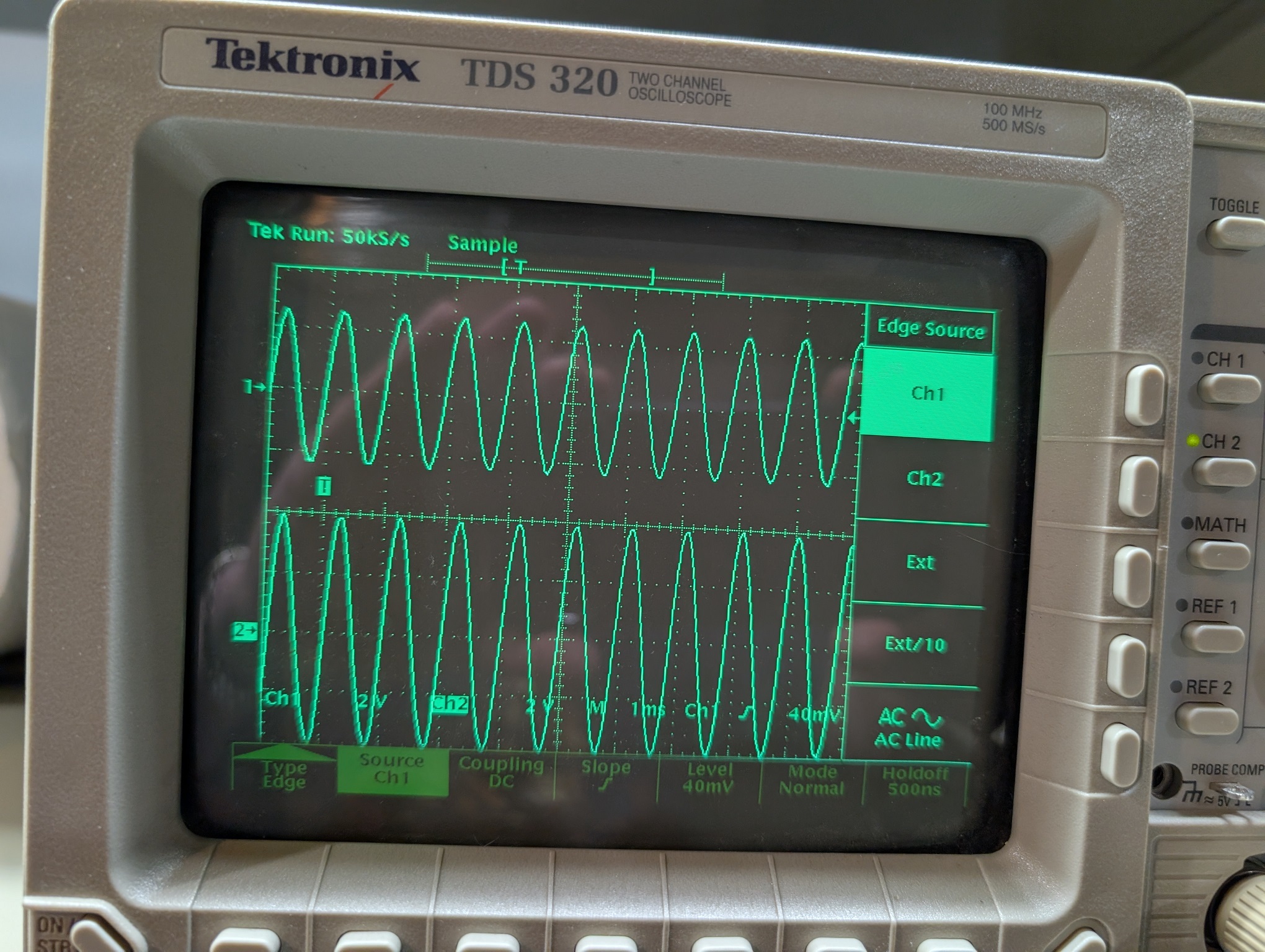

I put a generator and the scope to see the frequency response of the one I have that survived, and....oh boy.
I will put it here after this post.

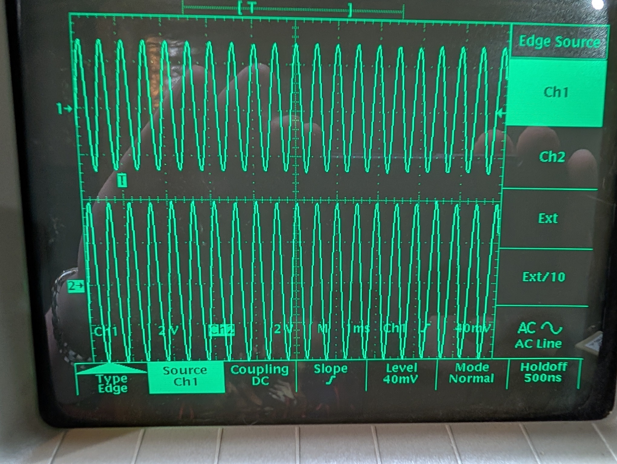

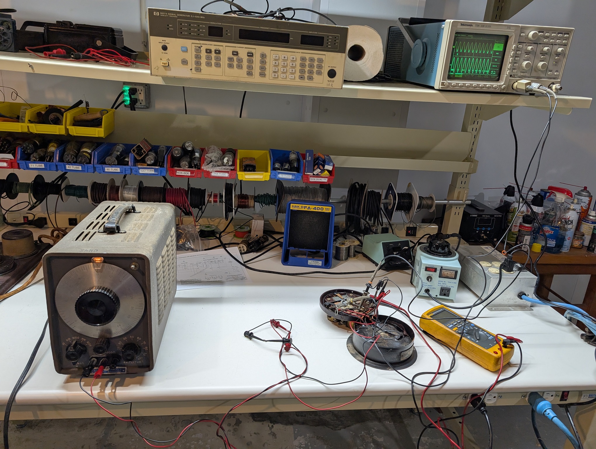

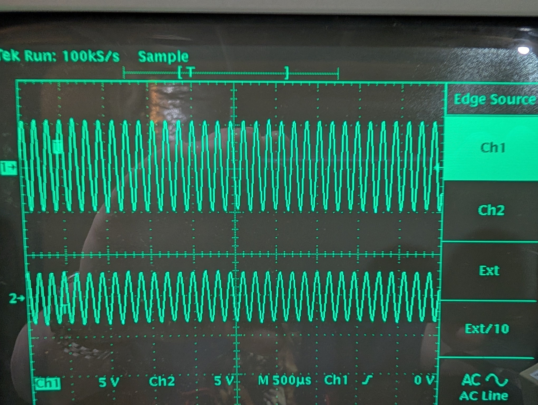

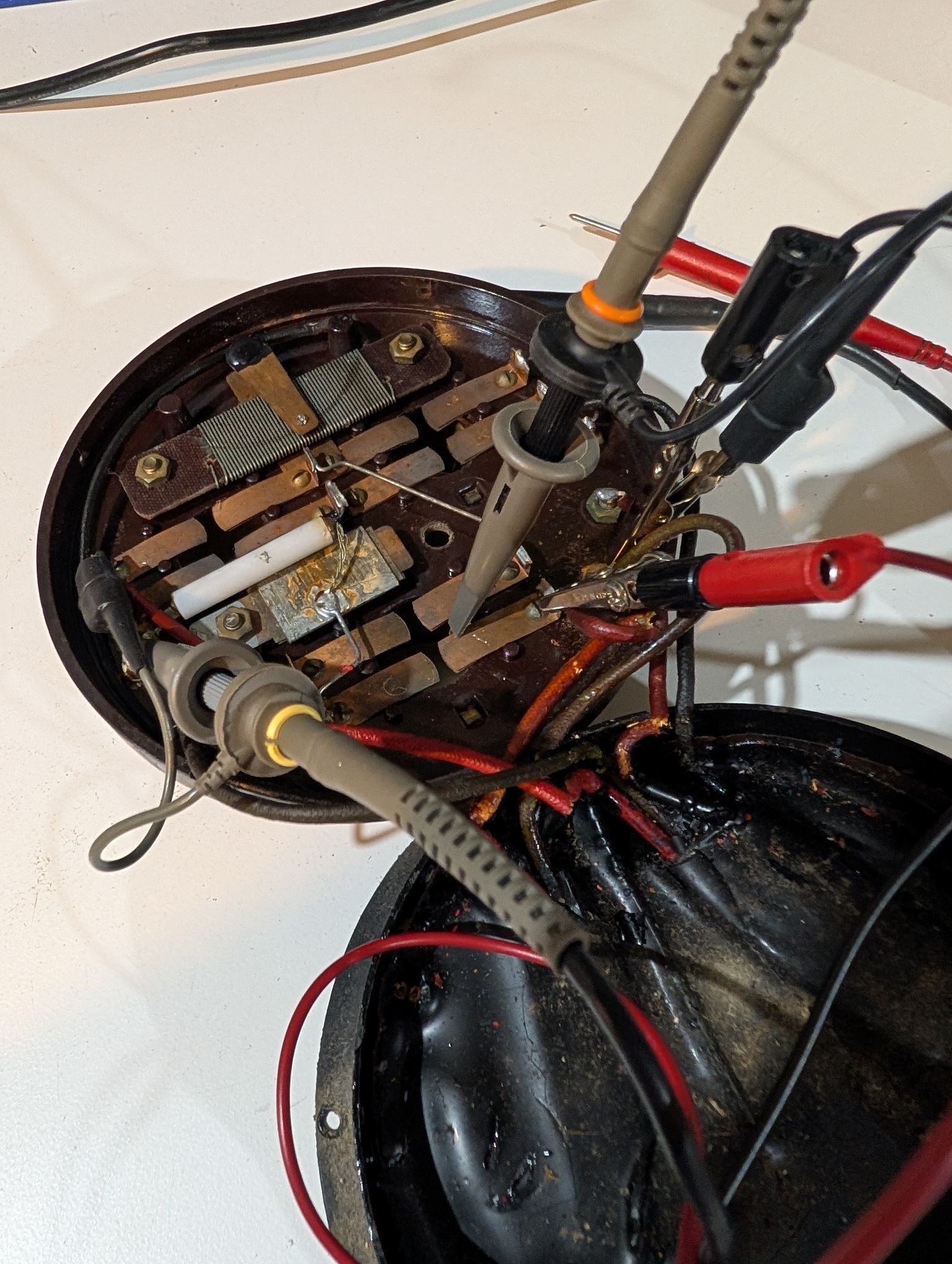

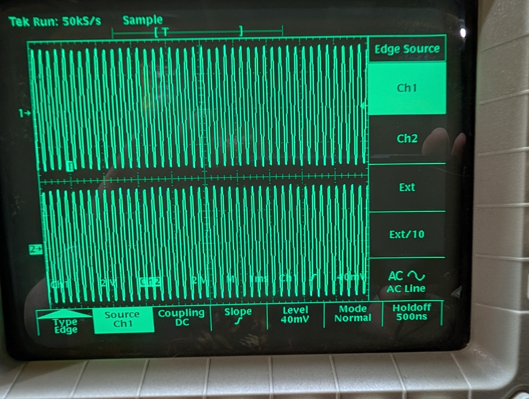

So I went and looked at the transfer of the remaining good xfmr.
I fed it signal from 1kHz to 6kHz directly from my HP oscillator, while looking at the input signal directly across the Primary and at the output directly across the secondary.
This is the setup.
The HP200D oscillator I havn't fired in over 10 years (restored way back).
The scope I fixed this summer with two channels. The channels are connected right across both windings, with the sig gen also right across the primary. So what we see is what is across the windings.

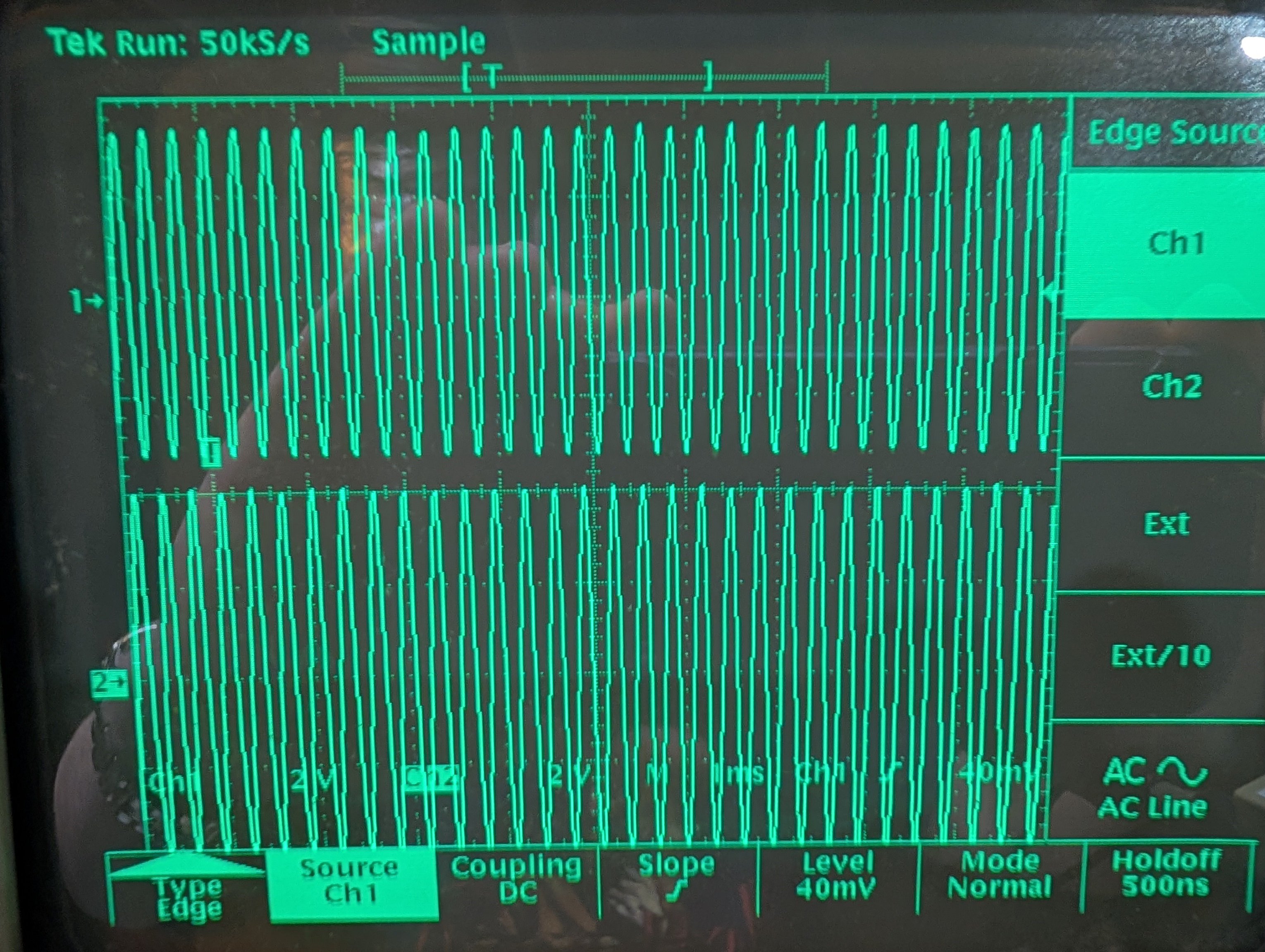

Now the inputs are in order: 1kHz through 6kHz.
Every photo will have the secondary to primary volts ratio (which is, more or less, should be the turn ratio, right? The claimed one is about 3:1)
1kHz - 0.65
2kHz - 0.7
3kHz - 0.825
4kHz - 1
6kHz - 1.66
So, so much for the promised 3.
I guess, the core type, the parasitics and the losses (what losses? 10M scope probe).
I feel justified replacing them.

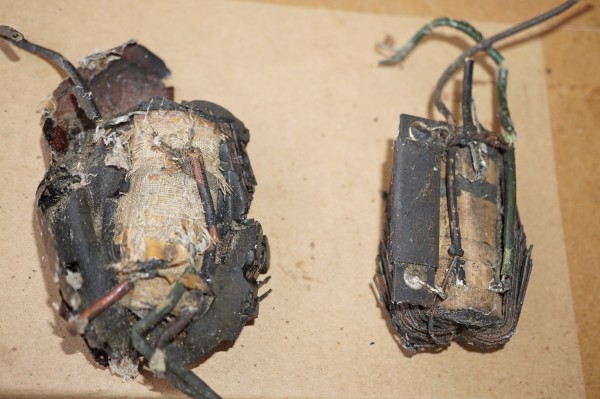

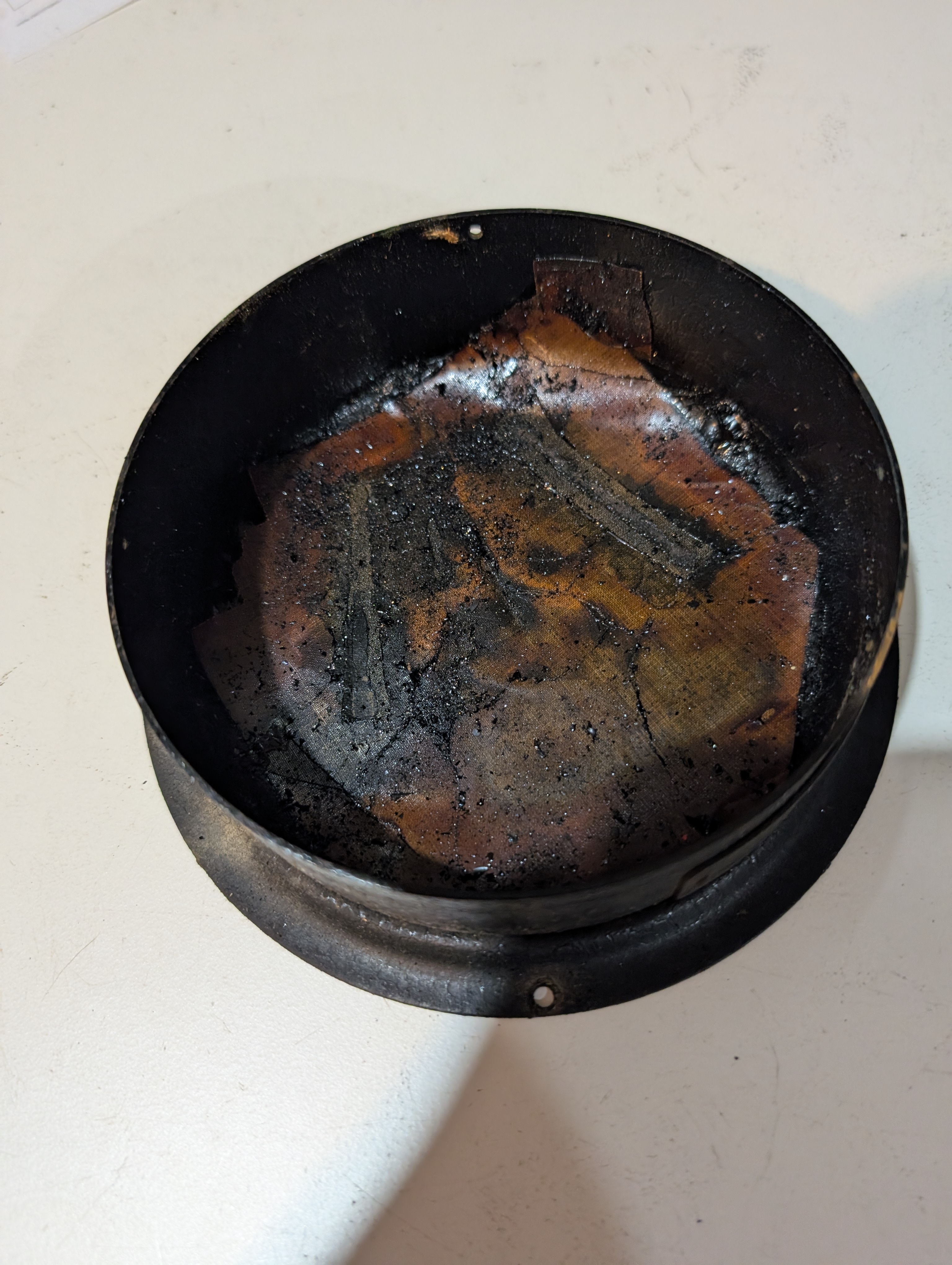

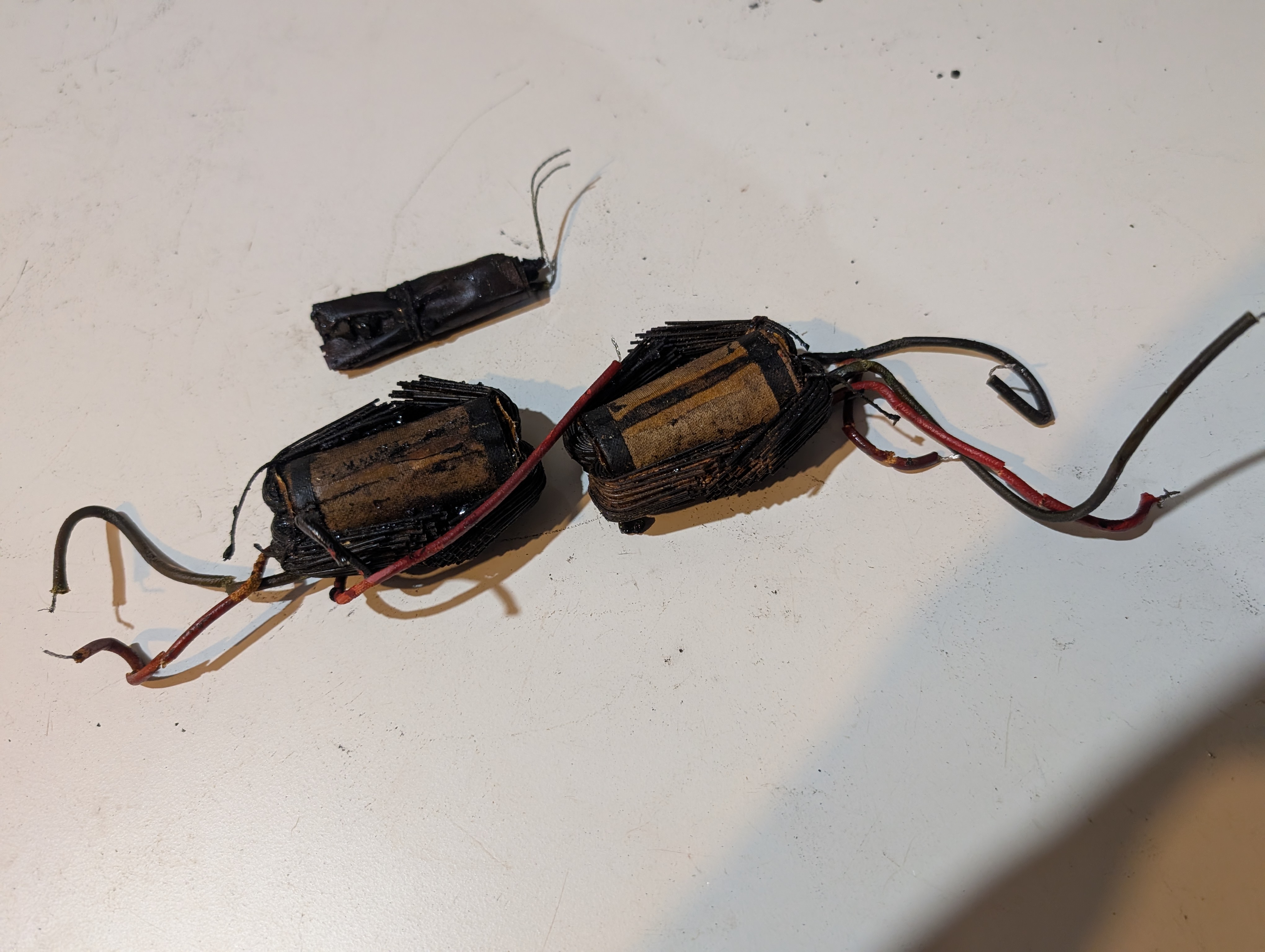

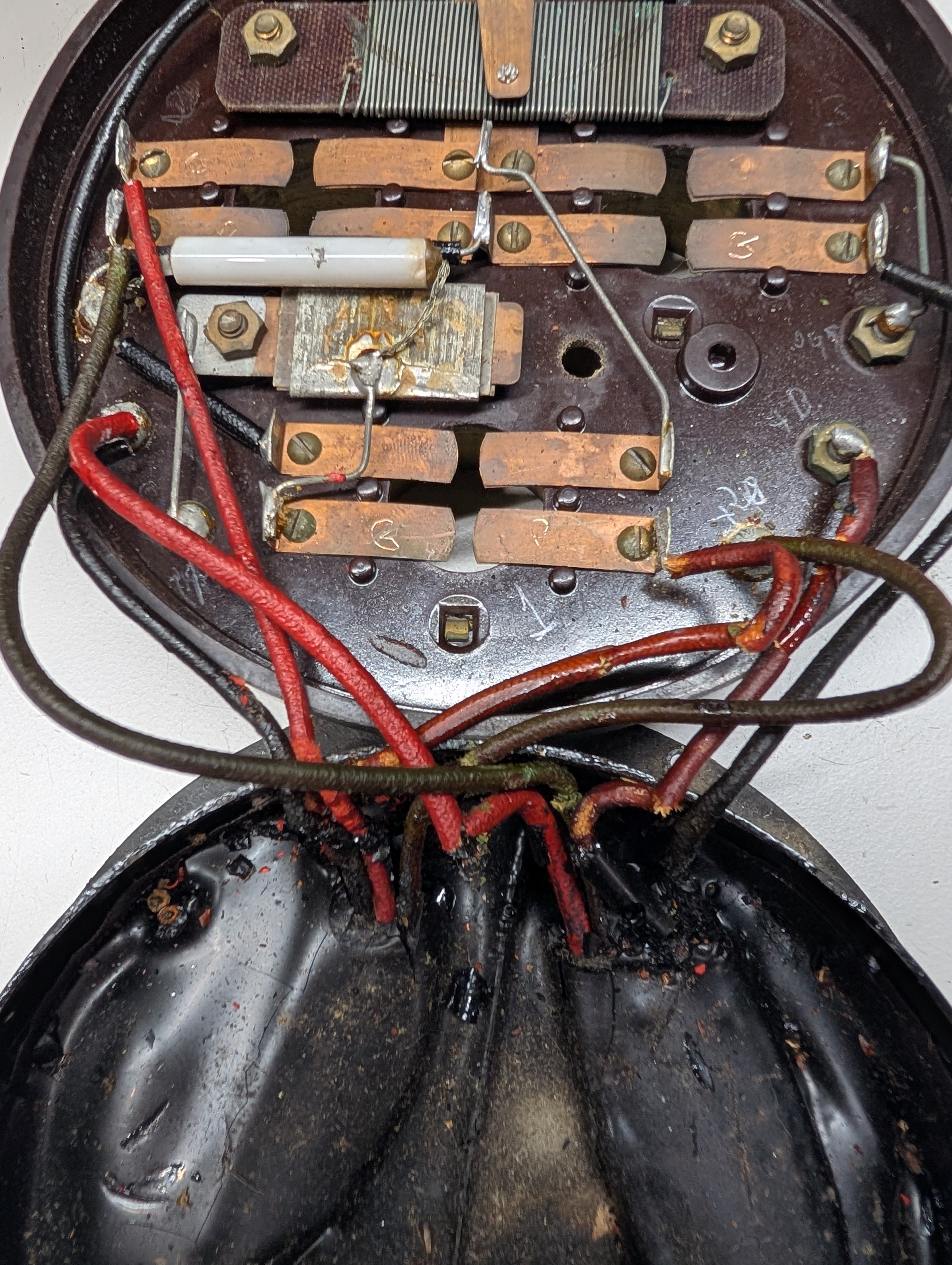

So today I retrieved the amp can from the freezer chest.
The instructions were to whack it agains the concrete floor.
I thought of it, found it 1) inconvenient, 2) potentially damaging the can, 3) messy, 4) some unpredictable effects.
So I put it, still in bag, on two hard wooden blocks on the concreted floor, put another piece of wood on top and gently knocked on it with a hammer.
It came out without argument or much mess.
I vacuumed the frozen pieces of tar, put the block on the table and gently tapping onit with the same piece of wood, cleared most of the tar away.
These are the can before and after, and the two transformers after removing the tar. Plu some other piece that was there, I am sure it is bad, whatever it is.

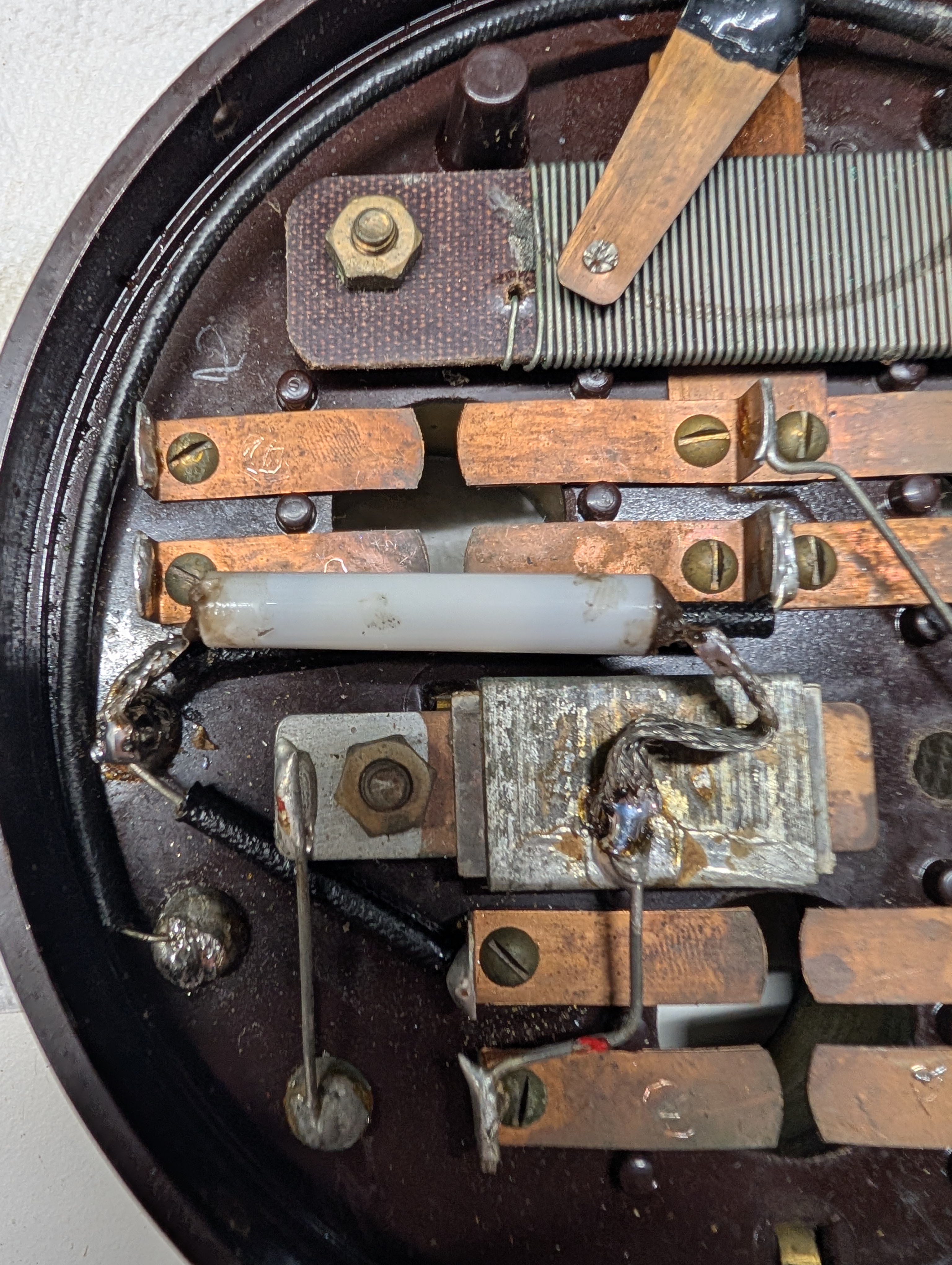

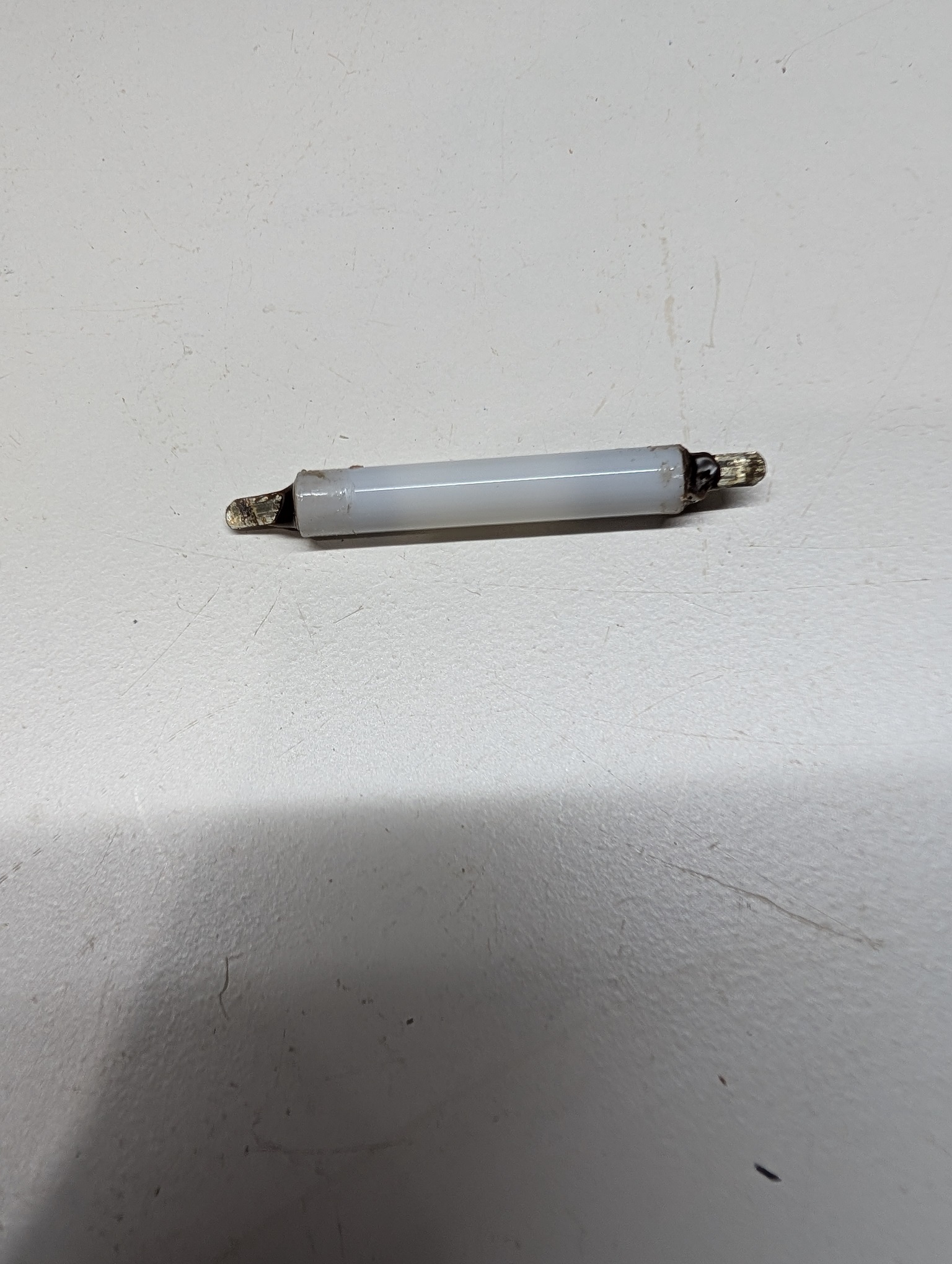

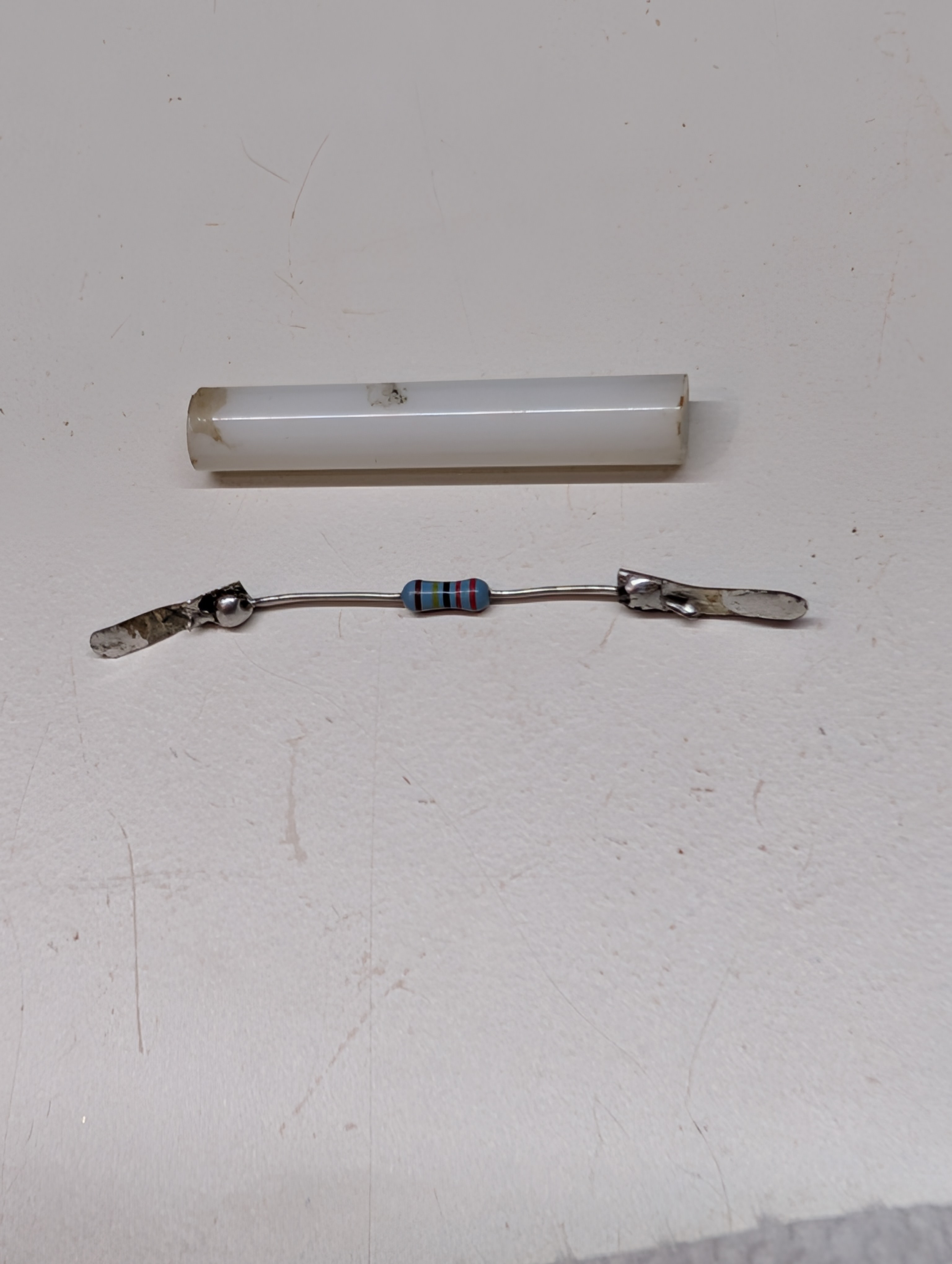

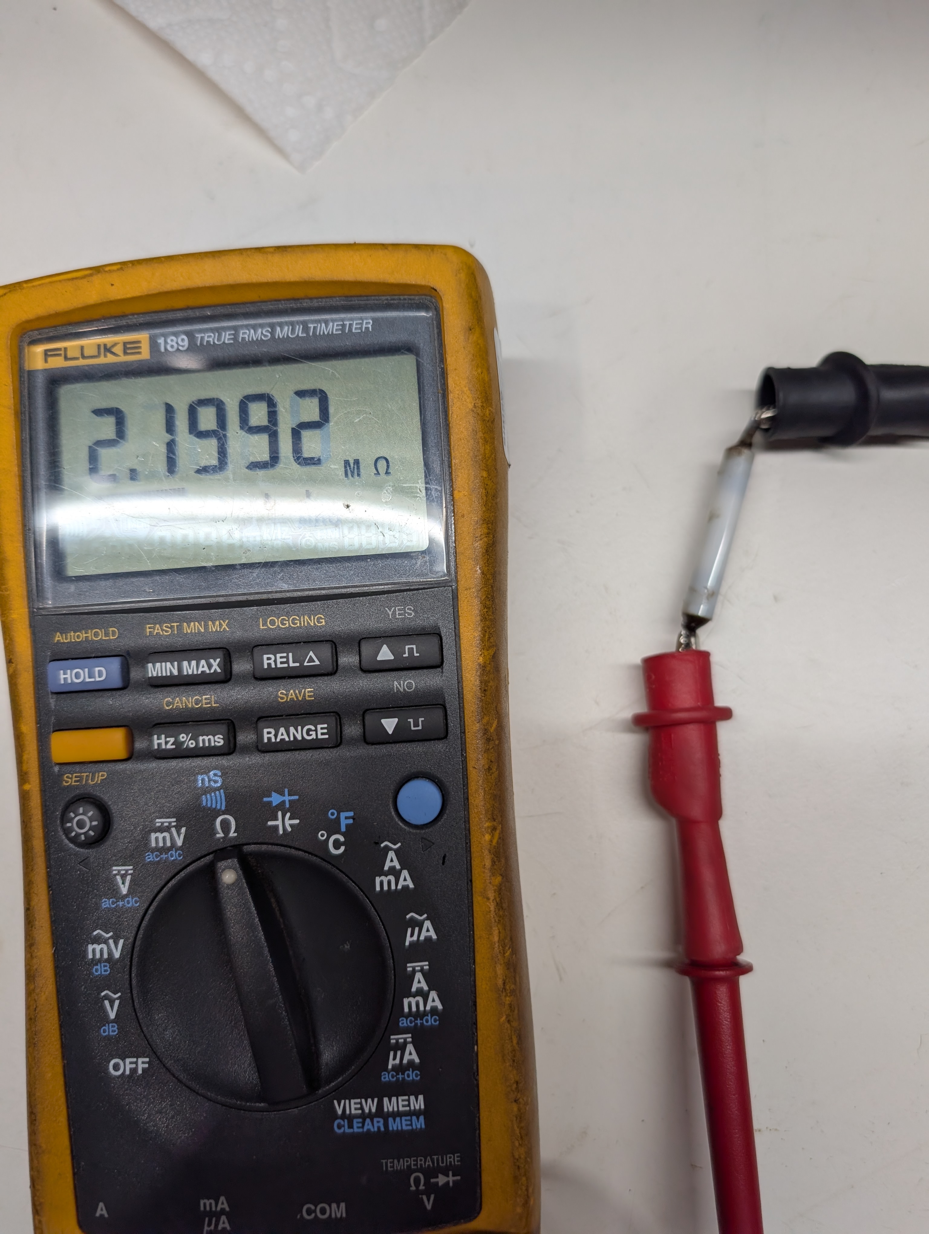

The 2M resistor from the AK10 amp. It failed because inside it is two think metal clipped wrapped around carbonized paper. Well, it separated from one of the leads.
The extracting is real easy, way better than any tubular caps.
So, this is the resistor connected to the old leads.
Potted/rebuilt
2M value verified
Before rebuilding, in place
After rebuilding, in place
