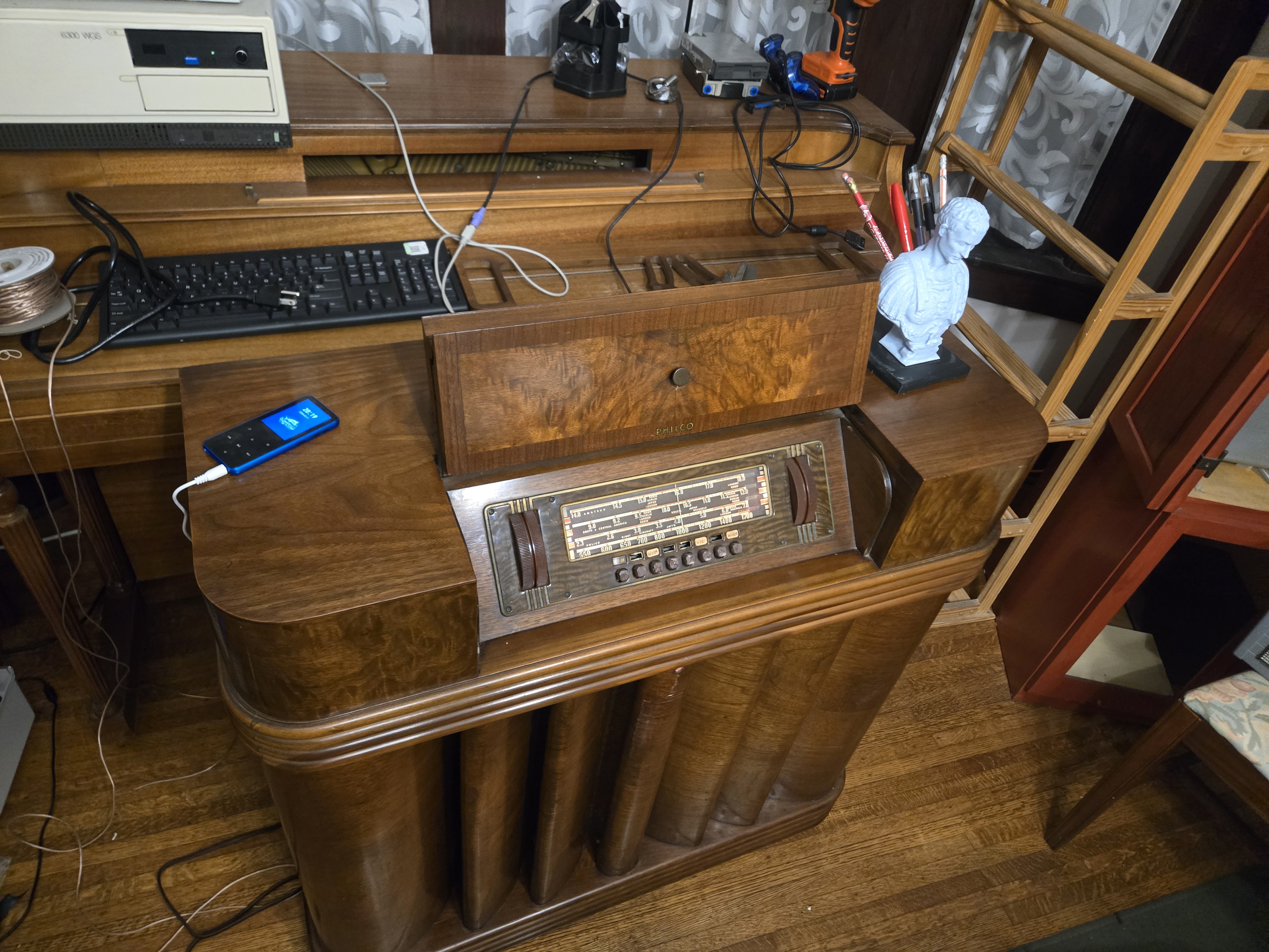

Over the weekend I installed the fuse and aux in. Success! The phantom voltage is gone too even for whatever reason. Not like the fuse changes the arrangement of the safety caps or anything. And the aux in audio is much cleaner than AM transmitter.
Remaining oddities: It has a bit of hum even with volume down that it didn't before. Nothing awful but noticable. Also despite doing a DPDT switch to send the radio in to ground, switching it to aux only attenuates a strong station, not silences it. Neither are crippling so I can troubleshoot them later.
I ordered some mica caps and an inductor to jury-rig an antenna coupler, though to make it more permanent I'll have to figure out the right size pins to plug into the connector. Those should arrive this week. After that, next phase will be working on the peeling veneer on the center column of the cabinet. I got some Titebond, syringes, and an iron, but details fit better in the other subforum.
I also am thinking I need to align the radio eventually since the dial seems off and I get dual peaks on some things, so I was looking into the details. Seems straightforward when you have the equipment, I just don't presently, so it's not an immediate thing so much as once I have the right test equipment.

Glued down the peeled veneer, not super aligned but it's hide glue so i can revisit later maybe.. Old English was magic on the scuffs. Reassembled and about ready to place in the downstairs hall until I'm ready to tackle alignment .
I still need to test the antenna, but after that I'm going to work on setting up a more 90s stereo for upstairs.
