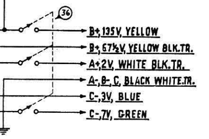

More research on the Model 38, it appears from Service Bulletin 166 and 166-A that this model needs:
A at +2V
B at +135V and +67.5V
C at -3V and -7V
(see attached pic)

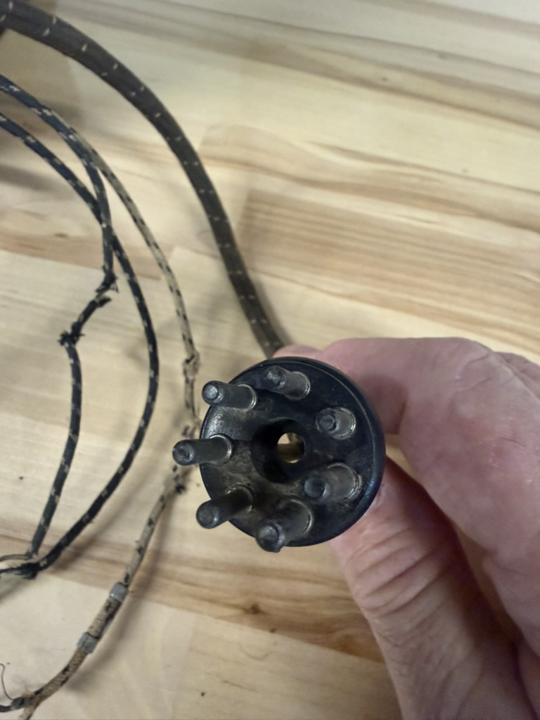

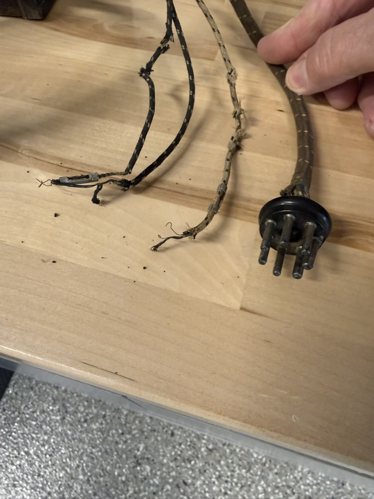

Looking at connector closer on my unit, I have 2 individual wires, likely for the A 2V battery, then a 7 pin connector for the B/C battery.

It appears that you have the Philco 38A which used a "combination" A/B/C battery much like the later 1.4 / 90V sets using an A/B battery. Your voltages are 3V A voltage if you have the ballast tube (that should have come with the radio because it uses the battery pack) 67V and 125V as Morzh said for B voltages, 3V C -for Output tube bias and 7.5V C- for 1st audio amp bias. The drawing is incorrect; it should be 7.5V, not 7V.

BTW, yes, the power cord looks like it would fit a 7 Pin tube socket similar to the one used by a 2A7 or 6A7.

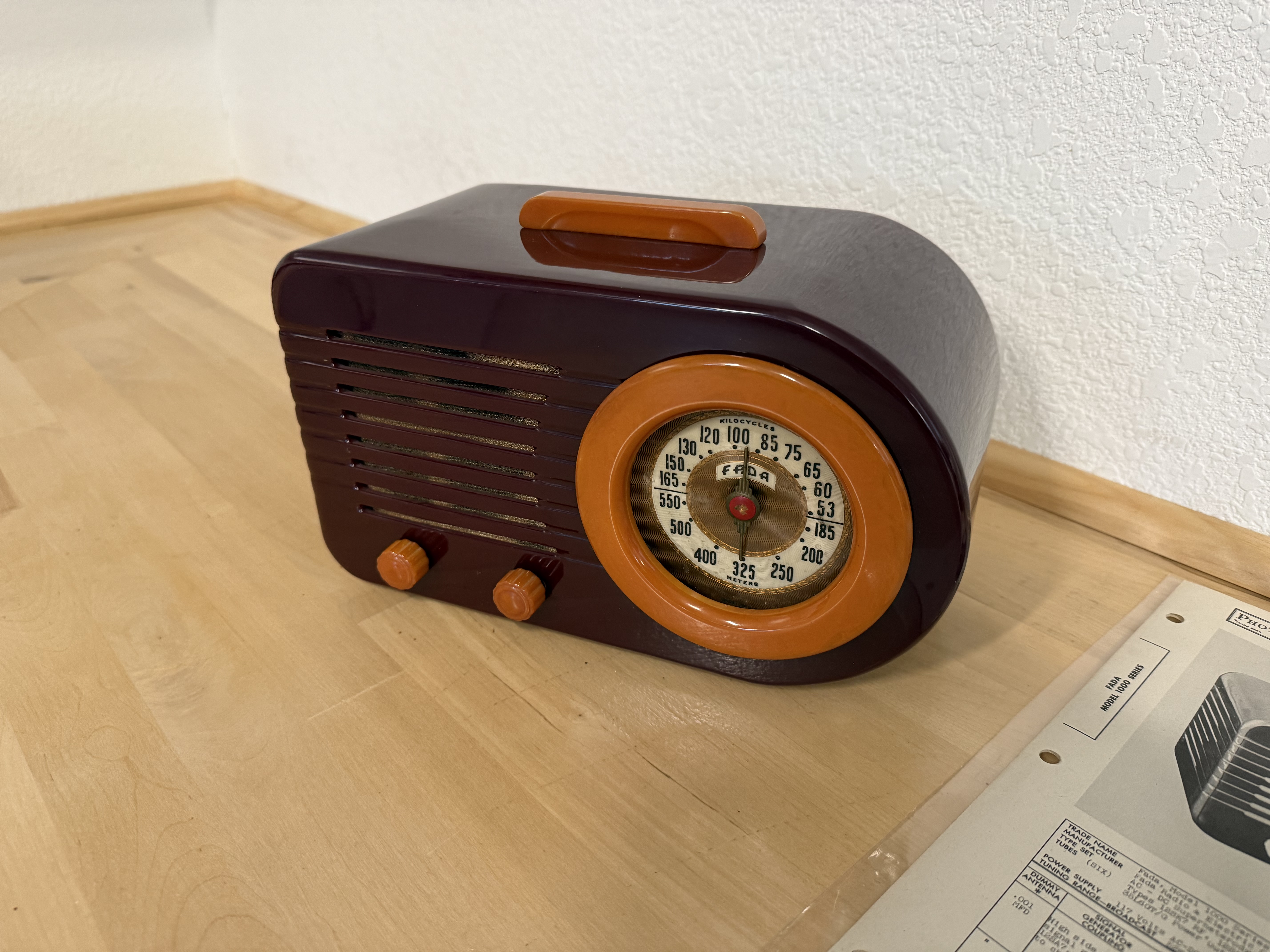

You are well on your way with this hobby with an interesting inventory! Does the FADA 1000 have a Catalin cabinet? I think the FADA 1000 is merely an AA5, but the Catalin cabinet makes them worth a MINT! As in US Mint.

Yeah, the Fada is a Catalin, I got lucky in getting it. Cosmetically it needs a dial cover and rear panel, both on order. Chassis repair seems straightforward. Not sure if I will resell it or keep it afterwards. It is the one and only Catalin unit I have, so I'll probably hold on to it.

The FADA 1000 used the same circuit as the FADA 1001 I have, it has an extra tube as an untuned RF amplifier, a 12BA6. I'm guessing that it was a last minute addition as all of the others tubes are your typical metal, and GT style octals. In any event the 1001 is one of the better performing AC/DC sets I have for DX, so if I were going to choose a catalin set to keep it would be something like that since it's not just a pretty face. Be careful with it though, these sets have an actual HOT CHASSIS where one side of the power line is soldered directly to the steel for common negative, though I suppose it could be modified.
