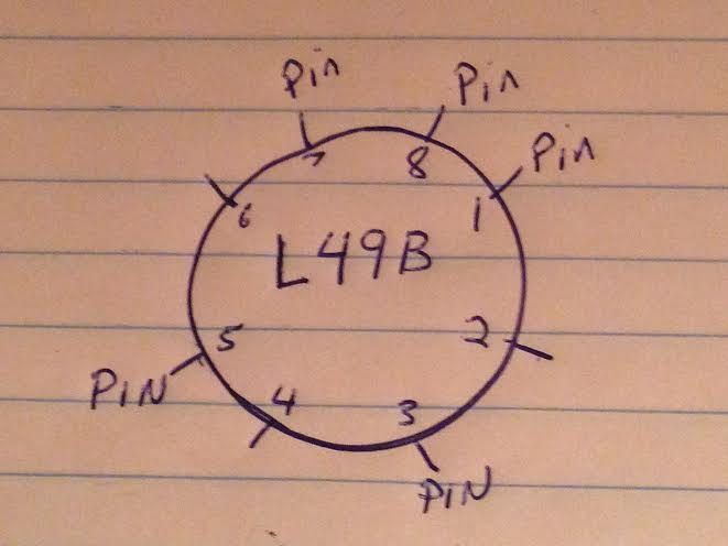

Once the L49B is numbered right according to the L49B actual data (I gave you the link), look at the diagram.
What L49B is is a ballast tube: it drops some voltage at a given current (in short it is simply a glorified resistor) so the rest could be applied to the serialized filaments of the other tubes, and at the same time uses a tap in that resistor to derive the voltage to power the dial lamp(s).
Now I believe it has just 3 pins that are functional - the beginning, the tap and the end of that resistor. The rest of the pins is typically a dummy - the pins do not go anywhere or even missing.
Now once you have mapped your socket with correct pins and look at the tube's data, look how the MAINs wires actually connect. One, very similar to the Stromberg radio diagram I listed, will go directly to the beginning pin of the ballast.
The other then should go to a pin that is dummy or not used, they usually do that to use a spare pin as a solder post, for convenience. If it is the case (and I think it is) you are OK.

#32
This is the proper numbering of the L49B. The mains connect to terminal 3 and terminal 5 (being the 2nd and third pins), both are occupied by pins. I would assume that since I did plug it in and turn it on when I first bought it and nothing exploded that it was wired correctly unless it blew up in the past. there was no response when i turned it on. nothing lit up, nothing hummed, it was dead One thing is the main is not connected to the #1 pin. I cant tell from the ballast tube diagram you sent me which are active and which are dummy pins.
#33
As I suggested, look at the diagram.
http://www.radiomuseum.org/tubes/tube_l49b.html
You will see that the pin 5 is a dummy pin.
They use it as a solder post, just to hold a wire. It is a popular practice.
Pin 3 is one end of the resistor which is consistent with how it should be. Now the pin 7 then (another end) should go to the strung up filaments, and also to the dial lamp.
Pin 8 should also then go to the dial lamp.
#34
Yes, pin 8 goes directly to the dial lamp and pin 7 runs through pin 5 of 25z5 to the dial lamp. Main runs to pin 3 (active) and pin 5 (dummy)
