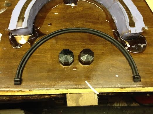

Kirk,
It looks great! The problem is now the knobs look lousey.
Nice job,
Henry

Decals would be an acceptable substitute, I think, and could be added by the buyers of these grilles to take care of that problem.
Looks great, Kirk! Icon_thumbup Icon_clap

I wouldn't worry that some models were embossed or even about the swirling effect although that woulld be nice. If I needed a grill to complete a radio yours would do it. I think it would be interesting to know how the effect was done.
