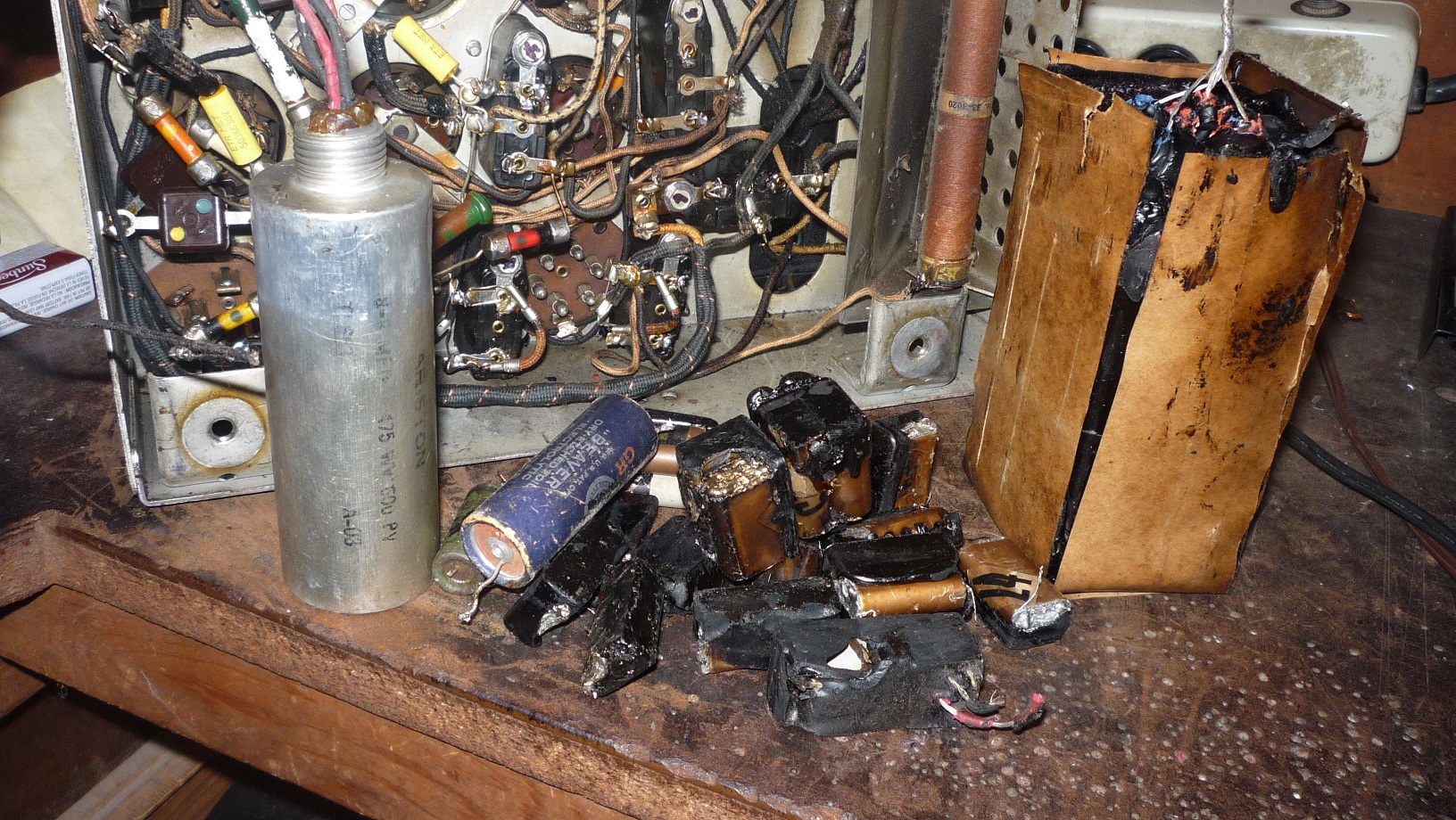

The old caps are starting to pile up nicely, i have 3 left to do which includes the tone control and the BIG condenser bank. Which brings up a few questions as i explore this radio.
1. Why did they bother to put rubber insulators on the tuning gang mounts if they were going to solder ground leads to the chassis?
2. Anyone have any procedure for removing the condenser bank? as in removing attached parts prior to removal. Or did you remove the bank with external parts still attached to it?
Thanks..

Well.....THAT was fun... Didnt have to remove the entire unit to replace the guts.. Pretty lucky with the cardboard liner, just slid a knife around the edges and it popped out..
All caps have been replaced... DIG THAT PILE!!  im getting an itch to light it up and check my progress.. Icon_biggrin
The radio has lost some weight as well   Icon_thumbup
