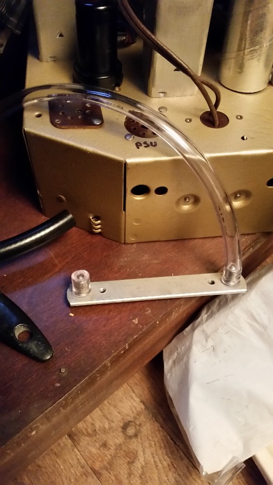

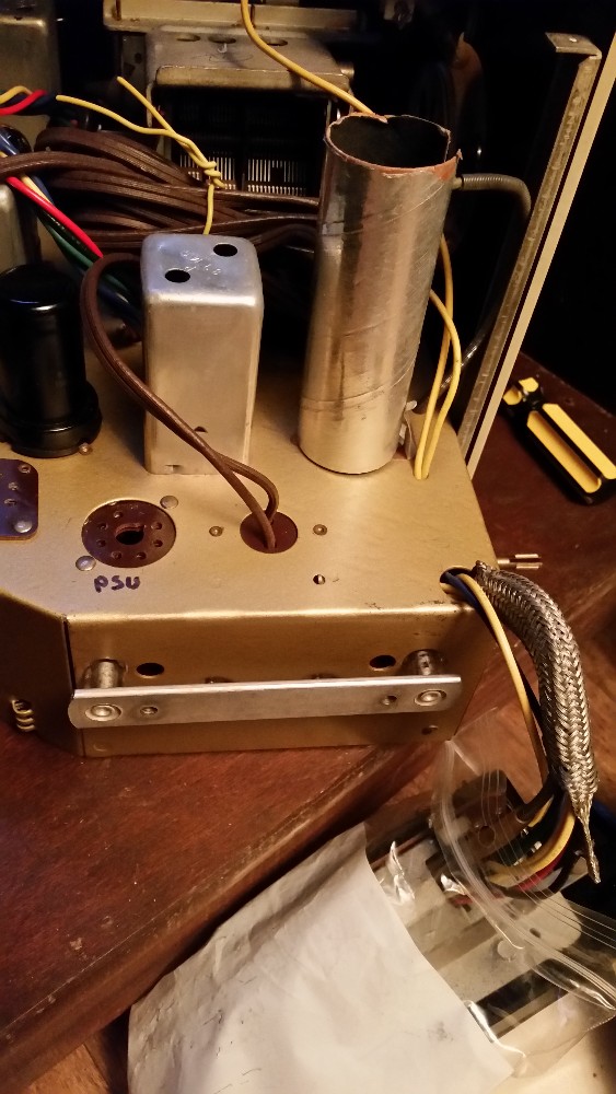

Here is the method I used to refit the mounting bars. These suspend the radio chassis in the pull-out drawer.
I used two sizes of clear tubing (one fits within the other) to make a substitute grommet. This makes a good snug fit between the peg on each bar, and the 7/16" hole in the chassis.

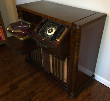

Through the magic of the internet, all you have to do is scroll down a little to complete the arduous task of replacing the magic parts inside the wooden boxy thing.

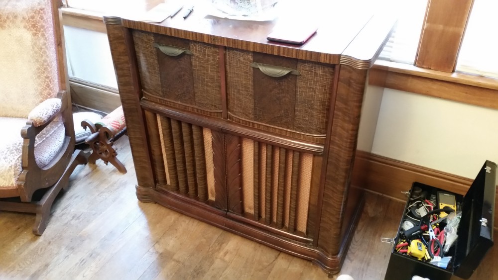

Here's the furniture aspect:

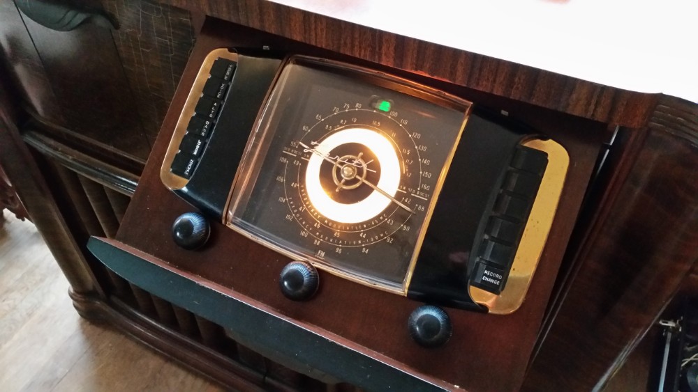

And here is the "Magic of FM". Instructions direct the user to adjust tuning until the bars on the eye are evenly balanced. The top bar is fixed, the bottom bar (connected to the discriminator) expands from the right side as one tunes across the signal, indicating the position of the station center. On AM, the whole eye works together, opening and closing from both sides.
I'm demonstrating here on the 100 mc/s band, as there seems to be an interruption to the programming on Captain Armstrong's stations around 45 mc/s.
#51
On the other side, the drawer opens up to reveal the Cobramatic phonograph. Here, we have a couple of problems, and some creative input from Mrs H. The turntable is missing a needle, and will only play 78's. add to that, yet another long harness filled with crumbly rubber wire. Amongst the other things we seem to have accumulated going through life is a "Nu Tone" turntable, sold as a cheap way to digitise your vinyl. It is a good fit in the space occupied by the Cobramatic turntable, which has been delicately removed, and will be preserved for a possible future project. All changes are completely reversible, so (in my book) don't count as mods.
The next project will be to fabricate a board on which the newer TT will sit, and also to contrive a means to connect it into the main audio circuitry of the receiver. I will need a connector suitable for the radio chassis, if cannibalising the old phonograph harness is not desired. Mrs H really wants this to be usable for records and radio, and I think this is a great compromise Icon_smile
