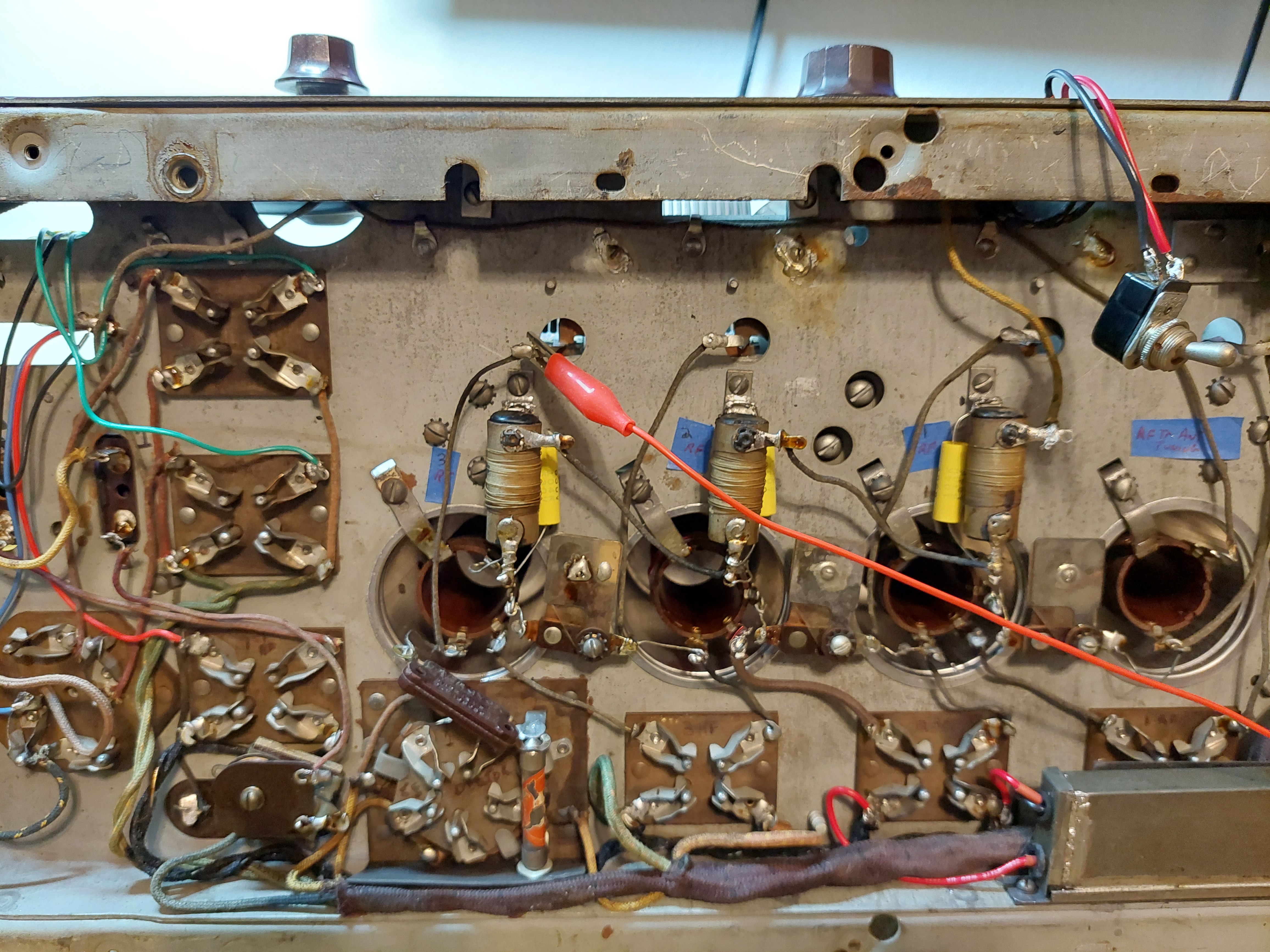

Finally got the .1 caps and installed them. Still no reception, so I poked around with the antenna wire and got 2 local stations with ant hooked to the 3rd RF at the tuning condenser. See photo. I guess that means the problem in between there and the ant connection Suspect the rewind on 2nd RF was not good enough. Any test to isolate it any closer?
Thanks for your help.
George

Are those capacitors shoved up inside the first two RF coils? And what is that wire roughly wound around the three capacitors above the RF coils in the photo above?

You could look up my thread. Those are wire-wound resistors, as I remember, 100 Ohm, and the caps were inside them.

Never mind, Mike. I was rather ill yesterday and the photo gave me an optical illusion of having a large film cap inside two of the RF coils. This morning, after some sleep, I can see that isn't so. However, the windings around the caps still look like they are either coming loose or have been crudely rewound.
I am well aware of how to rebuild those cap/resistor combinations, having most recently done that work on a model 87 only a few months ago.
https://ronsradios.com/2021/07/19/philco...rs-part-2/
In the 87, the resistance wire was not wrapped around the capacitor tubes, but encased inside the tube with the capacitors.
To that point - If the resistance wire is open on any of those three capacitor tubes, the radio will not work.

It looks just a smidge cruder than those on mine; the right one here actually looks pretty much the same.
Sure it won't work - these are B+ filter resistors. Without them there is, well, no B+.
