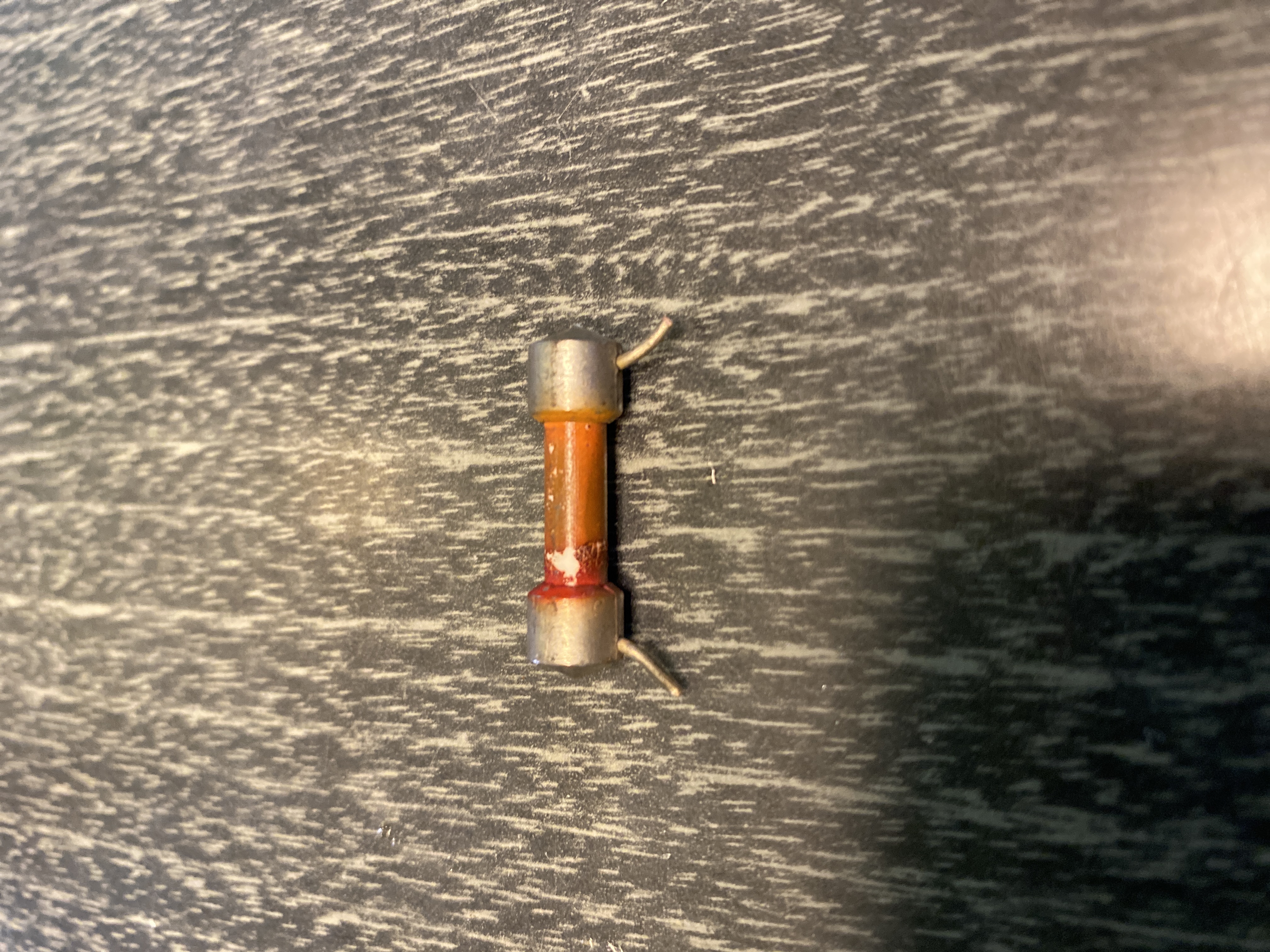

#60
So this 32,000 ohm resistor is measuring 17,000 ohms with my new multimeter. And this is the one that goes to the outer winding of the oscillator coil, so I’m hoping this is the problem! New resistor is coming in tomorrow or Wednesday I believe. Goes to show that cheap multimeters will screw everything up! I’m not sure if 17,000 instead of 32,000 will make the radio not play, but it does need replacing! Time to cross my fingers
