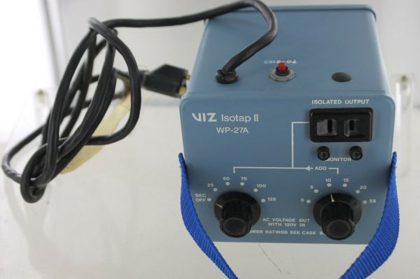

Hi Roy, most variacs are auto transformers so you still need an isolation transformer. The picture I posted is what I have been using for over 40 years. Isotap isolation transformer. You can vary the output in 5V increments from 25V to 150V AND it is an isolation transformer in one neat small unit, saving bench space and less expensive than separate variac and isolation transformer. I believe they are still sold by some companies or they show up on eBay!

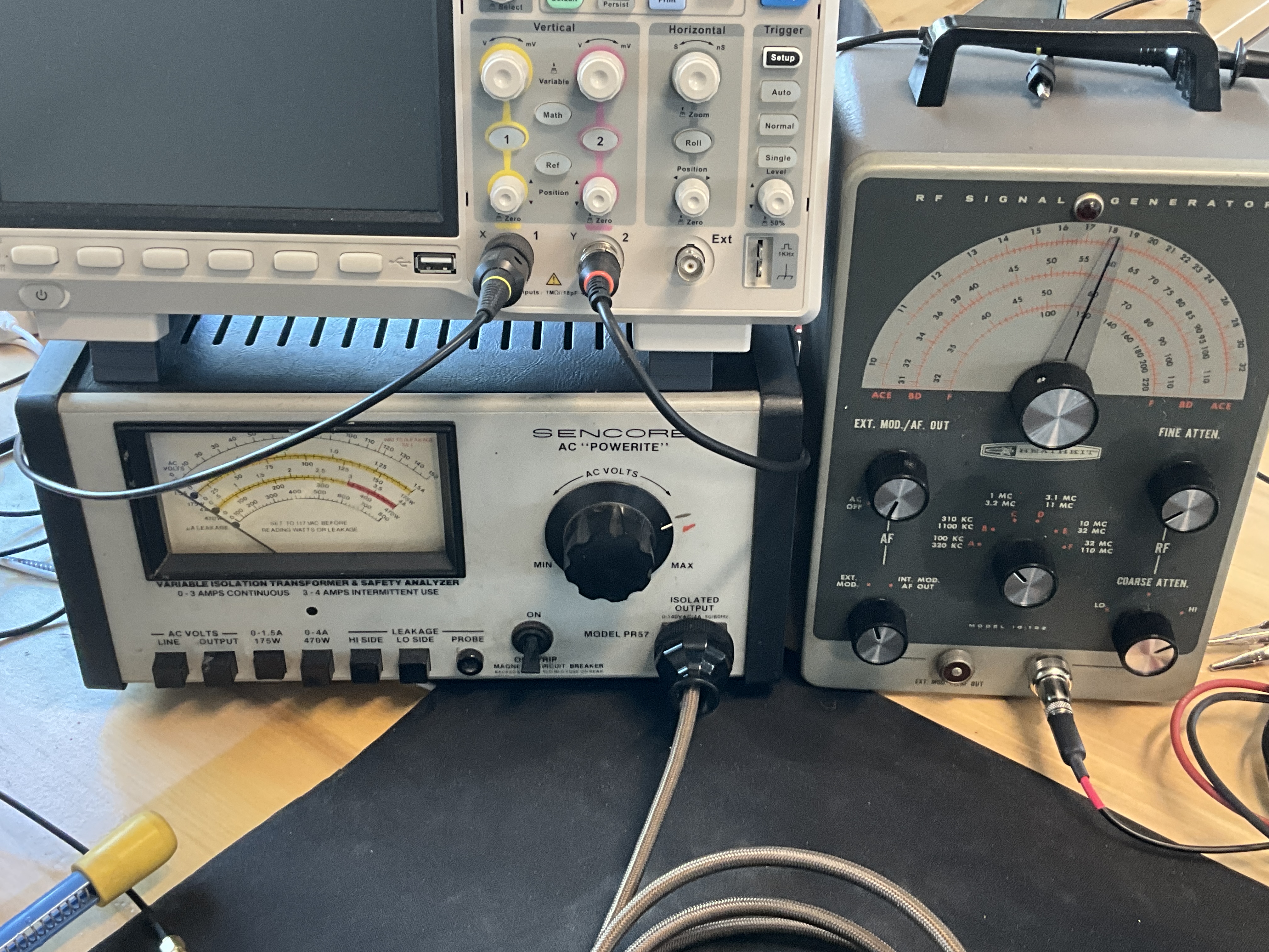

Regarding your questions on measuring B+, one document that I think does a great job of explaining all this is the Philco Trouble Shooting Techniques handbook. This is a short 11 page doc but it does an amazingly good job of giving an overview of a process you can follow.
If you want to go deeper, in my humble opinion, the book that is the best is Elements of Radio Servicing, Marcus and Levy. I still have my copy I got while in the navy in 1981. You can’t go wrong with that book, if you want to dig deeper. The third edition is the best if you can find a used one.
Another good reference is Radio Troubleshooters Handbook, Alfred Girardi. The cool thing in this book is they have this case-study massive section that lists every radio made in the 30s-40s, and they list common defects and problems and solutions. That has come in handy for me many times over the years.
For Signal Generator, you really just need one for alignment. My personal favorite is the Heathkit IG-102. It was made in the early 60s I believe. And because it was a Heathkit it is easy to service and find documents for. And really it is so simple to use and to understand. You can find used ones on eBay quite often. There a couple guys who service and calibrate and resell them.
For isolation transformer, my favorite is the Sencore PR57. It isn’t cheap when you can find a used one, but I had a bunch of them when I owned an electronics repair shop in San Diego back in the 80s and you can’t go wrong. But not the cheapest solution.
These are just my thoughts from someone out here messing around and trying to restore a few of these beauties. Hope this helps some. George

I have one of those RCA-branded version Isolation trans. Since my repairshop was RCA Dealer but the main unit I use is my Sencore Prorite like George has in his photo .

Roy, that Viz or RCA IsoTap is good for 400W, back in the 70s I did TV repair and used it!
