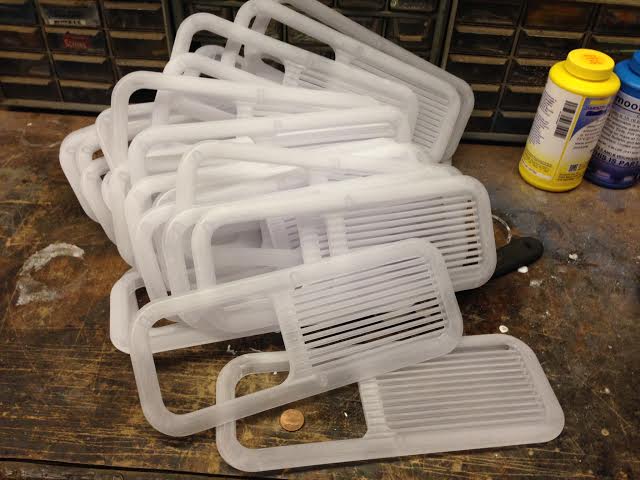

Ok,
50 ready for paint!
I will be making them in colored plastic but not for a few weeks. No money for it right now.

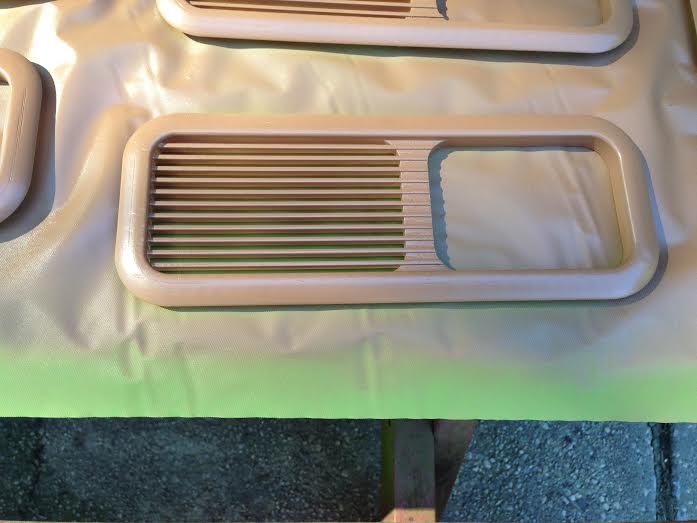

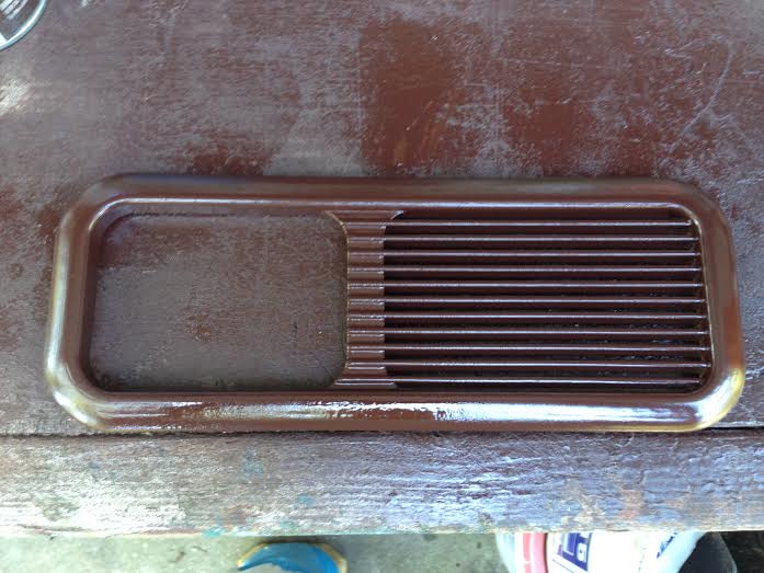

OK,
I made 10 black, 10 white, 20 lighter brown and 20 darker brown.
What do you guys think are the best colors to do?
Which brown is better to match the original?
#50
OldRestorer Wrote:Which brown is better to match the original?
The darker brown. The 41-226 "Sled" used this color.
If you still have the list I sent you previously, you will note that none of these Philco sets used a black escutcheon/grille. If you can find a lighter ivory color paint, the ivory versions will look very good.

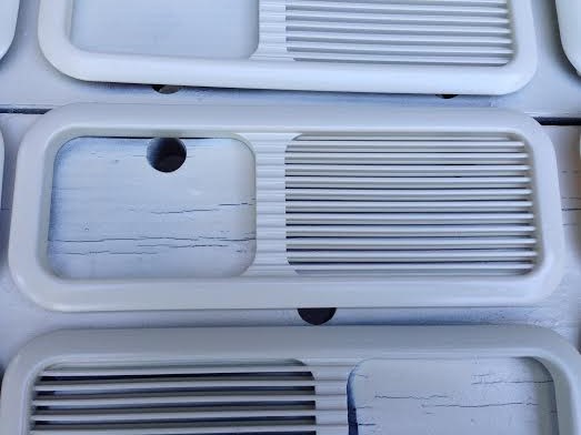

#53

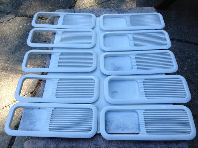

Ok, antique white was the best I could find. The ivory was greyish and kind of sparkley.
What do you think?
#54
Looks like a brand new part (which, of course, it is). Icon_thumbup
Allow me to congratulate you. You have done an amazing job on these parts!
Since you also participate over at the Alternative Radio Forum, ask Gary Rabbitt over there what color paint he used on my 38-12CBI. Now that would be the perfect shade of ivory for those grilles. The antique white looks good, though.

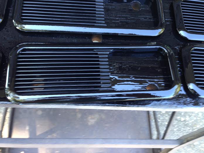

#60
Kirk;
  Were you having problems with paint adhesion, the pain looks like it wrinkled on some of those grilles? If so you may have to give them a good wash in a degreaser, like hot water and TSP, first and then prime them. What sort of plastic resin were you using to cast these with, epoxy? Polyester?
