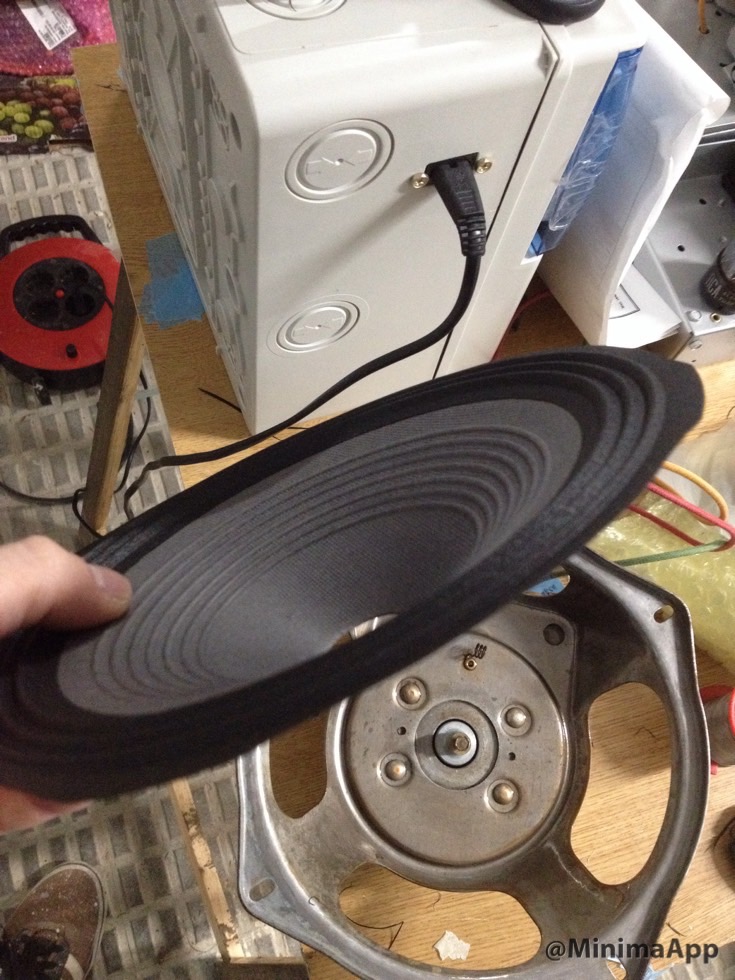

Well then, was free, I will make a good paper weight Icon_smile or use the refrigerated box to make a diy proyect... Now on trails again I got some time to test with real full voltage 115vac, and 6,3v on heaters, connected an old car speaker coaxial to the secondary, AM and after 30sec warming it started to sound an station! I raised the volume almost full but was like 30% in volume, mention that I have no antenna installed, but just by getting close my hand to the green wire comming from the tunning cap to the top of the 6A8G det-osc the volume raised a lot. Now I know is working I will try to do the alignment with the heathkit after check it, I received also today the new cone, is one I found in italy since the shop in USA does not ship overseas, was arround 10€, not cheap but this one is paper reinforced with cloth and look almost the same as the old and fit almost perfect, just little trimming on sides to get inside (is 8") maybe is little more rigid than the old...I will post Photos later.

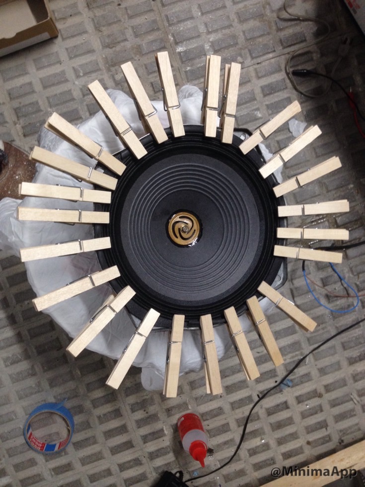

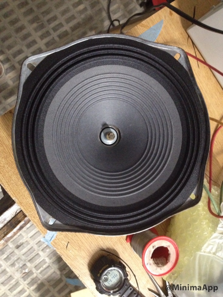

Here are the pictures of the speaker trimmed
#69
One more

I do not know if this is the correct place to ask since is a general question not relationed with the radio, is something that surprised me with the SG heathkit: almost all ceramic capacitors (more than 10) are far away from its values, I though ceramics are more reliable and dont fail as silver mica, is it normal? By the way, speaker is finish
