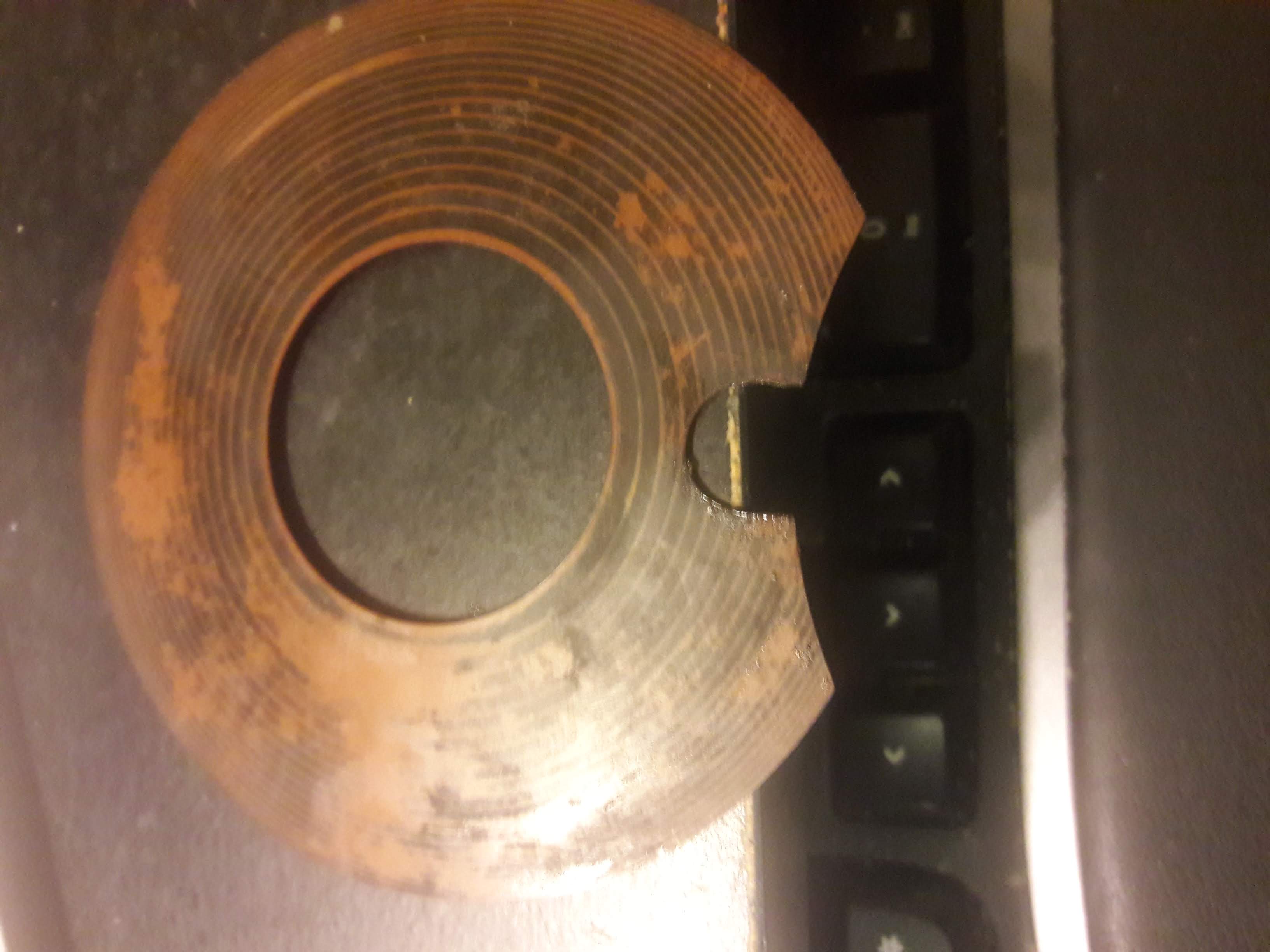

I have another question, where can I get another tuning dial insert for my 116B?
The item I'm referring to is pictured below.
I'm asking because I can't seem to find this part anywhere on the internet, Radio Daze doen't have Reproductions of it, there aren't any for sale on ebay whether NOS or Reproduction, or previously used units.
I don't even know what this part is called or if I'm even searching for the right name for it.

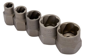

Hi Captain, there are various types of easy out tools for removing stripped hex head bolts. You can do a google search or visit a hardware store and see what they got that could work!

Quote:Hi Captain, there are various types of easy out tools for removing stripped hex head bolts. You can do a google search or visit a hardware store and see what they got that could work!

[Image: https://philcoradio.com/phorum/attachment.php?aid=21423]
I was thinking of those as well, but I ended up getting the bolt out by just drilling the head out.
The hex nut screw they used is a common enough size that I can just pick up some new ones at the hardware store.
