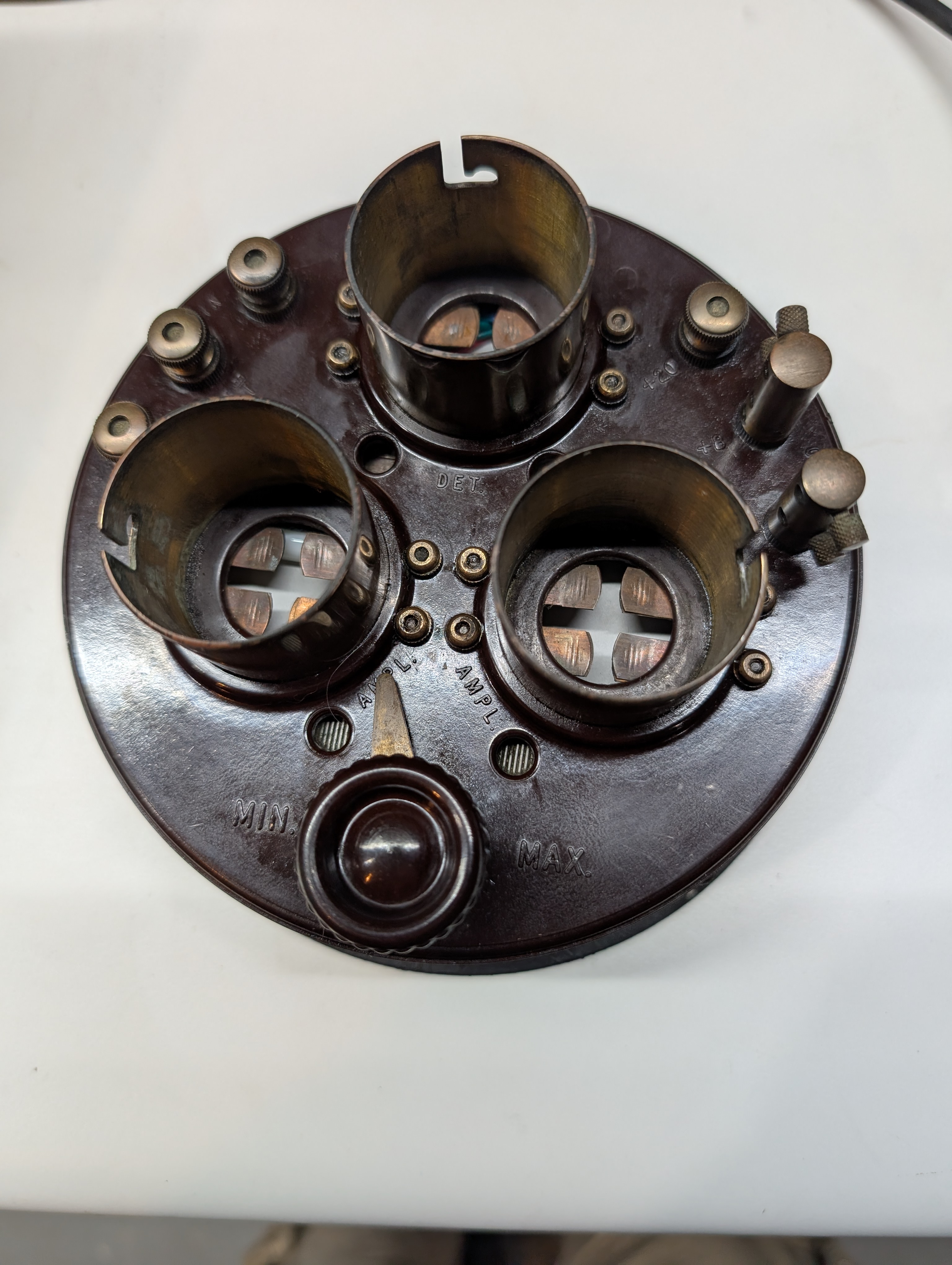

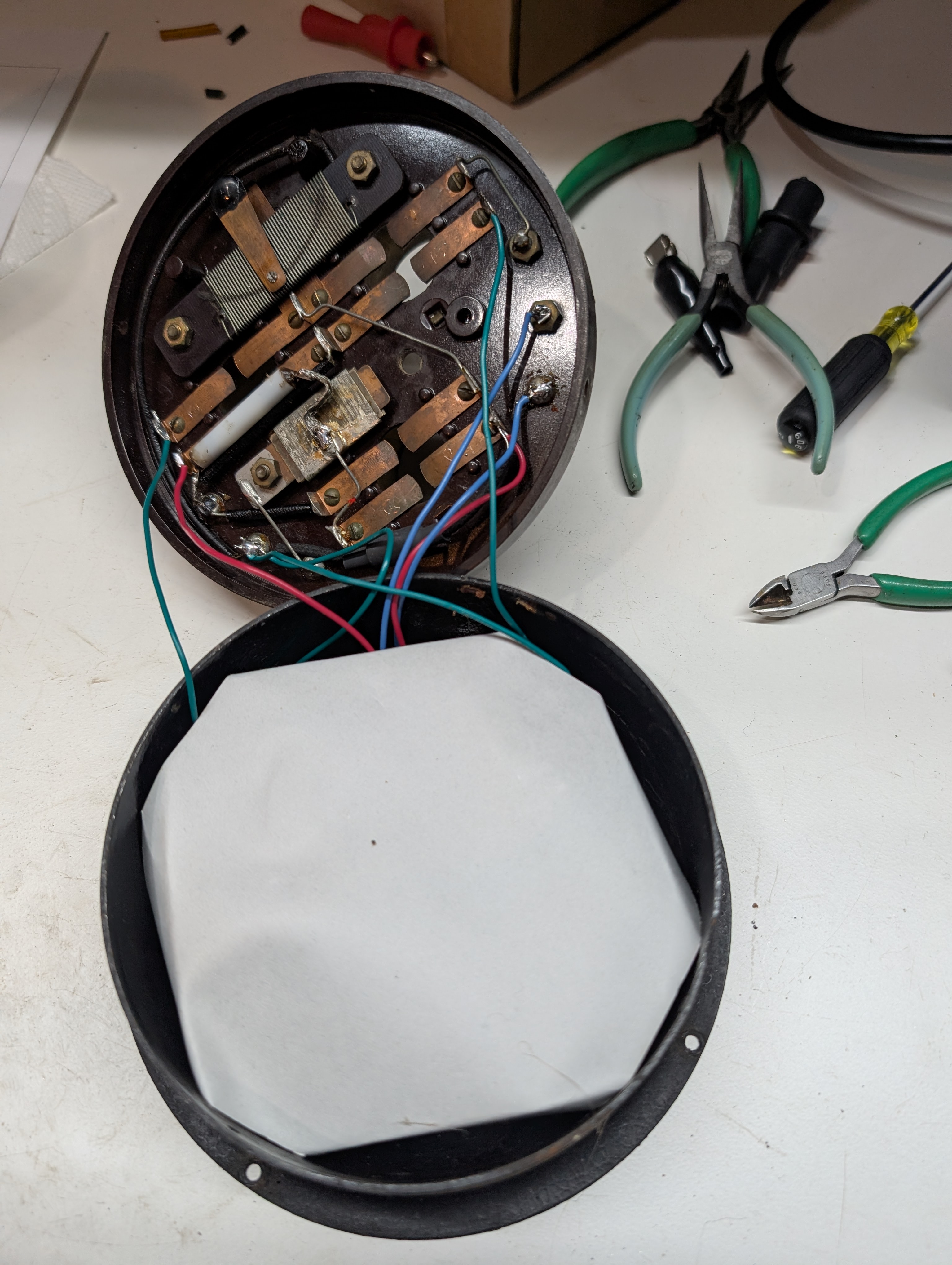

After I have soldered in the interstage transformers, I covered them with fishpaper. Just in case, it seems they did not touch anything.
Then I closed it and eventually used a stiff toothbrush with some extra Goop on the embossed letters and the creases around the tubes' sockets.
The result is pretty decent.

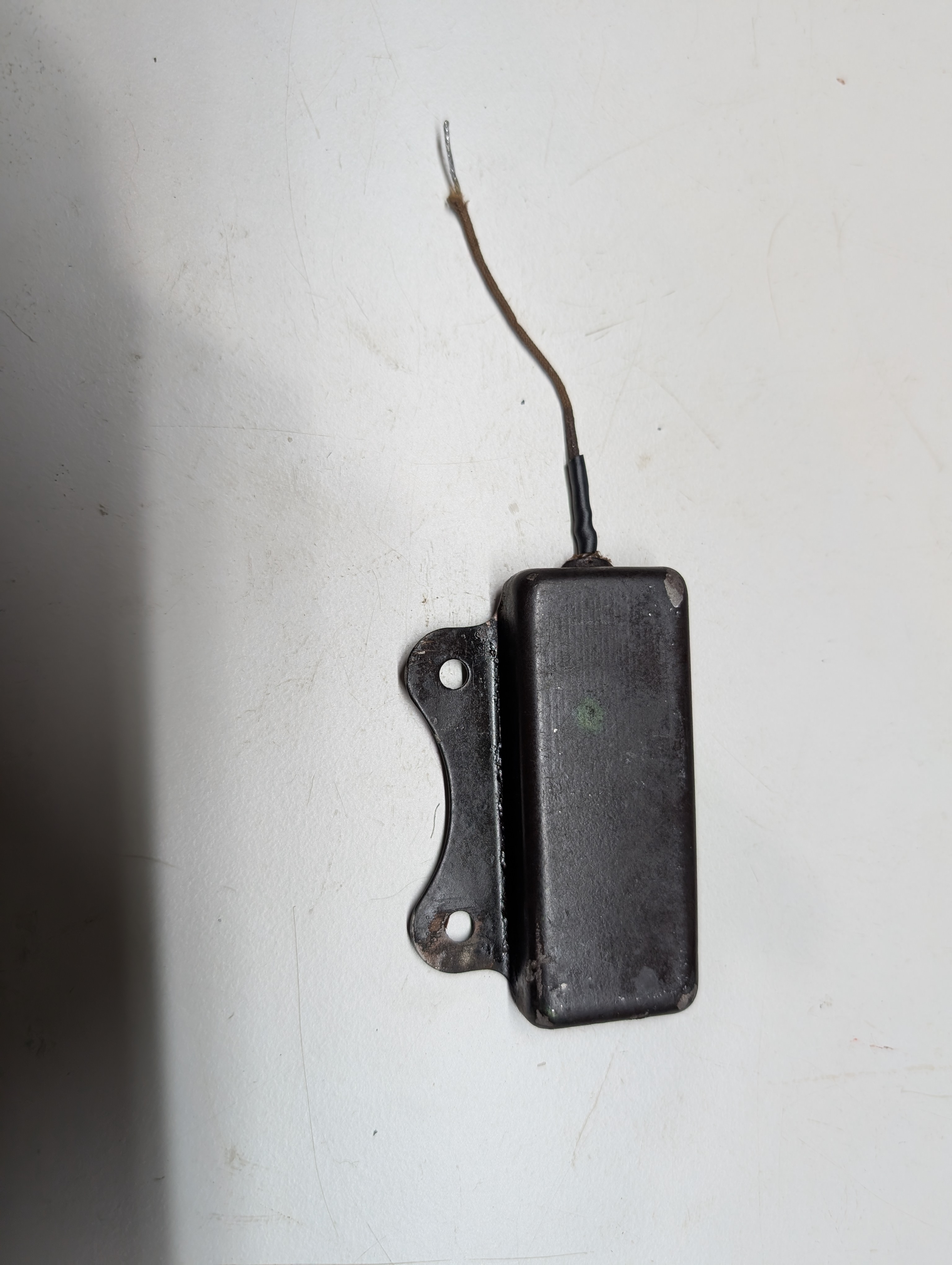

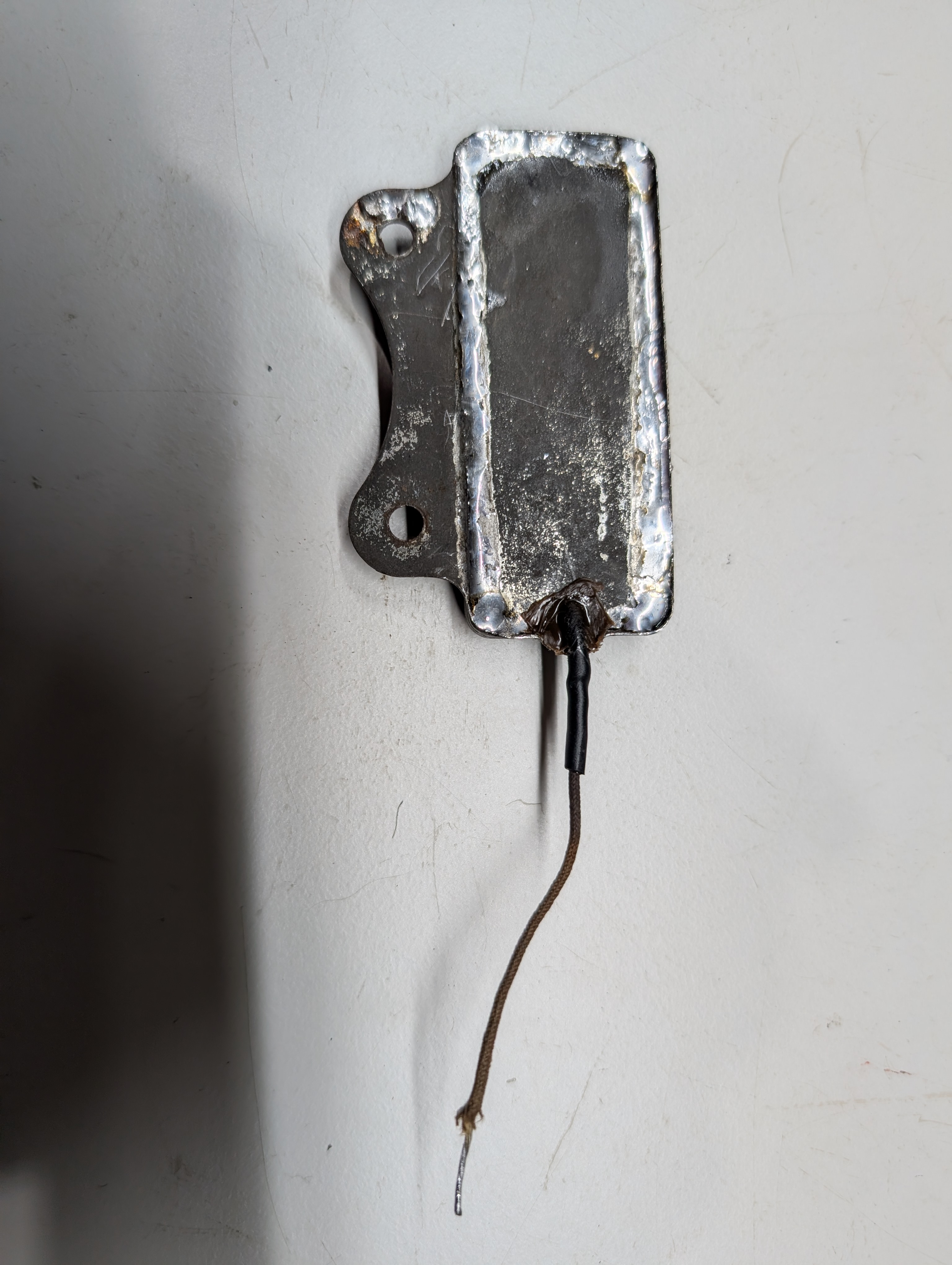

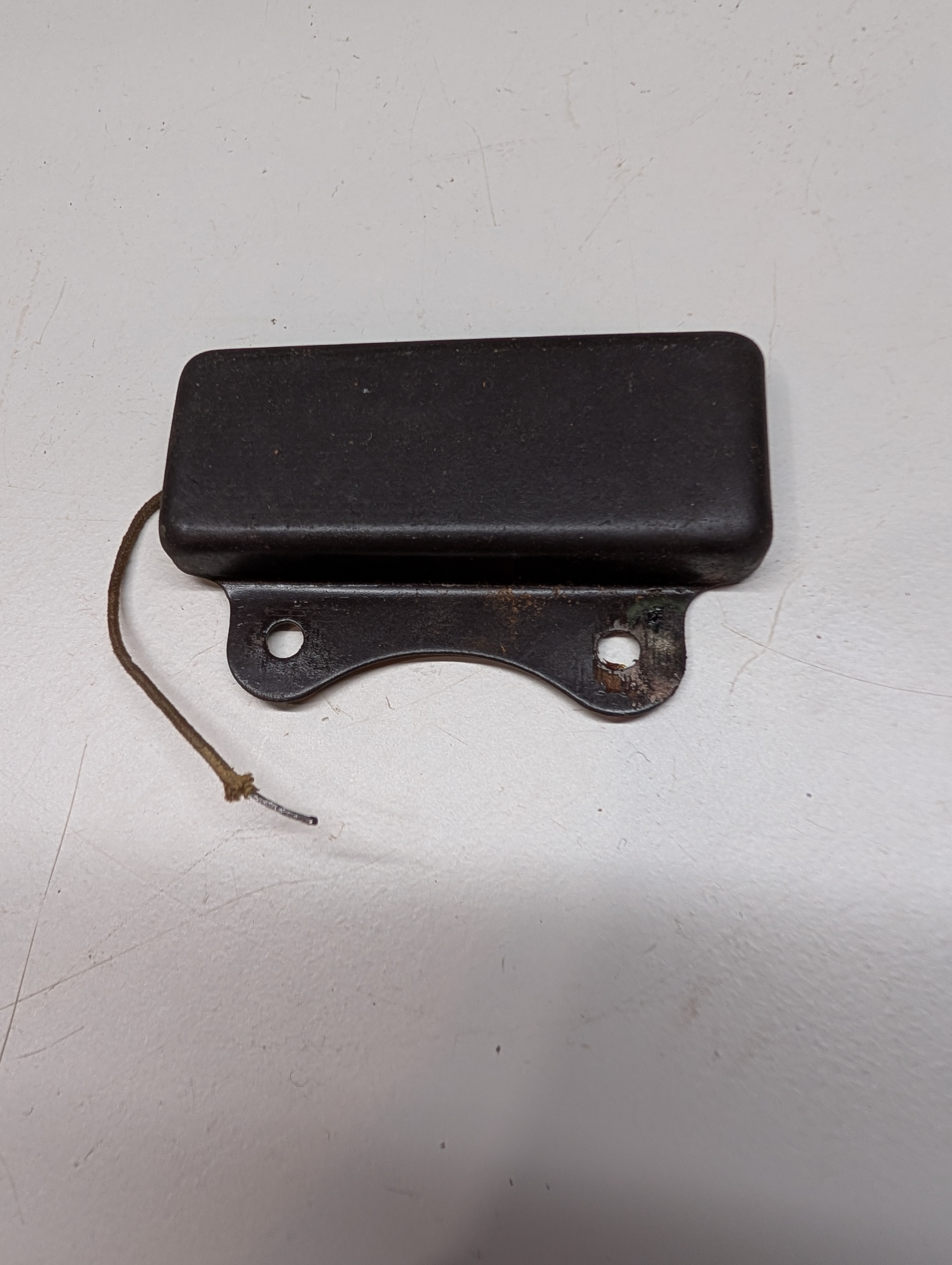

Now to rebuilding the 0.2uF decoupling cap.

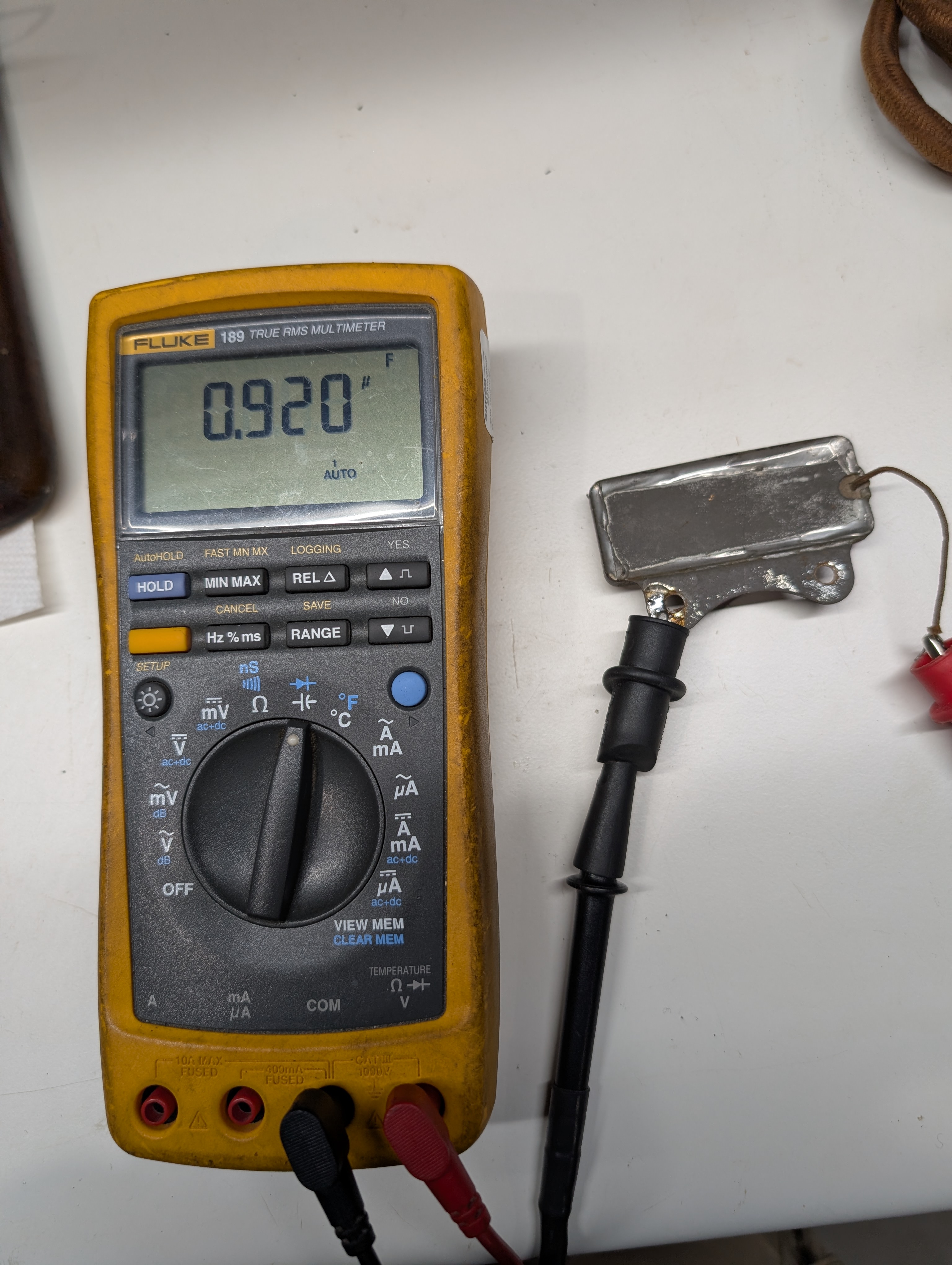

It shows 0.9uF on my DMM and 0.5 to 0.9uF on my Stanford Research LCR analyzer, depending on the measuring frequency.
Thing is, I forgot how I did lifting the can's bottom before. I know I removed solder. But this one is stubborn.
I will consult my AK82 thread. Though I doubt I put the exact technique there. Will have to figure it out all over again.
Short of using a can opener.
PS. Well...I was of a worse opinion of myself. I did put the exact technique in the thread. And it is exact same as I've been doing now. Heat the can and shake off teh solder.
Except the solder is not shaking off. Maybe gotta get it hottel. Maybe the tin is thicker.
Oh well, I'll get it somehow.

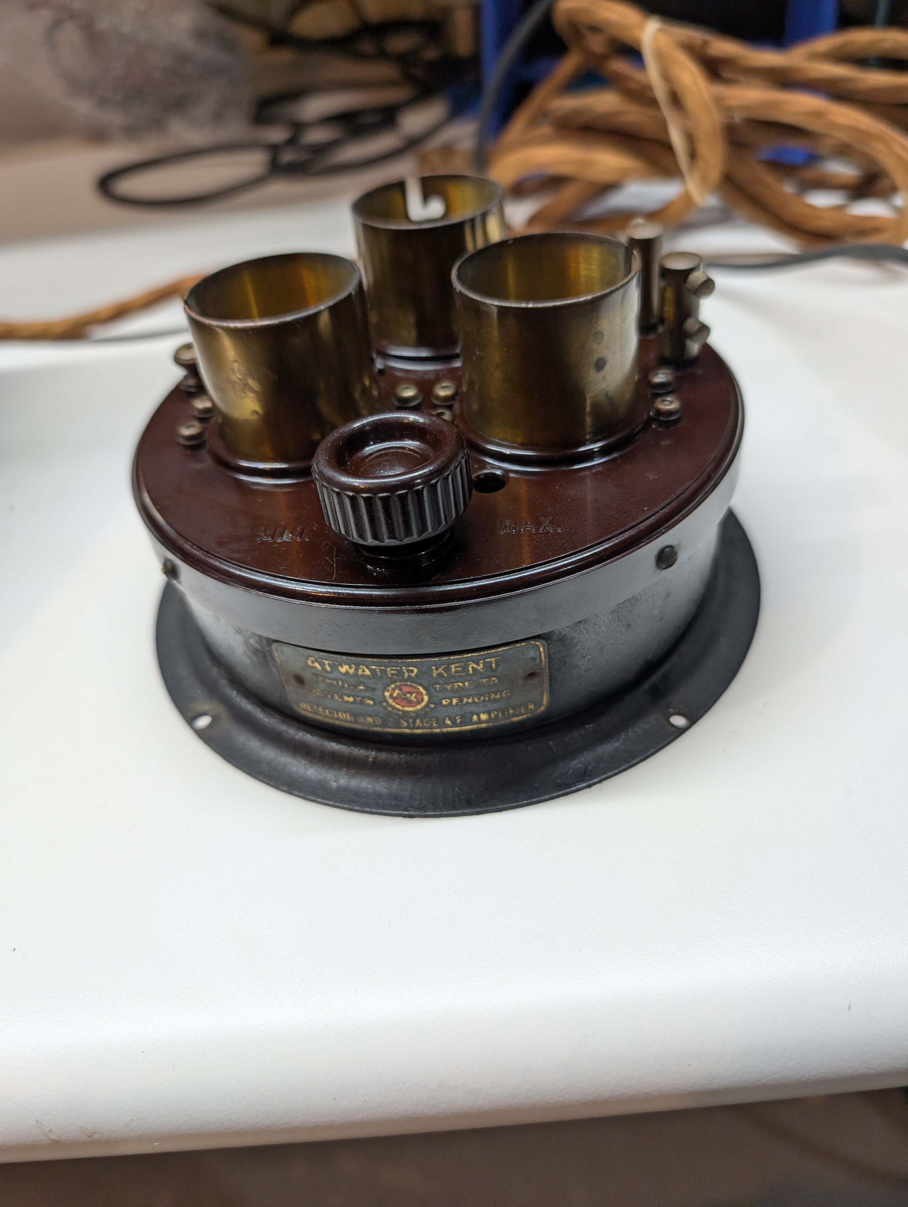

On mine, I removed all hardware and scrubbed, then used GoJo and brushes, after I glued the parts that broke off the bakelite due to the eBay seller's sloppy packaging (He packed the A-K E2 speaker in the same box on top of the breadboard instead of under it and did not use enough packaging material or tying anything down.

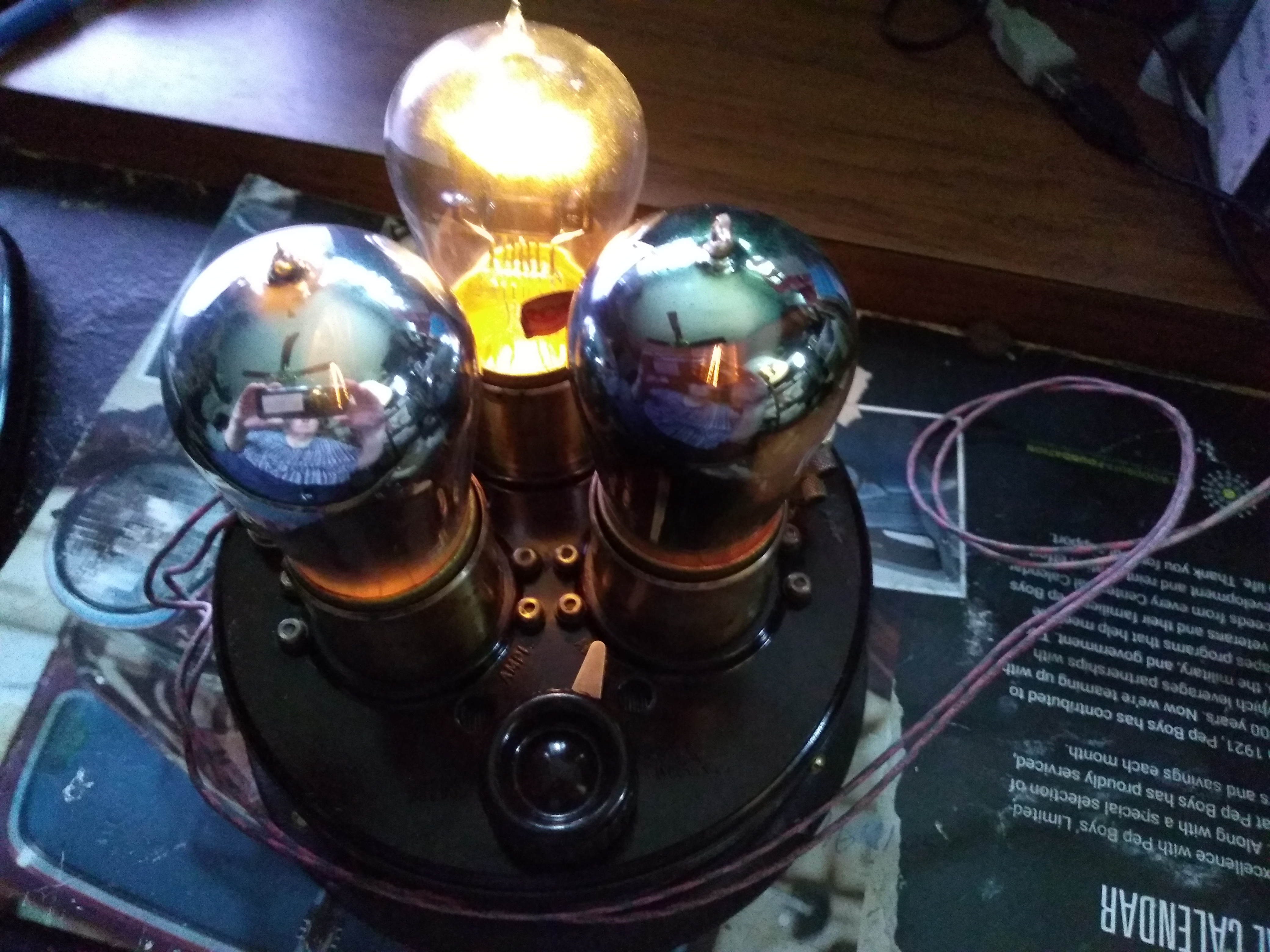

Here is a pic of my Island. No pics of one disassembled. I used the same transformers as Morzh did and wrapped the frames in tape. Morzh, yours is more elegant. At some time, I will soup this up by adding a terminal for bias by using an existing hole. The tubes are ca 1923/24 Radiotron 200 and 201 BBTs, no brand etching on bulbs but paper meatball labels. Came with my FADA 160. Suspect them to be GE made. And they work. The radio is quite loud but usual distortion. BBT 201 and a DeForest in the RF sockets. Caption says AK10A but it is a 10C, Pooley version (without the cabinet. The boards for the Pooley sets were not beveled, therefore not pretty. But I got it for $600 3 years ago when a good AK10 was still selling for $1200-$1800.

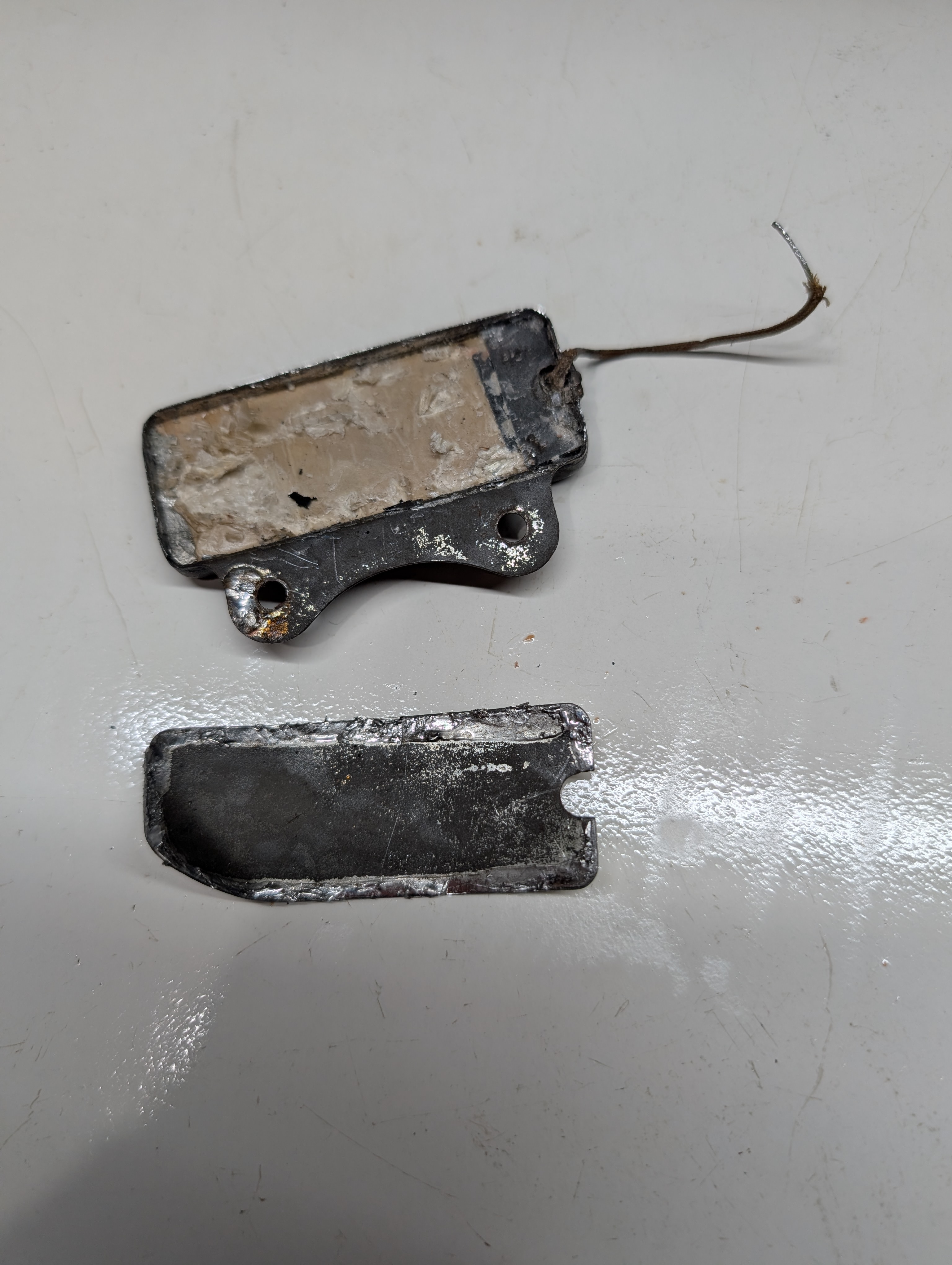

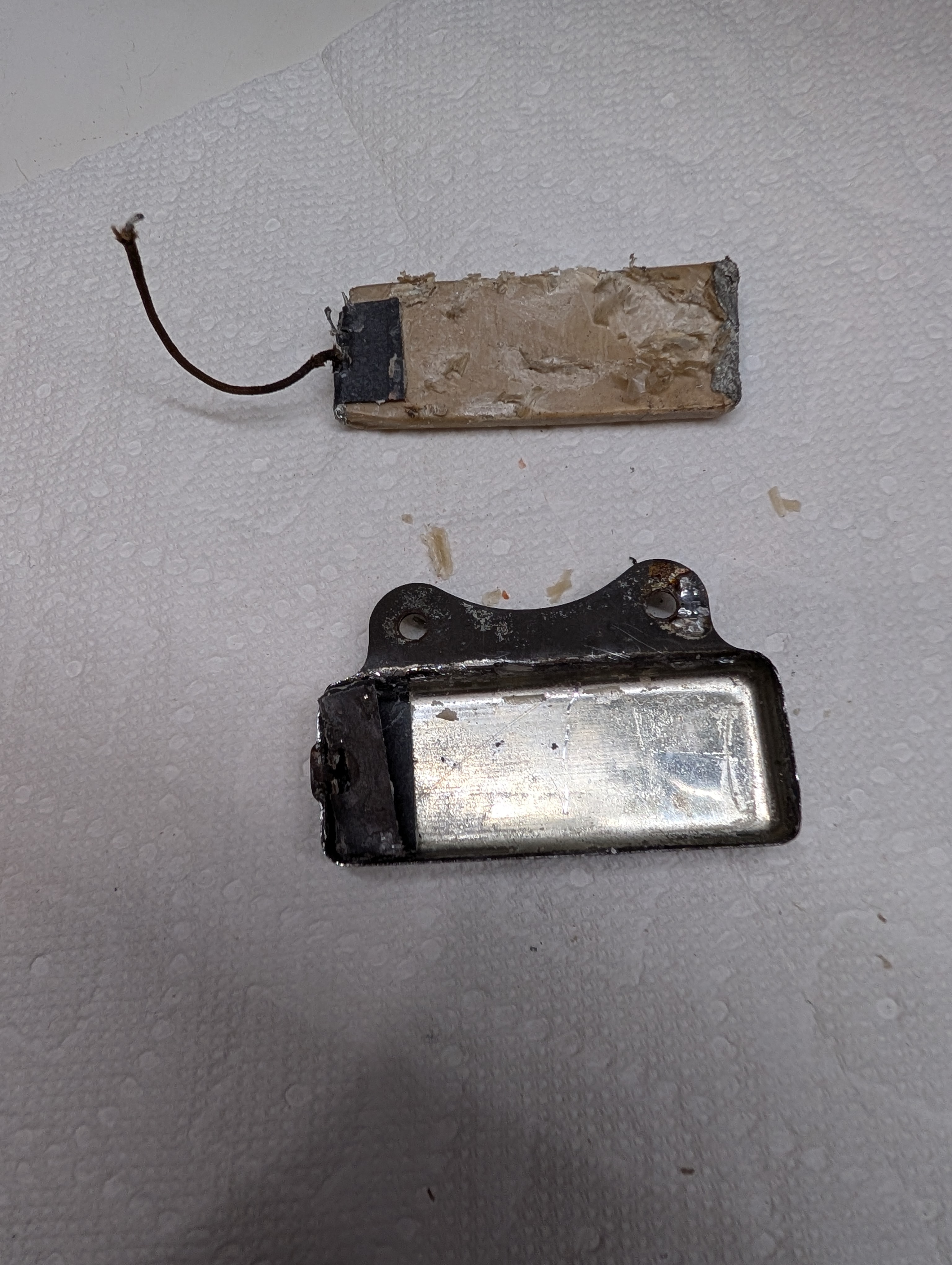

The heat-n-shake technique did work, though this time it was more of a "heat-n-whack." And then I had to jam a screwdriver inside and do "heat-n-pry". Then I had to clean up the table from the wax that, while looking white, landed as pink.
But the cap is opened. The cover will have to be straightened out and then re-soldered, which is fine. No creases means no unsmoothability. Is there such word, "unsmoothability?" I have just come up with it. Who knows, maybe this is what I will be remembered by after I'm gone.

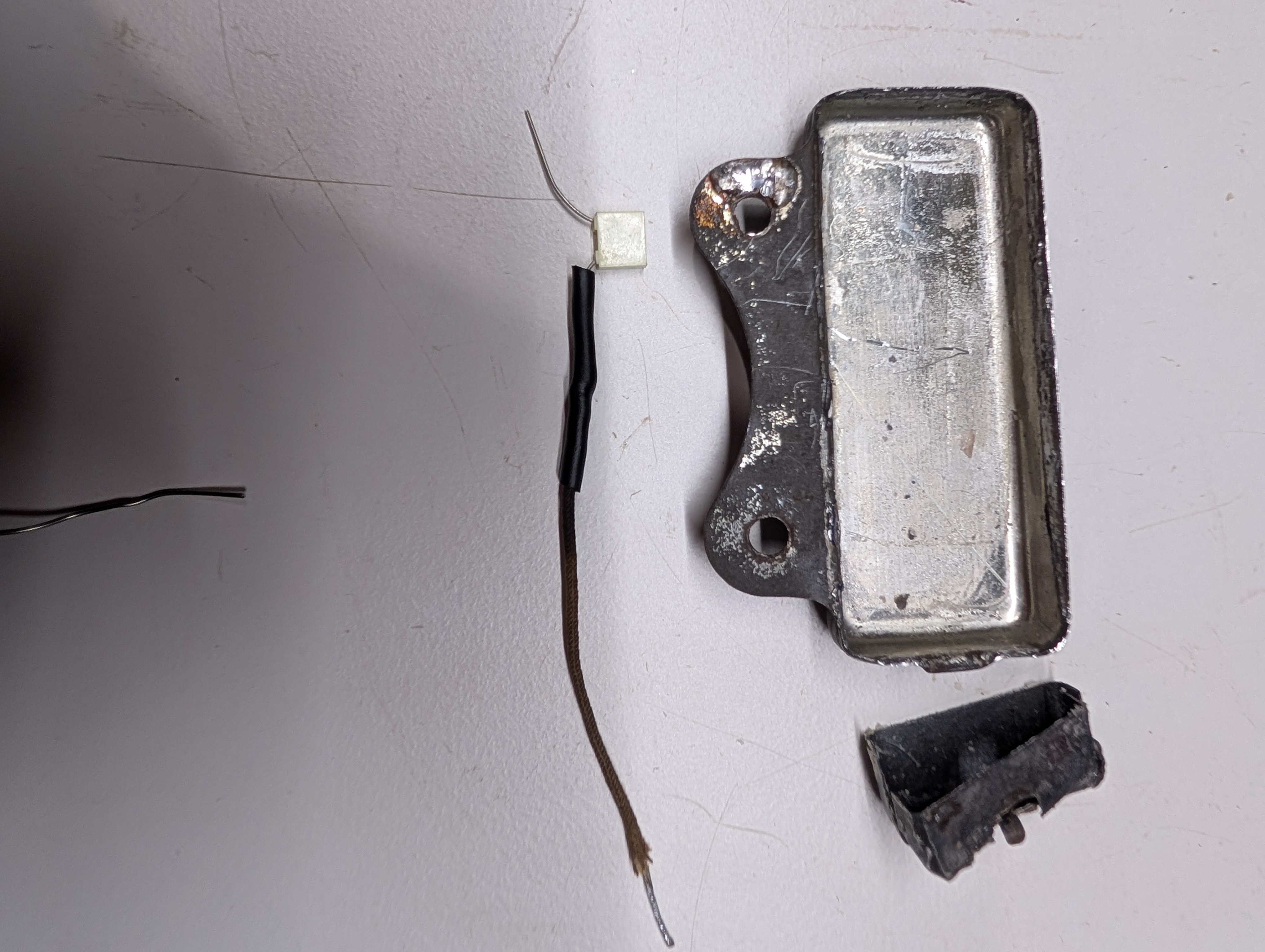

First, the question: what tint of Howard Restor-a-Finish should I be using on the AK10?
Walnut, Dark Walnut, Mahogany?
So, this is your typical AK cap block rebuild.
Not sure why they use this one, considering it is but one cap, maybe for protection.
It is somewhat cold in the workshop, have to use a spaceheater (the one I fixed recently). Though I decided to order another one, and a Black and Decker of an equal caloric output is $21.
So, due to this, the wax block was stuck to the case and I had to use a heatgun for a minute or so. Came out easy after that.

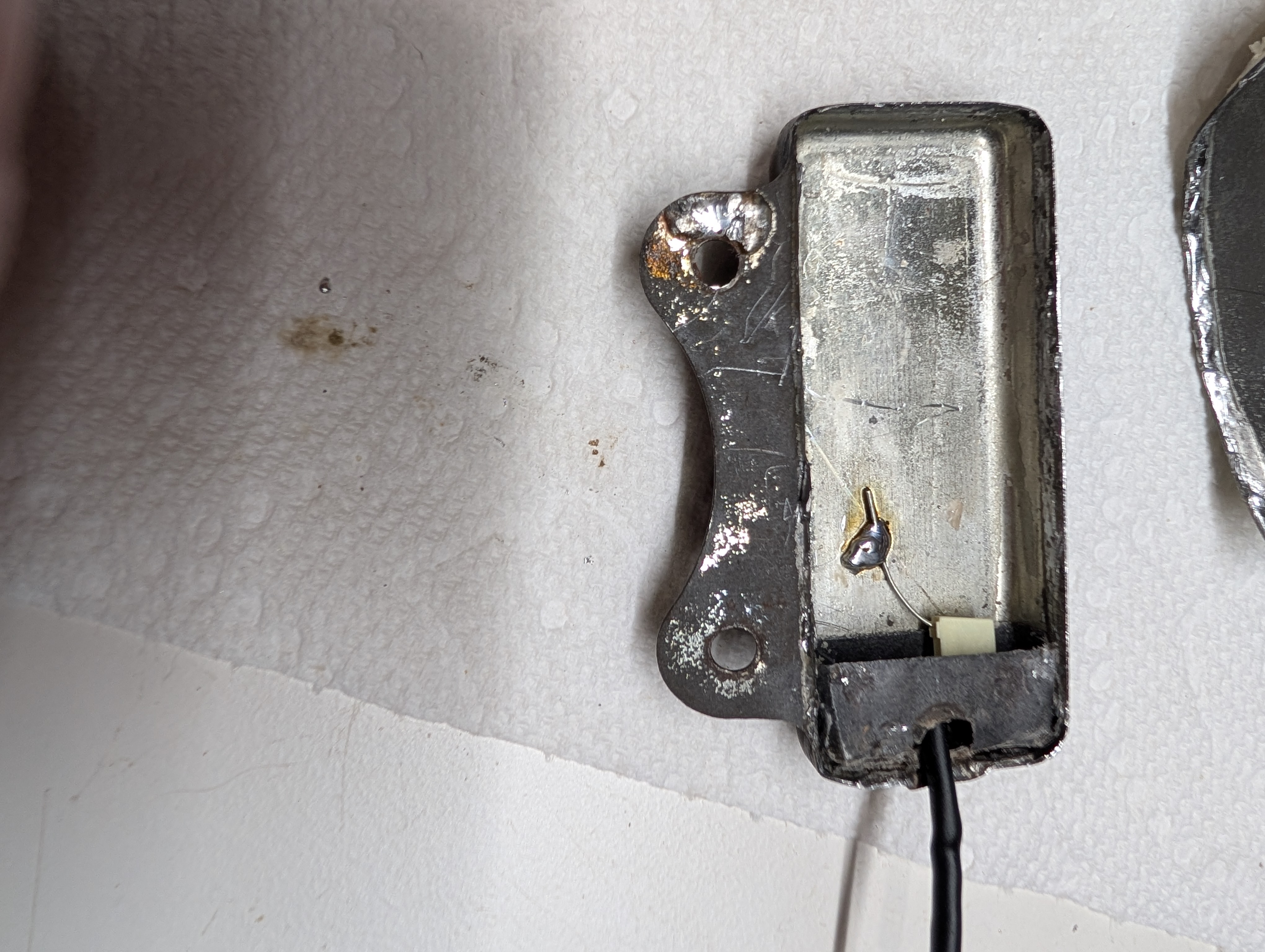

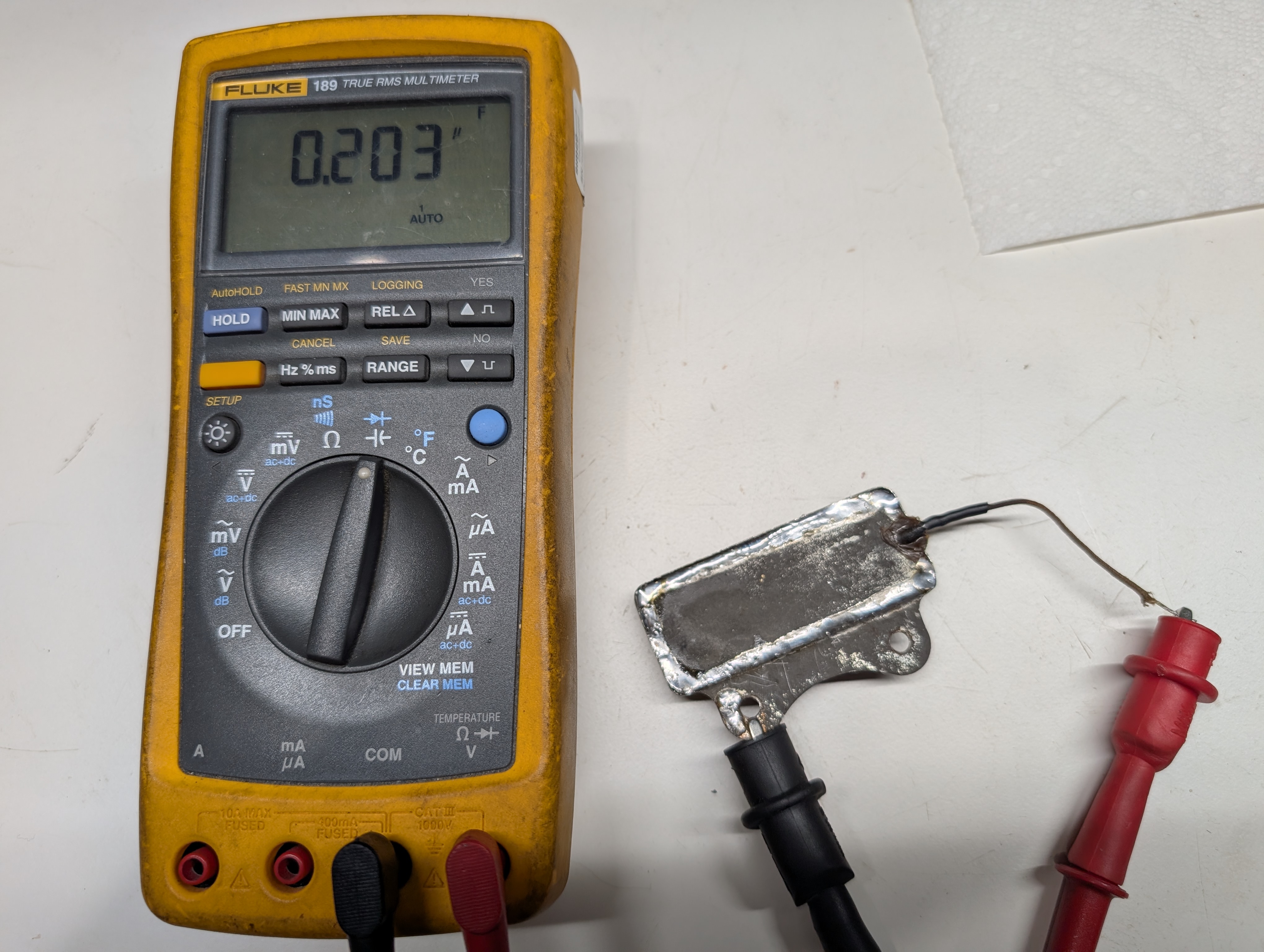

Then I realized I have no 0.22uF cap thin enough to not present problems when soldering the cover back in. Somehow I overlooked the fact I do have a cap, but it was very small, 86V or so rated. Then I saw the cap. Then I looked at the sch and realized this is pretty much the feedback cap for all the Cathodes, so the voltage across it should be very small, so I used it. I even remember why I bought them on Amazon: I repaired my APC UPS and saw these caps broken off (vibration? else? I bought it used 20 years ago from some company going out of business).
Soldered it in place

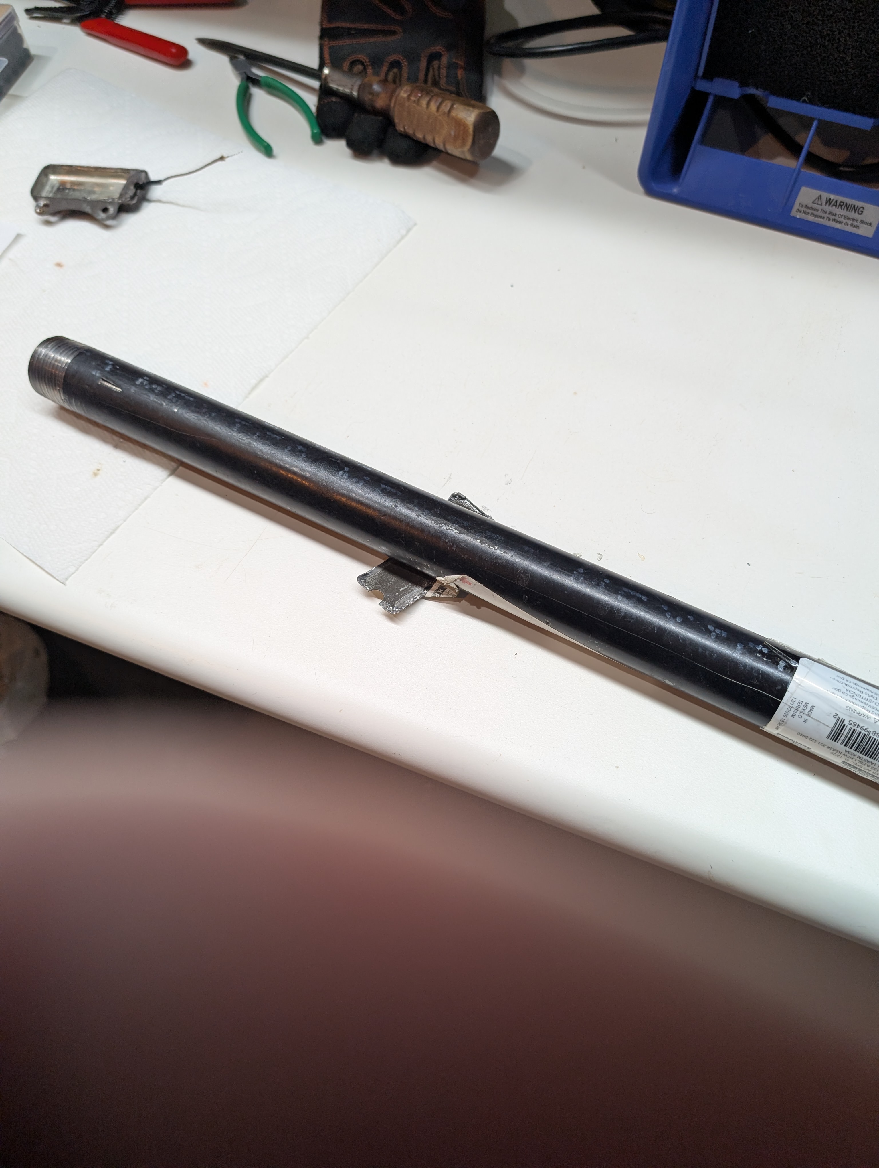

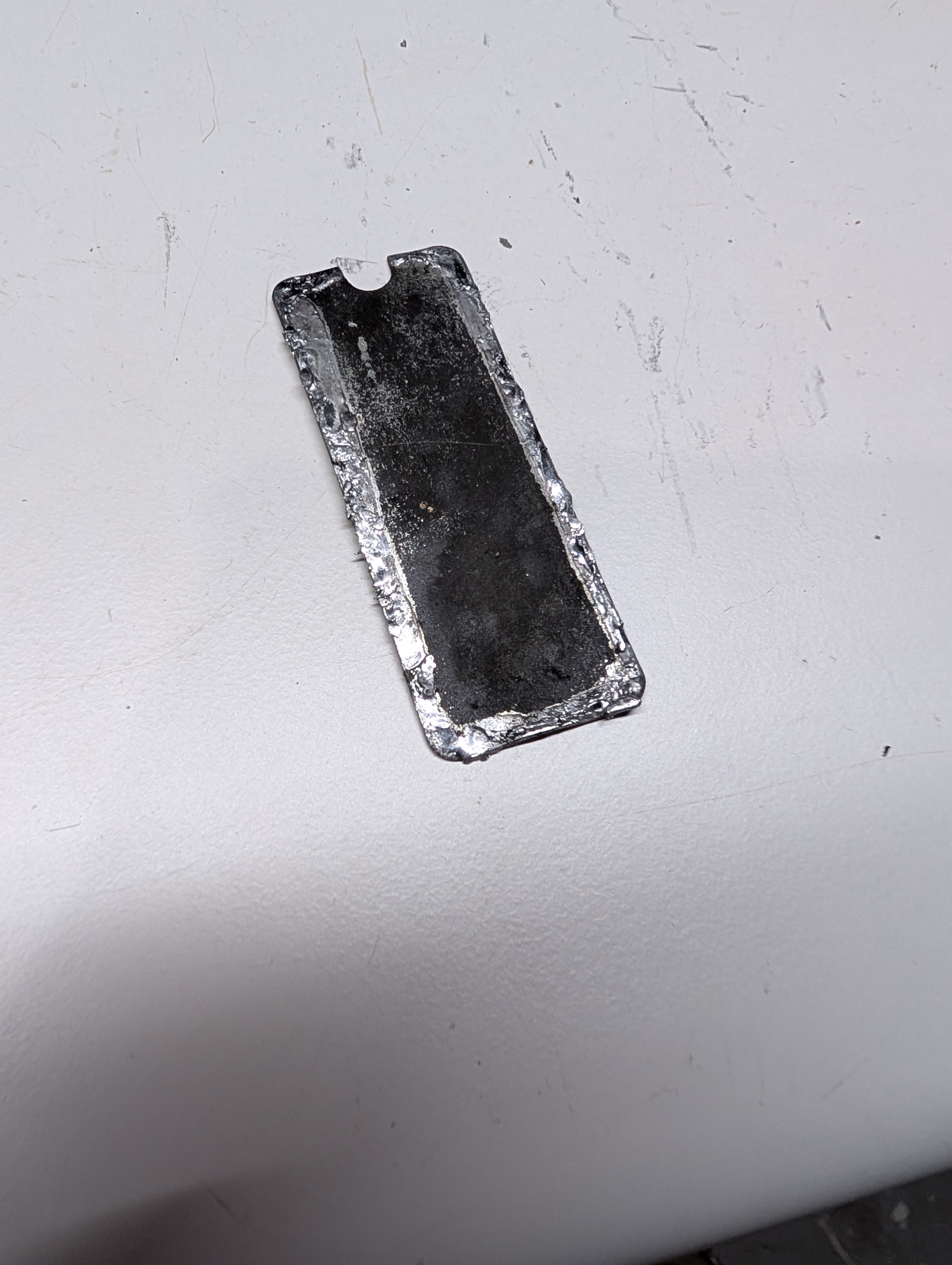

Then had to straighten the cover. I have a large steel pipe, so I used it as a rollin pin.
With good success.
Soldered it in place and potted the hole.
Gave it one final check.
