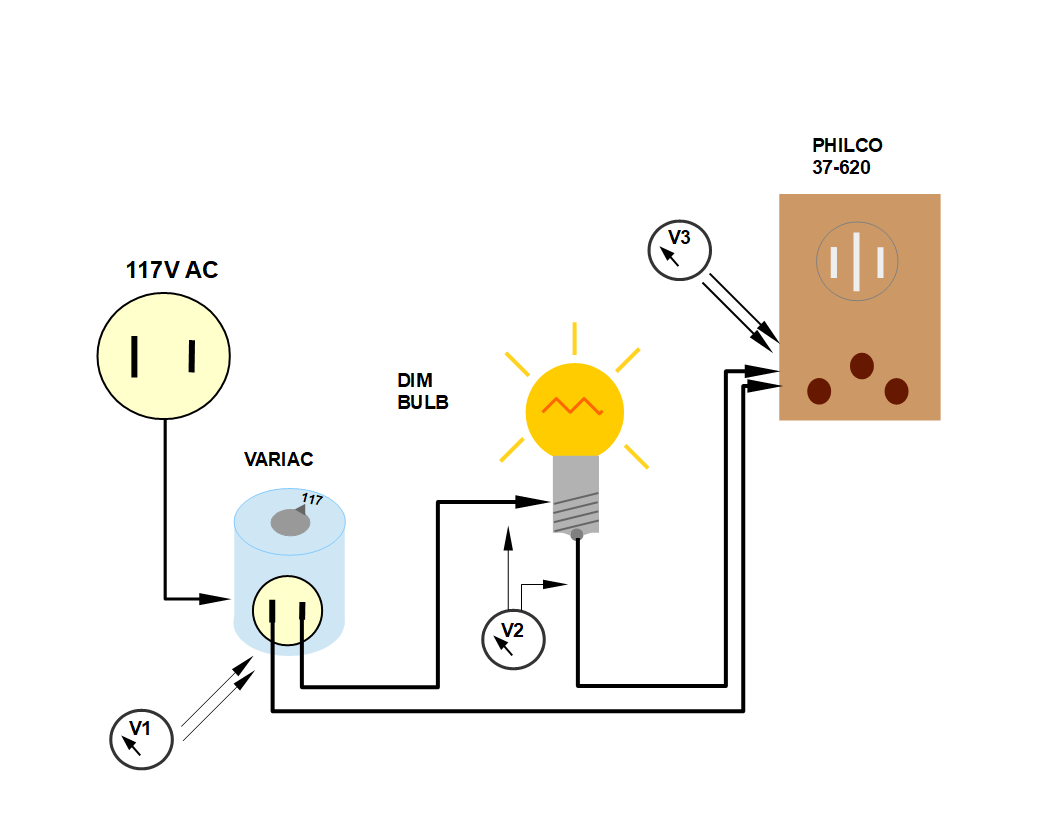

Again, if I understood you correctly (if not, correct me): your setup is kinda like this.
Your radio and the Dimbulb are serialized and then plugged into the Variac that is set at 117VAC. (OK, 110, 120, whatever).
So your V1 is 117V.
If this is the case, measure the V2 and V3. That is, across the lightbulb and across the radio plug (inside, outside, whatever is easier - they are the same)
