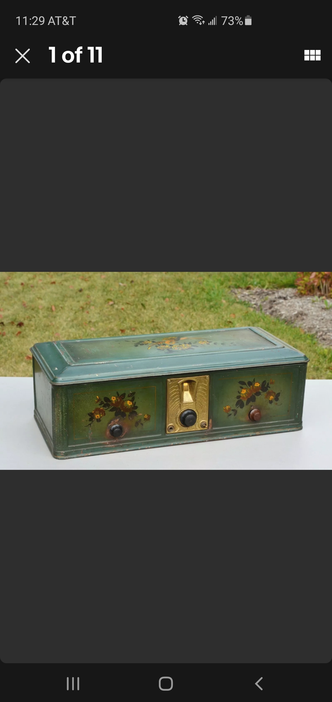

Hi Skip.. I just purchased a 514 and need to find an aluminum power supply cover stamped with '514'.  As you have a 512 which has the incorrect cover with 514, is there any chance i could purchase the cover from you and provide you with a 511 exact replacement?  In just beginning my restoration.   This will be my 6th set.   I also have a 511 i restored which is one of my favorites.   Thanks for considering

Did you buy the one on Ebay last week?
I had a monster Esnipe bid on it,$500,but withdrew it at the last minutes.I decided I didn't need two 514's.

I did.. pretty decent unit  (Got it for $160 with shipping.. not bad).      I couldn't believe it was missing the power supply cover though.   Now i just need to find the speaker wish which may take the rest of my life!  Can't wait to start restoring it.   Please let me know if you'd consider an offer for the cover you have.. id be very grateful.   Cheers
